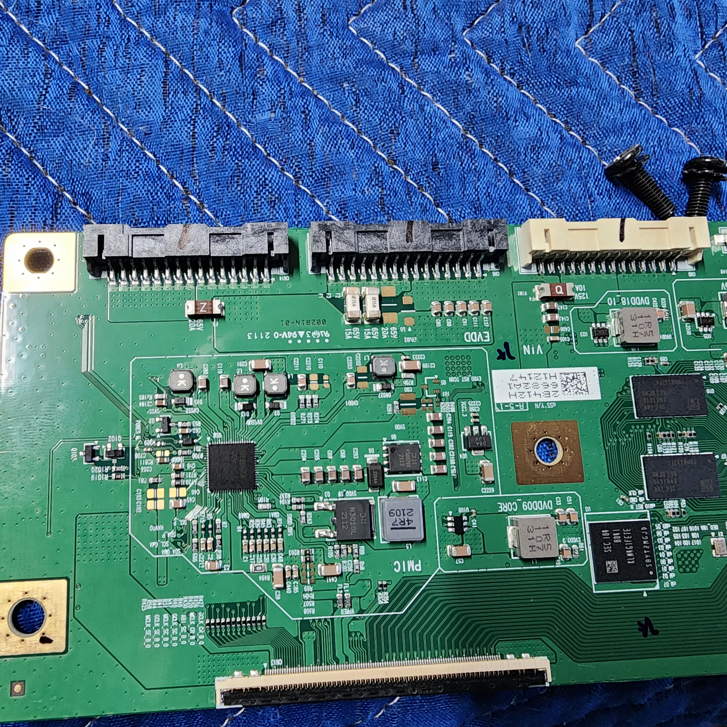

        Re: Sony XR-77A80J OLED 5 Blink
        Originally posted by Diah
        puffer boards
        These?
        Ceramic cups
        these?
        • EazyBone
          • Jun 2023
          • 1356
          • United states
          #44
          I have tried many things, I even found a broken screen a80j and swapped all parts from it. To confirm also evdd would send 21.4v on this one, when doing test. So I ordered new tcon, found a random full set replacement with broken screen and results always the same. The screen shows same exact pattern. I also found a small damage spot on the side of chassis that may have crunched the screen in some way. It was enough to put a small dent in the chassis so I'd assume it could of damaged it.
          As much as I'd love to save it, I think we are confirmed goner.
          Diah, I could cut into the metal strips and such but I have alot of others to fix at the moment. I'm going to put it to the side for now, and if I decide to do such ill look back.
          Davi, I don't see much point in the test now, since I found all those replacement parts. Literally everything is the same no matter what I switch etc and I can see on the broken OLED screen that there was a jumbled picture.

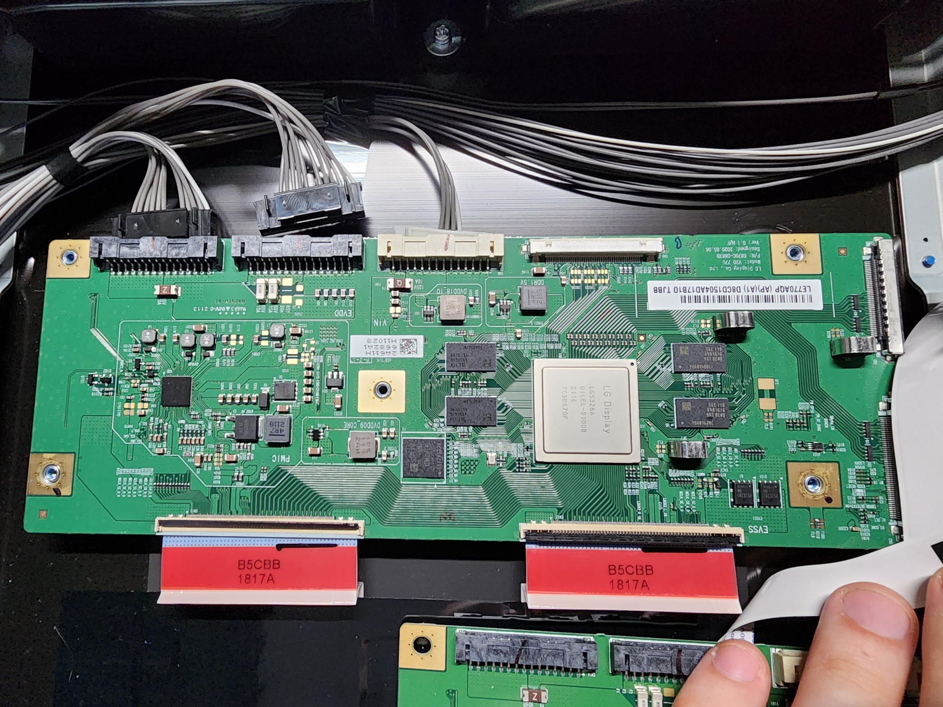

                  #48
                  Already packed up TV but maybe does this help?
                  • Diah
                    • Feb 2013
                    • 6460
                    #49
                    they look they have,,, but need to see the ribbon self its silver pins..

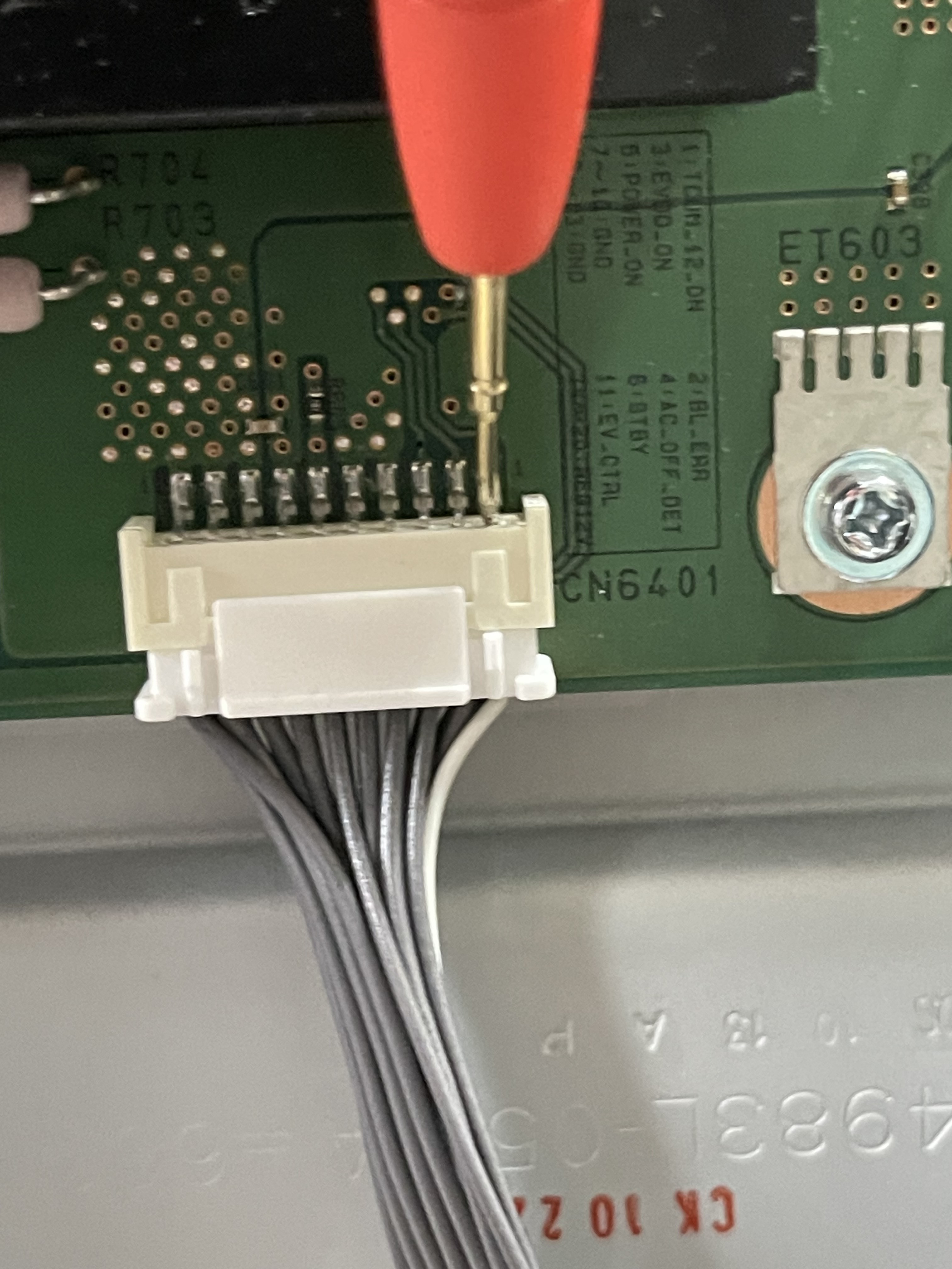

                                  Diah thanks for that. I'll start reading. Also I have purchase V160 8Th Generation LCD Screen Tester Set 4K-Vbyone & 2K-LVDS For Screen Test. Can I use this to test on this Sony TV?
                                  My reading were incorrect from EazyBone here is what I have below.
                                  1.TCON_12_ON = 0V (never changes when I hit power)
                                  2. BL_ERR = 0V
                                  3. EVDD_ON = 3.38V
                                  4. AC_OFF_DET = 0V
                                  5. POWER_ON = 0
                                  6. STBY = 0V
                                  7. GND = OV
                                  14-20. REG 12V = 12.8V
                                  PSU to TCON.
                                  1-3 0v
                                  4-6 0v
                                  7-18 0v
                                  19-30 0v​
                                  Last edited by ChattFix; 04-09-2024, 10:08 AM. Reason: Incorrect readings on my part.
                                  • Diah
                                    • Feb 2013
                                    • 6460
                                    #57
                                    2. BL_ERR = 0V
                                    3. EVDD_ON = 3.38V
                                    4. AC_OFF_DET = 0V
                                    5. POWER_ON = 0
                                    6. STBY = 0V
                                    7. GND = OV
                                    PSU to TCON.
                                    1-3 0v
                                    4-6 0v
                                    7-18 0v
                                    19-30 0v​
                                    yours measurement had error... not correct 100% .. but please do it again with photos

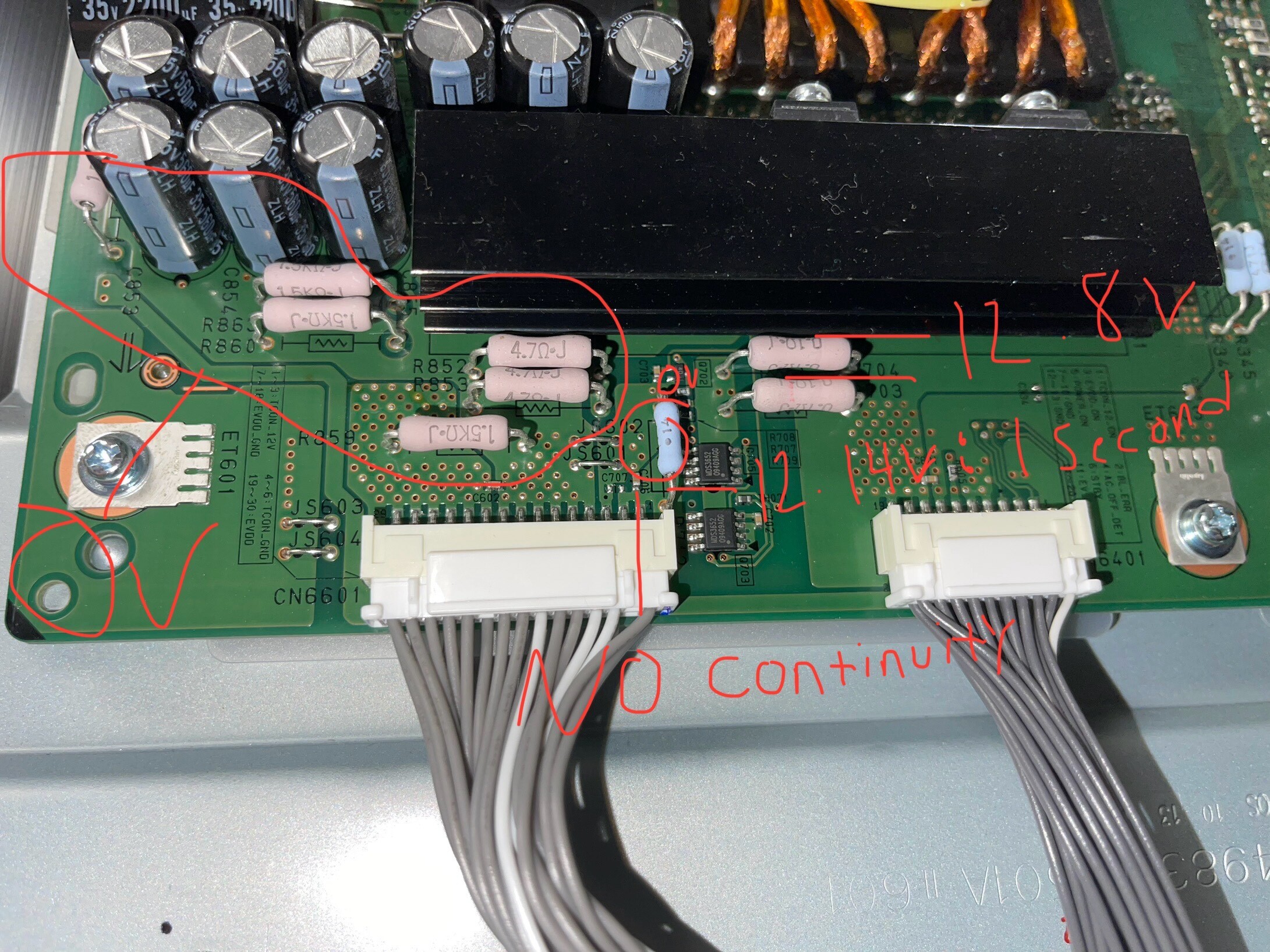

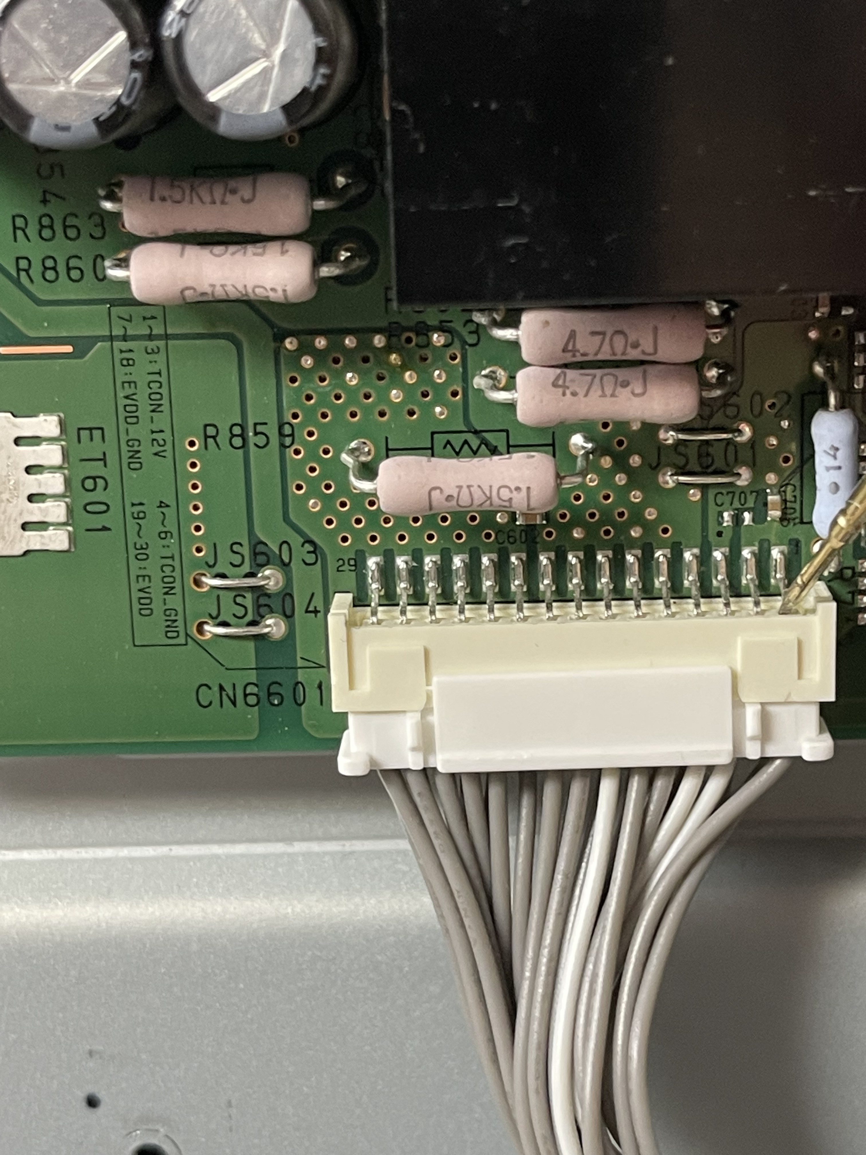

                                    • ChattFix
                                      • Oct 2021
                                      • 79
                                      • US
                                      #58
                                      Thank you for your response Diah . The only difference I saw was in the pins below located at CN6401:
                                      1.TCON_12_ON = 3.38v for half a second then down to 0v
                                      3. EVDD_ON = 0v then when I hit power button goes to 3.38v then to 0v once red light is present.
                                      Here are the picture below where I started at pin 1 on both PSU to MB then PSU to TCON. I noticed that R712 does not have continuity, is it supposed to have continuity? R712 also flashes 12v on one side for half a second.
                                      • vinceroger69
                                        • Mar 2012
                                        • 6714
                                        • uk
                                        #59
                                        sounds like r712 maybe open circut maybe lift one side from board and re check
                                        • ChattFix
                                          • Oct 2021
                                          • 79
                                          • US
                                          #60
                                          vinceroger69 I removed one leg and still no continuity. I'll look to see a replacement. Is there something else I should check before replacing?
