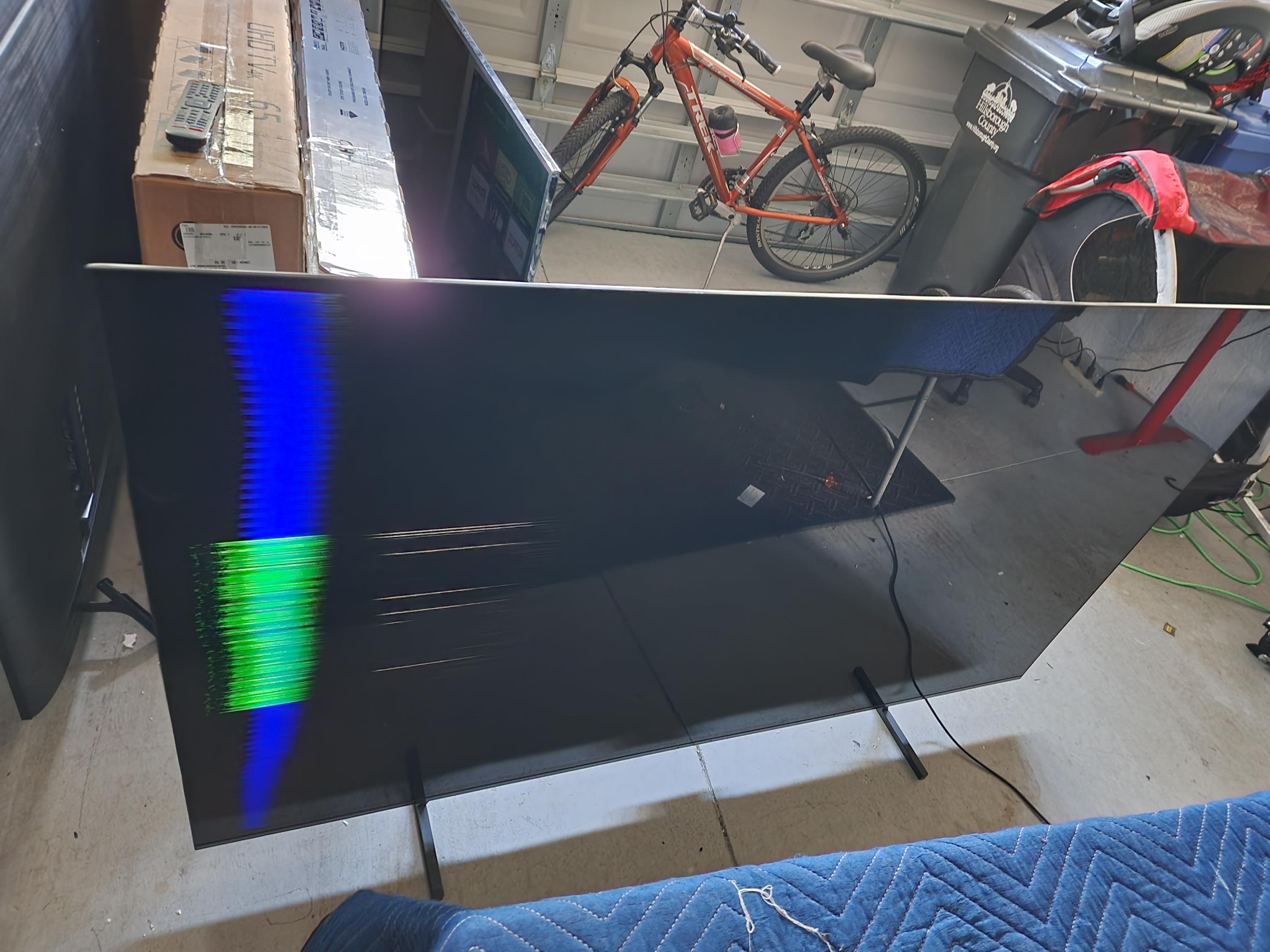

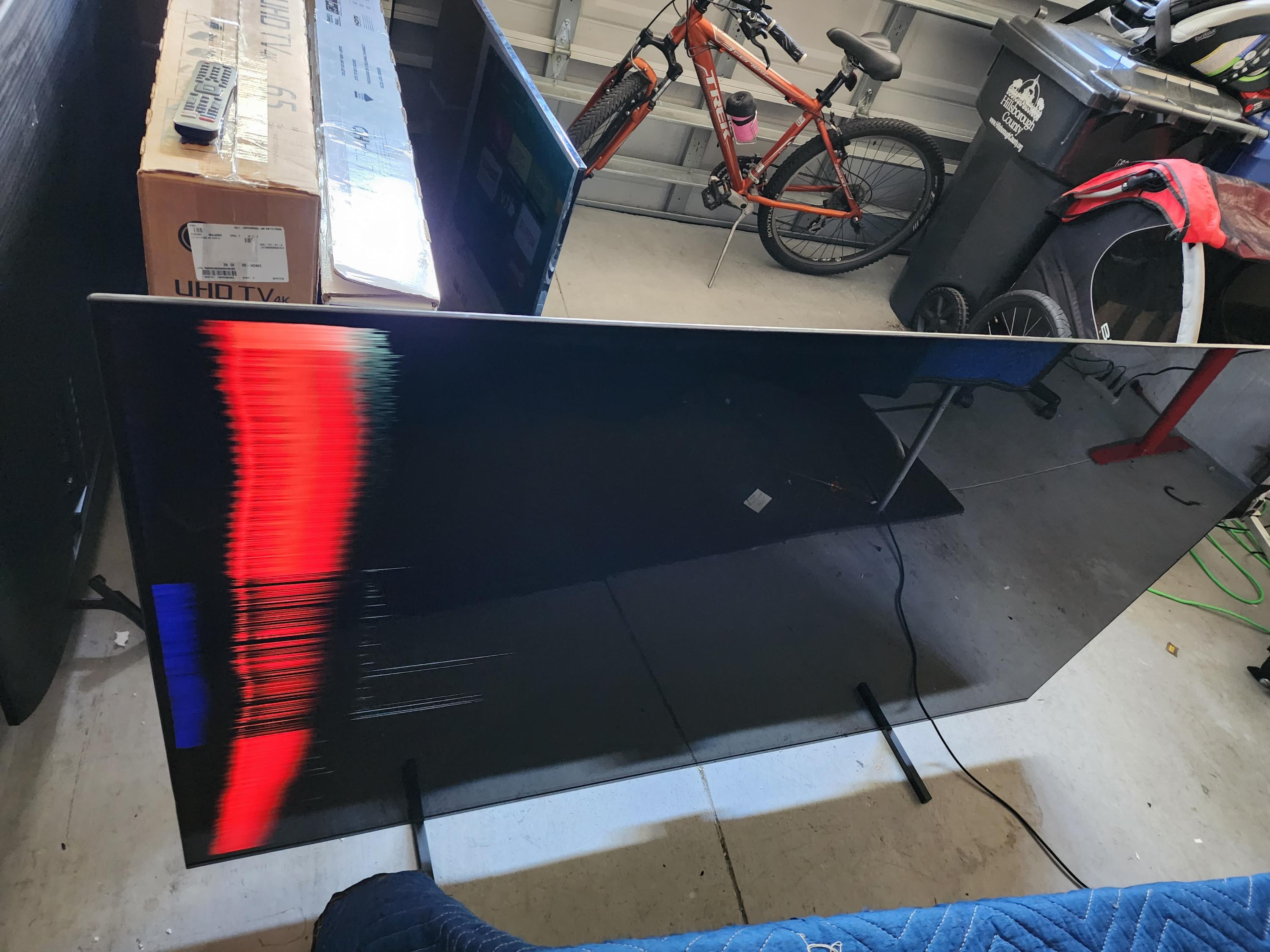

            I get blue red white green

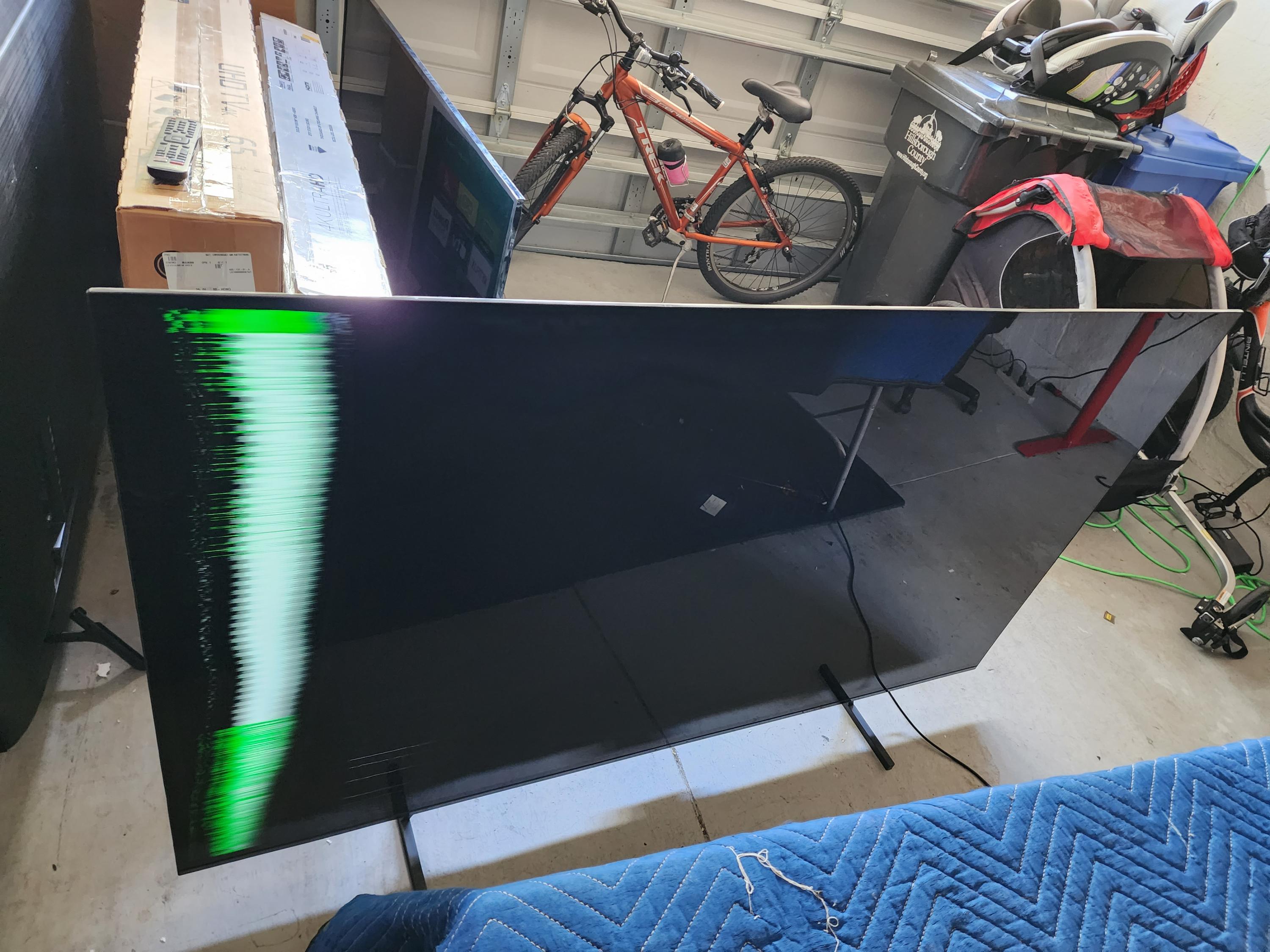

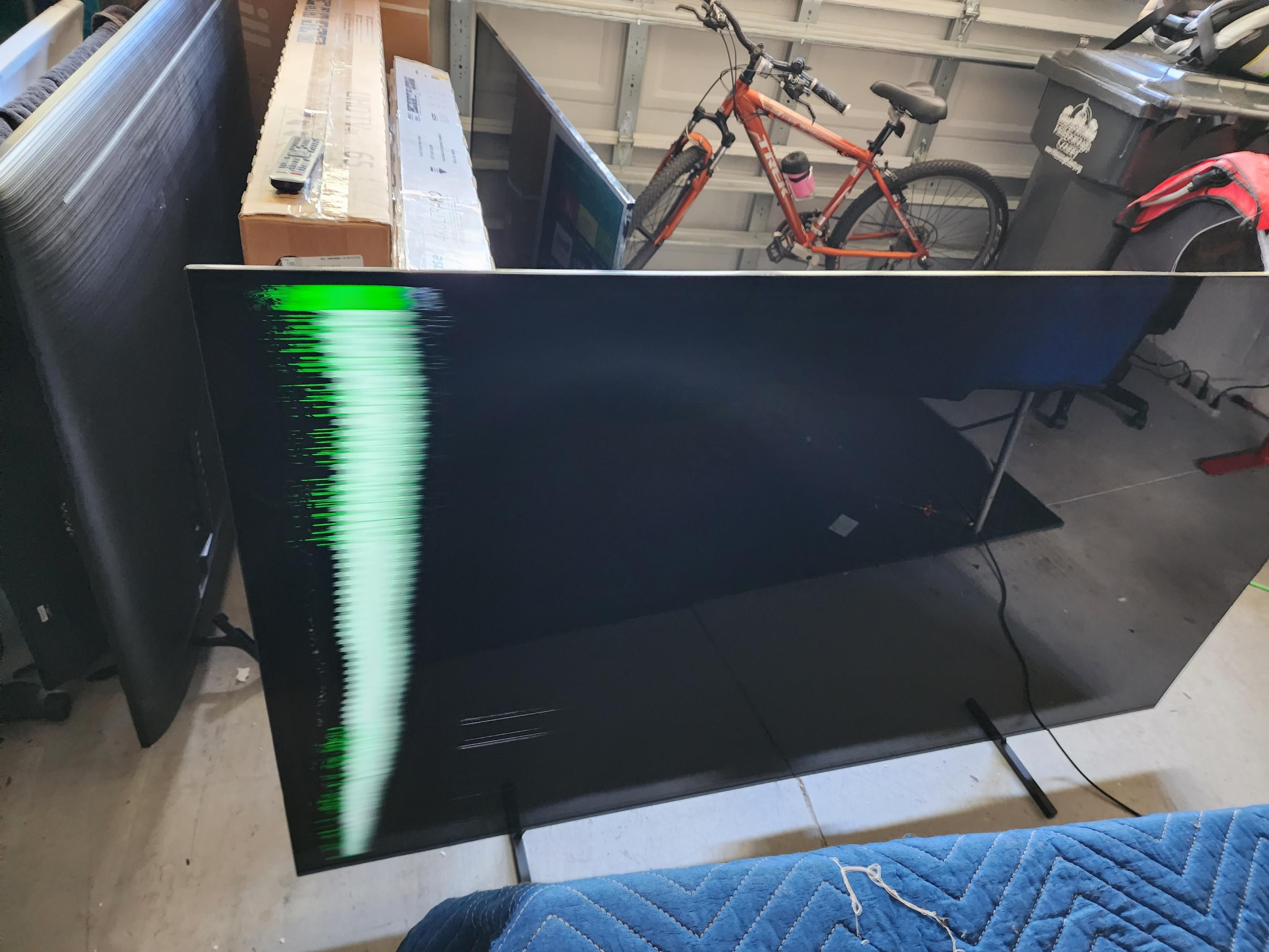

                  Fire also should be something say before hand lol I was not ready. But no fire. And okay on voltages
                  The white lines in the middle? Yea they show up and leave randomly. It just cycles the picture shown. Red white green blue back and fourth with small white line randomly in middle of full screen

                      Okay, all the lines are left to right. Although that color line is up and down, all the lighting up is all doing left and right lines. No lines are up and down.

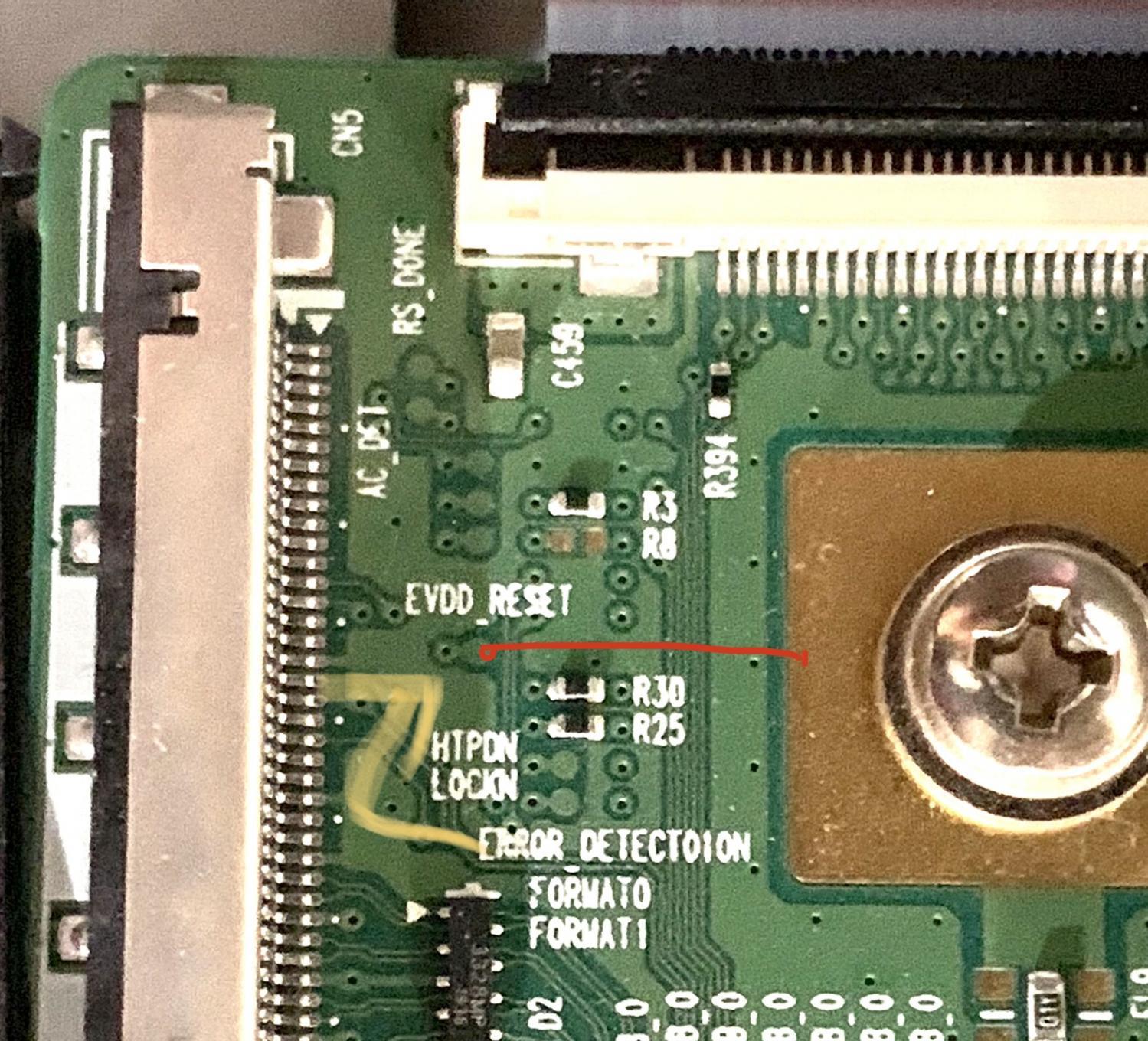

                                      if you look on the LVDS down one ( which you disconecct it before and TV remain ON.with black screen ) there are test points ( EVDD_RESET ) this points go high to round 3.3V at time the Tv shutting down because of the SOS signal.
                                      if this points jumper to chassis to remain always low the TV will remain on and you could see the screen on... but in which condition this is the questions..
                                      so if the the points go high.. mean EVDD at the module had short cells too

                                          TV is done. New tcon same results. Panel short. Thanks for trying. I have bad luck with expensive tvs
