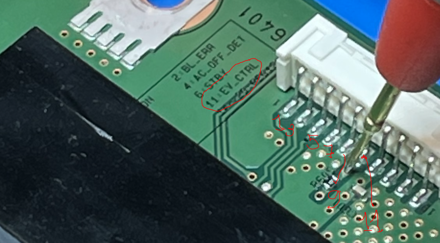

              Originally posted by ChattFix
              See pictures below
              You are measuring on the wrong contacts, your probe is set to 11 pin.

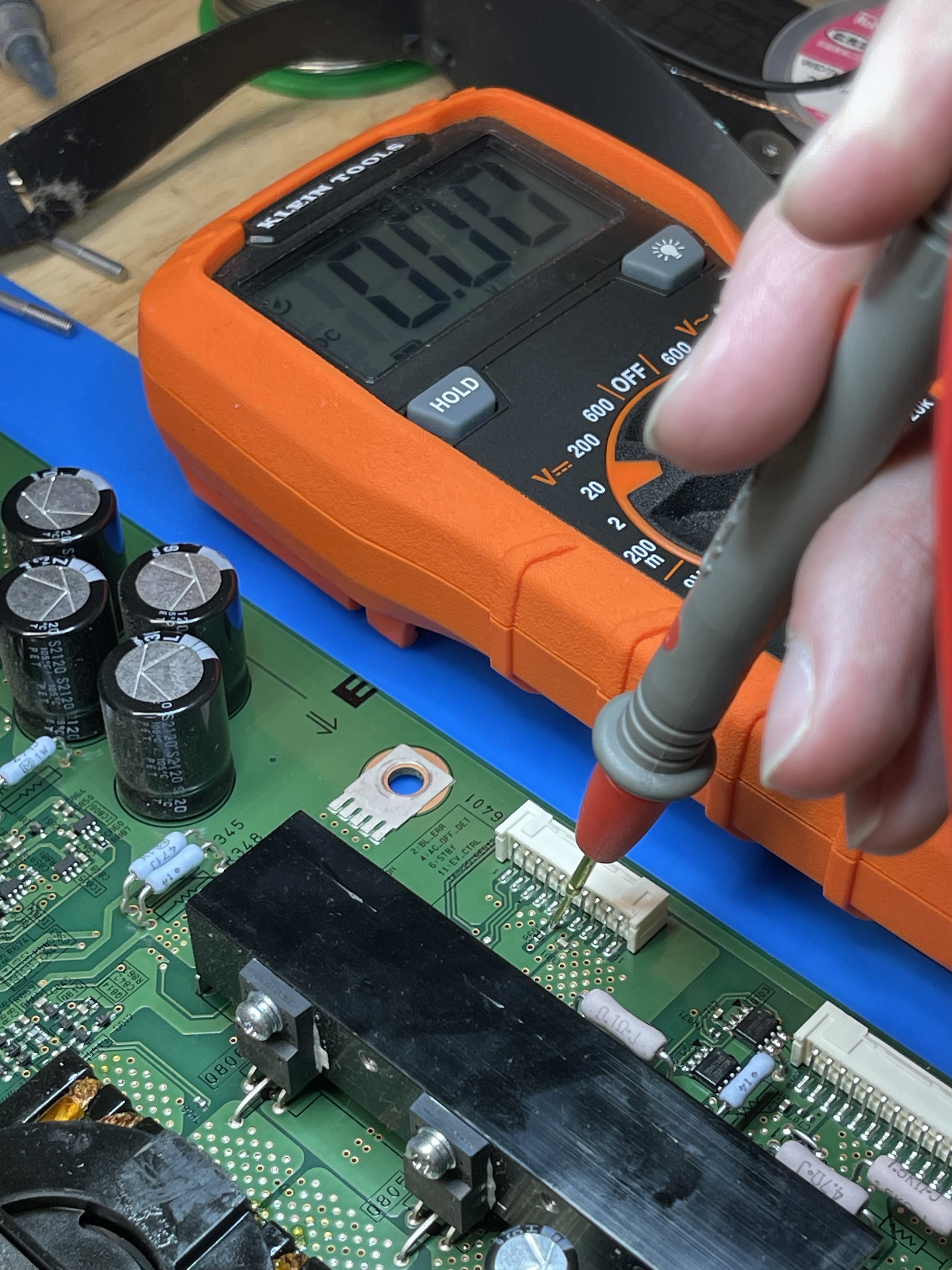

                    Diah I apologize for my lack of knowledge and not paying attention as much as I should. My readings were incorrect as you stated as I did not read the pins on the bottom part of the connector. I have been stopping my work on other repairs to learn TV's and have noticed my mind has been split between this and working on my other repairs so I apologize for my absent mind during these posts!
                    In saying that I do have 3.5v for the STBY. Staying on 2 I still don't have any readings on the 2 black connectors going to the T-CON as well as the white connector.
                    EazyBone I also was laughing at myself going back through these posts lol. I also apologize for adding two pages to this thread of nonsense haha

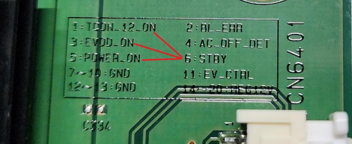

                      disconnect the MB socket from PSU , and disconnect the 2 LVDS from T-CON, the sockets between PSU and T-CON should be in place
                      jumper STBY to pin 5 ( Power ON, & to pin 3 EVDD ON, and to pin 1. t-con on see the photo i attached at my post 84
                      turn ON and look at the screen how it will come on with pattern color
                          I have 3.5v going to pin 1,3,5 but no picture. Do I need to jump some points to turn the TV on or do I just plug it in?

                                I'm getting 12.8v from 3 pins on the white socket but nothing from the black sockets.

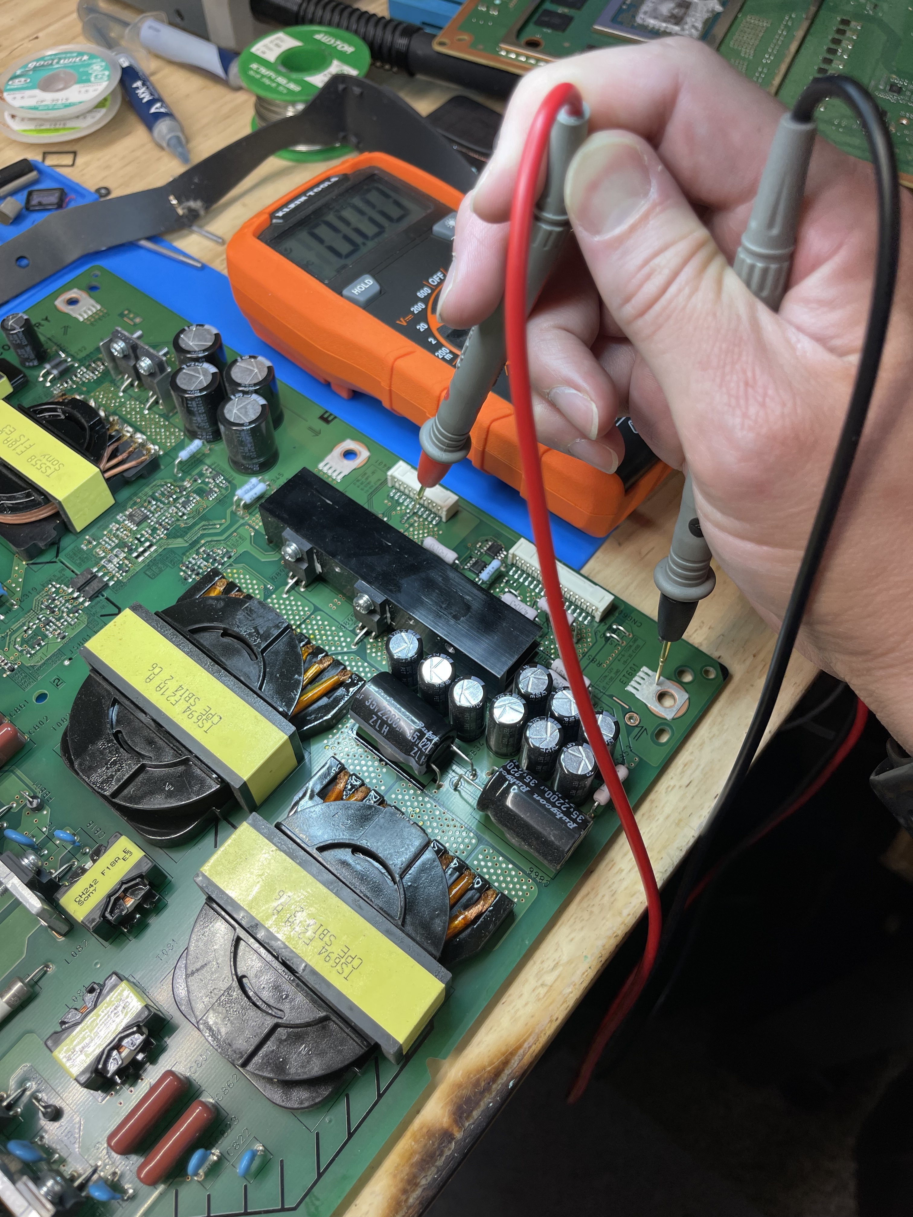

                                    Put it on the table and the bridge is good. CN6601 only have 12.8v in Pin 1 and 3, Pin 2 only has .07. Everything else is 0v. What is the R or LOI?
                                      R the Resistor you moved before one leg at early testing... do you have on bin 3 socket 6401 3.3V as the STBY

                                        Resistor is getting 12.8v on the positive side. Bin 3 socket 6401 is getting 3.5v

                                          this rail pin 3 are EVDD which right now missing V on socket 6101, you need to follow the rail from pin 3 socket 6401 circuit till the optocoupler , there you have issue which the EVDD circuit didn't start
