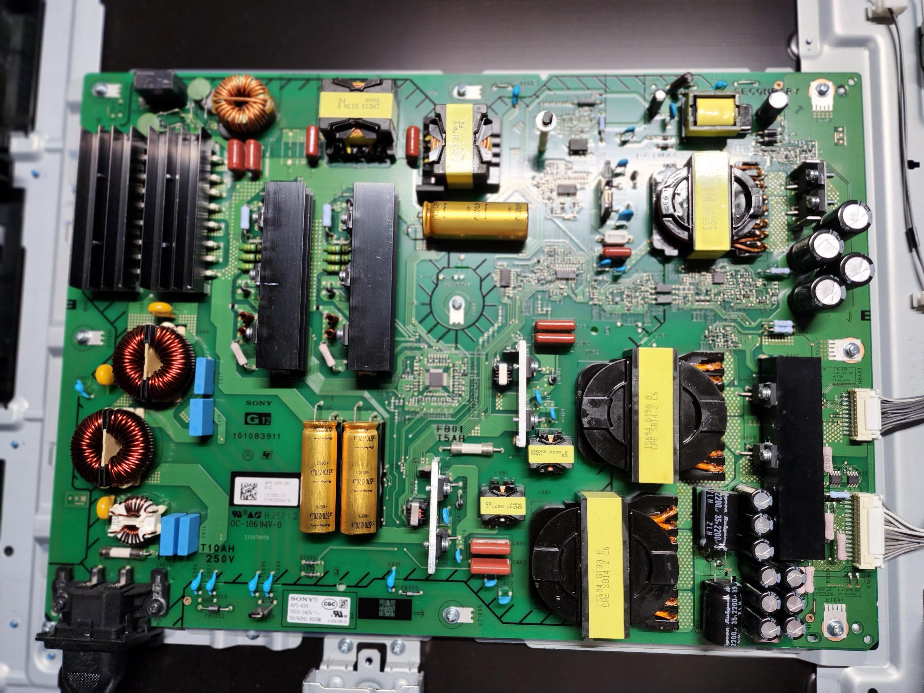

    Another eazybone post took on this OLED now.

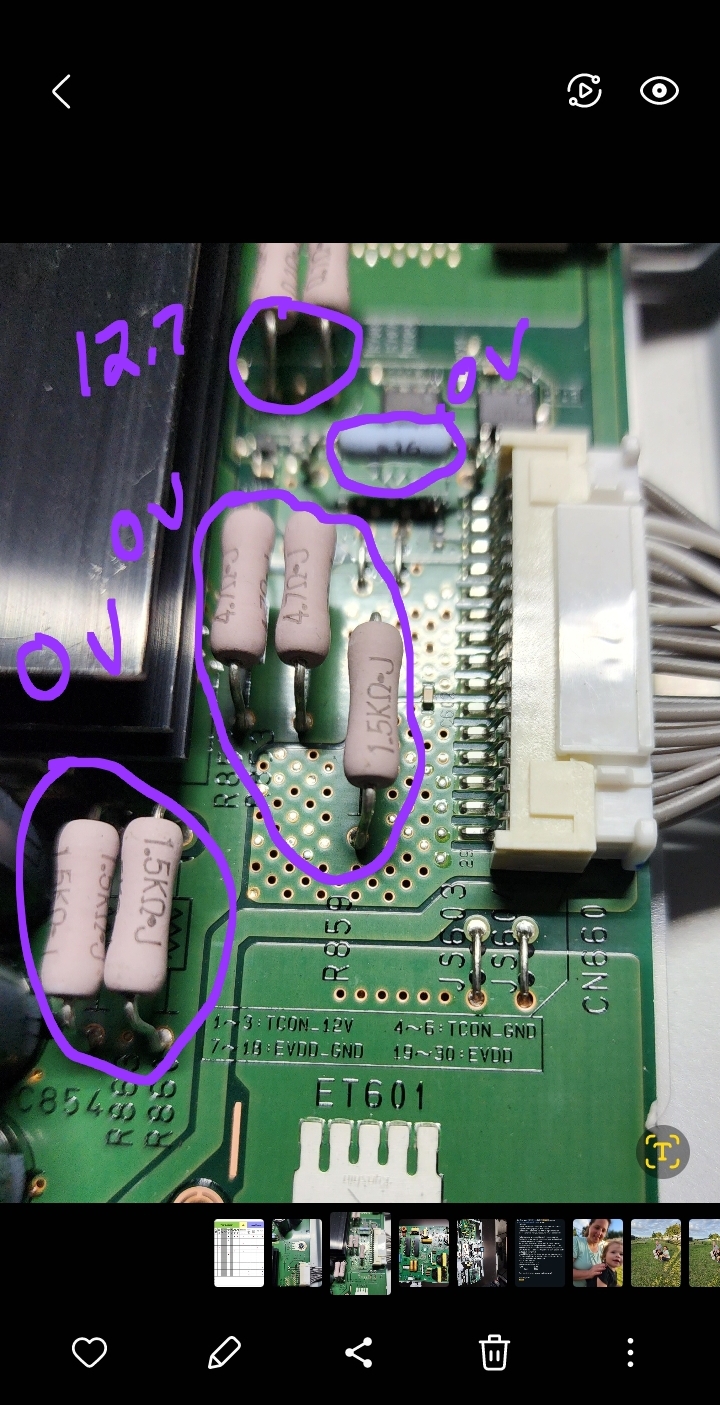

    Symptoms. Hit power, white light shows briefly and then 5 blink red code. TCON issue per chart on first picture.
    I'm thinking I have a power board issue though, which is one of the options
    Now to check pin voltages from PSU to main and PSU to tcon

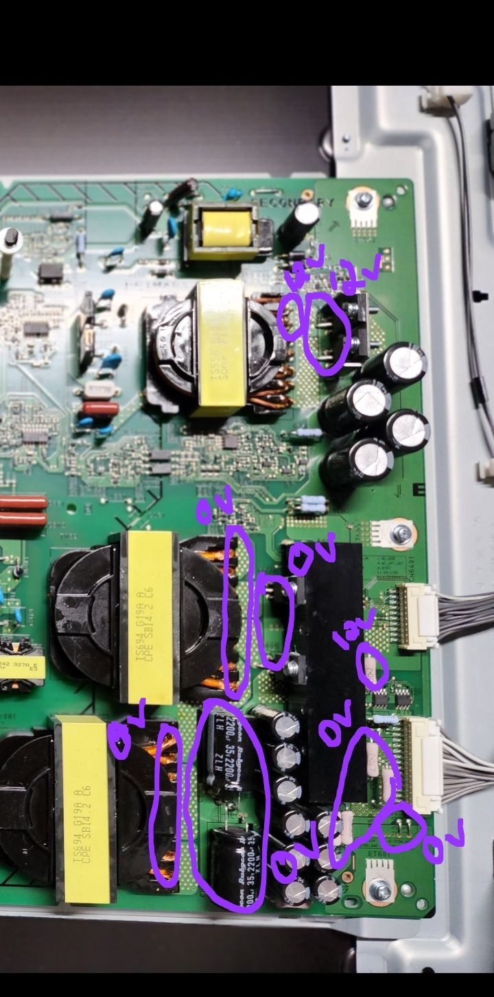

    Pic 2
    1 tcon on 12 -- 0v (when I hit power this goes to 3.1 stays for short time and back to zero)
    2 bl err -- 0.16
    3 evdd on --0
    4. Ac off det 3.187
    5 power on -- 3.362 BUT fluctuating randomly to 3.352
    6 stby 3.485
    7-13 gnd -- 0
    14-20 12.72

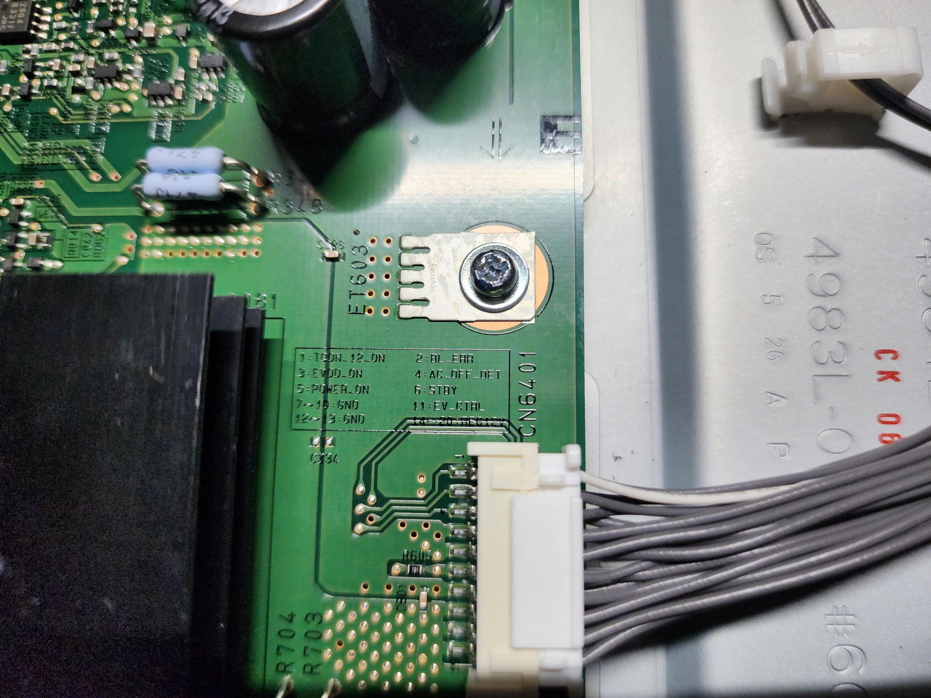

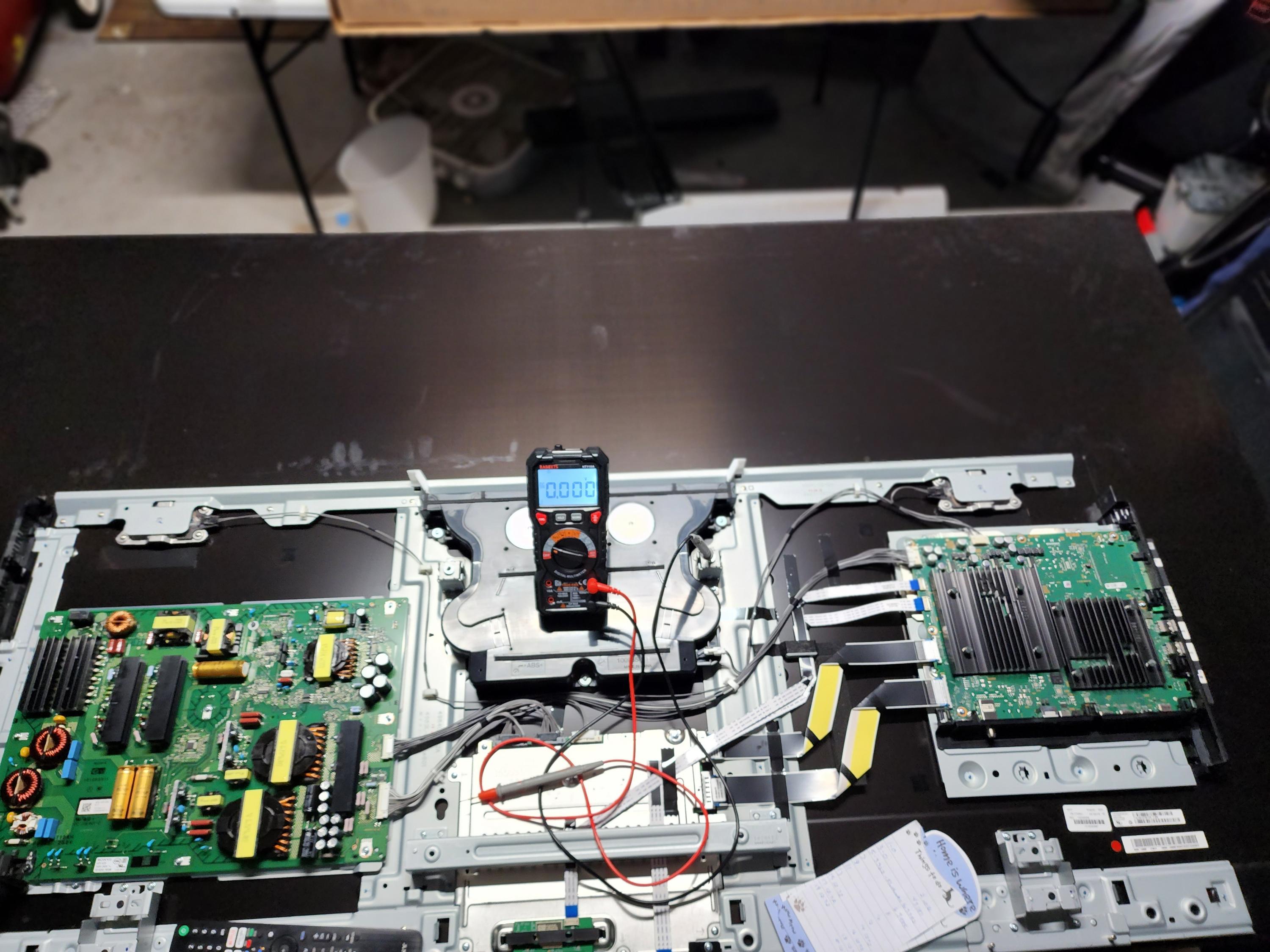

    PSU to tcon. Pic 3
    1-3 0v
    4-6 0v
    7-18 0v
    19-30 0v
    Seems I get no voltages to tcon board. In picture 3 I also circled some resistors I would think would get some sort of voltages but they get zero. Even after hitting power and tcon on to main board supplies 3.1v
    The main caps are at 380v all of them. The caps closer to the tcon connection never gets anything. As if they never turn on, even a residual voltage. Just zero always. Both PSU fuses are good.
    Am i going in the right direction here? Shouldn't I get some sort of voltages from PSU to tcon even if TV isn't turned on yet right?
    I have disconnected PSU to tcon to see if any voltages appear and they do not. Even after hitting power.
    Another note, the mosfets towards the top (cold side) read 12.7v like the 12v line, the mosfets at bottom have zero (haven't check after hit power).
    Any help would be appreciated.

        So I been thread searching. I was able to jumper evdd on, tcon on, power on to standby with main board disconnected. In doing so the power rail for tcon reads 12v as it should and the evdd reads 21v both steady. I did this without the tcon plugged into PSU. Then I plugged in tcon. TCON then gets 12v/21v at fuses and evdd area. I did this with OUT panel connected cause I didn't know if this could damage panel.
        Anyone can tell me if this would be okay to connect lvds cables and jumper all those things to test panel? If so what would happen if panel/tcon is good?.
        Guess I can rule out the power board.
        When I hit power (with everything connected normal) I assume the main board should send a signal to power board to turn on EVDD at 3v or something and it doesn't, it sents 3v to tcon on, 3v to power on and that's it.
        Could I even connect everything properly then jump the evdd on 3v to startup the tv? So many questions
        Any input would help lol, where's my Sony people at?

                        do the same you did above... LVDS shold be disconnected.... and the the panel should be in place..... see if your screen come clear color or with some green shadow.... show please photo of the result.
                        • Diah
                          • Feb 2013
                          • 6470
                          Re: Sony XR-77A80J OLED 5 Blink
                          of course the test above only PSU and T-CON and Panel module only connected,, no MB or LVDS
                            So the cables from tcon to panel are okay? But no cables from motherboard to tcon correct? Once you confirm, I will test. The tv is face down so I will pull it out a little bit and get a partial picture of screen if it works. But first confirm this is correct
                            • Diah
                              • Feb 2013
                              • 6470
                              Main boards disconnected from power boards....... LVDS between T-CON driver boards to Main boards... disconnect them from T-CON side, The panel should be connected with all ribbon to T-CON

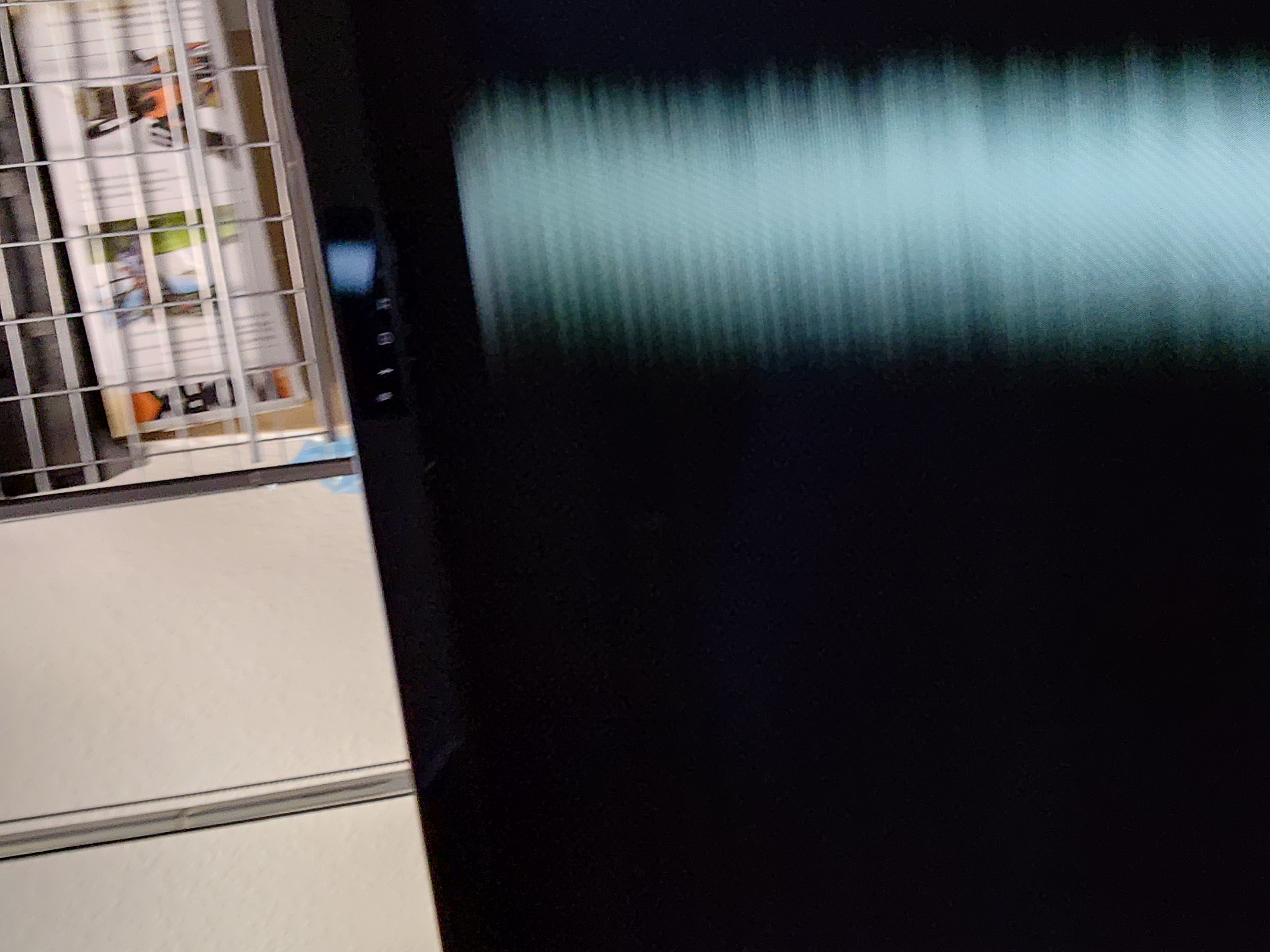

                                  Thank you, will post picture shortly
                                  • EazyBone
                                    • Jun 2023
                                    • 1356
                                    • United states
                                    This is what it shows. Shows like some green/red changes off to the right side. Then some of the screen shows white lines intermittent. The whole screen doesn't light up green or white. Picture is only of the right side (left if facing it).
                                    • Diah
                                      • Feb 2013
                                      • 6470
                                      keep it for long time... during its on with your finger Gently click on the white lines... and on dark side--- try to curve the panel from left & right side... so its better for you... let the tv standing on legs... screw thebT-CON to chassis and put back the heatsink and do it.. for long time.... any change at result report it..
