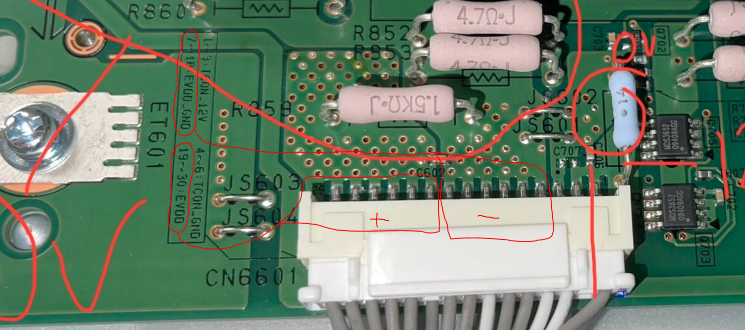

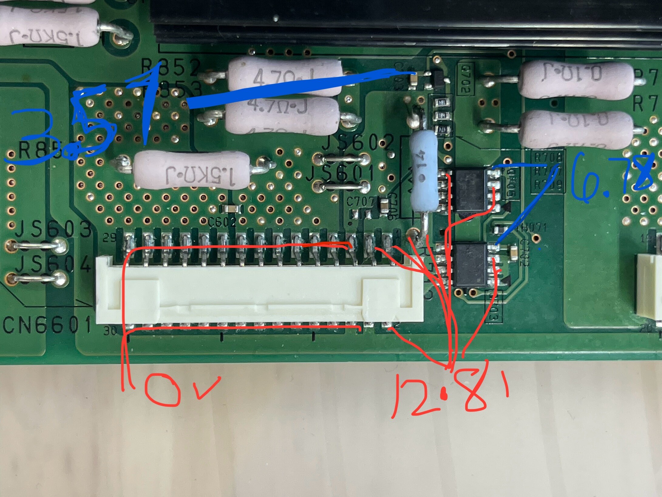

    Originally posted by Diah
    this rail pin 3 are EVDD which right now missing V on socket 6101, you need to follow the rail from pin 3 socket 6401 circuit till the optocoupler , there you have issue which the EVDD circuit didn't start
    Diah Here is the measurements that I see.
    • Diah
      • Feb 2013
      • 6470
      #102
      this is t.con 12V not EVDD
        What 12v, and what is this?
          Pin 19-30 on 6601 is getting 21.5v
          • Diah
            • Feb 2013
            • 6470
            #105
            bingo you have t-con 12V & EVDD.21V .. next step take all boards out for sale ..... yours Panel dead.
