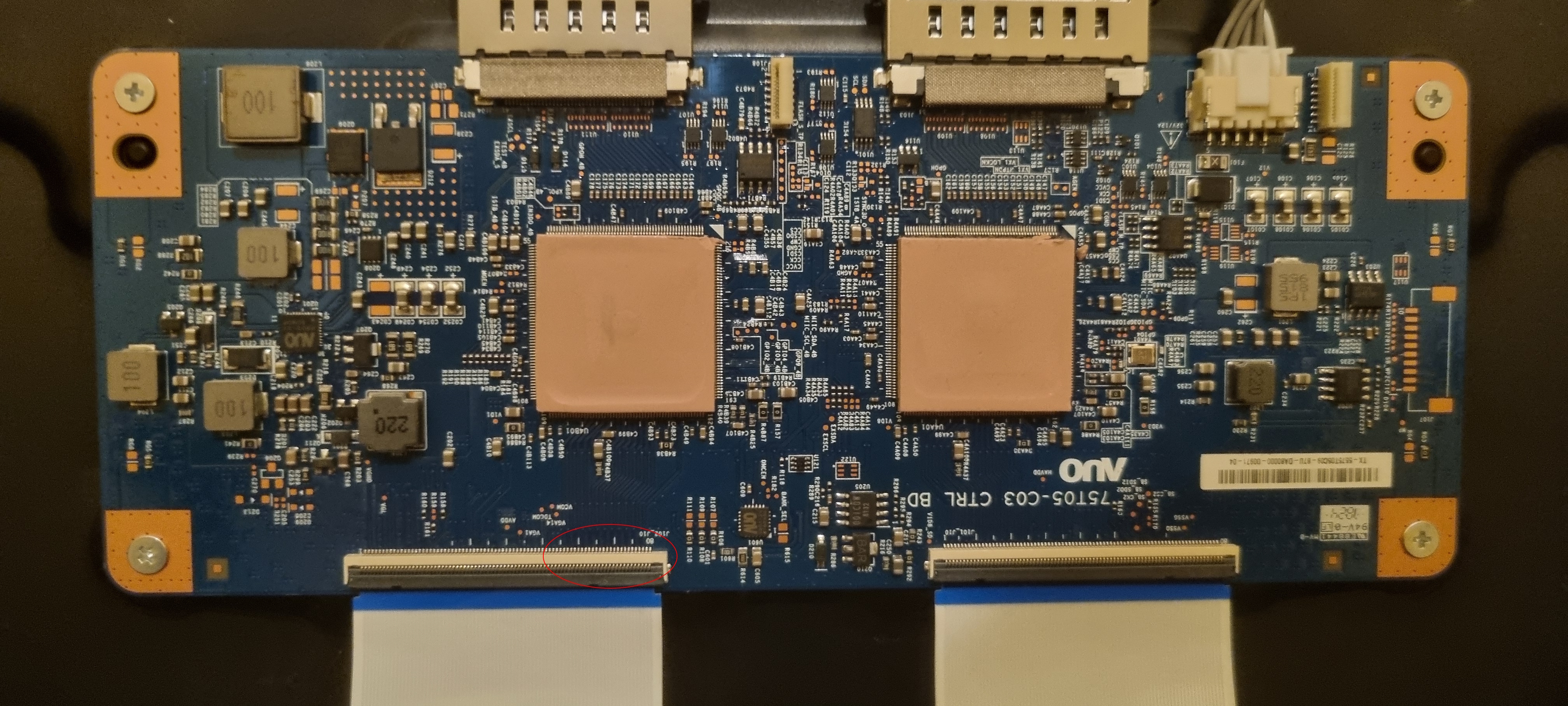

    i want to repair a Sony KD-75XF9005 TV that initially only showed a grey picture.
    Backlight seems to work, Sound (Setup menu after reset) works.
    If i dissconnect the left FFC cable from TCON to panel i have half a screen on the right. If left cable is connected always only the grey screen.
    Interchanged the cables, its always only the right side that is working. Always grey if left side is connected.
    With my small knowledge i would think at least the cables are good.
    Can this happen because of a bad tcon board?
    Or is it always a bad/shorted panel?

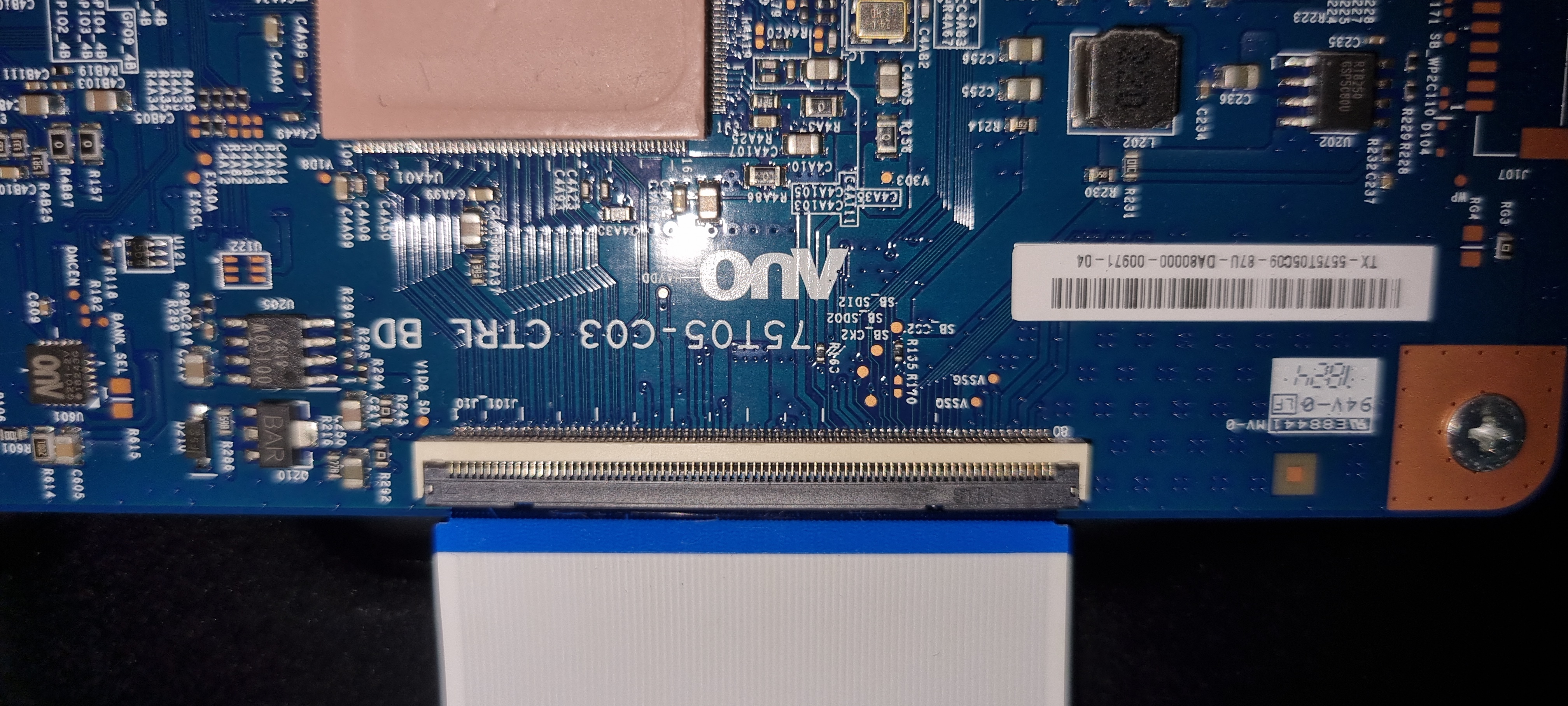

          Before i try the tape fix, is there any way to determine what pin is shorted (measurements with multimeter or oscilloscope)? Or even blow up the short with overcurrent so that is just a open line?
          And if i try the tape-fix, what lines should i tape?
          I would guess the pins towards the center of the pcb where all the traces go to the big chip (left side pin 80 and lower)?

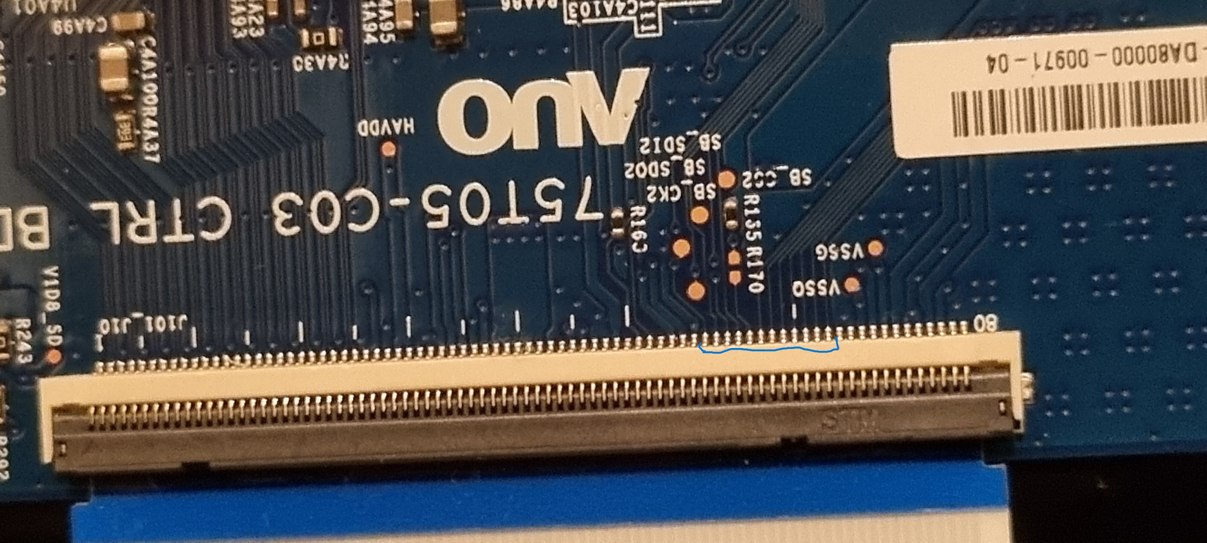

                    So i tried the tape method.
                    I doubted the right pins were on the right outside of the right connector, since the lines are kind of thick and marked with V...
                    So i masked 12 lines that looked right:
                    Wow, it worked, full screen visible. (and AVDD ob both connectors now 15V, before only 15V on both when only left connector was connected and half screen was visible)
                    I then unmasked one after the other of the 12 lines, (off course turned off TV each time.).
                    Even after unmasking all lines Picture stayed full screen.
                    Wow. Put TV together, powercycled a view times, all good.
                    After half an hour exact error like before.
                    Full grey screen until i disconnect right cable from tcon to LCD, then half screen worked.
                    Was it a coincidence? Did i even masked the right CLK lines?
                    Can anyone take a guess where the CLK lines are? Shouldn´t it be 8 instead of 12?
                    Here another picture:

                            • angelos
                              • Dec 2012
                              • 573
                              • South Africa
                              Check my photo. I think there where i boxed it in red is where you need to play around.
                              Regards
                              • iglitare
                                • Oct 2017
                                • 12
                                • germany
                                Regards
                                Thanks. That was the area I taped.
                                But as I said, after taping, picture looked OK, untaped the pins one by one an after unmasking all, picture stayed OK for half an hour. Then all grey again.
                                I think I try it again.
                                Strange thing was, even with these 12 lines taped picture looked not distorted, no lines, it looked perfect.
                                Can that be? I would have expected a bad looking picture when all lines are taped.
