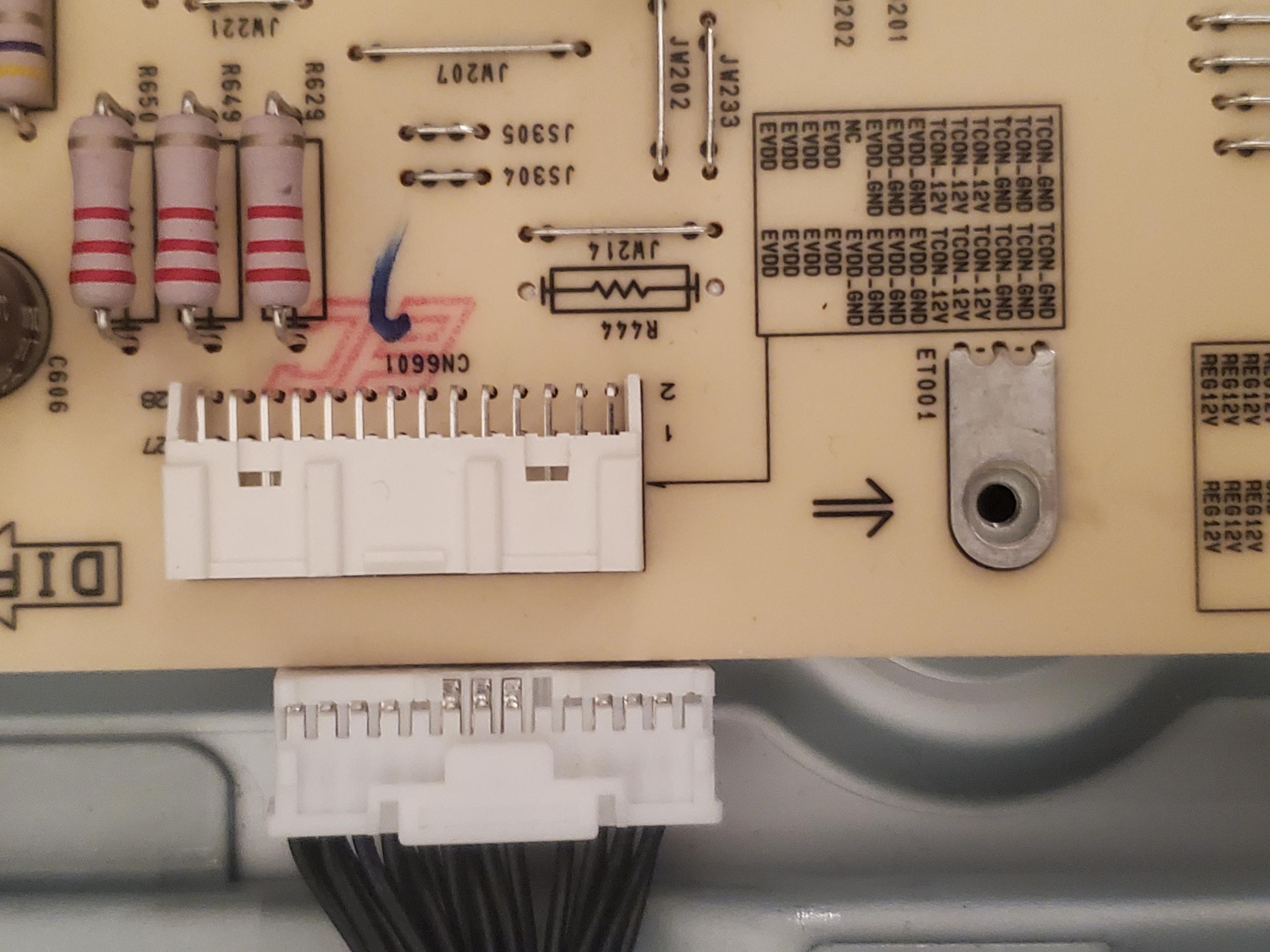

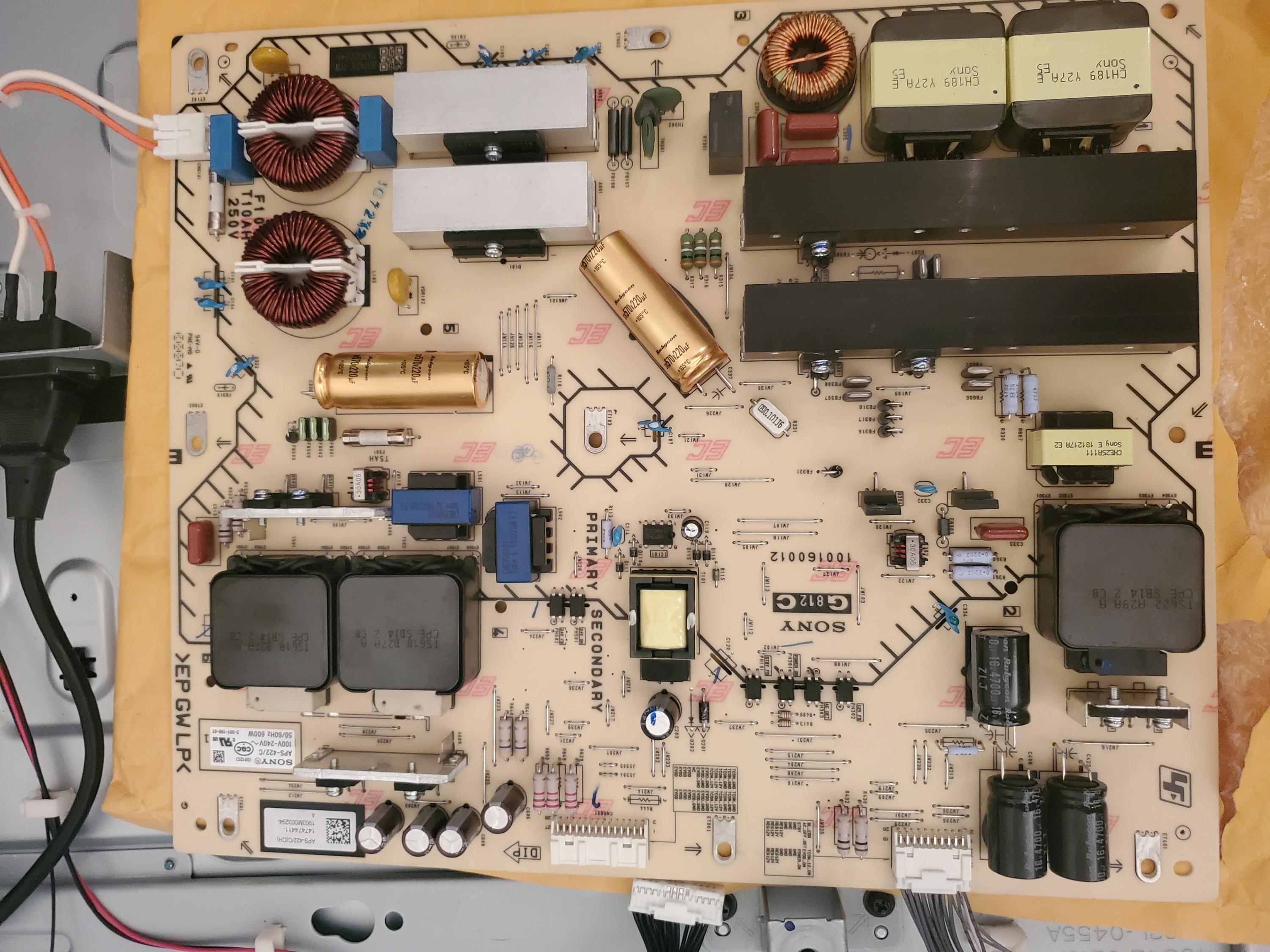

    Hi, I bought a defective OLED Tv thinking I would just replace the defective board and make it work. The problem was that the TV would turn on with sound but no image. I replaced the TCON first, didn't do anything so I replaced the main board and psu boards too but to my surprise the problem is still there.
    So I began testing the PSU to see if at least all voltages were good. What I found is that all the voltages seem good (standby, AC_On, TCON_12v and PWR_On). The missing voltages seem to be EVDD and I'm not sure if BL_ERR should be high or low and if EVDD_ON should be just a pulse or a steady 3.3v.
    The EVDD is present for a second, when the tv turns on (there is a relay that clicks) but then it vanishes.
    I think that if I can find why this voltage dissapears (maybe there is a bad cap or short circuit?) It would fix that black screen issue.
    I don't have the service manual which would be very handy so any help is appreciated.
    here's a picture of the power supply.

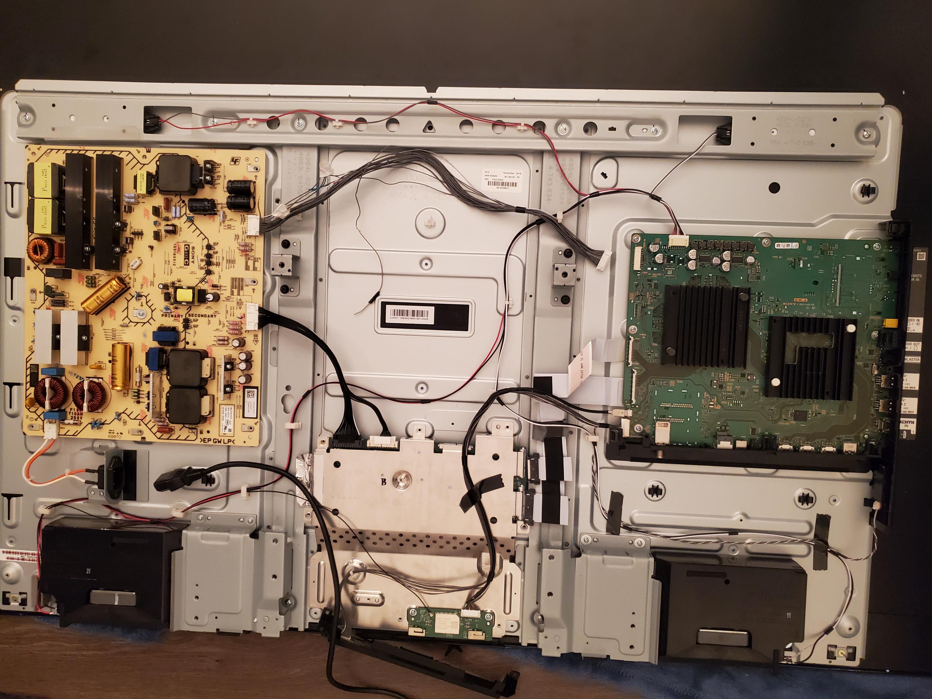

    Also, some images of the entire back of the TV showing how all the boards are connected would be helpful.

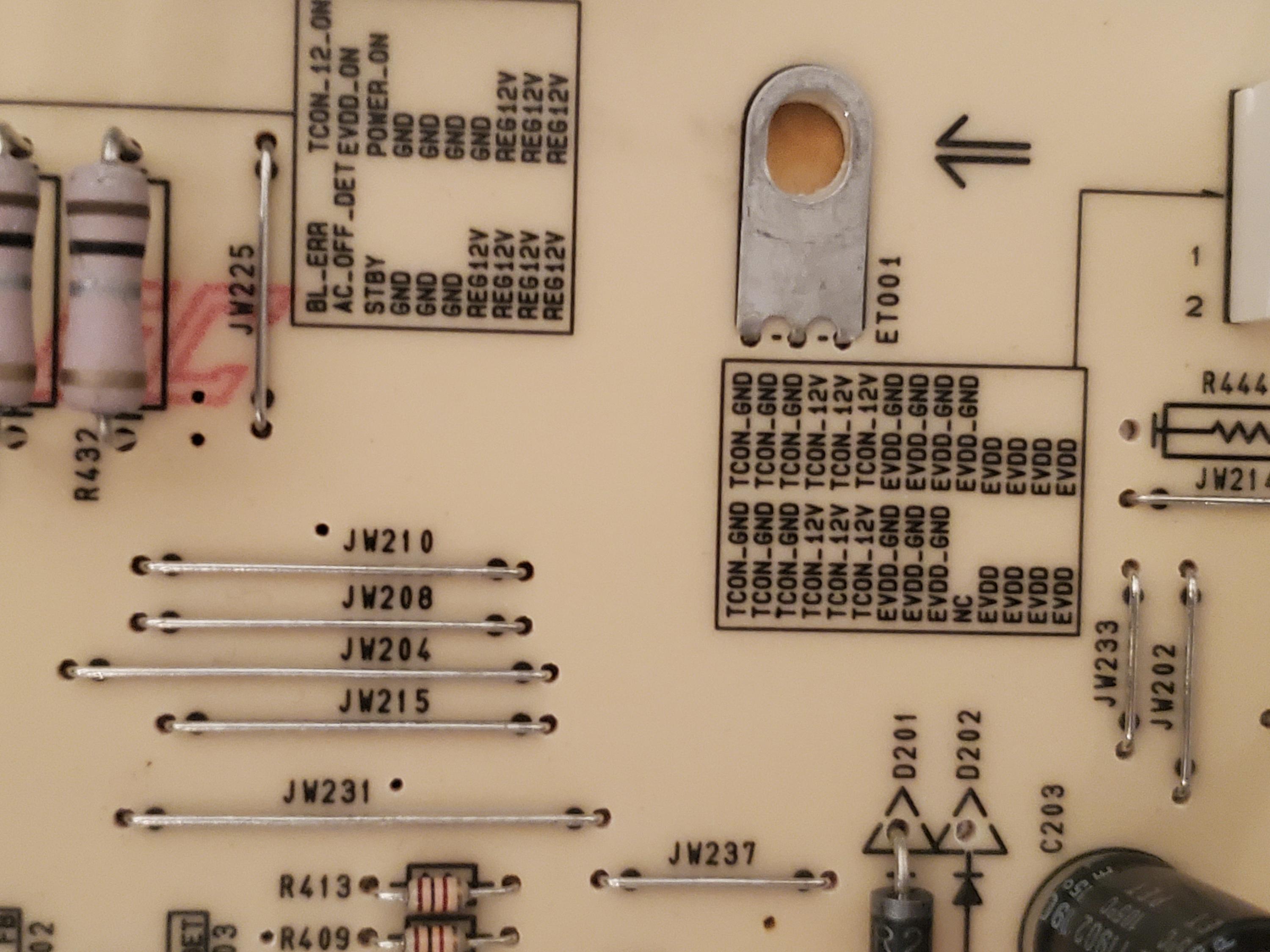

      first test:
      could you put back all the original boards in place.. and turn it on as you wrote you have sound.. write yours measurements of DC V on the T-CON side reference to TV chassis
      1- EVDD Socket ( black color ) on 2 Fuses from both side
      2- VIN Socket ( white color ) on both side of Fuse F1
      upload photo of the whole back side of the set . to see all boards connected together.

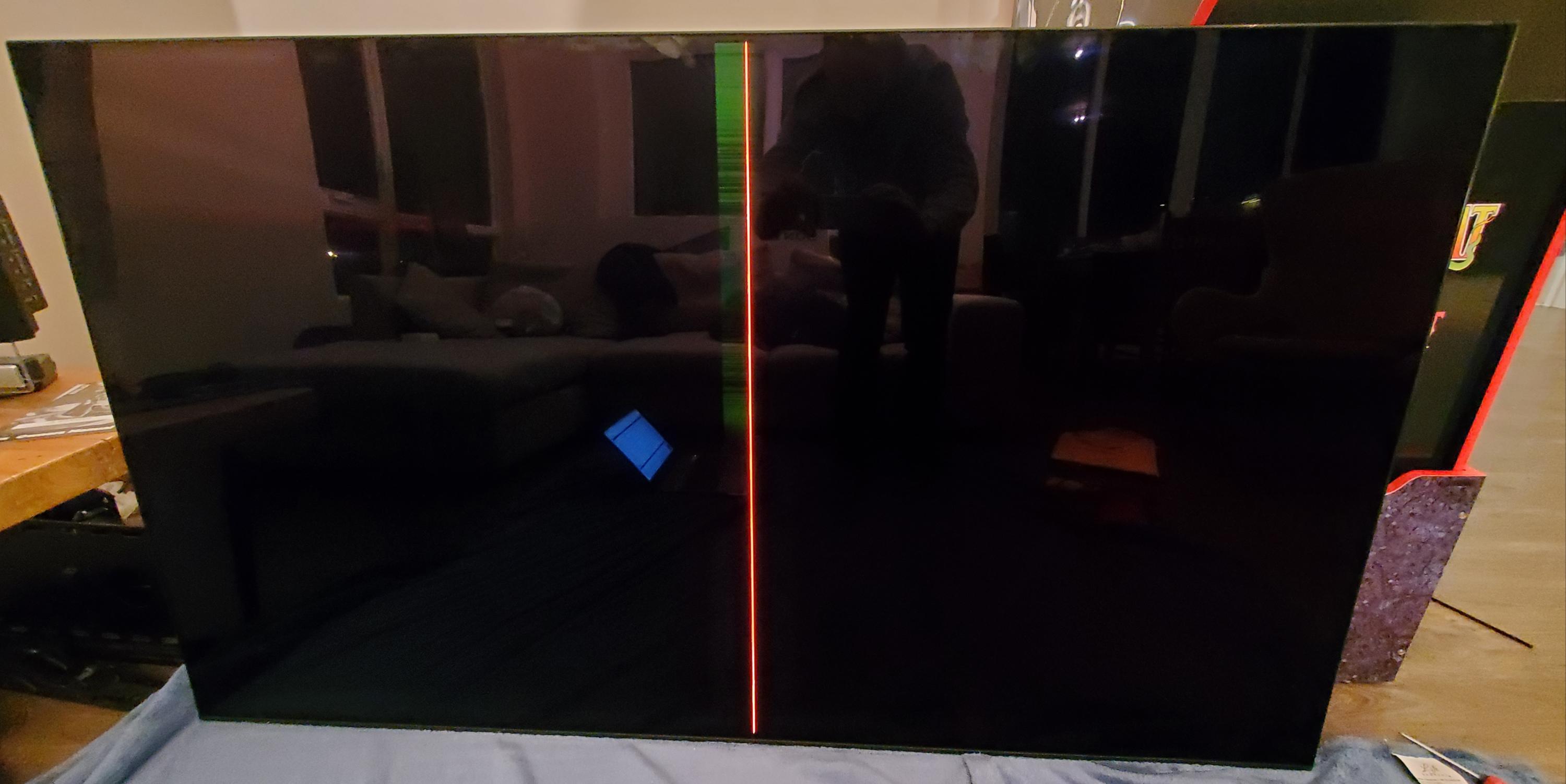

            Thanks for the detailed walkthrough Diah, this is exactly what I wanted to do but somewhat wasn't able to achieve (testing boards individually).
            So I bridged the pins with the standby voltage and got the right EVDD and TCON voltages. I then plugged in the VIN and EVDD cables in the TCON and got that weird red line on the screen instead of the color test.
            Bad panel?

              early to judge on the panel.. fault T-CON could cause this lonely line.

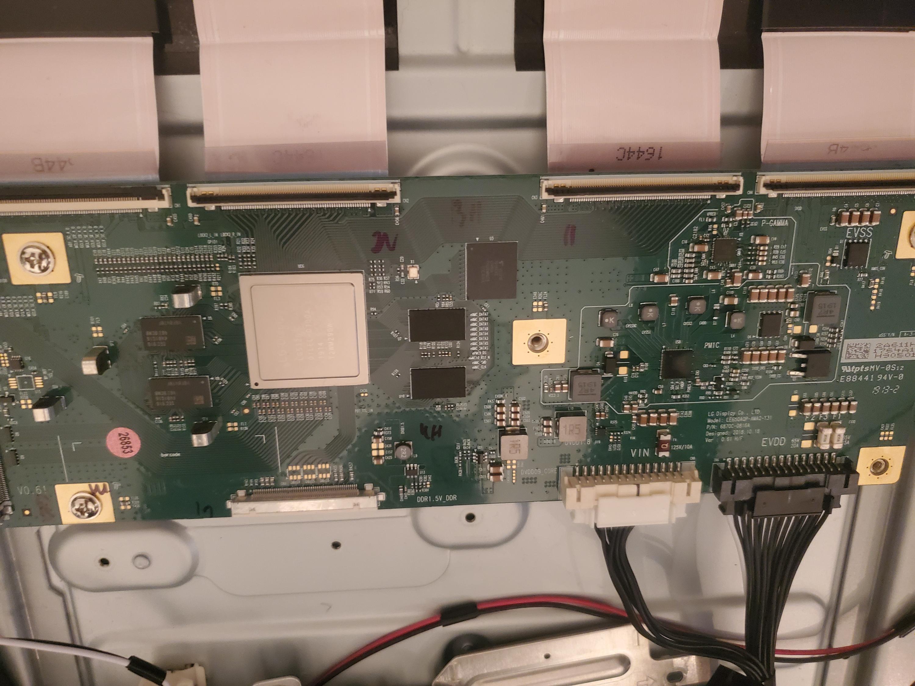

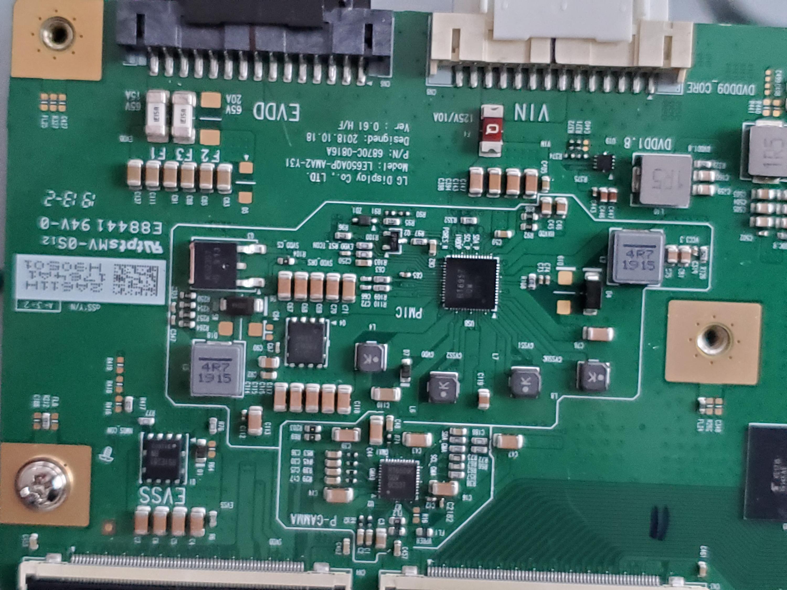

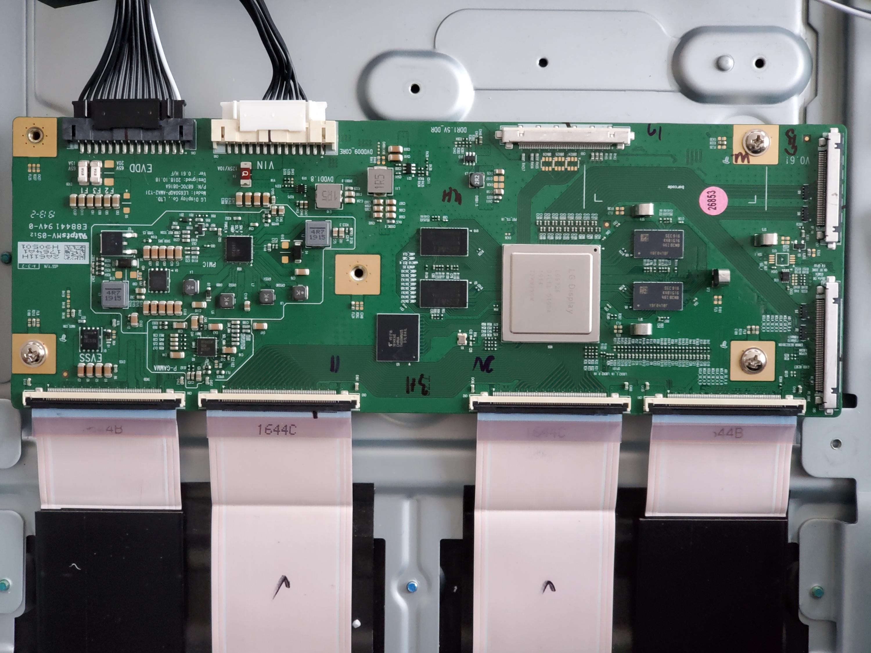

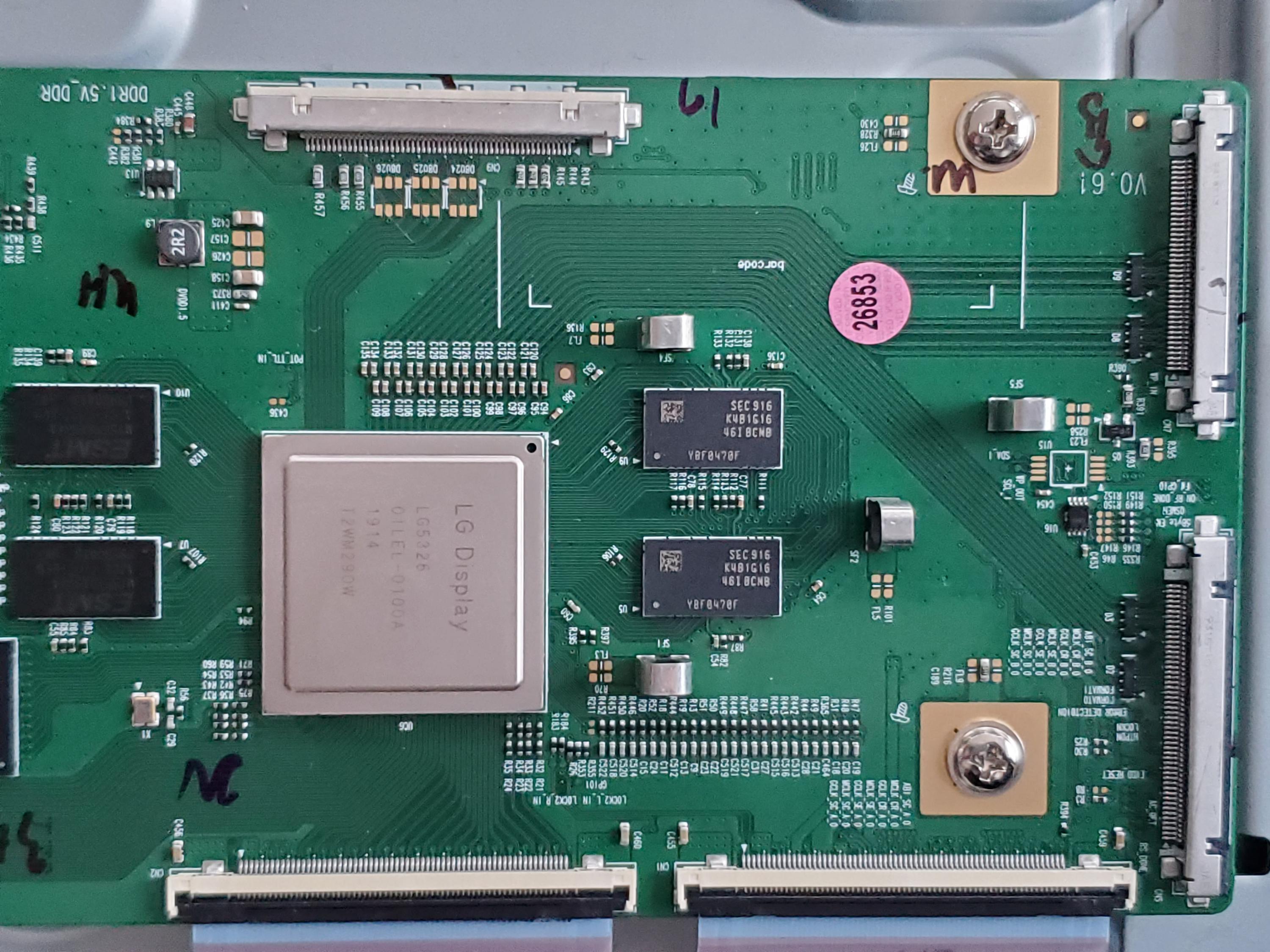

              upload focused high resolution photo of yours t-con

                Re: Sony OLED XBR65A8G no video, PSU problem?
                The two fuses on the EVDD side have 22.06V on both sides and the VIN fuse is 12.5V

                            you can try heating the main IC of T-CON and iC U3 heat them very well with hot air gun... and check only with test bridge to see if the screen became full display
                            just for warning.. dont heat them and the set in stand position LOL... put the t-con out side on surface and dont move it until they cool down

                              Thanks, replacing the T-CON is the first thing I did when I got the TV and it didn't fix the problem. I'm really afraid that it's the screen that's defective, can you think of anything I can do to confirm it's the TCON and not the OLED panel itself? I'd order another TCON but I feel it's going to be another 100$ thrown out the window.
                              *** I tried heating the ICs without luck

                                then dont... but the panel and t-con at stand alone test showing the line... are you saying when it turn on and can hear sound you have the same line on the screen??? or blank or dimm
                                did you have access to the panel edge boards for more checking ?

                                  When I turn on the TV, I get the red line in the middle and I can hear the sound (music from demo mode). It's the same red line that i get in the standalone test.
                                  I can dissassemble some more parts to get access to the edge boards I guess, just let me know what to look for

                                      Ah! Sorry, I thought I mentionned it: when I turn on the tv there is the thin red line for a second (while EVDD is present) and then it dissapears when EVDD goes away and the screen is all black and I can hear the sound. I felt it was a psu problem too.
                                      I'll take everything apart and let you know if i see anything.
                                      **any way to show me what you mean by edge boards?
