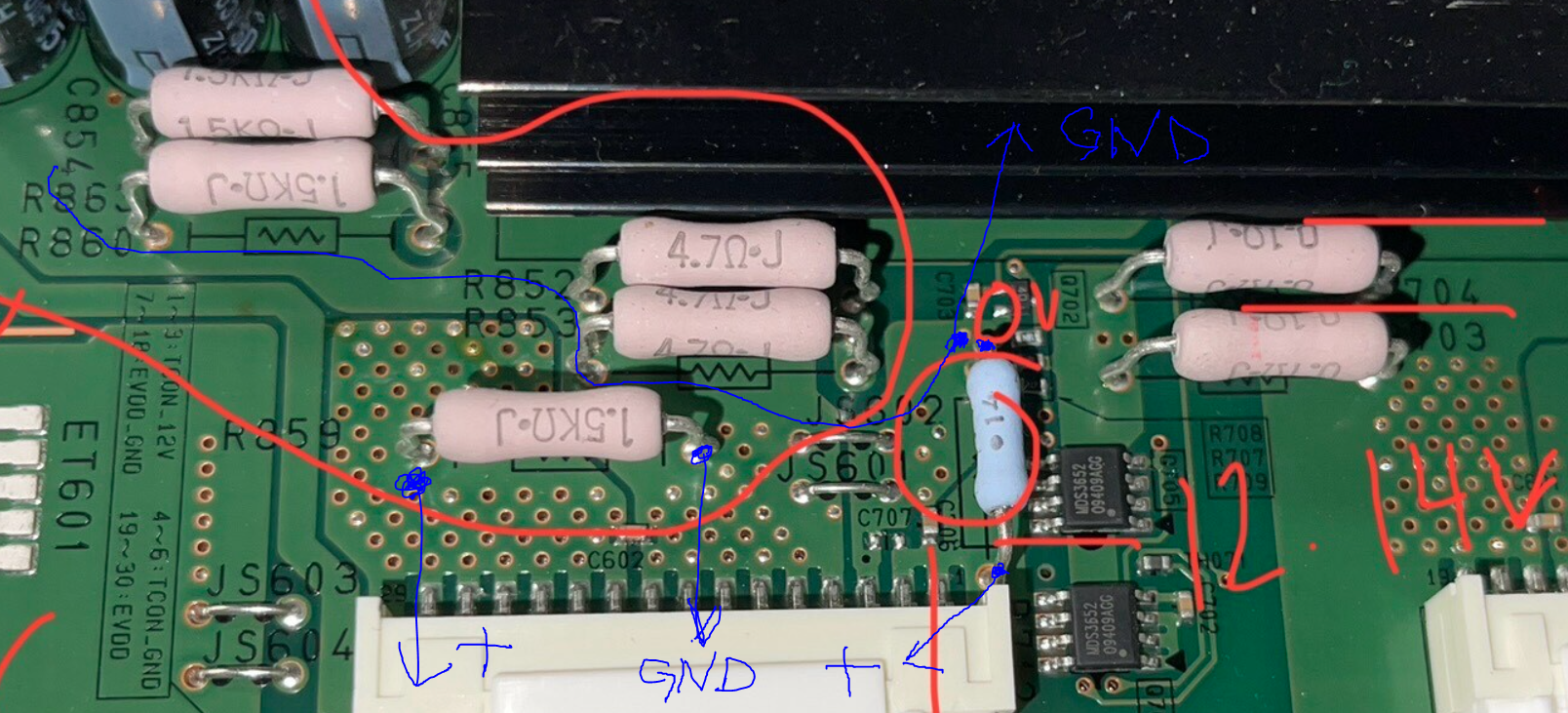

    Originally posted by ChattFix
    I noticed that R712 does not have continuity, is it supposed to have continuity? R712 also flashes 12v on one side for half a second.
    These are load, kilo-ohm resistors, one terminal is on ground, the other on +.
      lotas thank you for that clarity. The other kilo-ohm resistors have continuity so it confused me. So I'm assuming that is good so I need to start working backwards.

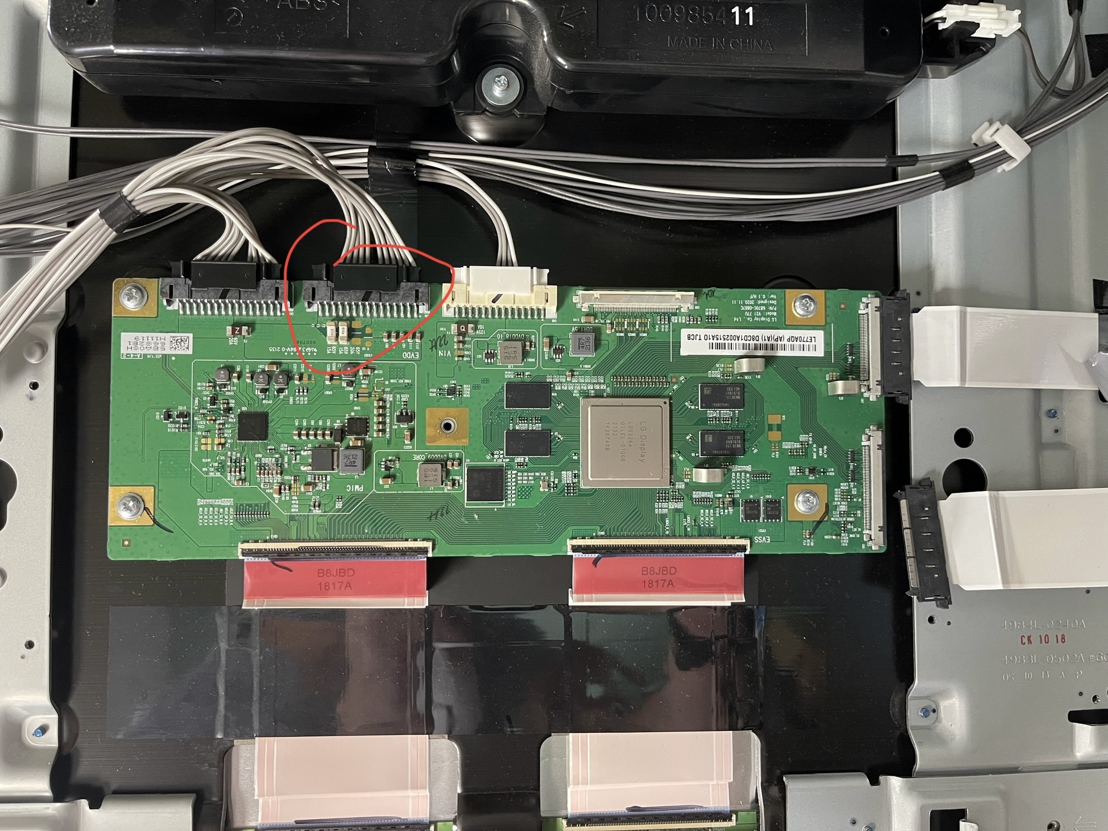

            Originally posted by Diah
            dont miss with PSU,, you have SOS signal coming so the MB turn off t-CON 12 & EVDD, to work around
            try
            1- disconnect the socket of EVDD only from the T-CON driver boards then turn on..... yours sign TV start the audio Optic output lit red
            2- if No 1 didnt help... put back the EVDD plug in place. and just disconnect the lower LVDS from T-CON and turn on check same sign on MB
            Forgive my ignorance Diah is this is incorrect. When I unplug the circled socket (I'm assuming this is the EVDD) I get the same result.
            When I disconnect the LVDS from the T-CON (see picture) boots and I hear audio.
                          stay at points 2 now.... and measure the EVDD 2 black sockets at T-CON and the T-CON 12V ( white socket)
                          I'm not getting anything from the three sockets connected to the T-CON board. I disconnected the LVDS from the MB as well, thanks for that.
                            you said TV booted and you hear sound... so it mean MB send to PSU t-con 12 on and evdd on
