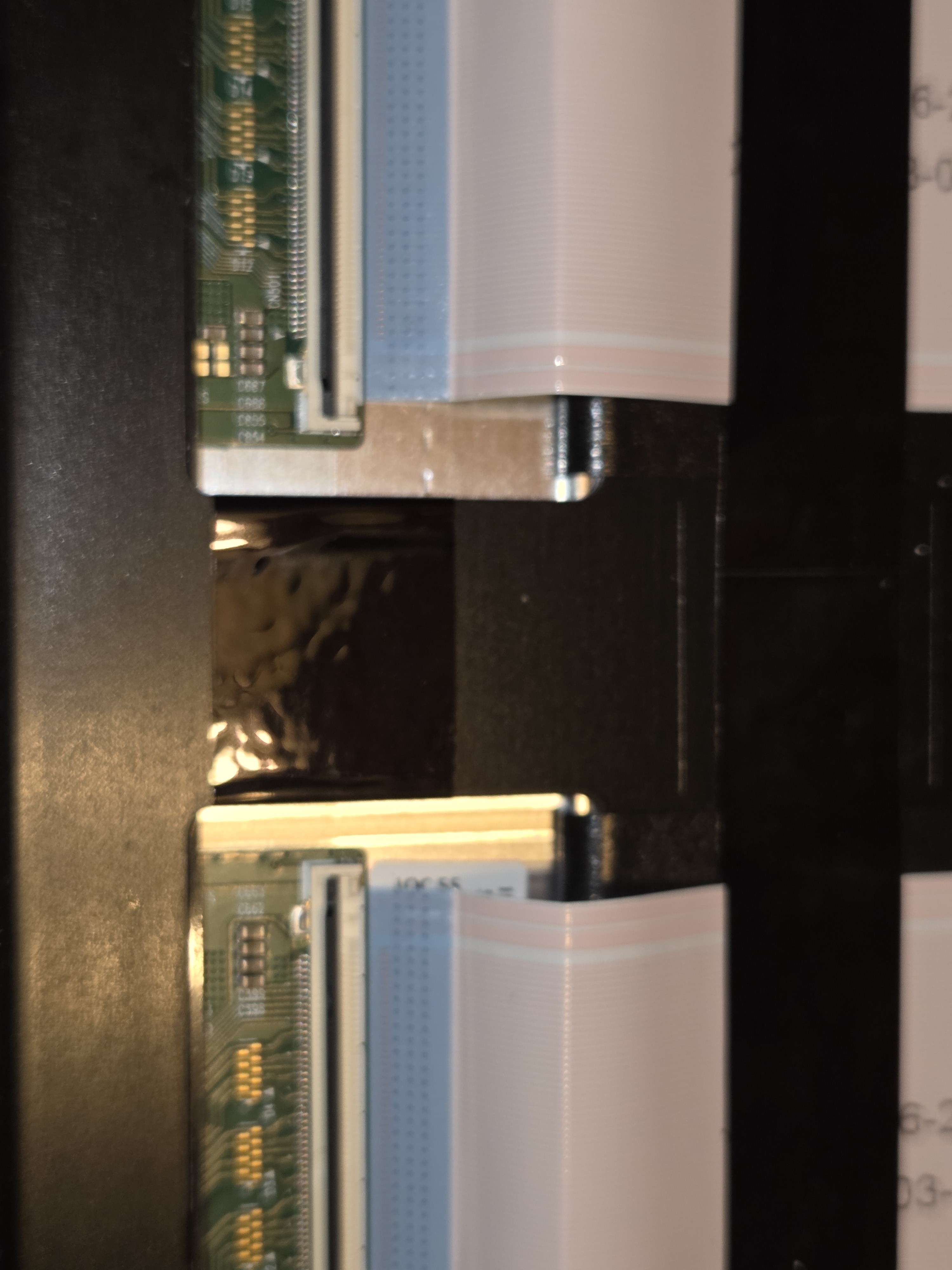

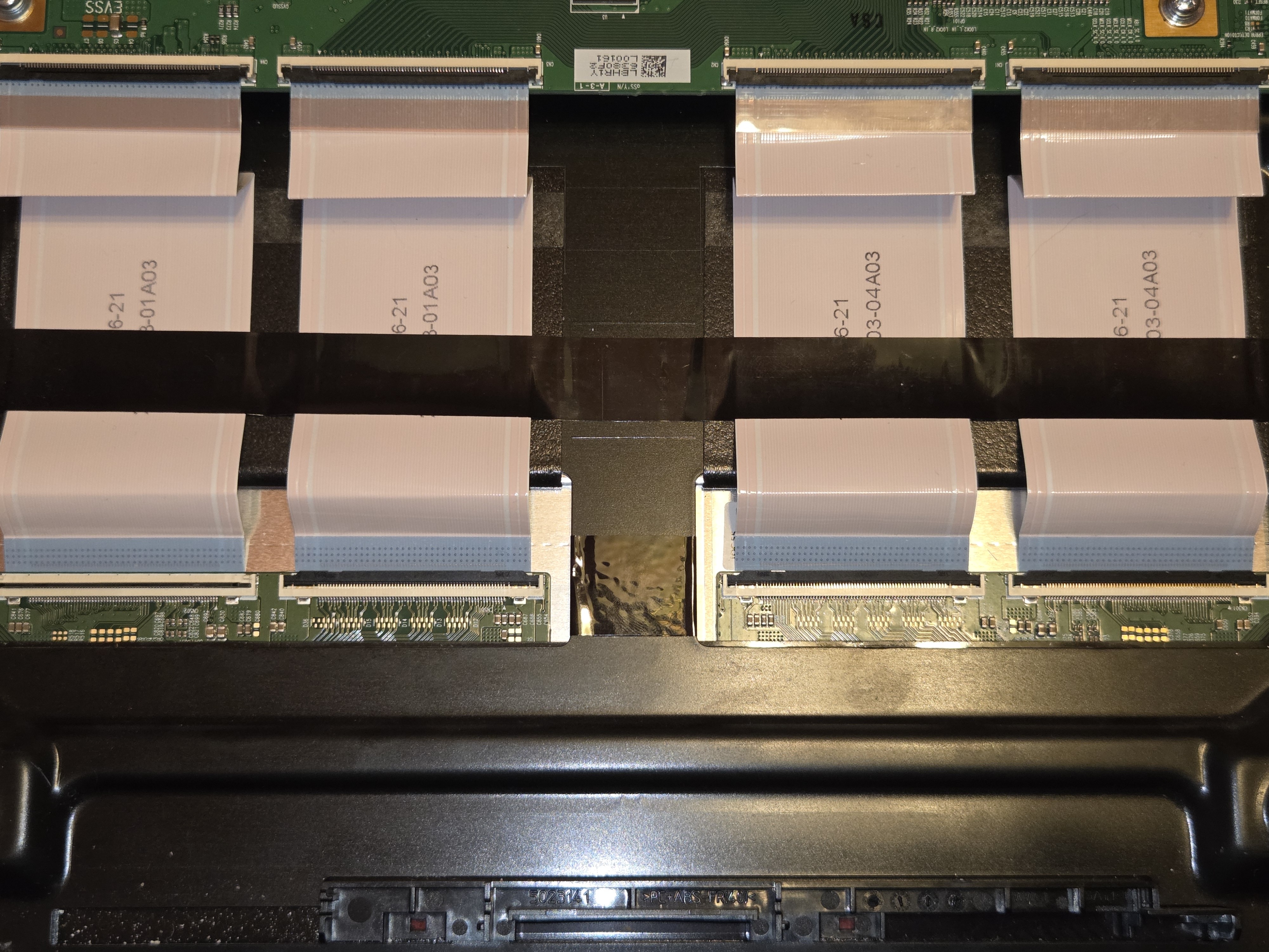

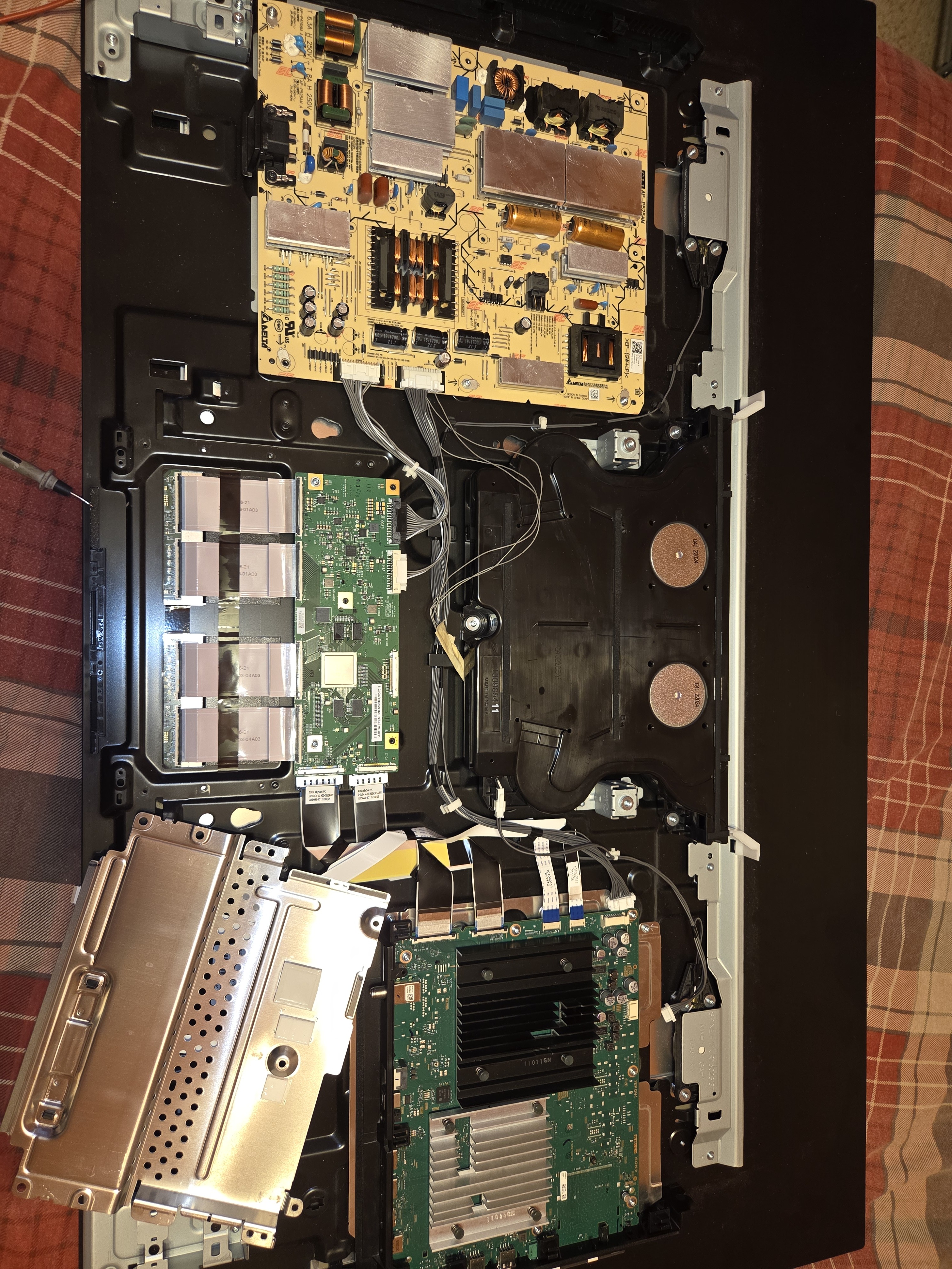

    Hi there,
    I see a couple of posts related to the troubleshooting of similar TV. The one I have is acting slightly differently and I'd love your help.
    So it has the 5 blinks. Previous owner got a TCON, no luck. Got a new Main board (though he didn't do the USB firmware update), again, no improvements.
    I see 2 posts that are relevant:
    https://www.badcaps.net/forum/troubl...j-oled-5-blink
    https://www.badcaps.net/forum/troubl...grade-possible

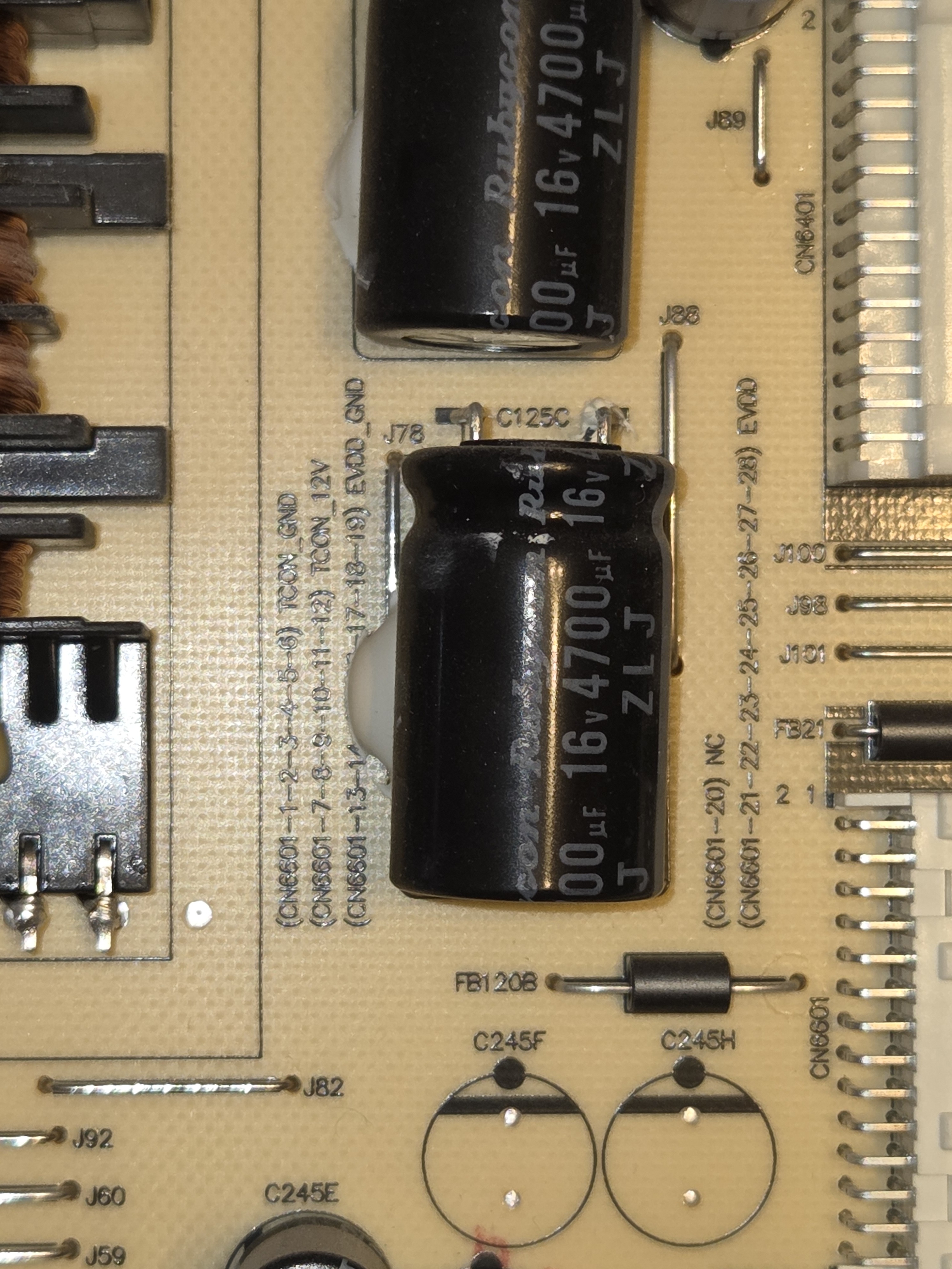

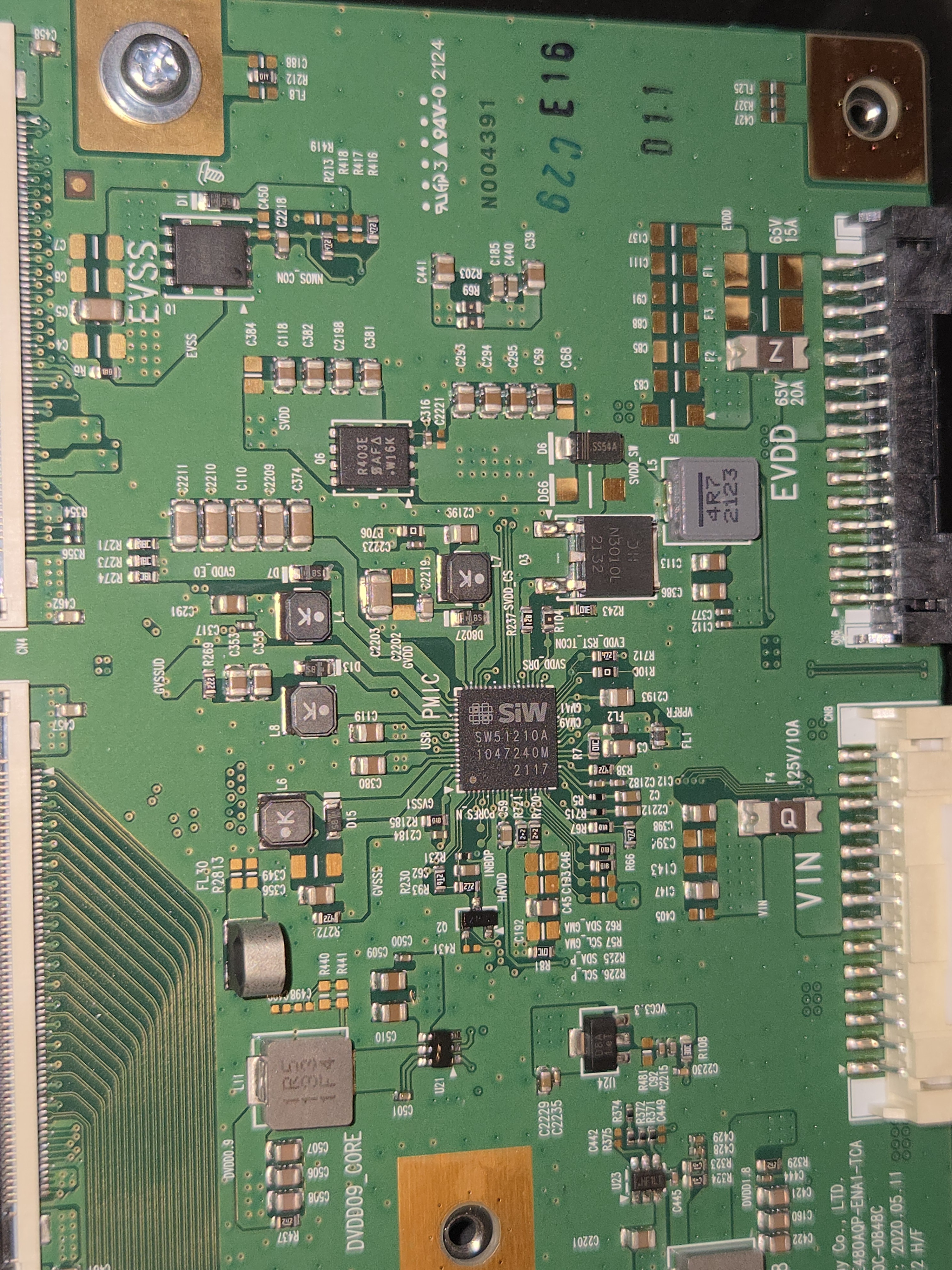

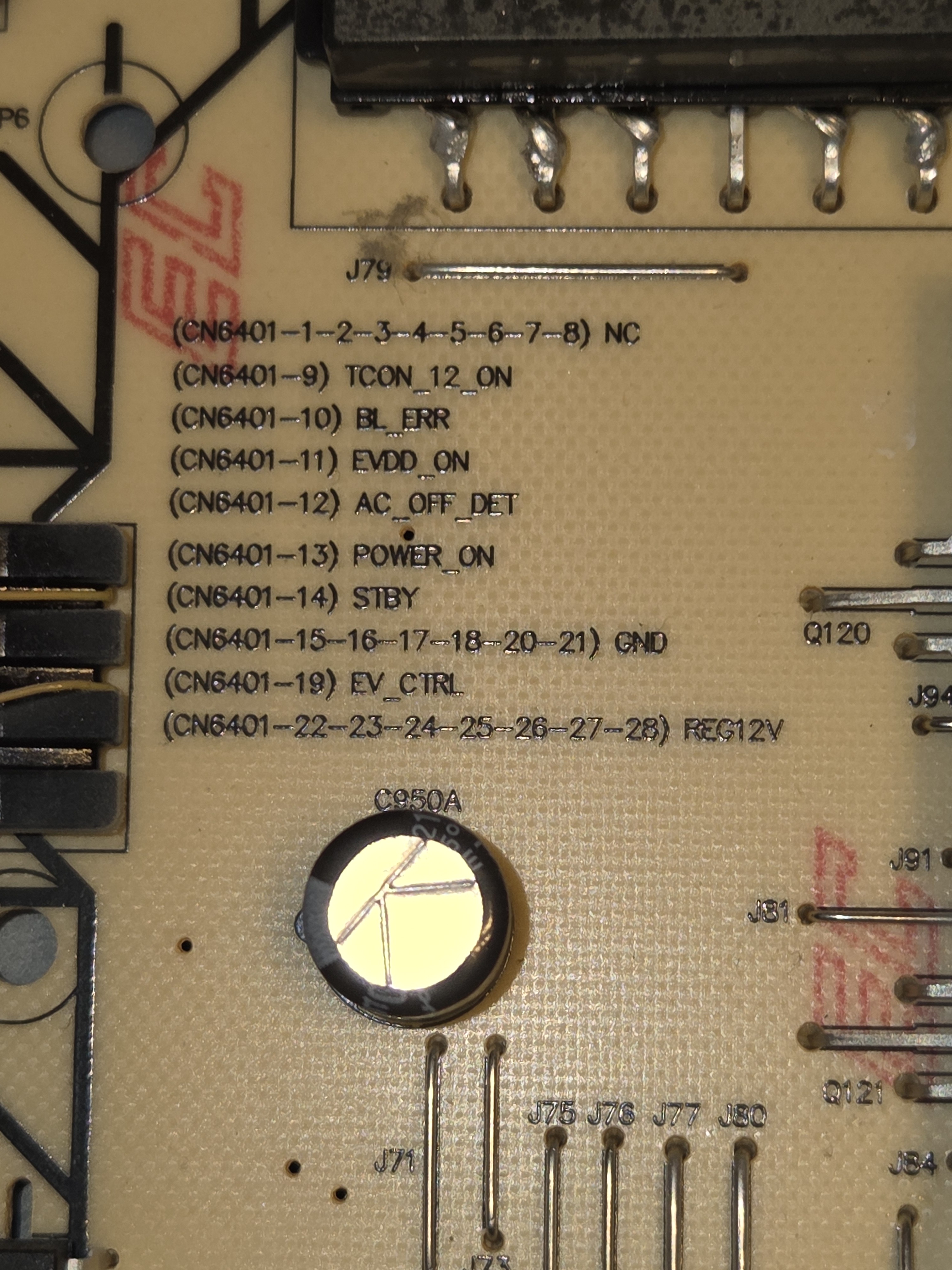

    So I disconnected the Main board from the circuit. Added a jumper between PWR_ON, TCON_12_ON and EVDD_ON and STBY
    Now all I get on the screen is backlight (screen lit up) but no colors on the screen.
    The EVDD on the TCON is 18.8 V
    The TCON_12 is 12.76 V
    Note that with TCON disconnected, the above voltages don't change much.
    I saw in other posts that EVDD should be higher? but I don't know maybe the 55" (Smaller) can live with lower voltage?
    Any suggestions on how to proceed?
    Thank you

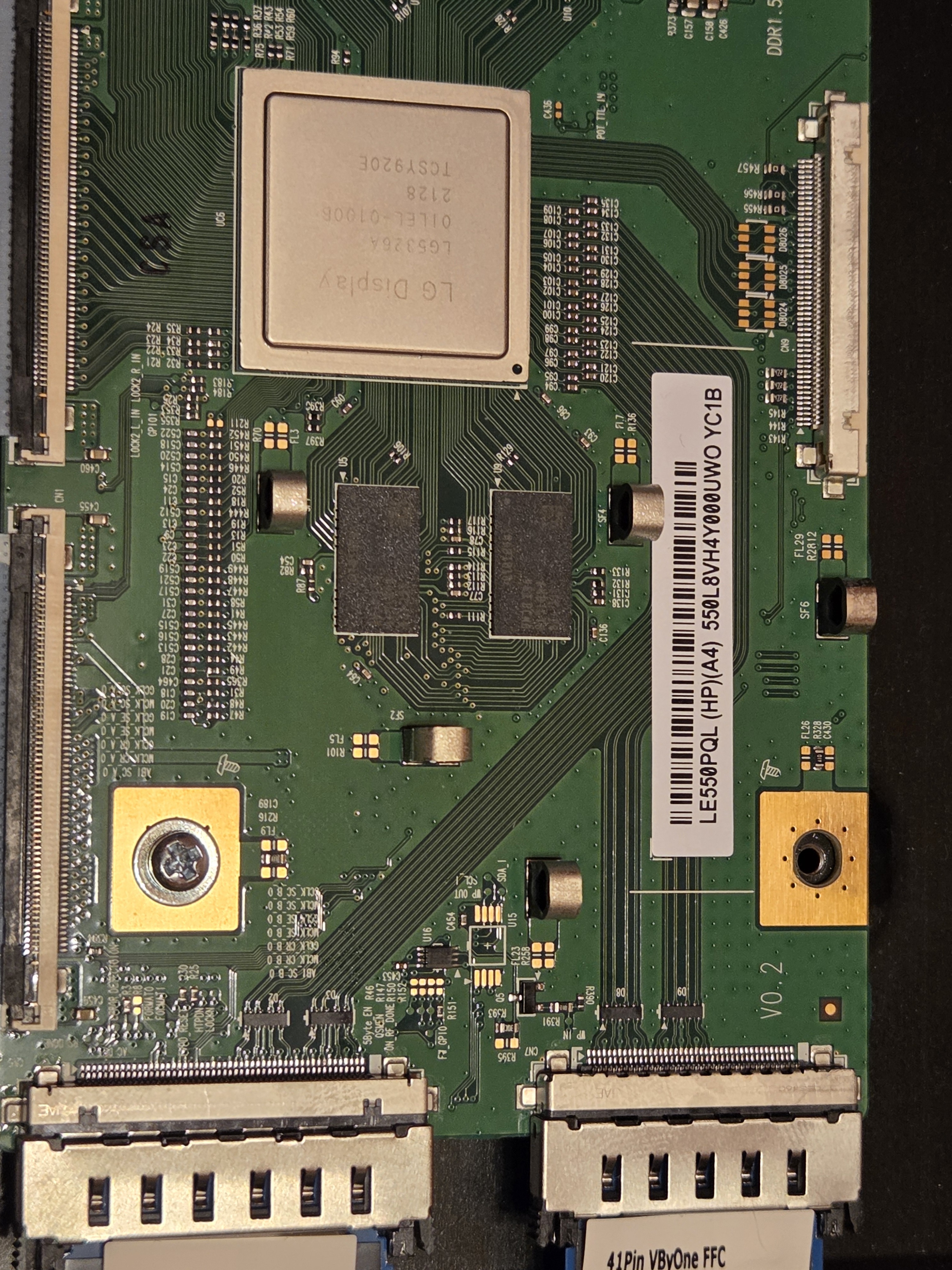

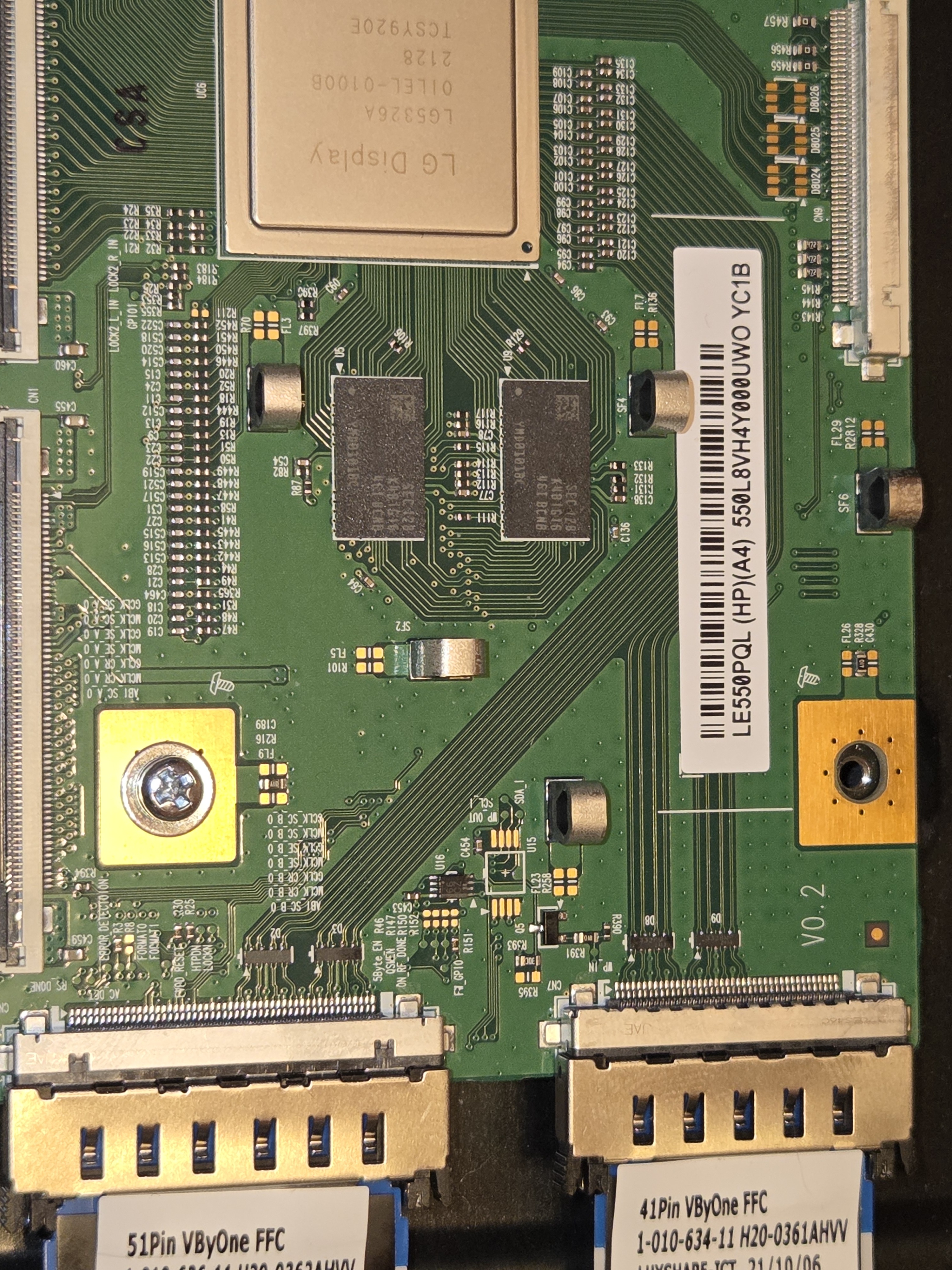

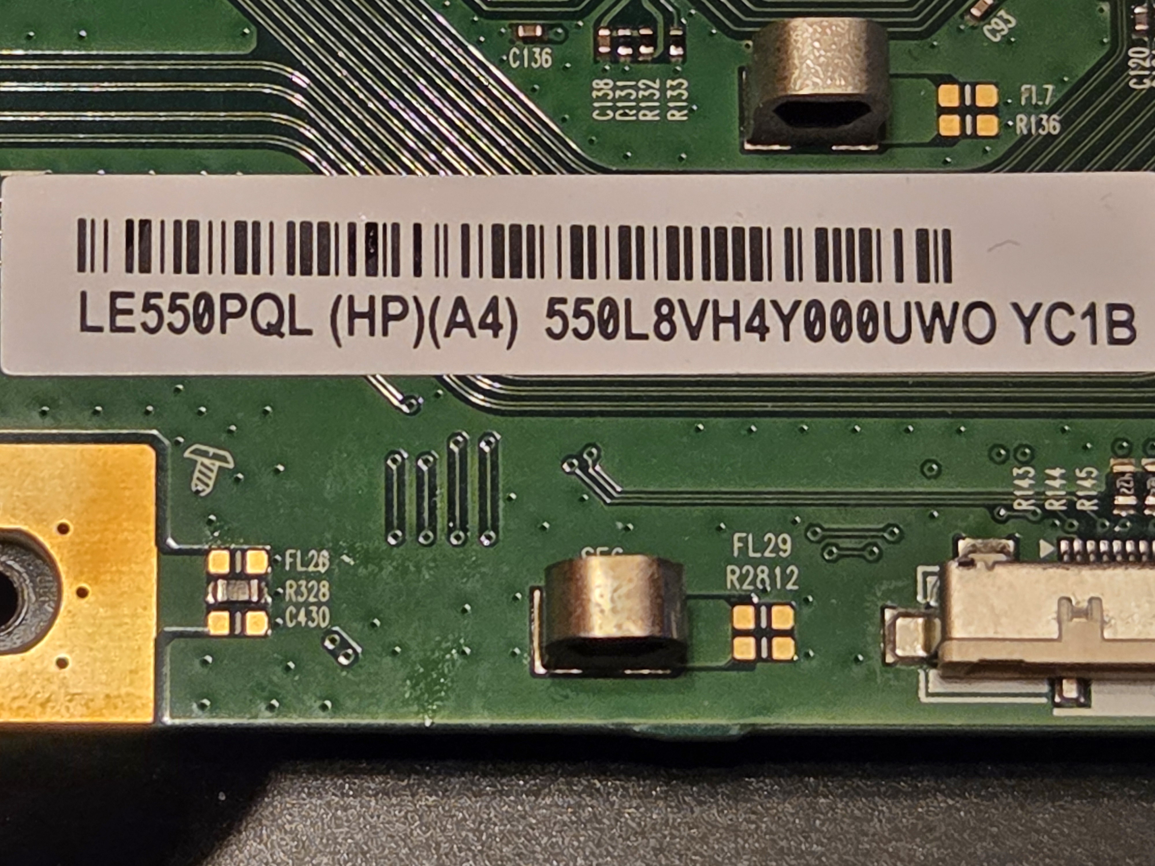

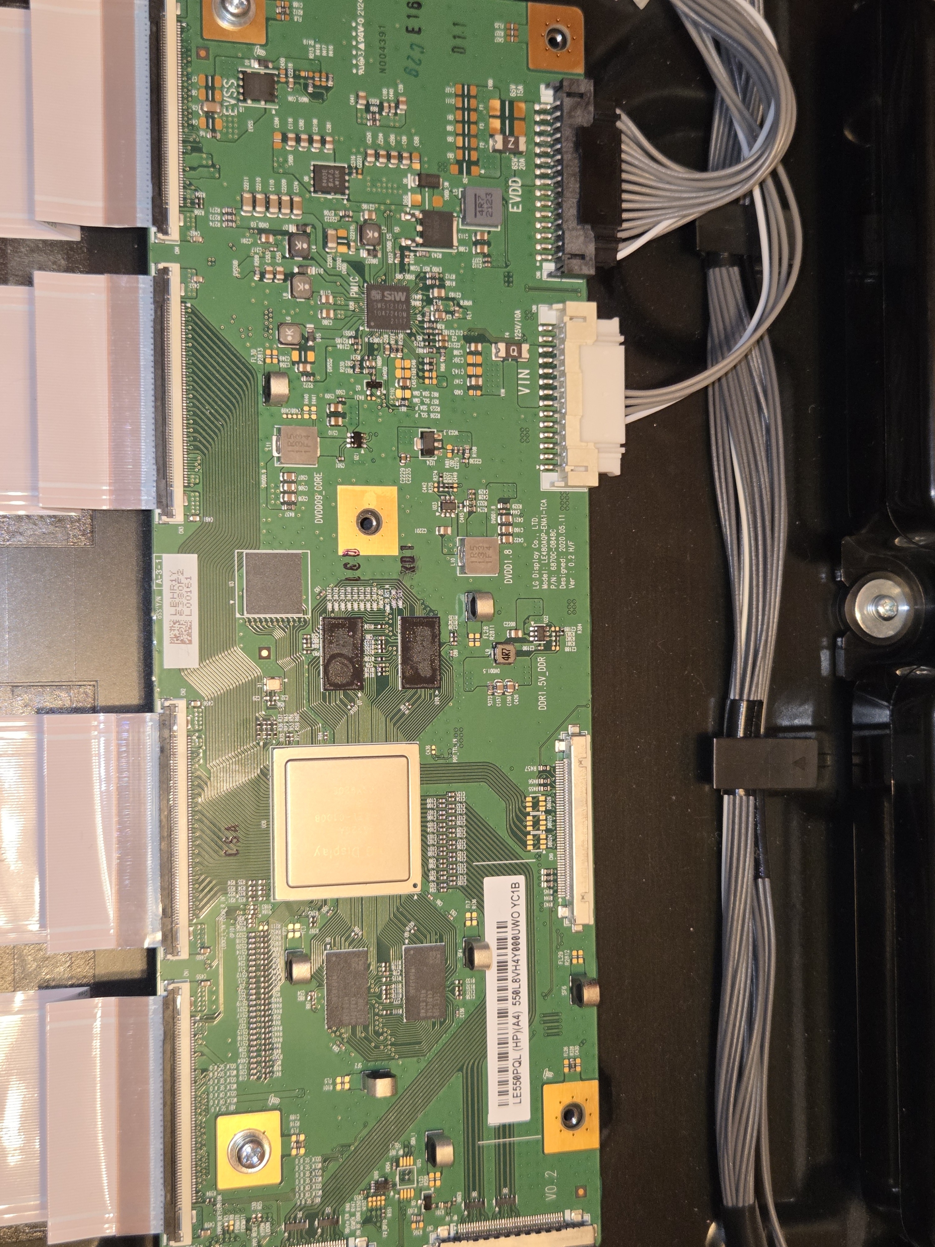

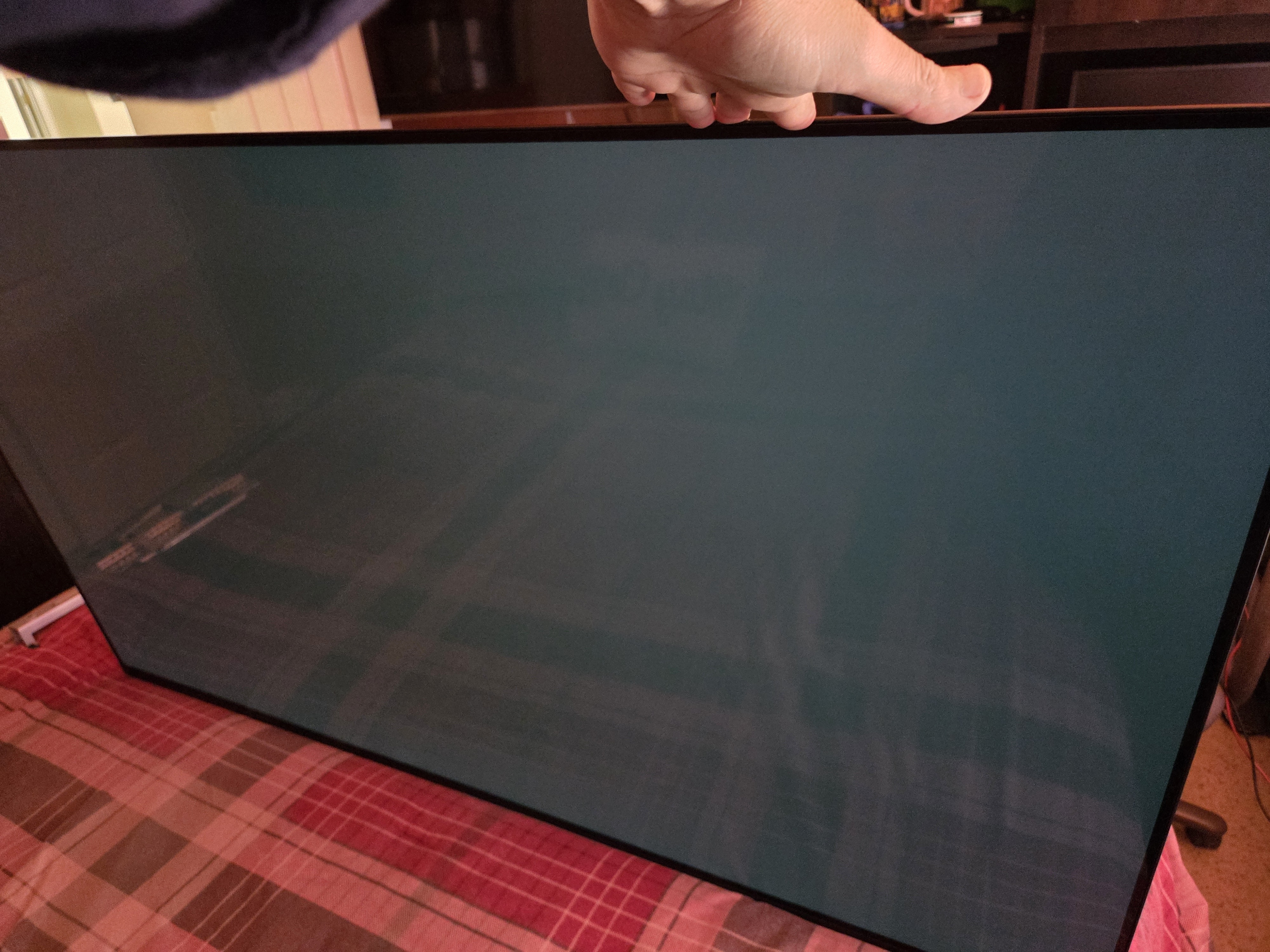

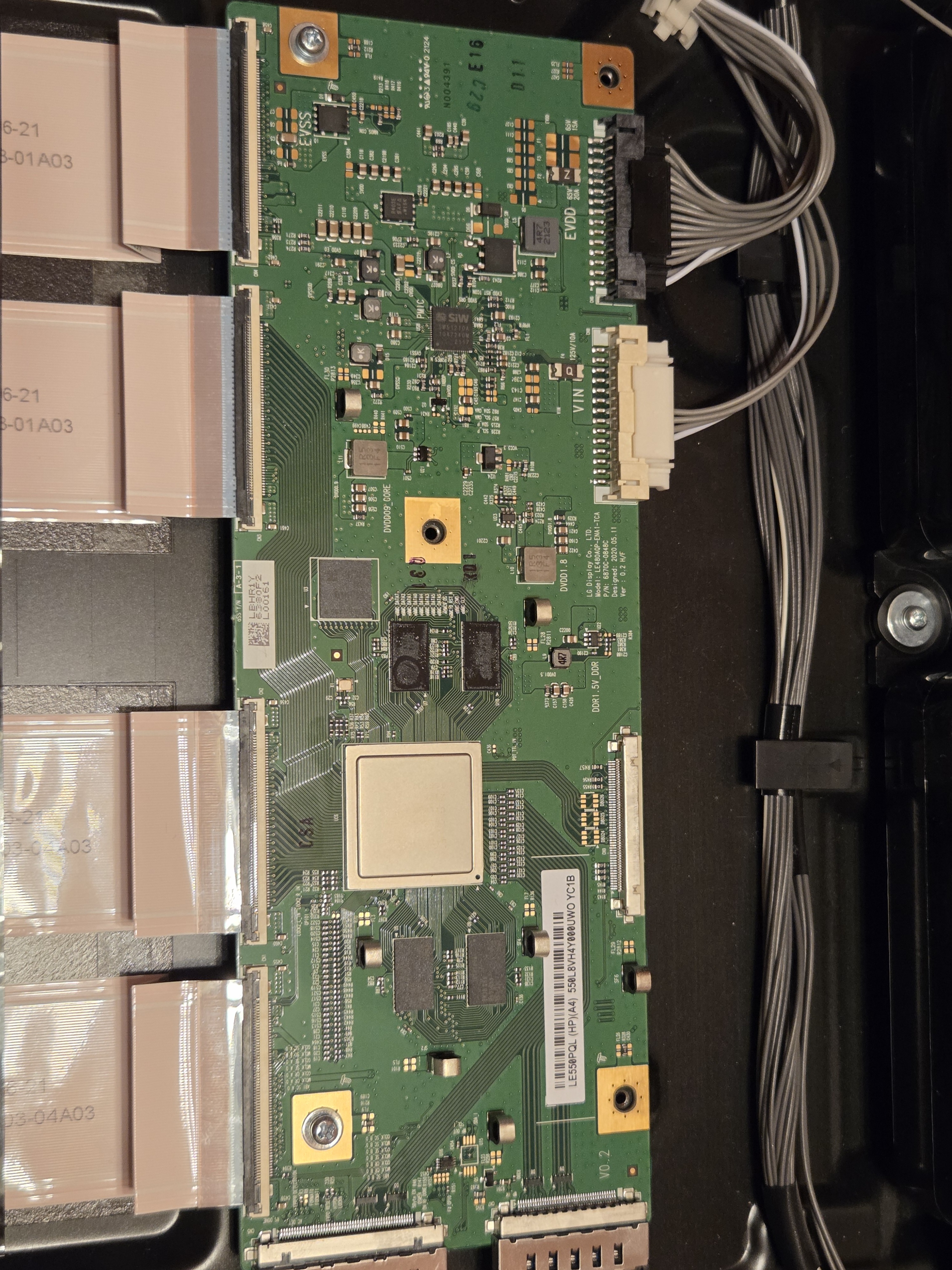

    OLED had no BL , put the the original T-CON and do the test again, post photo of your screen
    • jason123
      • Oct 2015
      • 1090
      This is the original TCON and Main board, I'm told. He bought them and when they didn't fix the TV he returned them.
      Yes, I'm aware there is no BL in the light-bulb sense, but I wasn't sure how to describe. I can provide photo shortly, but there is no hint of color or any activity other than you can tell it's on
      • jason123
        • Oct 2015
        • 1090
        Here is a photo of the TV with it on - just brighter screen, no color
        • lotas
          • Jan 2016
          • 4787
          • Russia

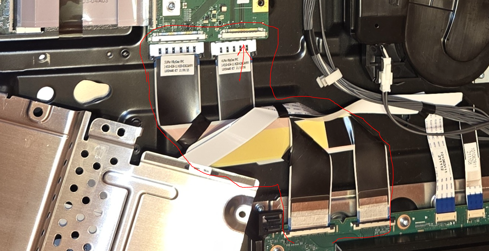

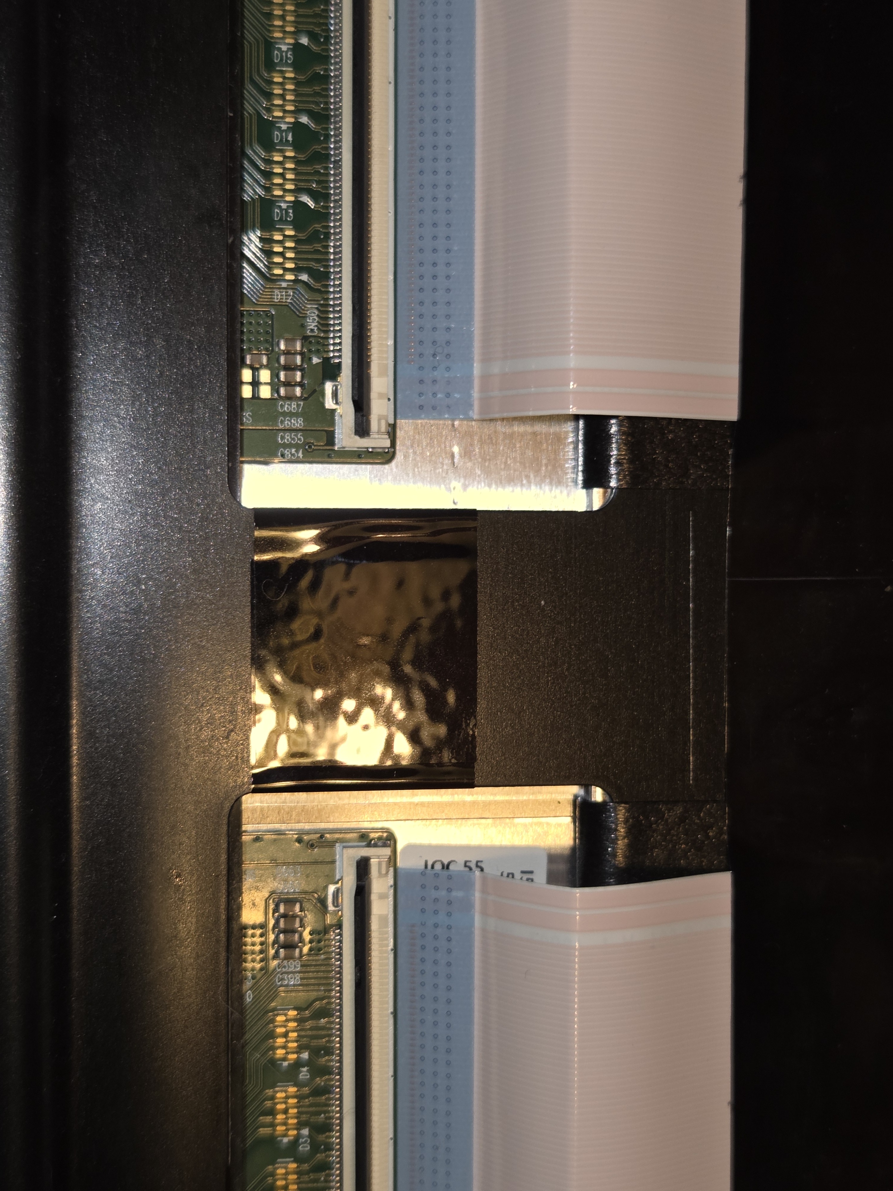

          You forgot to connect one LVDS cable. We tried replacing these two LVDS cables with others; they're a common problem with Sony.
          • jason123
            • Oct 2015
            • 1090
            Sorry, just so I understand... I need to connect the upper LVDS between the main board and the TCON or connect both LVDS cables? Even with the main board not powered?
            So to speed things up... I tried with one lvds cables connected at a time then with both and no change. Nothing is coming on the screen other than being lit up

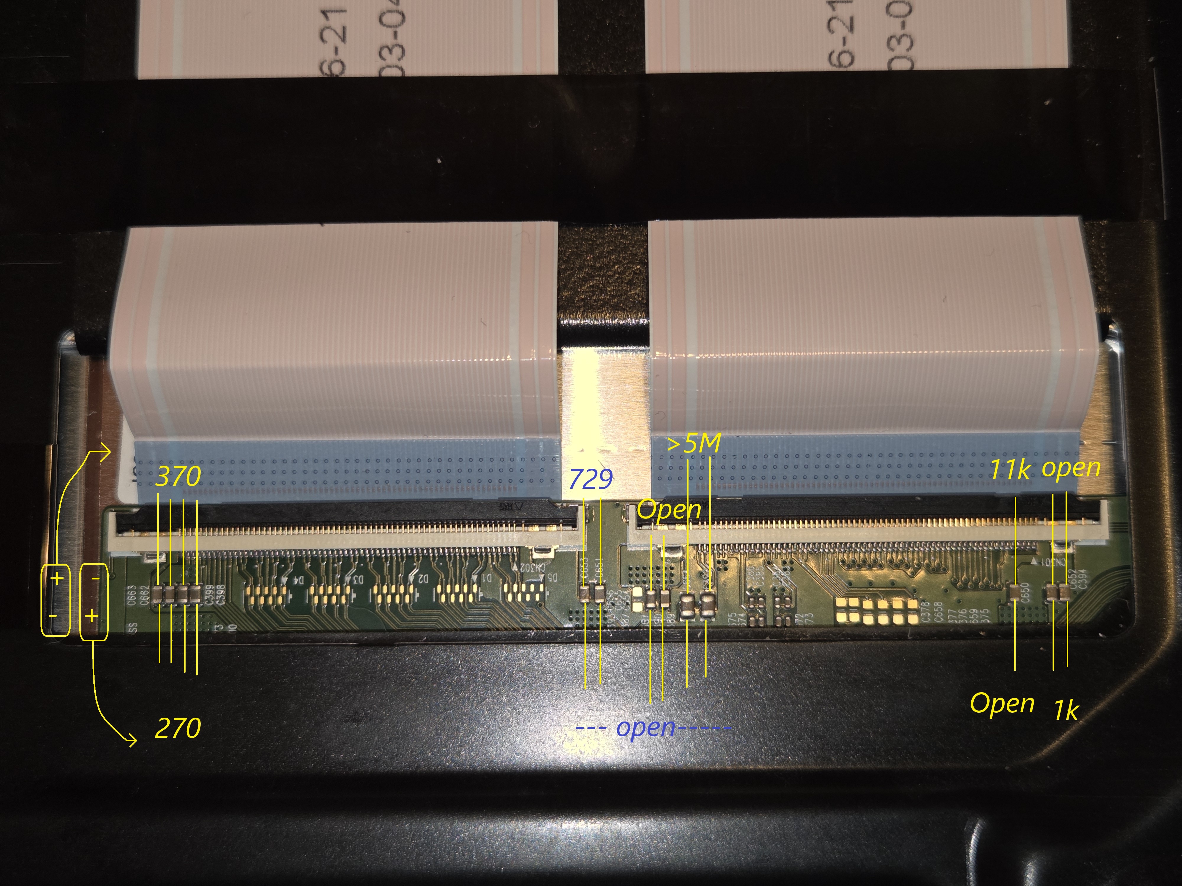

            • matwan
              Sony XR-55X90J 5 blinks
              by matwan
              I have problem with SONY 55X90J. After several check status is as below;
              1. Running power board as stand alone:
              TCON_12V =~ 12.6V
              EVDD V On Max 24V= 19V.
              2.
              Running power board with TCON as stand alone:
              Effect as below, attched.
              3. When bottom LVDS cable is disconnected no blinks, but of course no TCON 12V and EVDD.
              "I'm almost sure it's a defective panel, but maybe someone has encountered a similar issue on their screen.
              Best regards....
