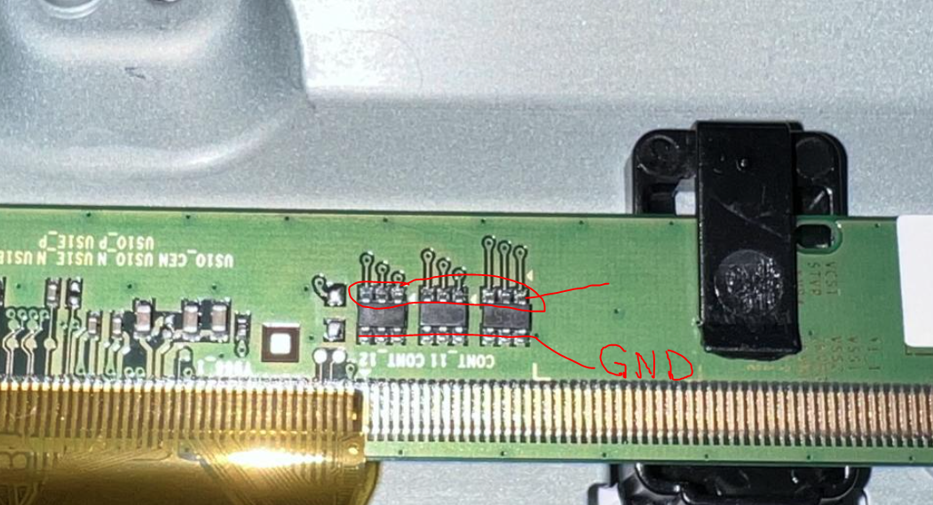

            if I unplug the cable between the motherboard and the power supply, the LEDs stay on without problems even for 15 minutes, if they were faulty they didn't light up at all or not?
            my question is if I test it with scotch tape by eliminating some clock signal lines, can I figure out if it's a display or motherboard problem?

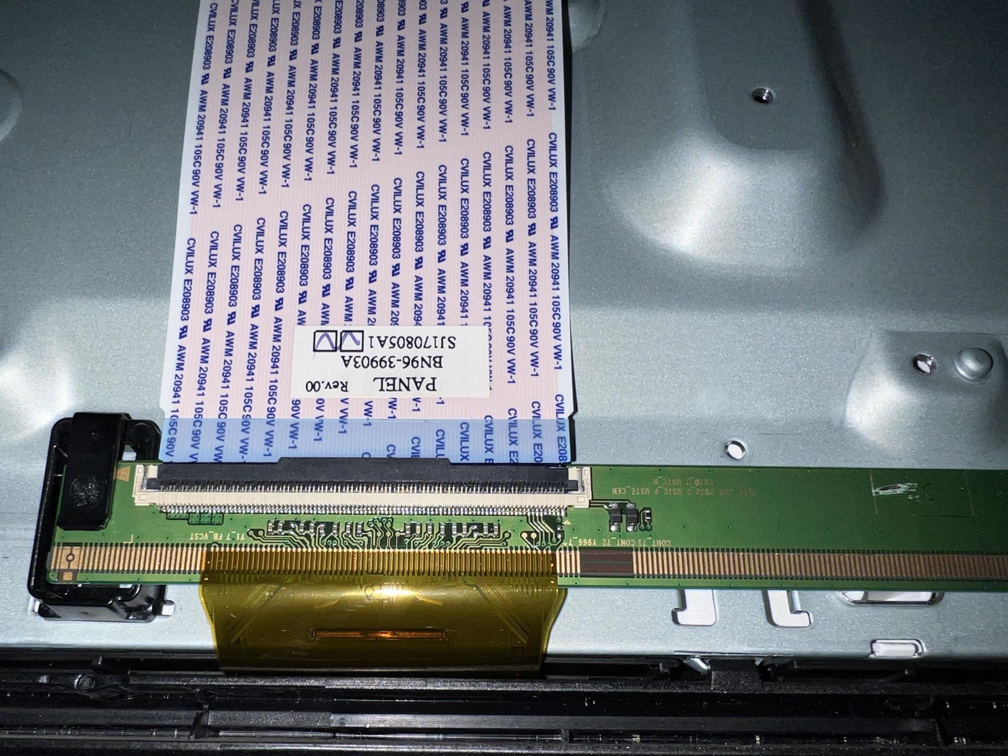

              2) if I disconnect the 12 pin cable that goes to the motherboard the backlight stays on without problems

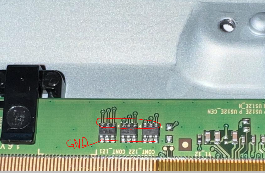

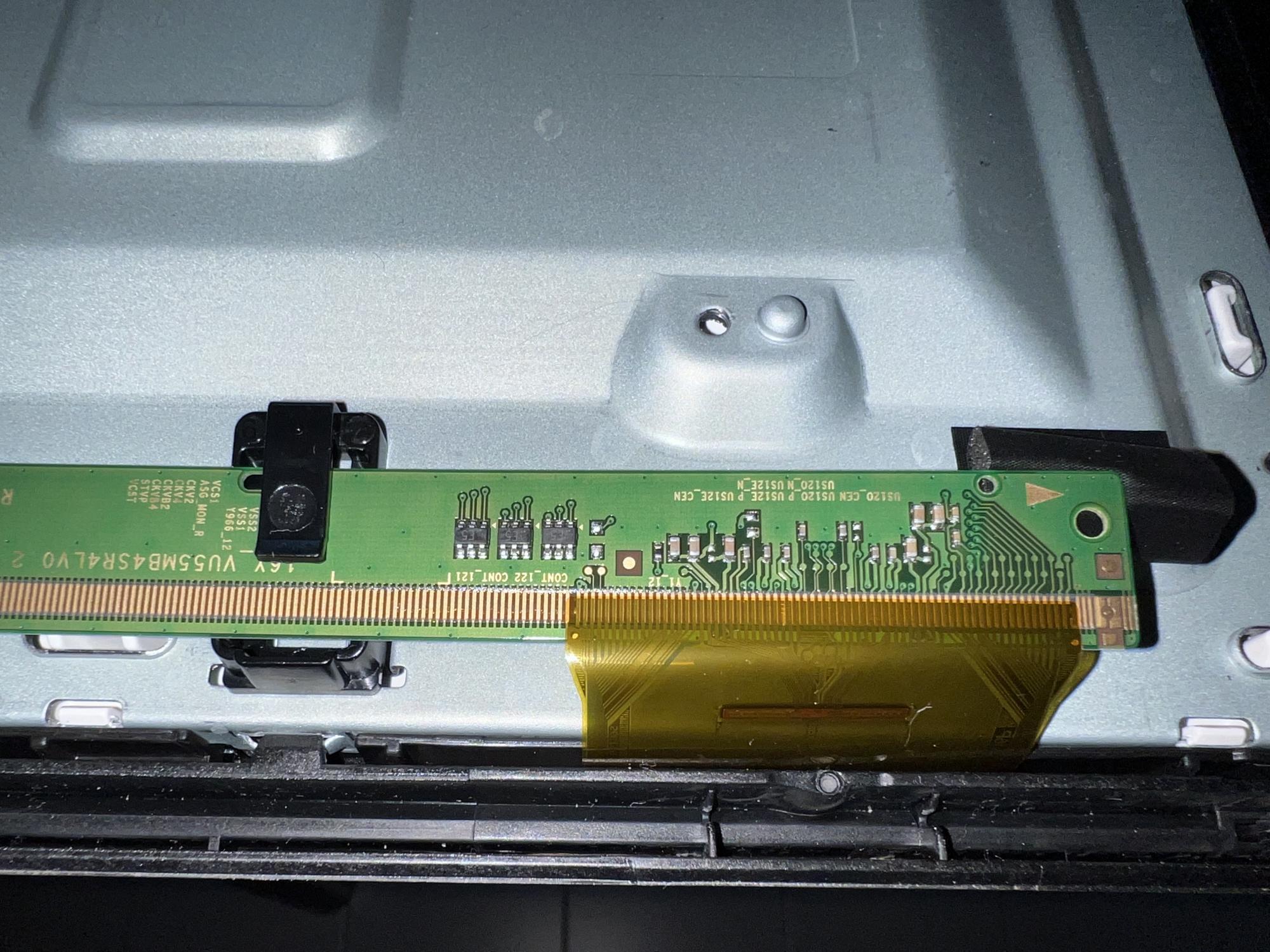

                  Re: Samsung UE55MU6120K Boot loop with backlight no video

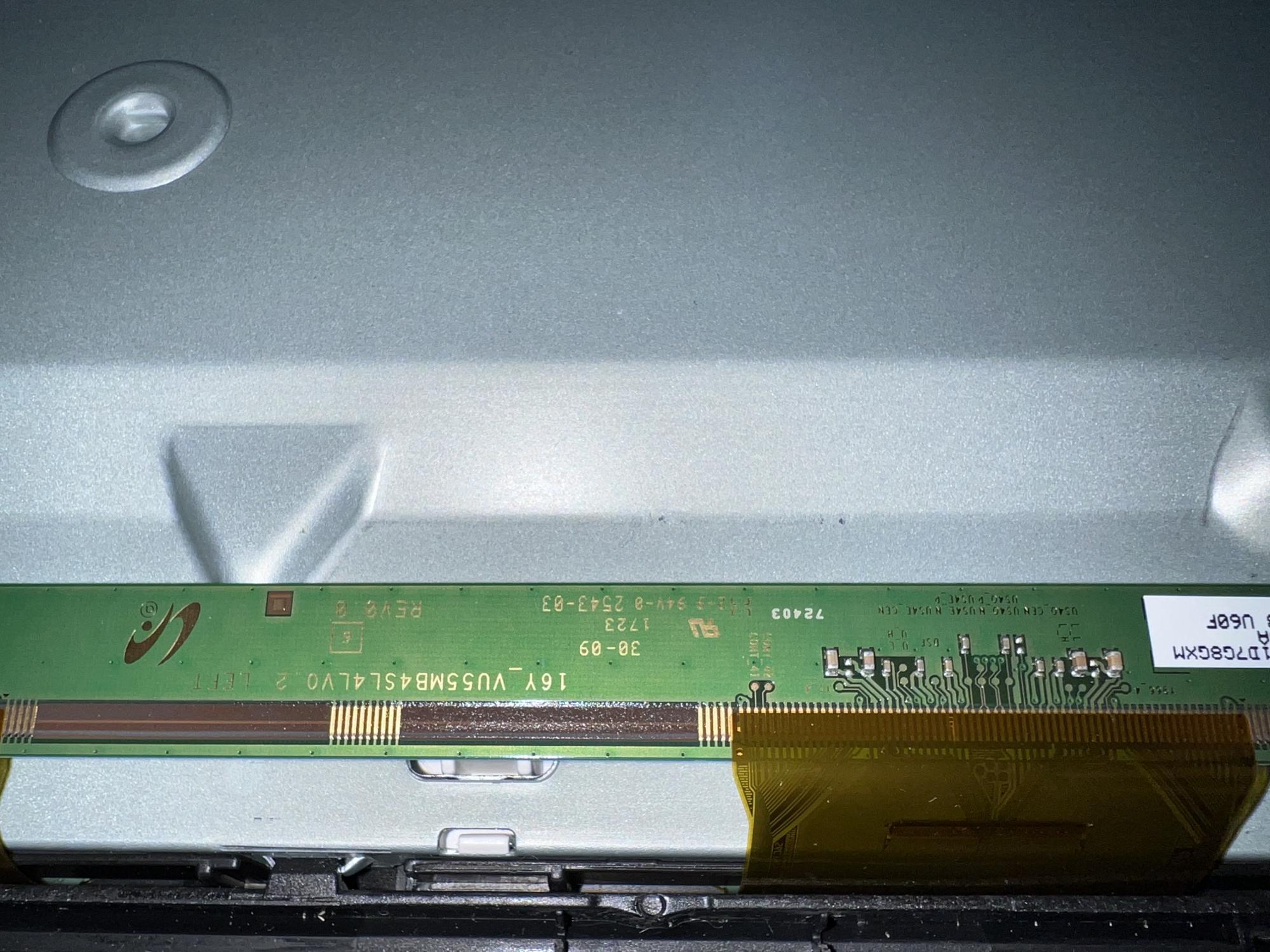

                  try blocking ckv lines, worked for me
                  • fanaticgames
                    • May 2017
                    • 138
                    • italy
                    I can't identify the ckv lines on this model, can you help me?
                    I can't connect the tracks to the serigraphs

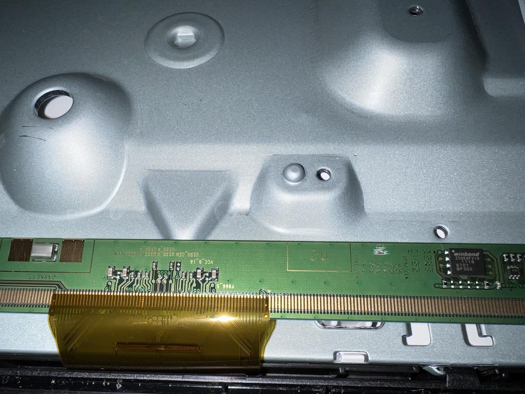

                              yes I checked the winbond chip on the left pcb and there is 3.3V

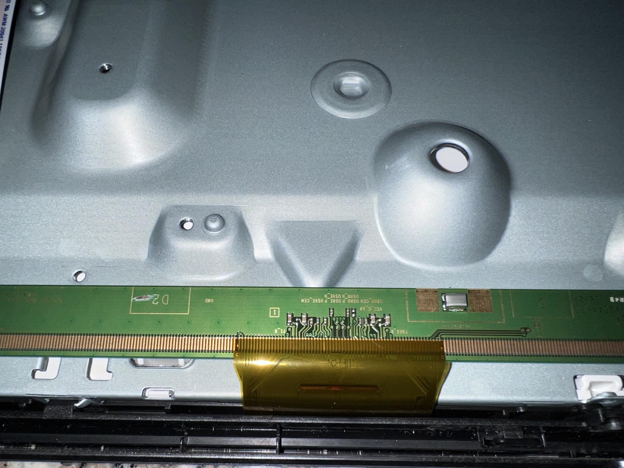

                              I did some random tests with tape on the panel flats and the TV doesn't restart anymore and you can hear the audio and the backlight works but the screen is completely black, no image

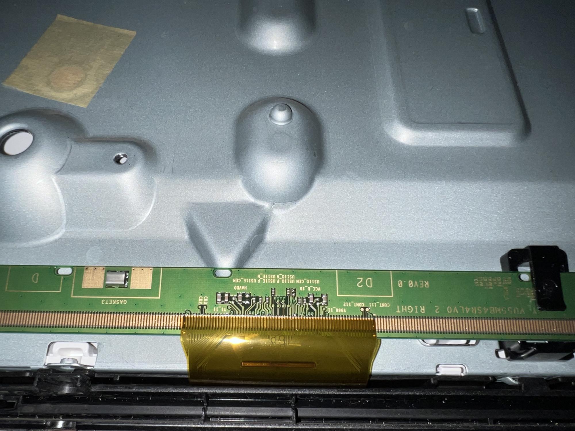

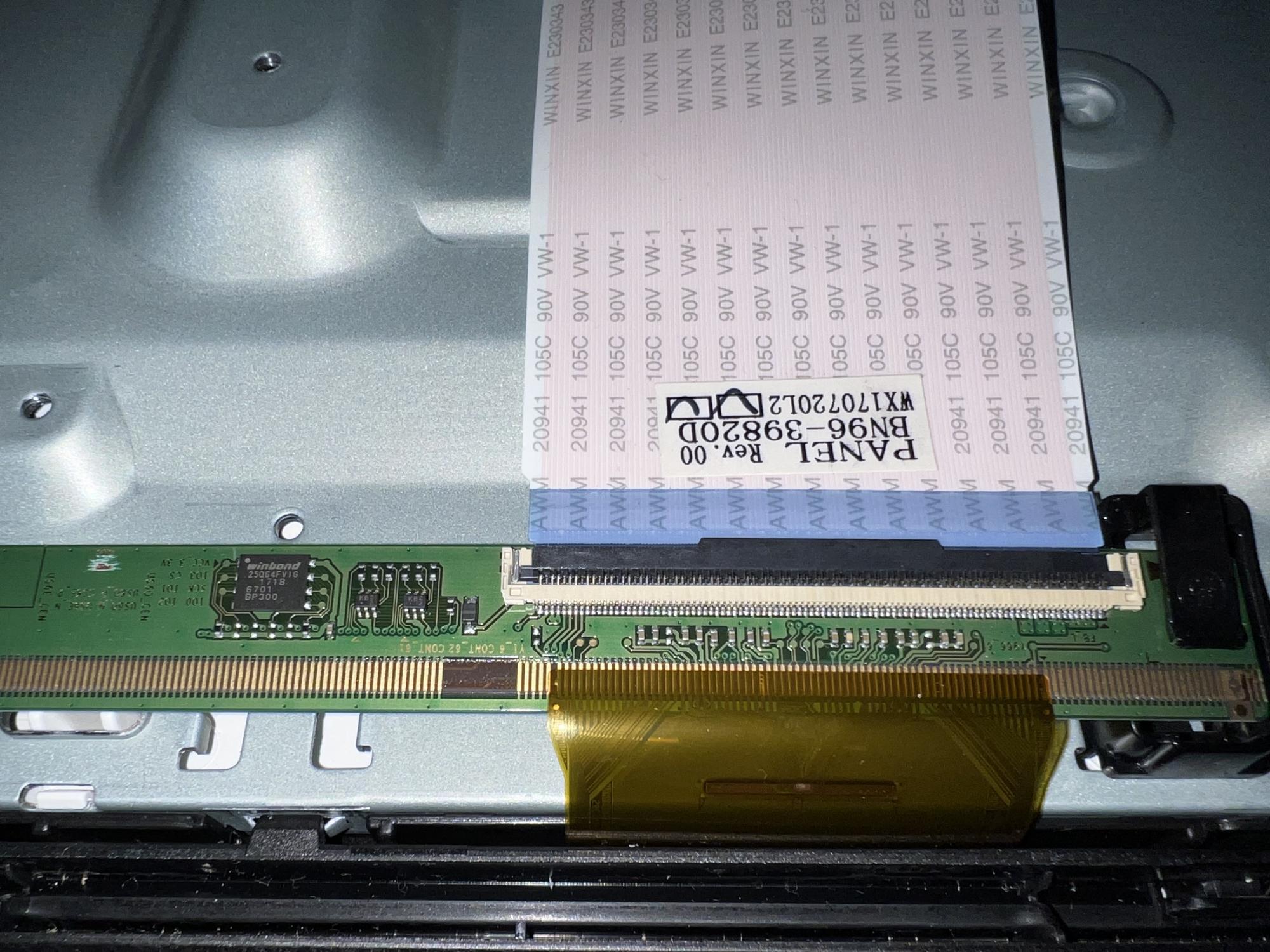

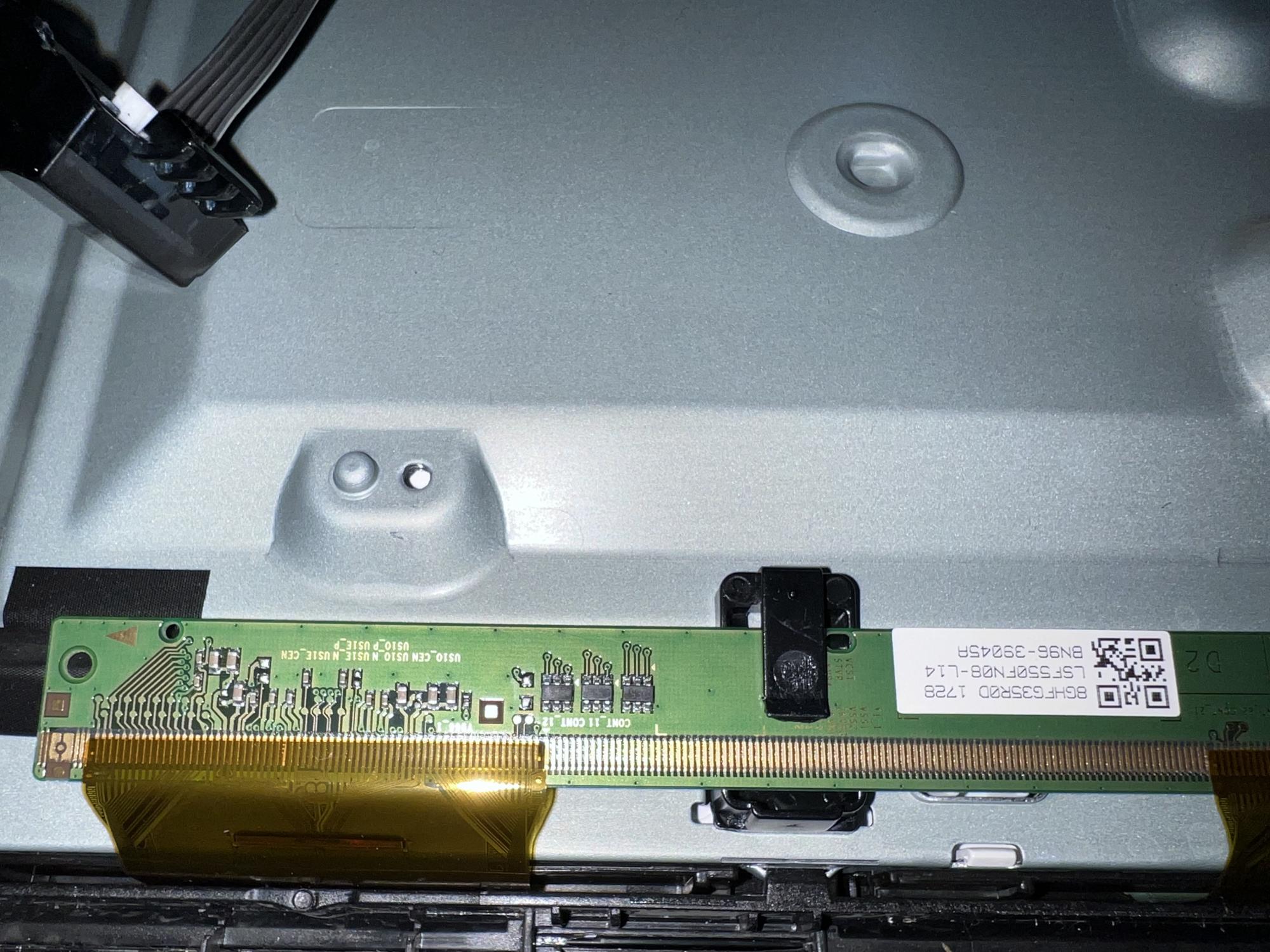

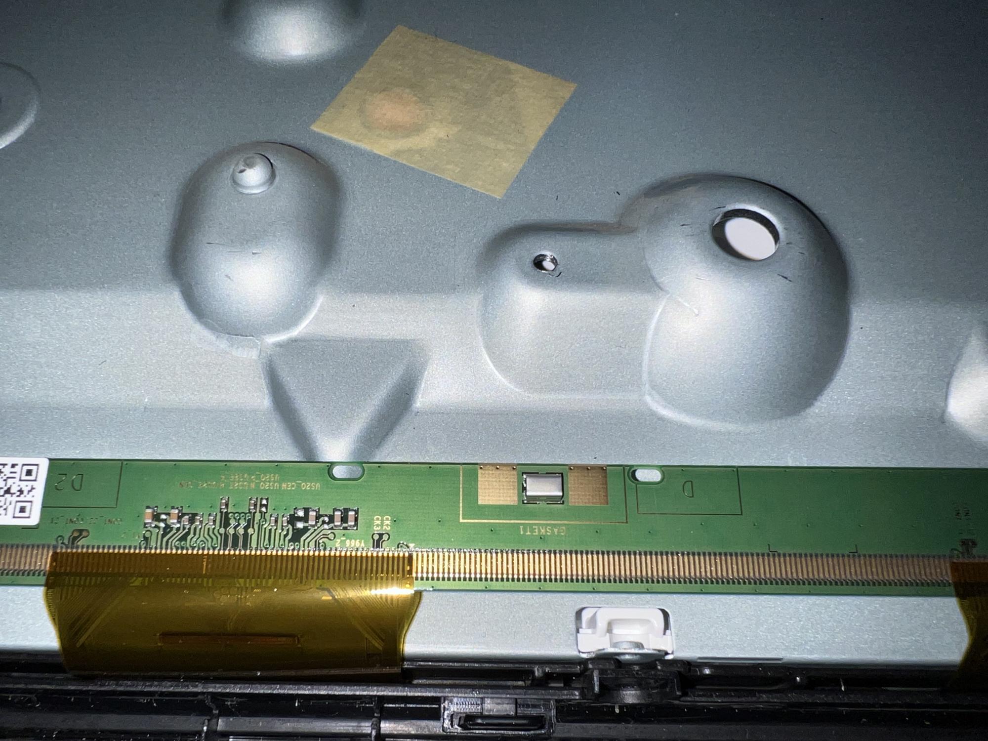

                                    • fanaticgames
                                      • May 2017
                                      • 138
                                      • italy

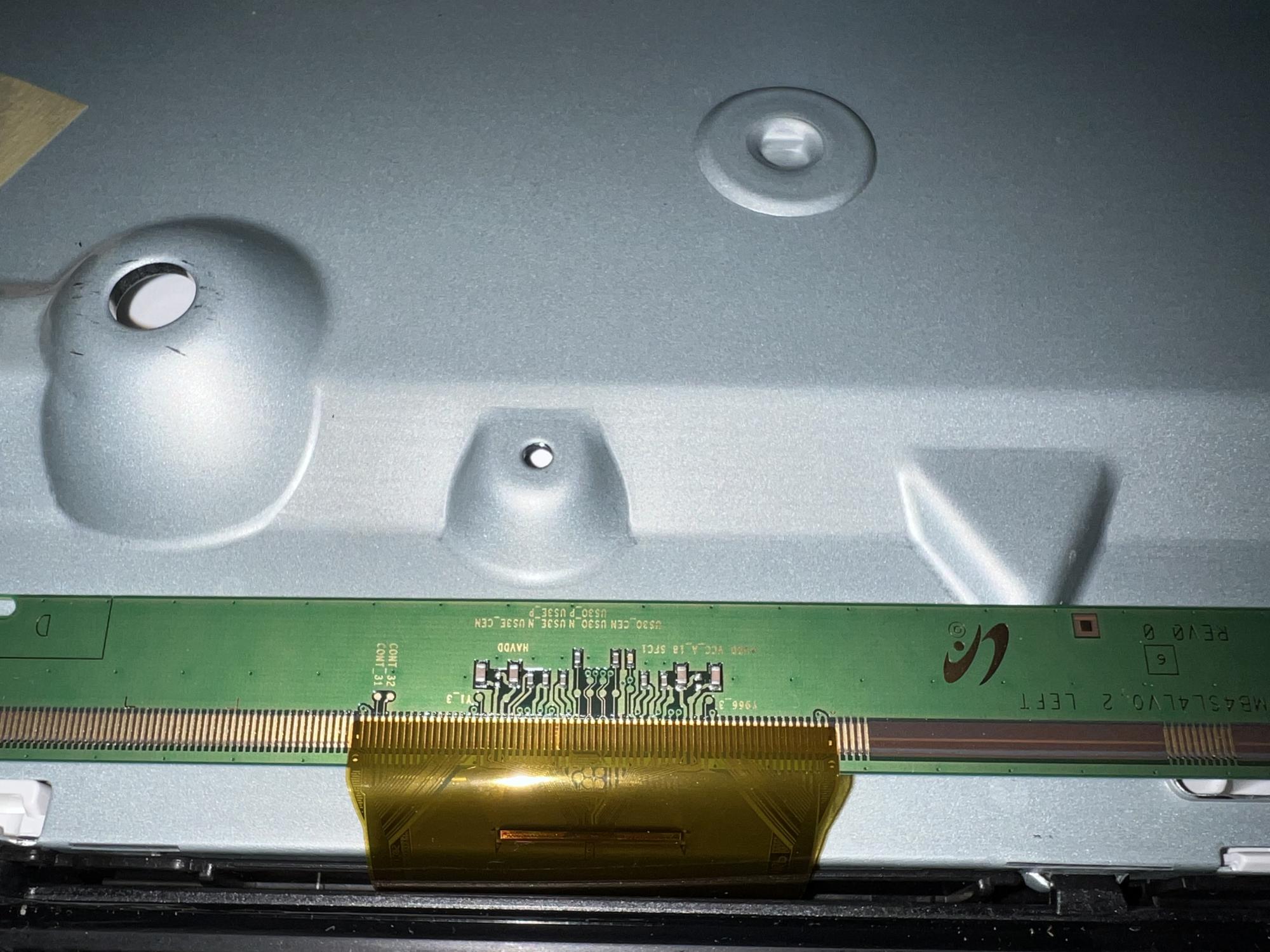

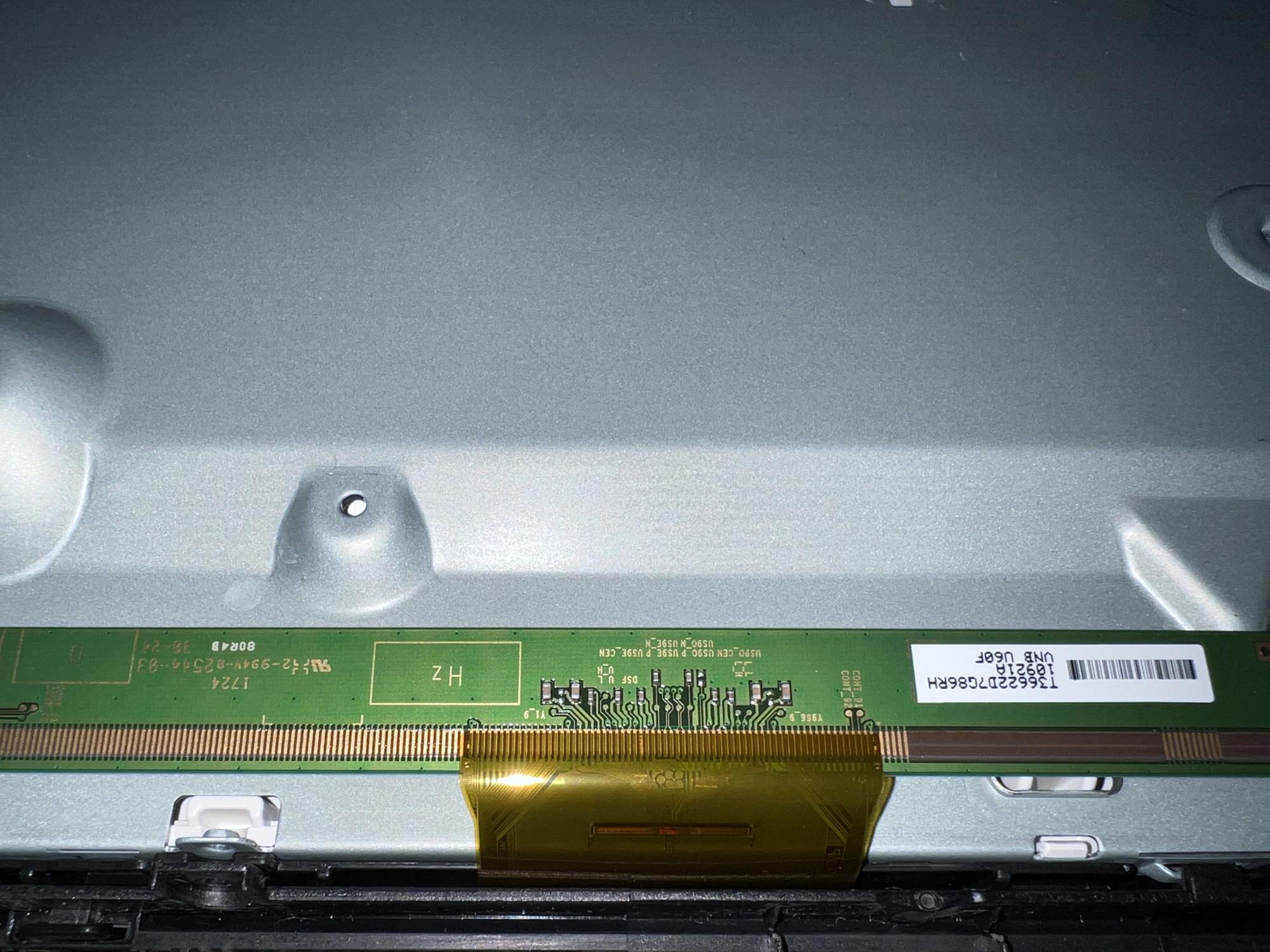

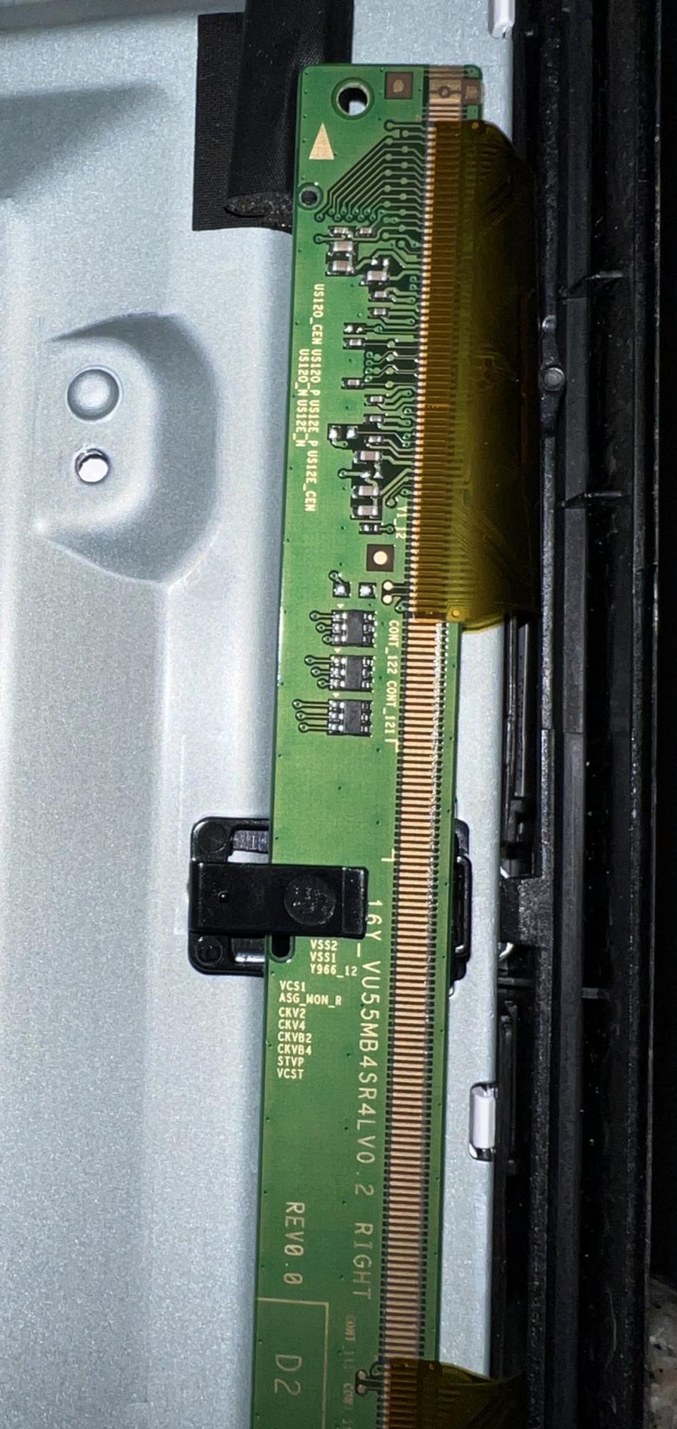

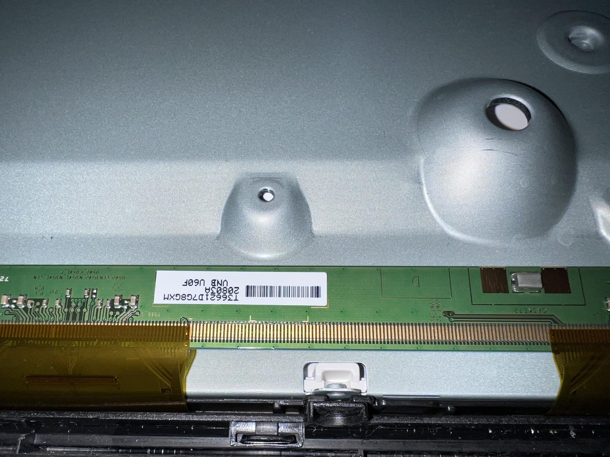

                                      Originally posted by Davi.p
                                      Ah, yes, try switching normally on the tv, if you can locate a 15 v for a short time on the capacitors on the screen's boards then you have located the 15v on those condensers, if the voltages does not appear then you must search for technical document of the model, or study the circuit on mainbboard , if you can't i need very sharp picture of it.

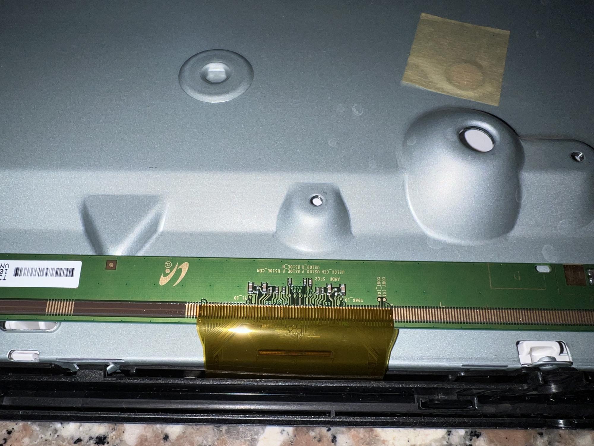

                                      Left and right board photo:
                                      • lotas
                                        • Jan 2016
                                        • 4787
                                        • Russia
