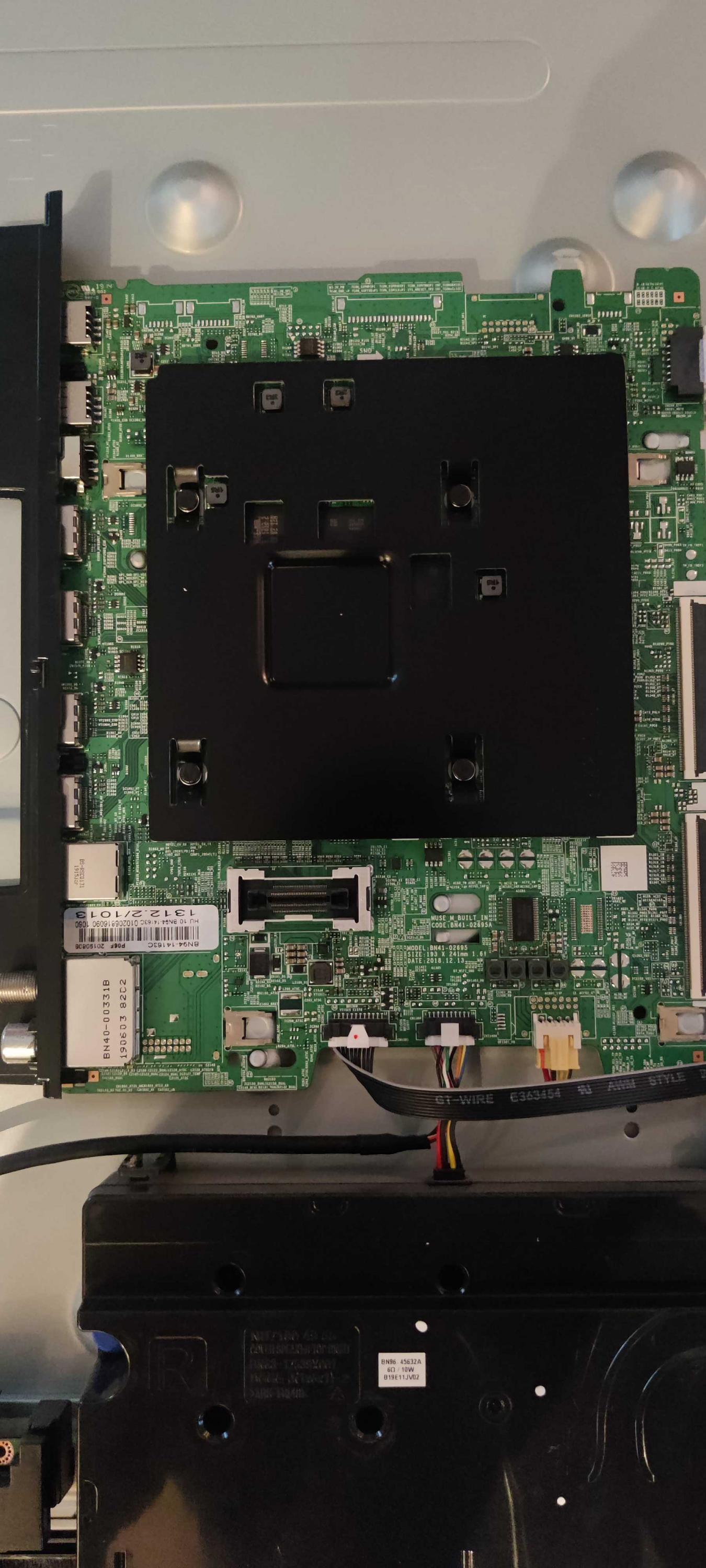

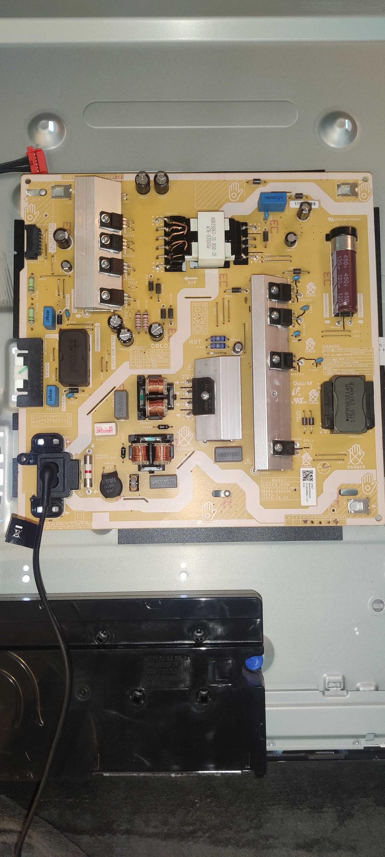

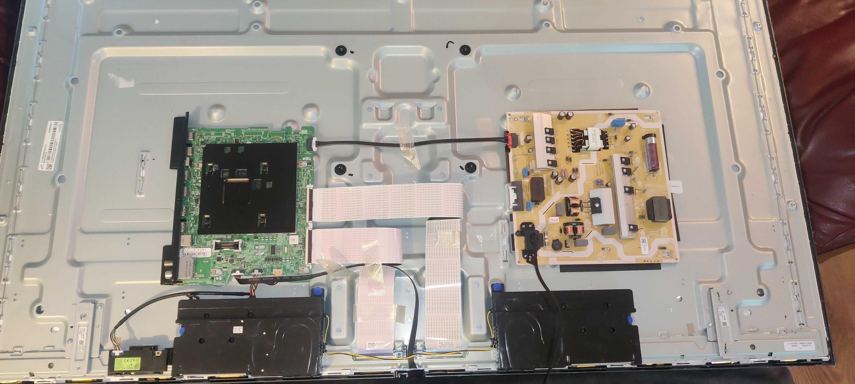

          Yes, ALWAYS pictures, need good straight on focused pictures of each board and one of the whole back as to see how everything is connected.

                  Re: Samsung 55" TV - Boot loop but sometimes works fine - UE55MU6470U
                  #6 I have unplugged the cable as per your instructions and the backlight came on and stayed on.
                  Attached are some photos.
                  • nomoresonys
                    • Jan 2013
                    • 12206
                    • U.S.
                    Ok, that in most cases means the backlights and powerboard are alright, so you can concentrate on the rest.
