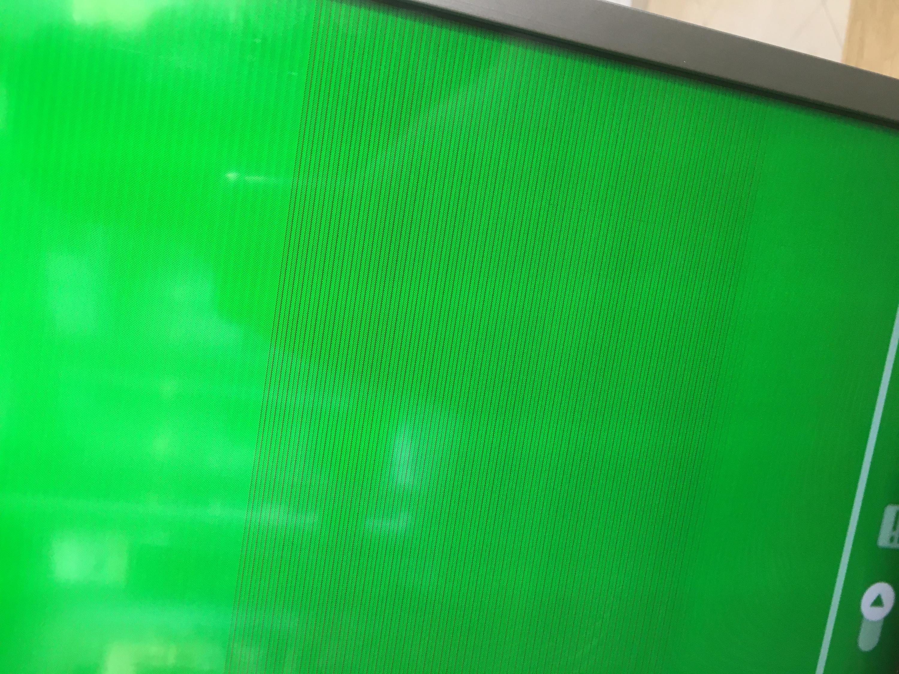

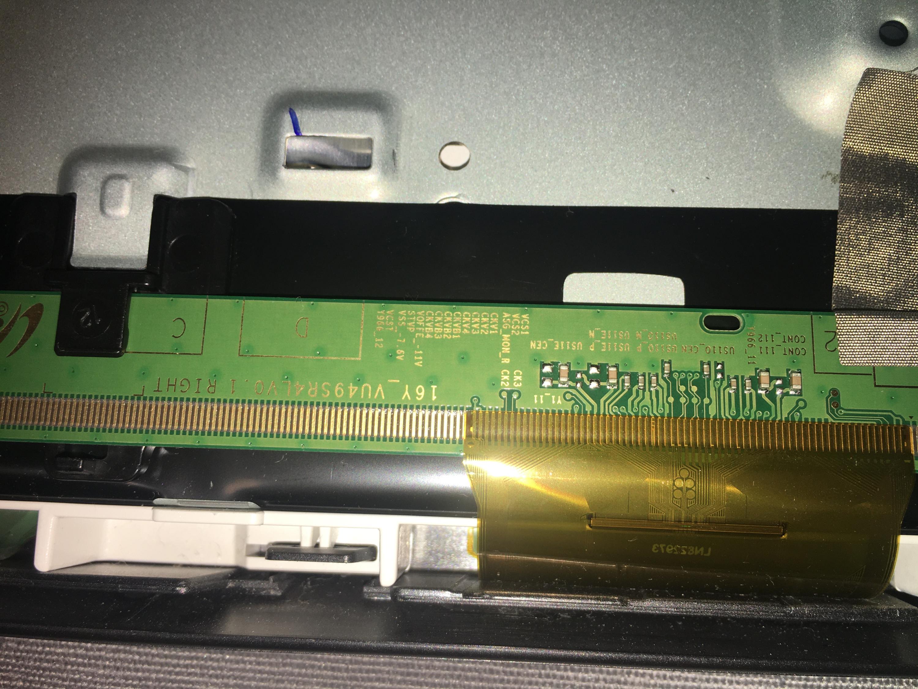

                              Re: Samsung UE55MU6120K Boot loop with backlight no video
                              My update for my TV: I did the jumper T-RDY1 and T-RDY3 in #36 and I found that the short was on the left and I isolated the ckv (12-20).
                              but I got some lines on the screen, how many lines should I uncover?
                              I cut the jumper after I got image on the TV
                              I uploaded the video
                              https://imgur.com/6rGvALj

                                #135
                                hugmax this is probably due to the fact that both the sides are broken..

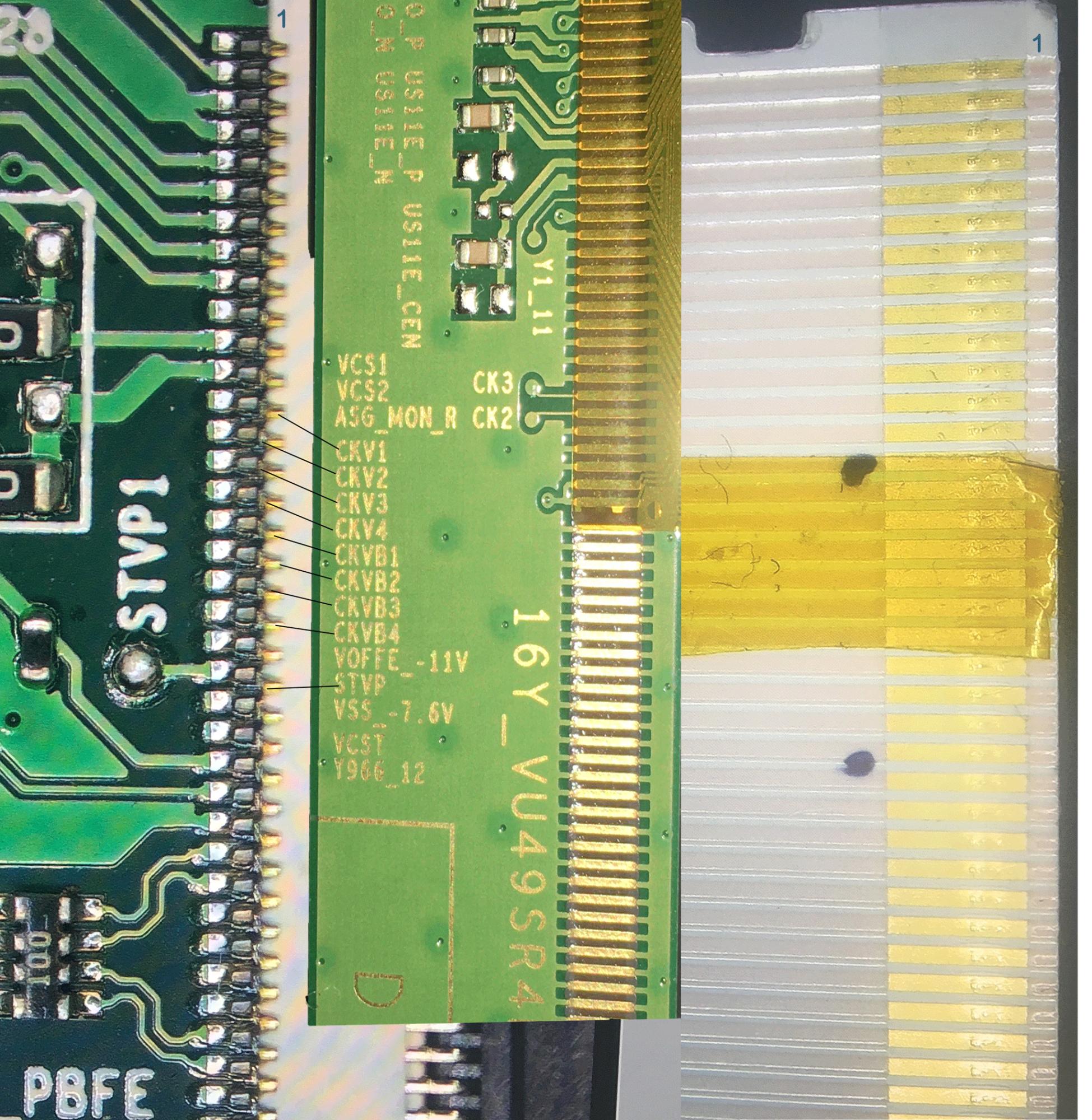

                                      #138
                                      I just went on try and error, uncover some lines on the flex.
                                      from 12-20 went down to 16-20 if I left any of these lines free the TV goes on reboot frenzy.
                                      but the best I got the TV is this.
                                      Is this the best? Can I do something to get a better picture?

                                        #139
                                        check diodes on the panel small boards, maybe try shorting clk lines to gnd one by one, if a new set of black lines appears step to the other clock, until no new lines appears, that clock line is probably connected to a bad diode to be removed.
                                        • hugmax
                                          • Mar 2023
                                          • 8
                                          • Spain
                                          #140
                                          Short the clock lines on the COF?
                                          Because I couldnt find the clkv points on the cof.
