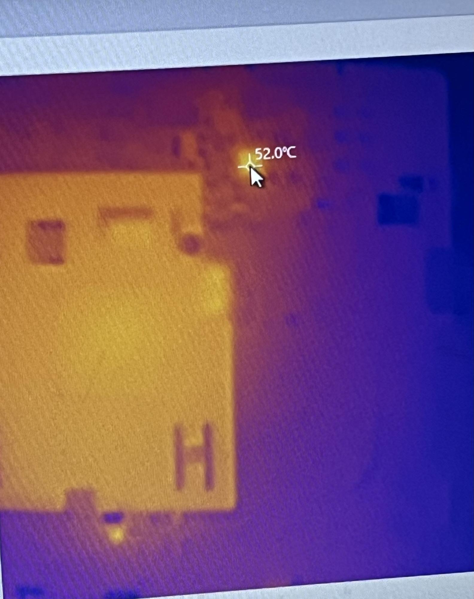

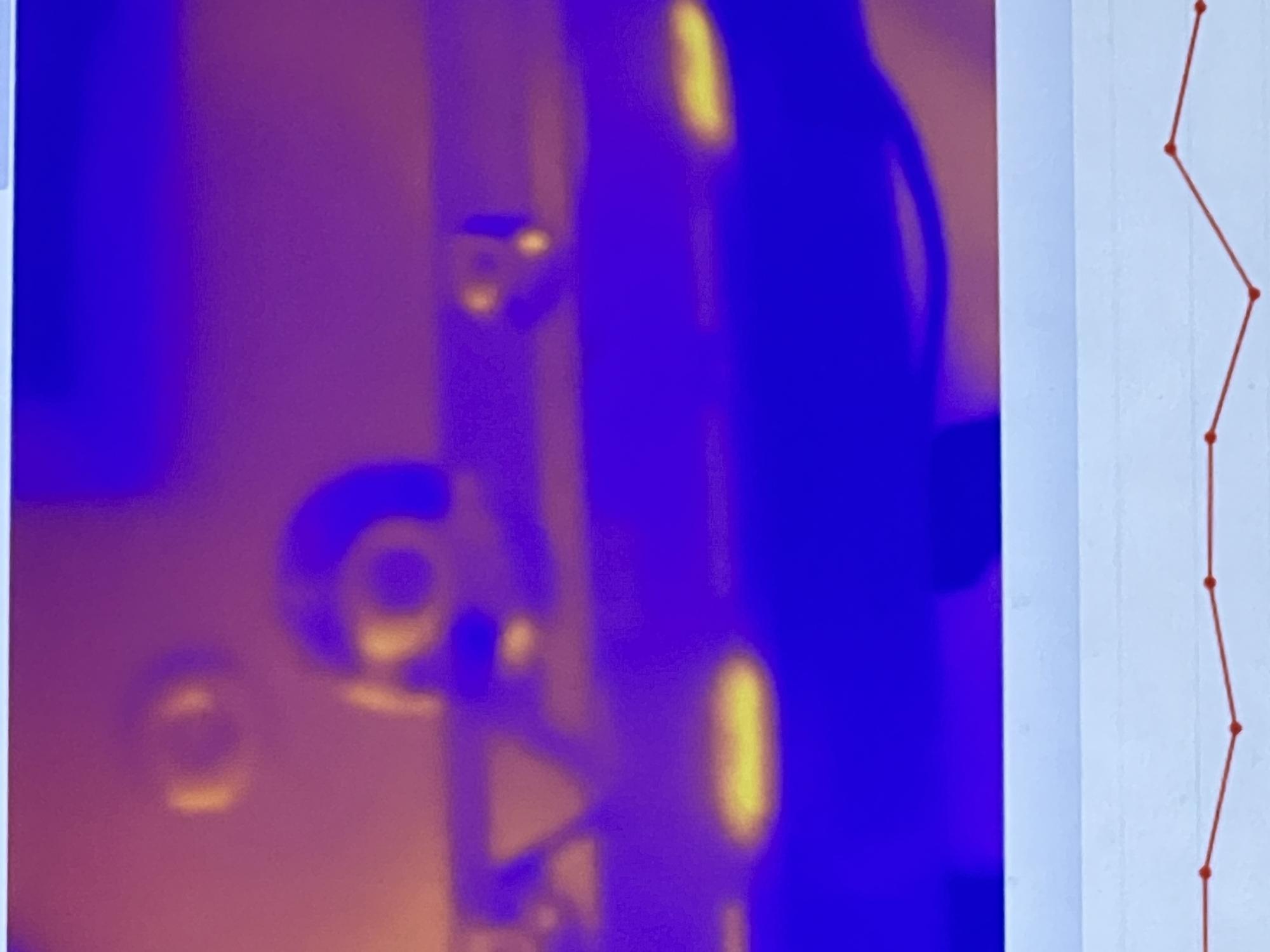

      Re: Samsung UE55MU6120K Boot loop with backlight no video
      Originally posted by lotas
      You didn't seem to put a jumper there.
      according to your photo then I made the bridge between pwm4 and rdy1, how can it be that it works now? it's still on without the jumper
      Update
      take some current photos with the TV on, the temperatures seem perfect both on the motherboard and on the flats of the right and left panel cards which are usually always hot

        #83
        Originally posted by Davi.p
        yes, it seem the correct T-RDY3 point is the one marked by Lotas, not so easy to understand..
        Don't expect it will work for long time.. something wrong may exist too..
        Let us to know how it goes, i'm much curious..
        it certainly won't last for now it's been on for 30 minutes, maybe I'm talking bullshit could it be that some component "discharged" during these days of inactivity? the esd diodes??

                                    • nomoresonys
                                      • Jan 2013
                                      • 12097
                                      • U.S.
                                      #98
                                      almost seems like something on the mainboard is just getting too hot once you get the back on and it back on the wall.
                                      • nomoresonys
                                        • Jan 2013
                                        • 12097
                                        • U.S.
                                        #99
                                        my buddy tampatec fixed one by putting some good heatsinks on every chip that got pretty warm on the mainboard, might not do the trick but something pretty easy to try.
