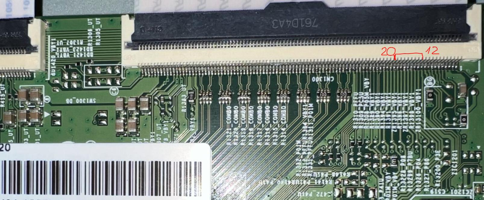

    Re: Samsung UE55MU6120K Boot loop with backlight no video
    This jumper is placed to determine which half of the panel is not working, insert one cable and turn on the TV, then do the same with the other cable.
    • lotas
      • Jan 2016
      • 4753
      • Russia
      #42
      Here I give you a photo of each half (left and right cable) where to isolate the CKV. Maybe it will be easier for you.
        lotas photo this is the cKV usual get issue at NU/MU/TU.
        ESD you cant test them with DMM. only if you have Laser Temp pointer you will find one of them more warm to hot than other.

          #44
          I put scotch tape on both flats and the result is that it restarts anyway, tried to put first on one, then on the other and then on both, when the flats are connected the TV restarts
          I positioned the tape counting pin by pin with the microscope so there is no error, covered the pins from 12 to 20 and then from 75 to 83

            #45
            Remove the jumper and test without it. Isolated should be only on one half, on the one that does not work.
            And you need to put adhesive tape on the other side where the contacts are on the cable.

                  #48
                  Originally posted by Diah
                  mask only the LVDS on the top of MB.... from Top count 11 pins and mask 9 pins.. it can be too from top start from 10 or 9 try you will have working TV at least but not perfect
                  by the way we have in forum digram where to mask on NU... MU will be same way just 1.2 more or less...
                  I have already covered the pins that lotas told me, can you name other pins other than his? honestly I don't think much will change since the TV keeps restarting with 2 connected flats

                      #50
                      Originally posted by fanaticgames
                      you mean in this area?
                      NO
                      i linked before lotas photo... its for LVDS which are on the top of MB... and as lotas remarked... i give you other remark to count from the top 11 pins and start masking.

                          #52
                          blue color

                            #53
                            CN1802_UT (USI-T RIGHT) and CN1801_UT (USI-T LEFT)

                              #54
                              blue color
                              ok, I understand, I'll try like this then, leaving the other flat free

                                #55
                                The pinout is clear, first I covered exactly the ckv area, first right and then left but nothing has changed

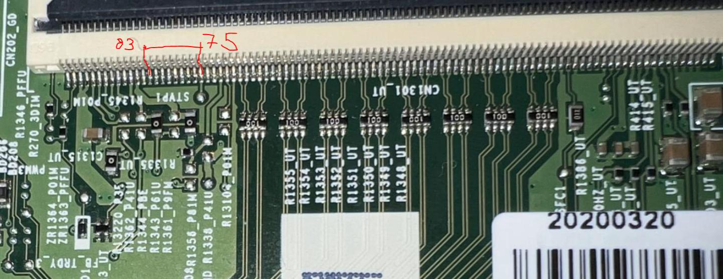

                                  #56
                                  Hi fanaticgames,
                                  i had the same error.
                                  Please try to block only the CKV lines without the STVP line. So the pins 12-19 on the left cable(CN1801). You have to work very precisely, preferably with a microscope. Do not block any pins on the right cable. Connect both cables and test if there is a picture.
                                  If there is no picture, you block the CKV lines without STVP on the right cable. So the pins 76-83 on the right cable(CN1802). Don't block anything on the left cable. Reconnect both cables and test. If an image comes up in one of the two attempts, we'll see what's next.

                                    #57
                                    Originally posted by PaolinaSparks
                                    Hi fanaticgames,
                                    I'll try later and update the status here

                                      #58
                                      Hi fanaticgames,
                                      nothing changes, it always restarts, i guess the ckv lines have nothing to do with it at this point

                                        #59
                                        blue color
                                        Nothing has changed
                                        I masked both 10 pins and 9 consecutive pins
