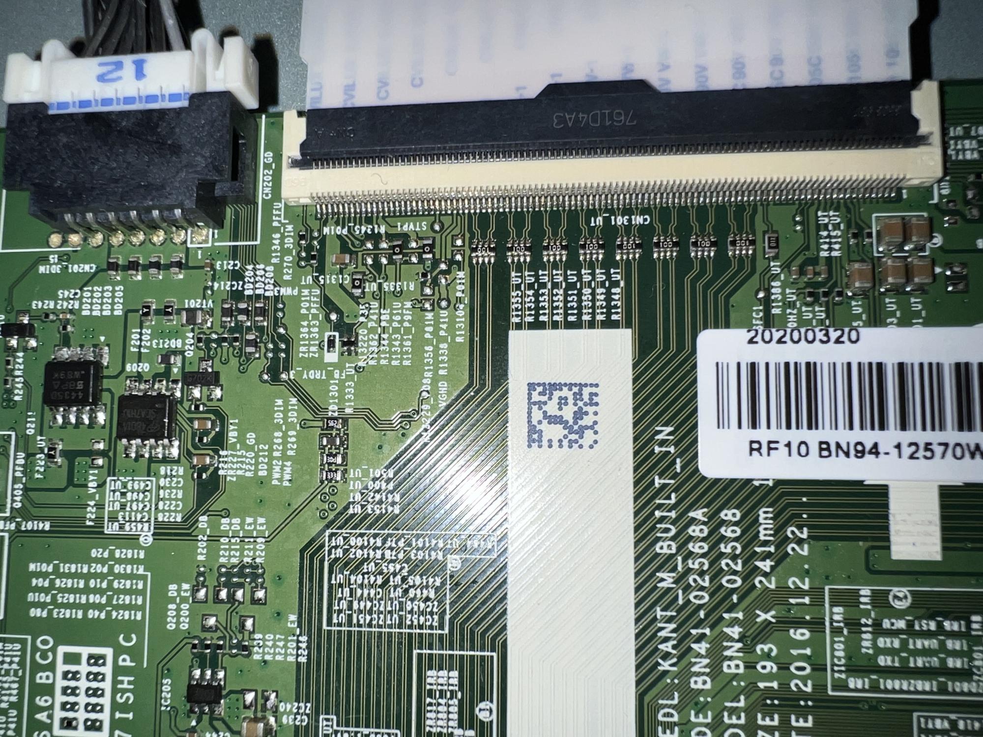

            even if i want to do it as individual ckv lines? on the motherboard I don't see any ckv indication

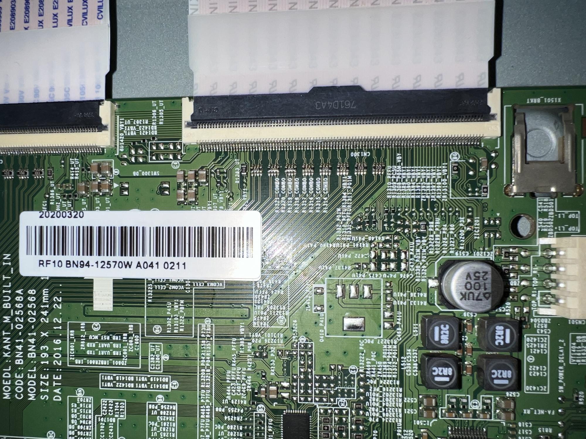

                Re: Samsung UE55MU6120K Boot loop with backlight no video
                to make things short, locate on MB two test points named T-RDY1 , T-RDY3, join them, in this way protection is disabled, now turn on tv and watch on to the screen's small boards if something gets hot or smokes, prepare to turn off tv rapidly, hope that there is a cap or diode in a half short state..
                  Points T-RDY1, T-RDY3 do not disable protection, they are intended for something else.
                        When you disconnect which cable (left or right), does the TV stop overloading?
                        • fanaticgames
                          • May 2017
                          • 138
                          • italy

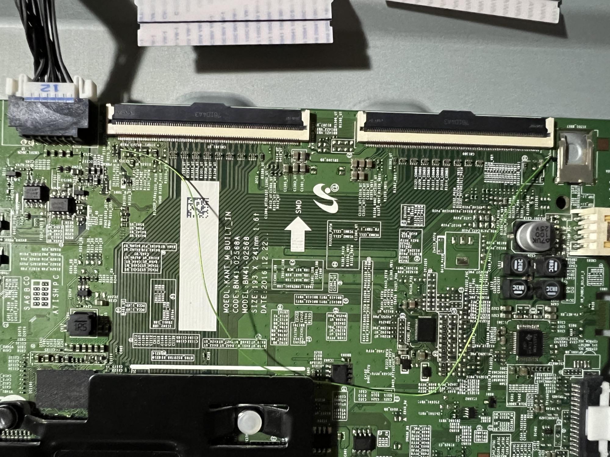

                          #32
                          this is what i'm trying to explain from the beginning, i recap:
                          (with TV off)
                          I turn on the TV only with the left flat connected and it turns on
                          I turn on the TV only with the right flat connected and it turns on
                          I turn on the TV with both flats connected and it goes on and off endlessly
                          same thing even if I disconnect the flats with the TV on, just disconnect any one and it stays on
                          the problem occurs only when both flats are connected

                            #33
                            Lotas i have tested it on a Panasonic with Samsung panel, the image appears and stays on with many artifacts and a coil starts to heat on tcon.
                            Fanaticgames, there's no need of the uart, the fault is in the screen, this is clear for who has experience enough, the uart is possible maybe but it's a very long process to enable it..

                              #34
                              (with TV off)

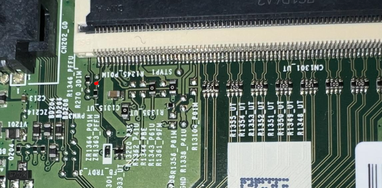

                              Damn
                              It's clear, now put a jumper between T-RDY1 and T-RDY3 (imitation of panel connection) and check also with the loops disconnected (with left and right).

                                #35
                                jumper done, it works

                                  #36
                                  T-RDY1 and T-RDY3

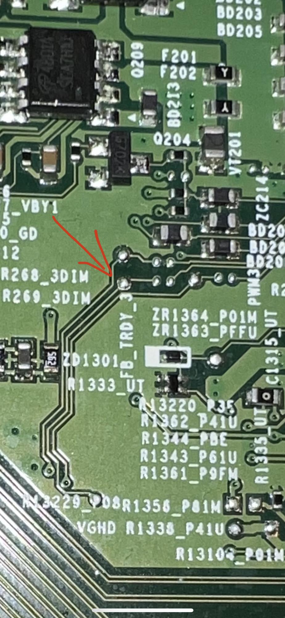

                                    #37
                                    T-RDY1 and T-RDY3
                                    yes, jumper done, the tv doesn't restart and works, so it's definitely the faulty panel

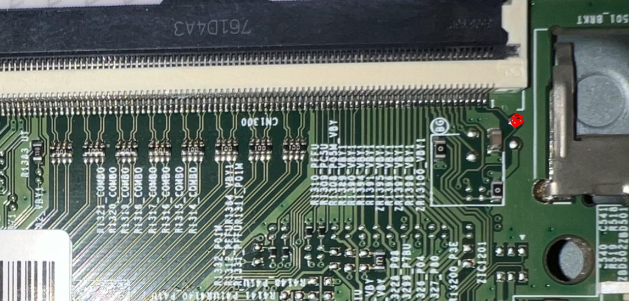

                                      #38
                                      now I have connected them correctly and the tv keeps restarting all the time, so the motherboard is bad??

                                        #39
                                        I don’t know, it’s not clear where, in one place there is a point, and its inscription in another, now on which half is the defect in the matrix?
                                        If the cable is inserted one of a kind, is there also a reboot?

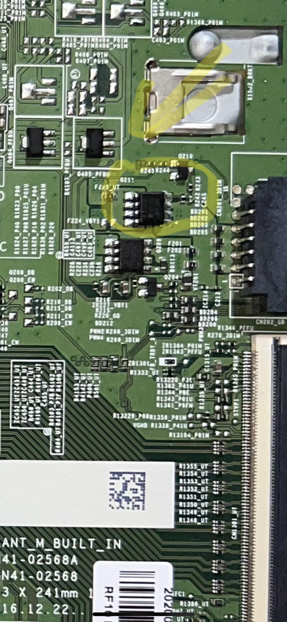

                                          #40
                                          at the point I indicated it does not restart, at the point you indicated it restarts, the flats are disconnected I have not tried to connect them
                                          from the tests I did yesterday by putting the tape on the left side flat it didn't go out but you couldn't see anything anyway
