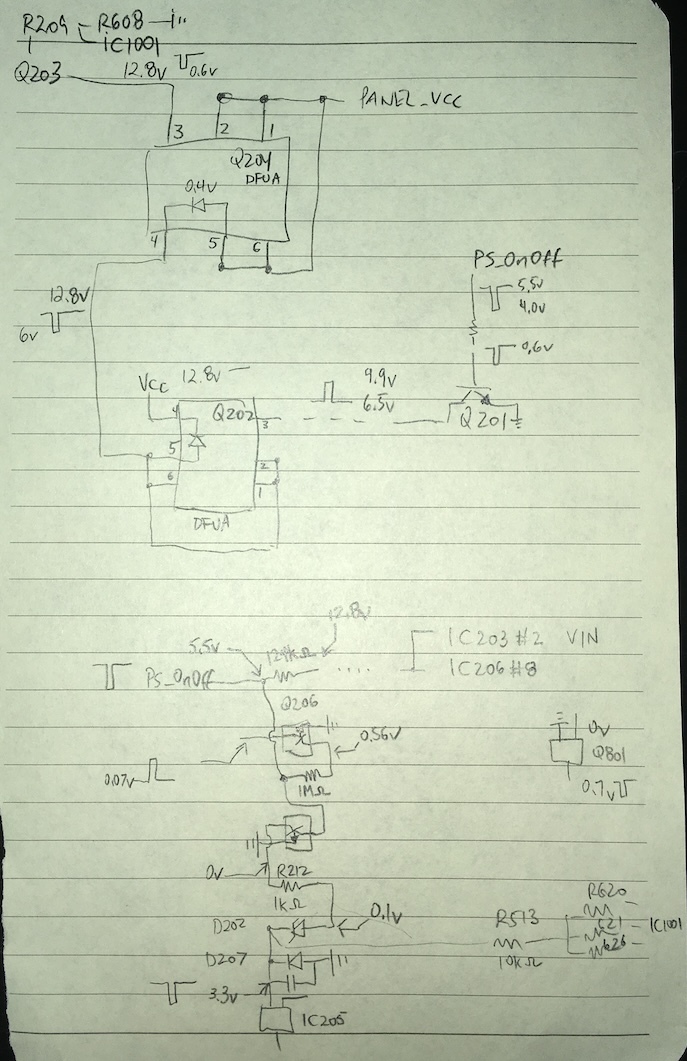

    Service manual "4-2. How to Check Fault Symptom" says "Check the Q206 base, voltage must be no larger than 0.5V​". Mine is 0.57V. Is this a significant difference?
    Q206 collector does have pulses at the same time as the standby LED, so it seems involved in the power-up circuit. But I don't have schematic so I can't really understand the meaning. And my meter is a little too slow to capture them reliably. I think most rails are steady (no pulses).

      Found another schematic, which seems a bit more similar to my device:
      https://www.eserviceinfo.com/downloa...ain%20sch.html
      Some things are more similar (Q207, 1.1V rail), other things are still different (input power, main IC, DDR).

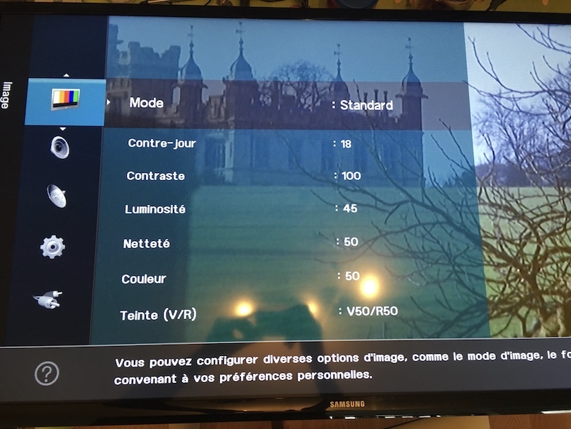

                    Okay, wow, I think I got it. It was a single bit flip in the SPI flash. Details below:
                    After confirming I could compute the CRC correctly, I thought most of the flash dump looked valid, so there must be only some very small corruption. Maybe it was a single bit. (I have seen this before on a cheap WRT54G router) So I wrote a script to brute-force every possible bit flip, and check CRC, it took 18 hours, and found one:

                    then produced a new file samsung-un40h5003af.bin-flip, flashed it, and it worked!

                        Some handwritten notes for main board power circuit.
                        Premium supporters get full download access and other benefits.

                          Trawling for info on "Eden" I was surprised to encounter a familiar name from my past life frequenting Foulab. It must be a small world for the handful of people interested in these chips.
                          Congratulations on the successful diagnosis and repair, and thanks for the writeup. I have a couple MSD3393 boards and--for a firmware reversing/hardware hacking novice like me, at least--this thread is an enormous help in figuring them out.
