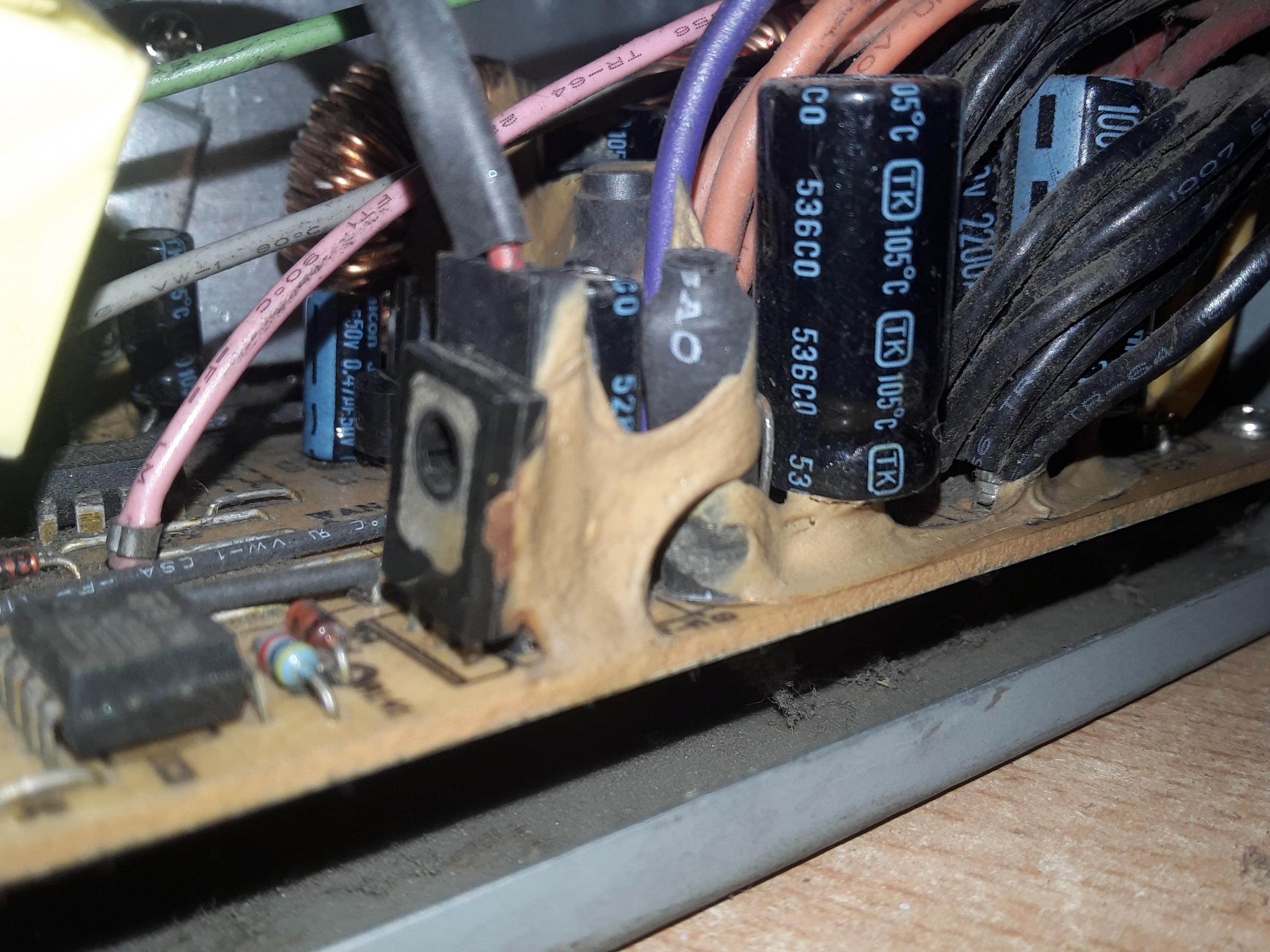

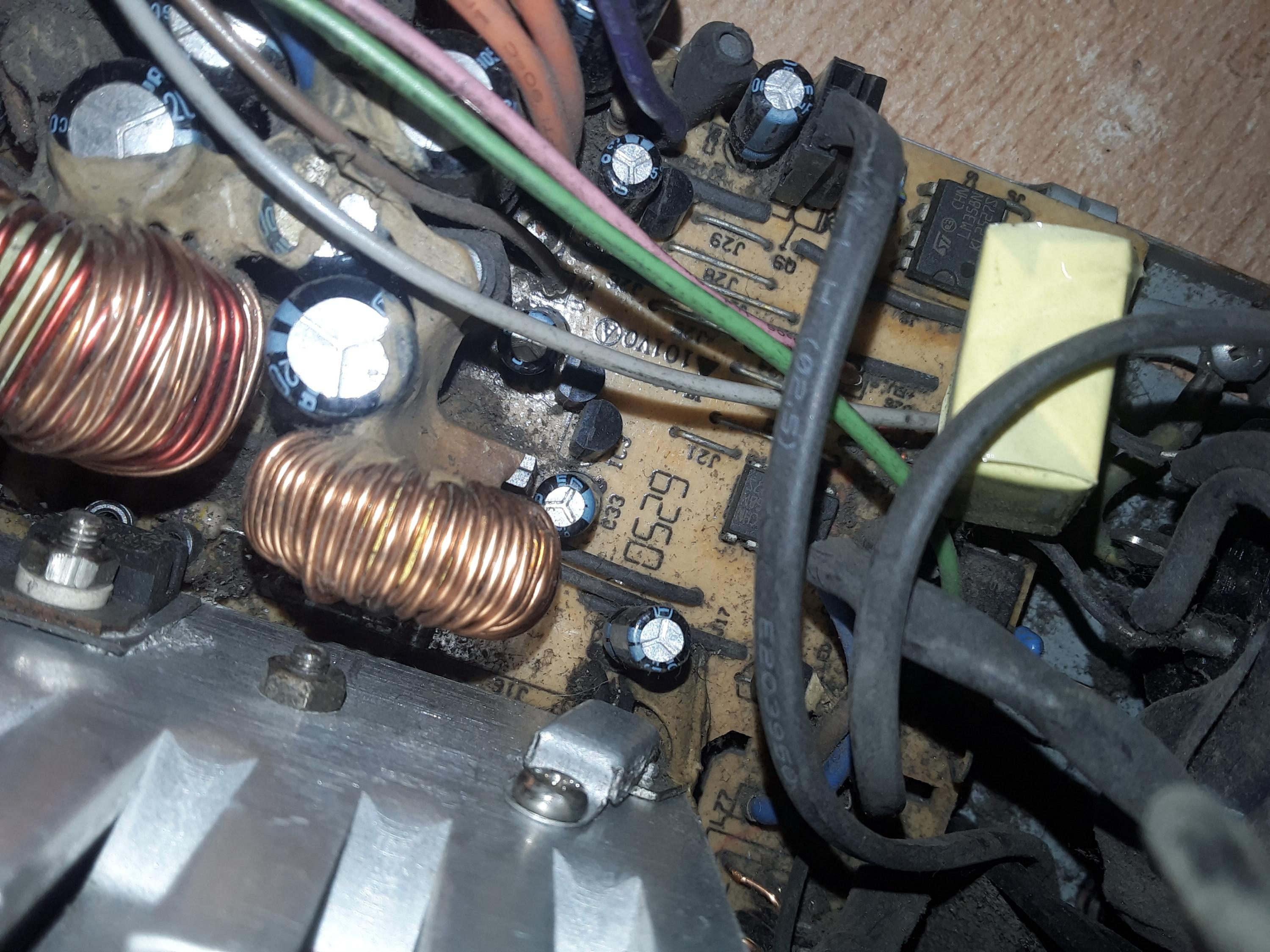

    "Looks okayish"?!
    WTF that's some of the worst soldering I have ever seen.
    And the bodge jobs, what the fuck?
    I was going to annote the picture but realized It'd be easier to just put a red circle around the whole thing!
    Looking back at it, you're right, but i can't change it to 'Looks like crap' now thanks to the time limit to edit posts.
    (Of course a mod can edit it for me (and cross out the '̶O̶k̶a̶y̶i̶s̶h̶'̶ part instead of removing it ))

      Originally posted by ruky con
      The resistor is for the LED and the output voltage is extremely unstable making this power supply almost useless.
      Well, with dry solder joints like that, I am surprised it works at all.
      Could also be that those 10V caps went bad or the startup cap is bad - those could cause voltage instability as well.

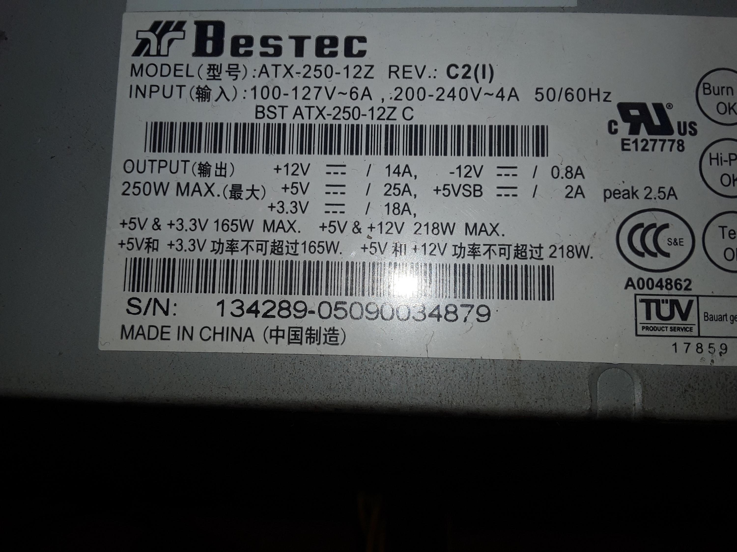

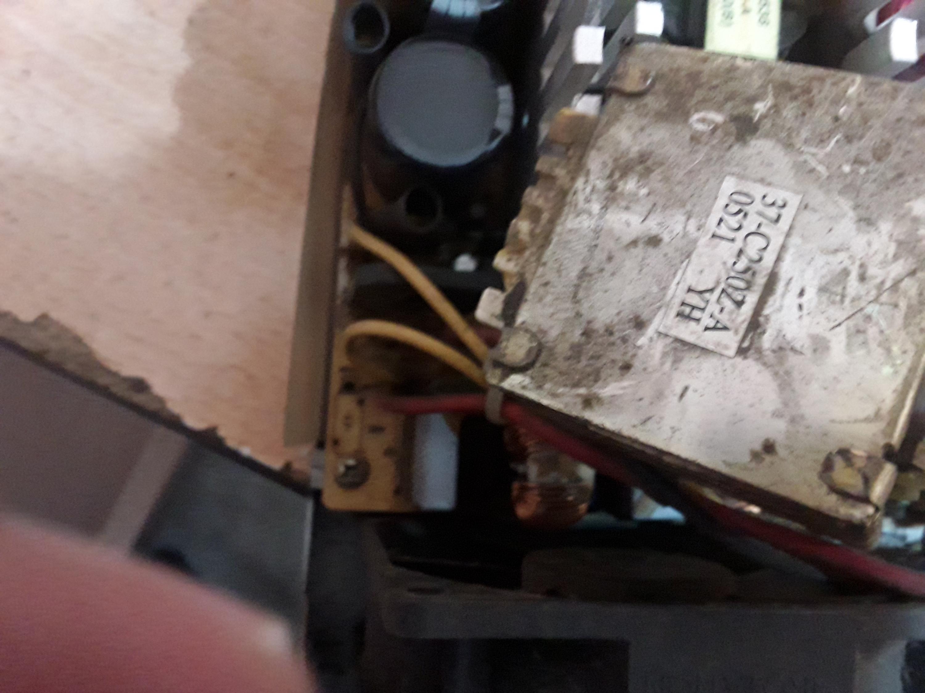

        Bestec-250-12 Z
        Ran 2-3 hours per day from early 2006 - late 2010, Pentium 4 506 + XFX FX 5200 (2008) ..
        his last words were -Little spark noise with some smell
        luckily didn't kill my Mobo
        XfX Fx 5200 with "EVERCON 125 c" caps is still working..

          That terrible conductive glue again
            It can't...
            Well at least with +5VSB Overvoltage.
            Because it has one of those 7/8pin Chips for +5VSB Generation.
              OTOH, the "E" version is known to kill motherboards! (Bestec ATX-250-12E)
              But the good news, the "E" was before 2005, IIRC.
                ^This, the "Z" variants still have Jamicon caps (and conductive glue in older ones) and thus still tend to fail after 3-5 years of use, but without the 2-transistor 5VSB and "critical cap" of the "E" models they generally don't take anything with them when they fail (While the "E" models cooked just about every early to mid 2000s E-machines motherboard since virtually all E-machines of this era shipped with a Bestec ATX-250-12E, leading to Bestec's infamous reputation of frying motherboards).
                    Thanks , so is this "Z" variant a decent design ? fully safe for other pc components ? and worth getting it fixed and a recap with all Japanese caps ? for a 120-130 watt system ?
                      It is a decent design, though an older one that won't be the most efficient, but should be fine for a low wattage system like you mention.
                          Yes, absolutely.
                          In fact, with good caps and most of the conductive glue removed (at least on critical parts), these PSUs become pretty reliable. The 12V rail has a rating of 14 Amps, so technically, you could probably power up to a 150-160W system (i.e. a 60-80W TDP CPU with a 30-45W video card and a single HDD).
                          Originally posted by dmill89
                          It is a decent design, though an older one that won't be the most efficient...
                          You'd be surprised. Many of the OEM single-transistor forward PSUs typically manage to stay up in the mid 70's % and occasionally peak around 80% efficiency. I know that's not great, but it's still much better compared to the low/mid-70's % *peak* efficiency of most gutless wonders.

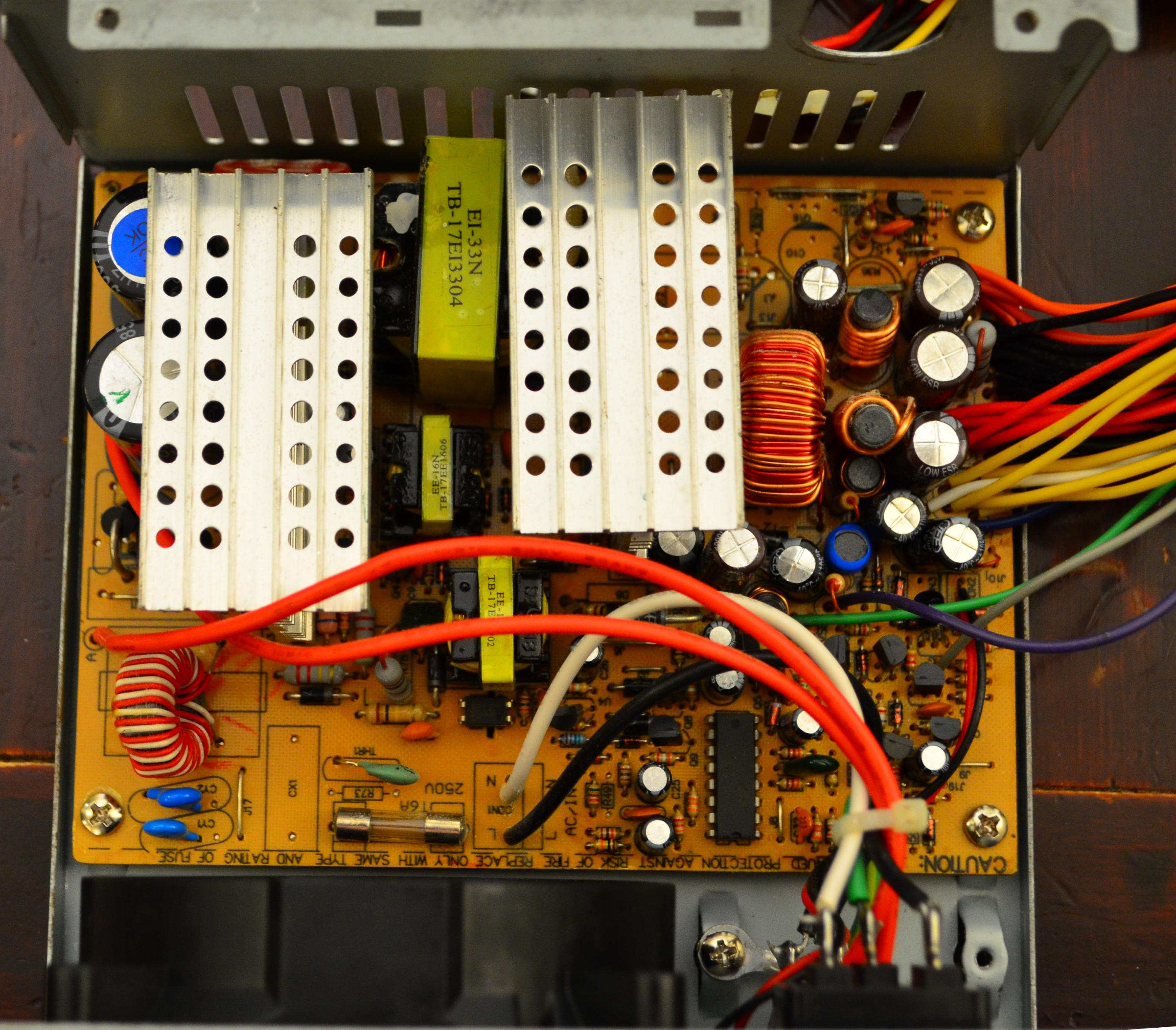

                              Here's a real turd, VIO "450W" (yah right) model KY-550ATX.
                              Here's what the manufacture claims (total BS):
                              Here's the box (this is an NOS display unit that sat on a shelf at a local PC shop for years):
                              Lets take a look in side... oh boy (note the bulged caps on the secondary):
                              Primary, 4 diodes for a bridge rectifier, missing filter components (has 2 y caps and 1 coil), a pair of 330uf 200V caps, and 13007 switching transistors:
                              Secondary has a F12c20c 12A 200V fast-recovery, SBL2045CT 20A 45V Schottky and CEP51A3 30V 48A MOSFET. Super-Group and JEE caps (2 of which are visibly bulged):
                              Soldering is pretty bad:

                              So the 12V rail is outside ATX spec (12.6V is max), 5V just barely meats spec (4.75V is min), and only the 3.3V rail is solidly within spec.
                              Got this as part of a lot of mostly older HiPros, those are useful for low-power systems, this thing is only good for parts.

                                  The moment I saw that model number, I knew it had to be a crappy Sun Pro / Leadman. Dan81 nailed it - it's an LP-7700 platform. Run away
                                  The only good thing about that platform is that it uses a KA7500 PWM chip, so you could easily mod it into an adjustable PSU and probably get anywhere between 1/2 to 2x the output on every rail (except for 3.3V).
                                  I'll probably test that on mine some day, but that would be whenever I don't have anything better to do (and I usually do). Right now, mine (KY-450ATX, posted in this thread many pages ago) is sitting in the closet, case-less, and recapped with crappy (but non-bulging) Stone caps that I got out of a Philips/Magnavox 17" LCD TV that I recapped many years ago. Half of the stone caps in that thing were failed, but the other half appeared good, so they got put back "in service" in this PSU. I figured a crappy PSU deserves a crappy cap job . Besides, anything is better than bulged CS and GL caps.

                                  12V rail at 12.767V... 5V rail at 4.8636V... 3.3V rail at 3.3554V ...
                                  I'm guessing that's with the bad caps.
                                  Mine squealed like a madman due to bad caps on the 5VSB. After the Stone recap, the output voltages were in spec, but... the whole thing just ran so hot. Efficiency must have been barely at 65%, if even that.
                                  Thanks once again momaka sir
                                  wouldn't bad Crossload performance and out of spec voltages be an issue with this PSU if used with a modern 12v heavy system ? something that 12E had like in this review ?
                                  http://www.jonnyguru.com/modules.php...tory2&reid=154
                                  The 12V crossload tests in that review are a bit unrealistic. All motherboard I have seen draw power from the 3.3V rail for the RAM (around 2-3 amps typically) and chipset draws about 2-3 Amps from the 5V rail. So with those slightly increased loads on the 3.3V and 5V rails, the 12V rail will regulate a lot better.
                                  Also, 13A of load on the 12V rail in that review corresponds to 156 Watts - that's more than enough for a Core 2 Quad with onboard graphics and a single HDD. Scale down to a Core 2 Duo, and you can add a 20-40W dedicated video card easily.
                                  Also this PSU uses jamicon TK general purpose caps , i'd like to use old motherboard japanese caps if it is safe and alright as too low ESR, it will be a lott cheaper , this PSU has been sitting in storage for past 8 years
                                  Should be okay.
                                  I did a Bestec ATX-300-12Z and ATX-300-12E with mostly Nichicon HN and HZ caps, and they both worked okay (no oscillations under load). On my ATX-250-12Z, I have a 16V/1500 uF Panasonic FL for one of the caps on the 12V rail, and it hasn't complained.
                                  On that note, the 5VSB and 3.3V rails in most PSUs are pretty much guaranteed to accept motherboard caps (the 5VSB is flyback-type, so ultra low ESR and high ripple current caps are okay with it by default, and the 3.3V in most PSUs is mag-amp regulated, so it's not going to care too much).
                                  The 5V rail is probably the only one where you should try to use more conservatively-rated low ESR caps (if possible), like Chemicon KY/KZE, Rubycon ZL/YXG, or Nichicon HE at most. But all in all, the Bestec PSUs from that era are not too picky about what caps you use. Given that they work with Jamicon caps that are close to general-purpose, you could probably even use general purpose 105C caps.
                                  That other PSU is just a spare testing sort of PSU , used for 20-30 mins max once every 5-6 months or so in an already semi-failing P4 system..
                                  The duration of the use doesn't matter too much. That PSU is just not safe and could blow up when you least expect it and take all your hardware with it. I just don't gamble with units like that. Loosing even a keyboard or mouse is worth more to me than saving money on using a cheapo PSU.
                                    Just for the heck of it I replaced the visibly bad caps (of course there may be more that aren't visibly bloated, but I wasn't going to waste the time to do a full-recap) with some spare caps (used take outs, not going to waste new caps on this thing) and re-tested, there wasn't much improvement (of course I don't have an oscilloscope so maybe ripple improved some).
                                    The 12V improved slightly to 12.759V, but still out of spec:
                                    5V and 3.3V about the same at 4.8383V and 3.3366V respectively:
                                    as for efficiency (or lack there of), this unit pulled 210W in order to produce 138W of power so 65.7%:
                                    Just for fun here is a side by side comparison with a (legitimate) 250W HiPro HP-D2537F3R that was in the same lot:
                                    • jarvis7
                                      • Feb 2015
                                          Lol, I guess it's just that bad of a power supply, then.
                                          Most likely Sun Pro / Leadman put a higher number of turns on the 12V rail, so that the 12V rail wouldn't dip so much with a heavier 12V load to make the PSU "compatible" with a more "modern" 12V-heavy PC.
                                          I guess my guess of "65%" wasn't that far off. That's truly terrible, though.
                                          A big part of that comes from the fact that this PSU uses a linear 3.3V rail that is derived from the 5V rail. So with your 12 Amp load on the 3.3V rail, the loses are (4.8383V - 3.3366V) * 12 Amps = 1.5V * 12 Amps = 18.02 Watts of loss just from the 5V-->3.3V rail linear regulator circuit.
                                          So I guess we can give this PSU the benefit of the doubt that with a more realistic PC load (either 5V or 12V heavy instead of 3.3V-heavy), the efficiency should be somewhat better - probably in the low 70% range. That's still laughable, of course.
                                          https://www.badcaps.net/forum/attach...1&d=1517441164
                                          Be careful not to drop that HiPro on the VIO PSU - it might just crush it completely. And then you won't be able to pull any spare parts from it whatsoever.
