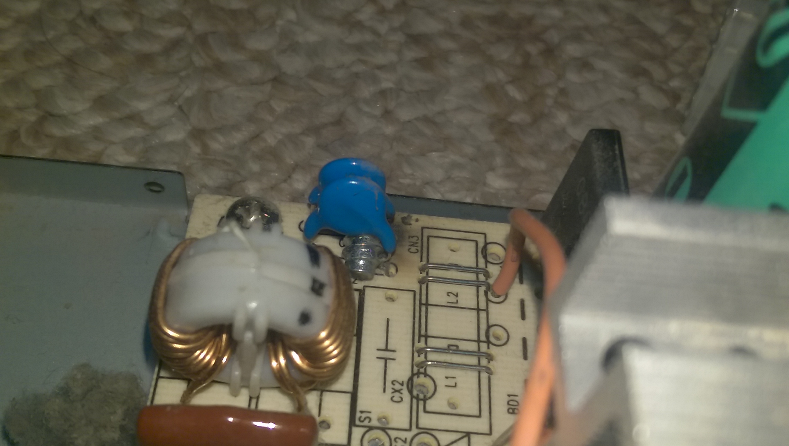

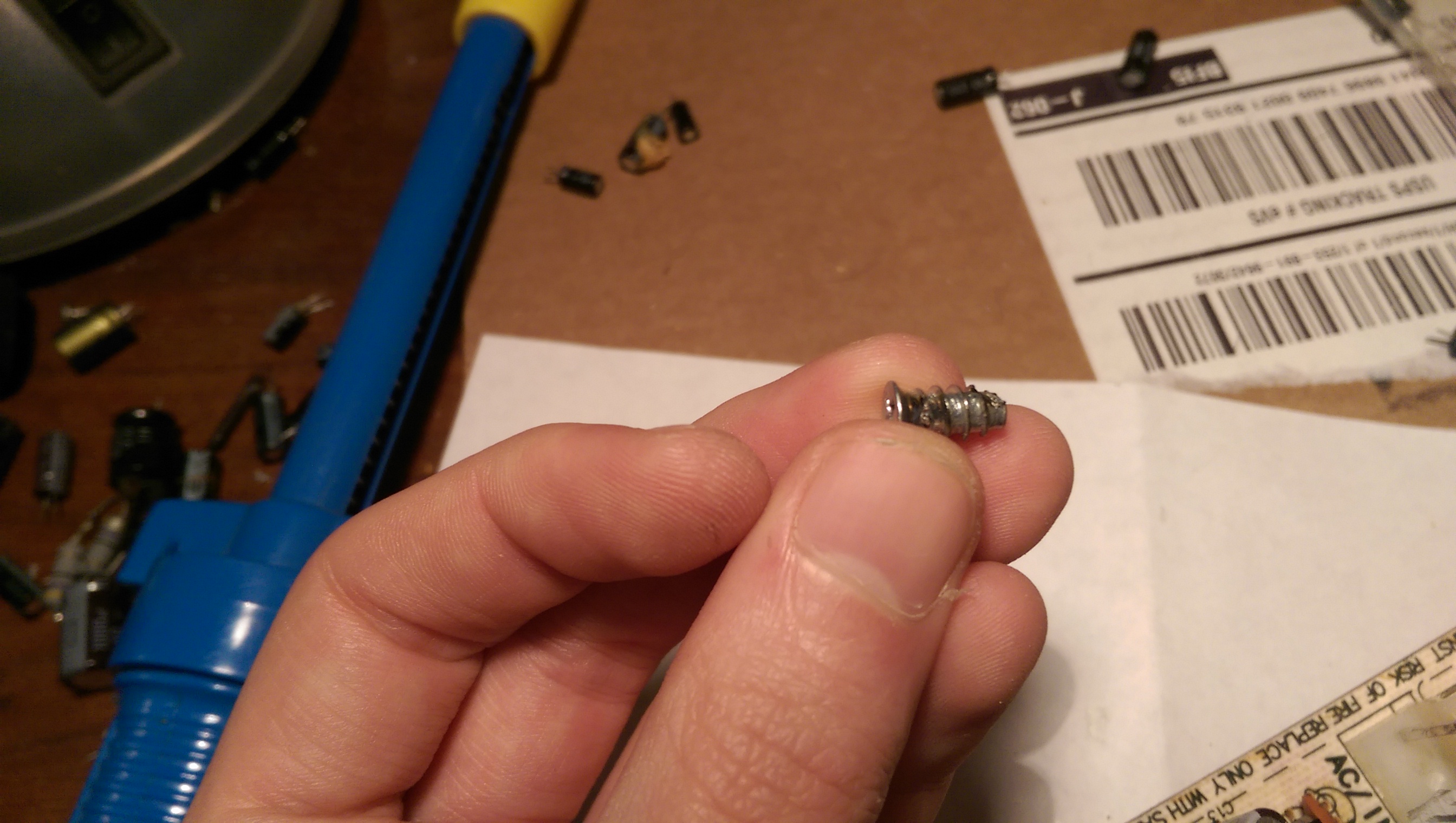

                        Check out this nonsense! I spotted this after testing the PSU. It powered up just fine. When I carefully removed the screw, the Y cap lead instantly broke! It was melted to the Y cap, so I can't really tell if this happened during manufacturing or if it fell in there. I think it happened in the factory, because it looks really wedged in there and I think it would be difficult for a screw to fall in like that.

                          Oh Deer! ????
                          Probably the screw made Live arc to Ground through it through the Y-cap leads, and that's why one of the leads melted to it. I've used this very same method to weld thermocouple wire together. (Though, I did it through a space heater in series, so the current was more controlled.)

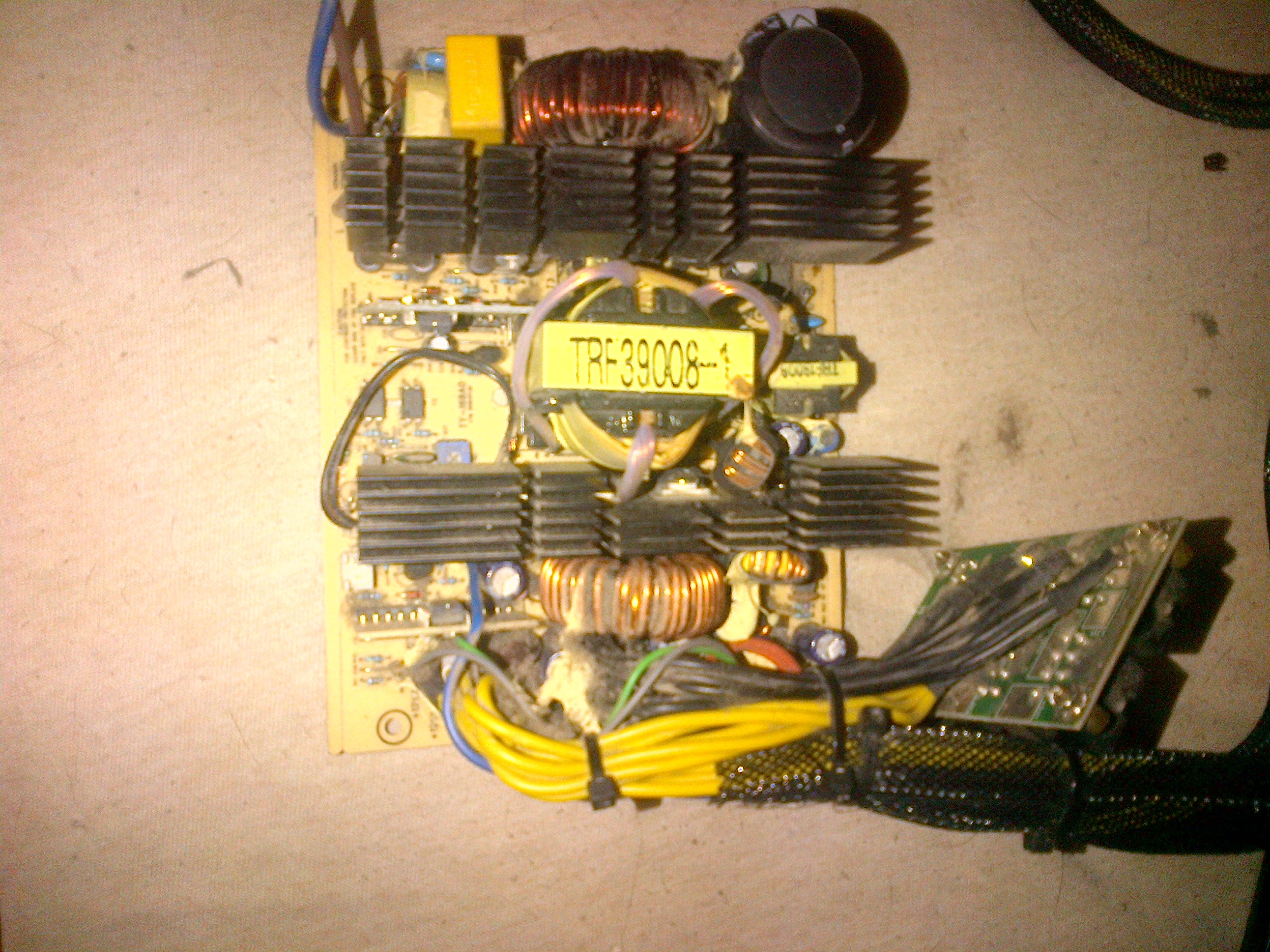

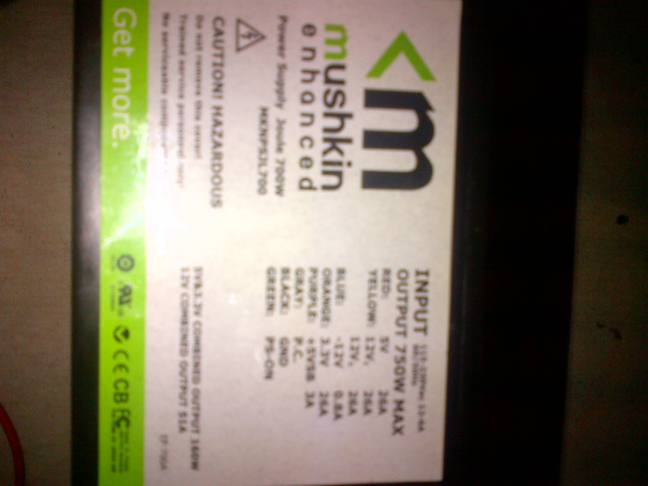

                                  Not much detail here... My media center/file server started locking up. It had failed POSTs, random segfaults, and udev hangs for a time before this incident. Those were signs i was ignoring. Today it hard locked, upon reboot it took 45 minutes to finish POST. I go through the usual steps, none work. So i pull out my trusty Tek 'scope and probe things. 3.3v is good. 5v has .3v of ripple, not so good. I get to the 12v rails and they have .5v of ripple.... HALF A VOLT! I cracked this thing open. Not the worst, but not good for a 750w PSU.
                                  To start off, Blackberry camera shot of the nameplate....
                                  mushkin MKNPSJL700.
                                  Now for the overhead
                                  Does have fan control. Heasinks are a little anorexic. Brown snot. Asia X caps.
                                  Solder side up!
                                  Not bad....
                                  Lifted pad on the PFC cap... (Again, sorry, i need to get my Moto fixed. This BB is shit)
                                  Damn... There goes the idea of fixing it...
                                    I wouldn't say the heatsinks are anorexic. If the PSU is efficient, those heatsinks should be good enough for the ratings. The Antec EA-500 I have has much smaller heatsinks than that, and it will do its 500 Watt rating no problem.
                                    The crap caps and the tan/brown conductive glue are a bummer, though - especially the glue.
                                    https://www.badcaps.net/forum/attach...1&d=1486176440
                                    Wait, you are not fixing the PSU?
                                    Seems like a decent unit. I would, at least. New high quality caps and an hour of work are well worth the peace of mind in knowing that you now have a PSU that won't crap out on you... well, IMO, anyways.

                                      It looks like the PCB snapped just a tad when he removed it from the PSU chassis. That's what he meant by not being able to fix it anymore.

                                          I will fix it I suppose. I don't like how the board is warped...
