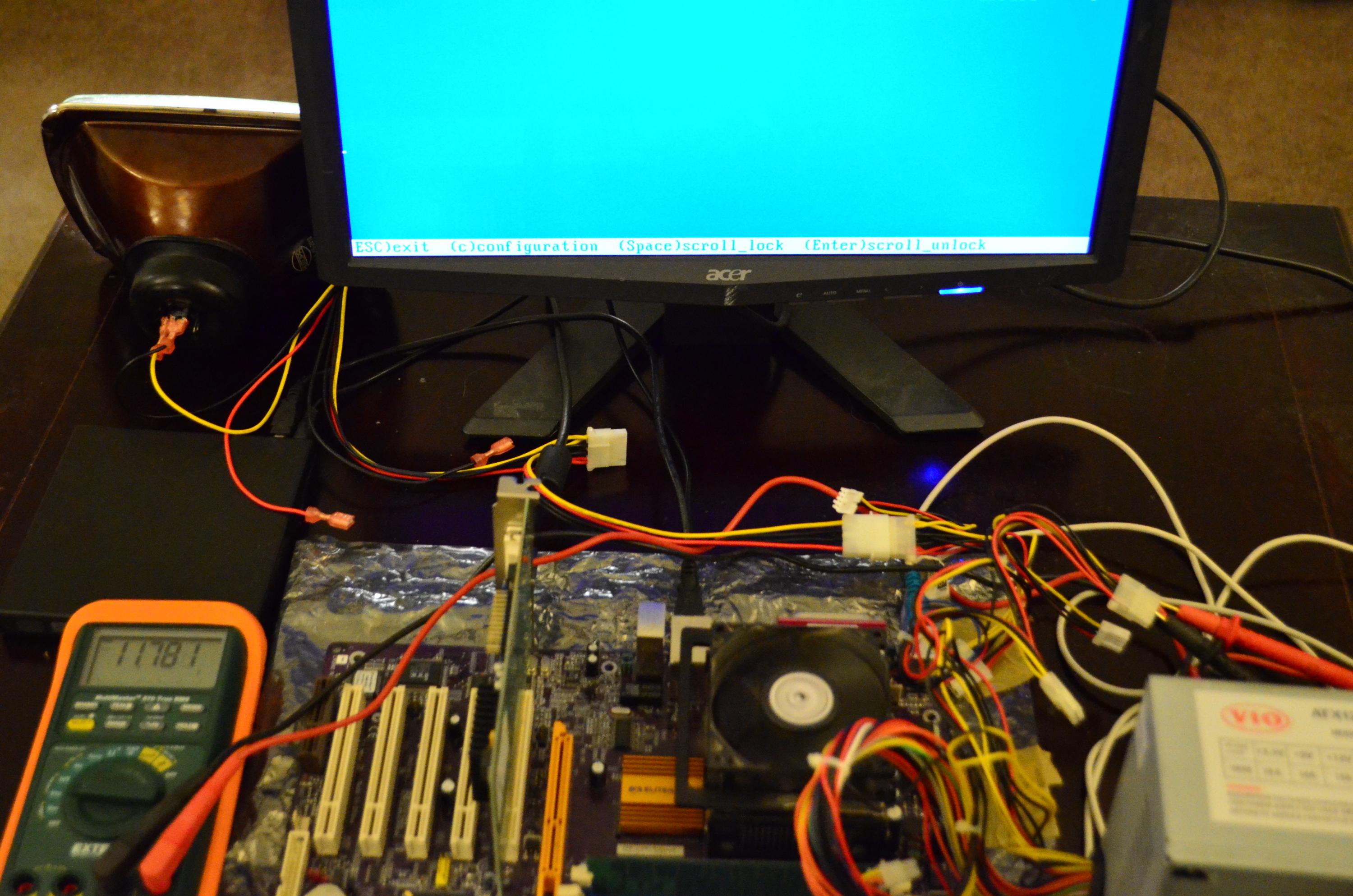

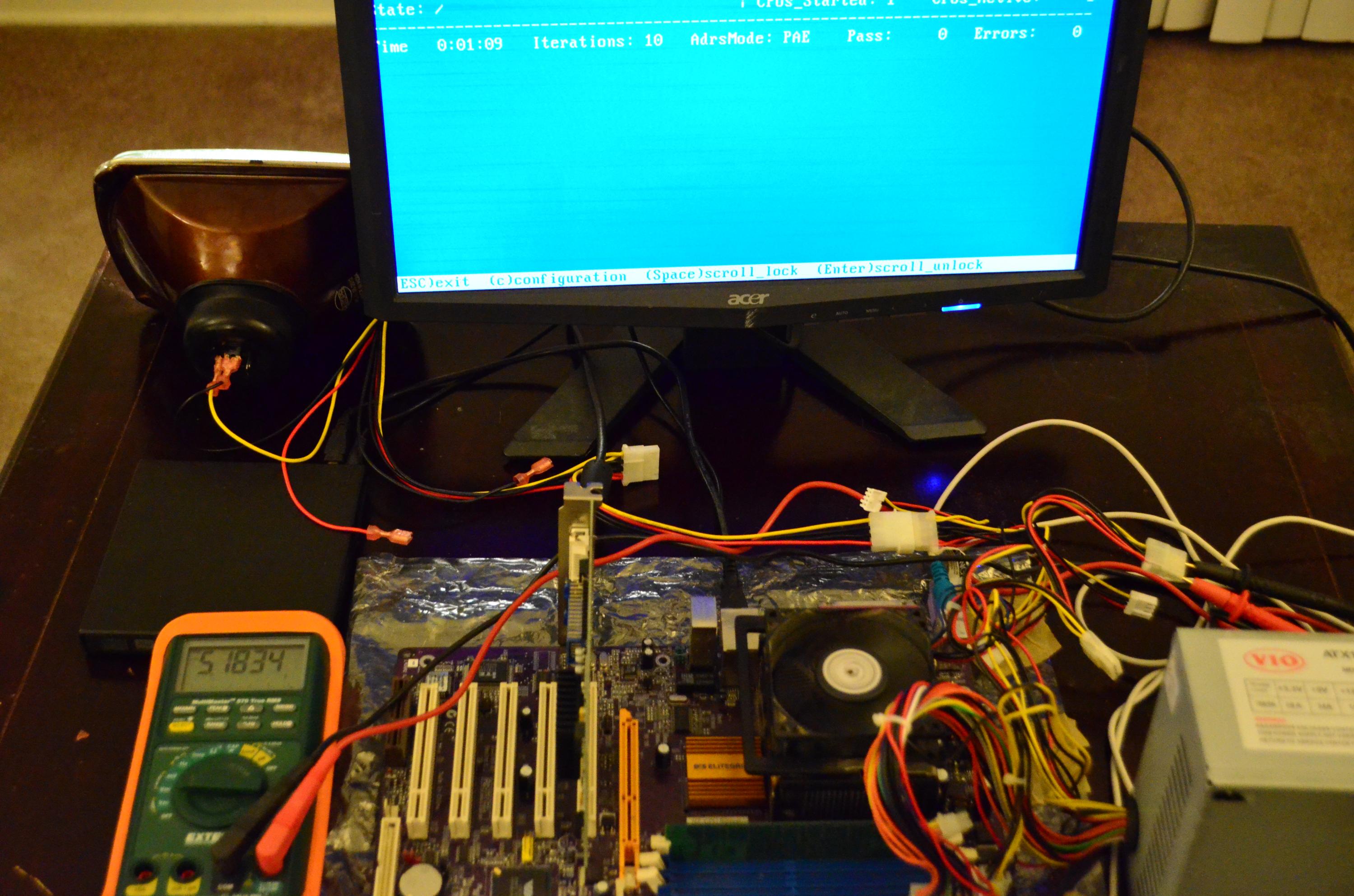

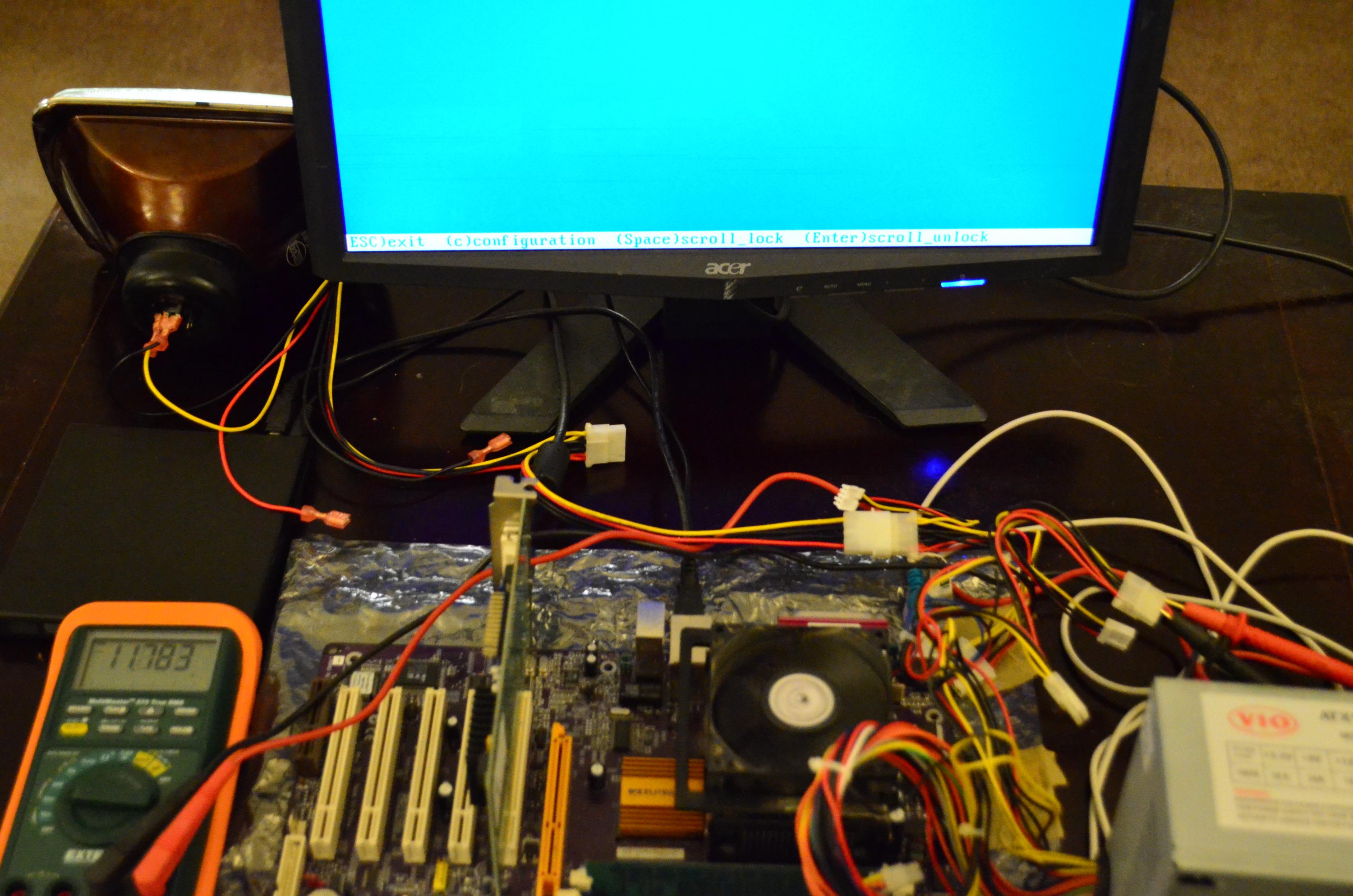

    in order to be a little more realistic I dug an old crappy motherboard (ECS L4VCA2 socket 478 board with a 2.5 ghz Celeron) I didn't care about (since the likelihood of this POS PSU blowing up and killing the board was decent) out of the shed, fired up memtest86 and added an additional 55W 12V load in the form of an automotive headlight to simulate drives and a load on the GPU (the CPU is 61W TDP).
    The results are interesting...., while all rails are now in ATX spec, the 12V rail is on the low side and dancing all over the place (note: the 12V pics were taken with my Nikon D7000's 6fps burst mode to give you an idea of how rapidly it is fluctuating, it went from 11.784 to 11.888 to 11.783, to 11.778, 11.781 in the space of about a second, I don't own an oscilloscope but I imagine it would look pretty bad on one):
    5V @5.1834V:
    3.3V @ 3.3618V:
    Its is drawing 167W to power what should be a 110-120W load, so efficiency is still in the 65-70% range:

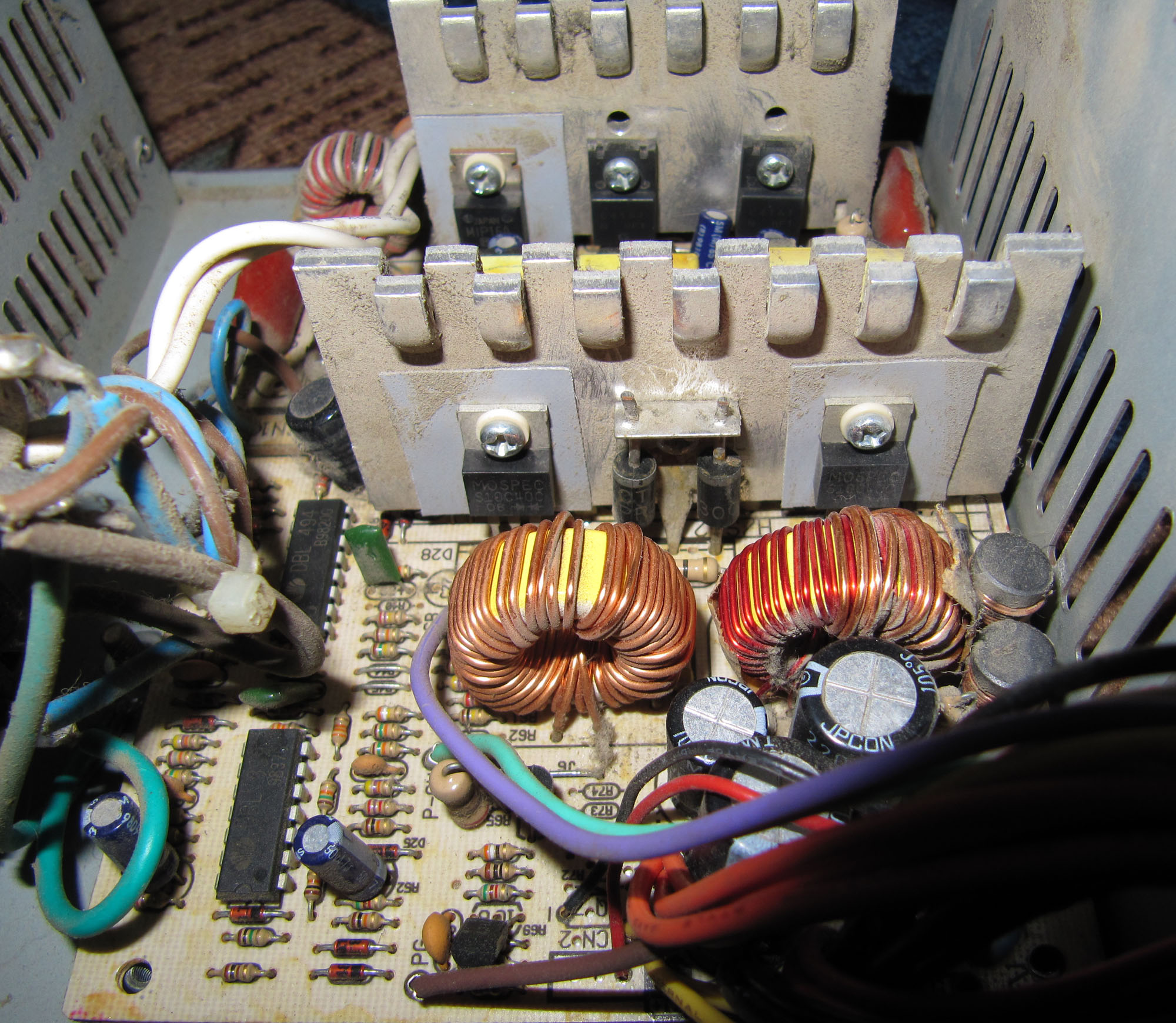

                  PAN STAR PSA-235
                  This is an ATX power supply made back at 1998.
                  It has been cleaned a bit, but still has tons of dust on it. Obviously, it has seen many hours of use. It's still in working condition Well, that was before I removed 6 Teapo caps from it. Sorry, I forgot to take pictures before that.
                  The label claims it's a 235W unit, but I don't think this is possible with that tiny main transformer and 220uF primary capacitors.
                  The main transistors are 2x C4161, I couldn't find a datasheet online, but it seems they are rated for 7A, lower than 13007.
                  5vsb uses a MIP160 IC! This is something I would never expect in such an old and cheap power supply. Unfortunately, it is not rated for more than 0.6A!
                  For 12V, we get 2 diodes on a bracket and the other 2 main rails use 10A rectifiers. The label rating of 25A for 5V is a blatant lie.
                  Any comments?

                      #1450
                      Re: the gutless, bloated, and fried power supply hall of shame
                      Ask and ye shall receive!
                      Those heatsinks actually look credible for 235W, likewise the output inductors. But for decent hold-up time it would need 470uF input caps. If you intend to use the thing, replace those 4700pF non-agency approve line-to-ground caps! The main transformer is also too wimpy. And those output rectifiers? 8A from dual axial lead rectifiers? 14A and 25A from what appear to be two 10A dual rectifiers? For how many milliseconds?

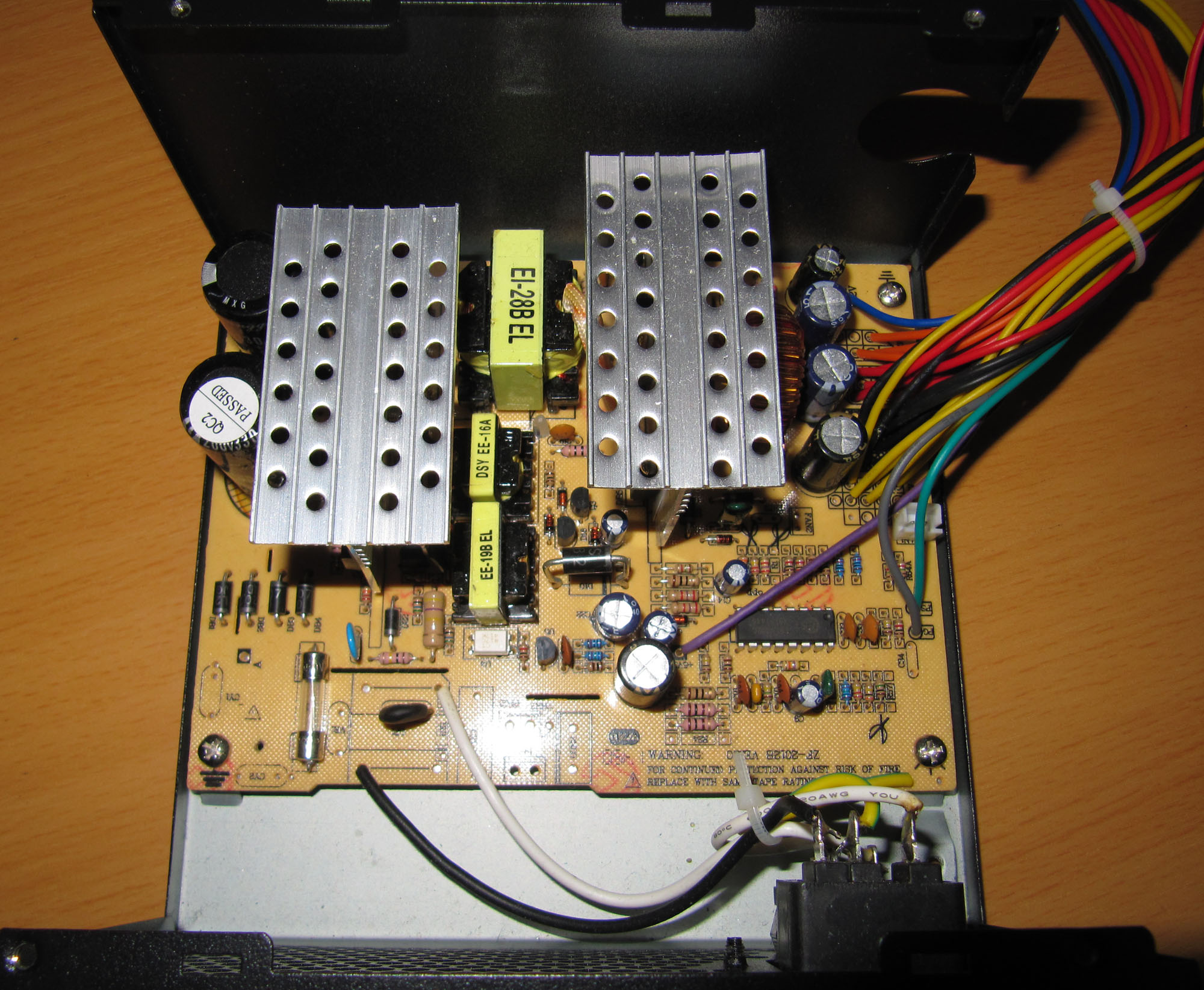

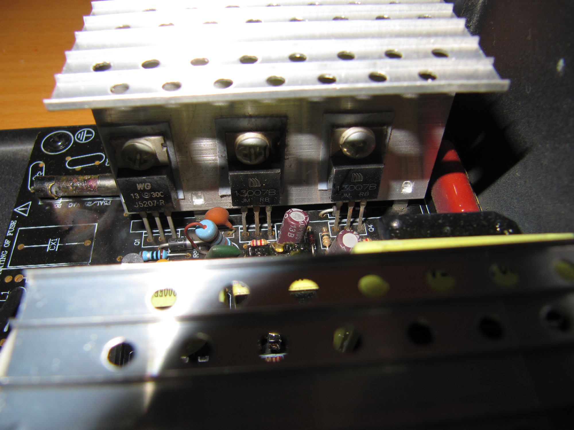

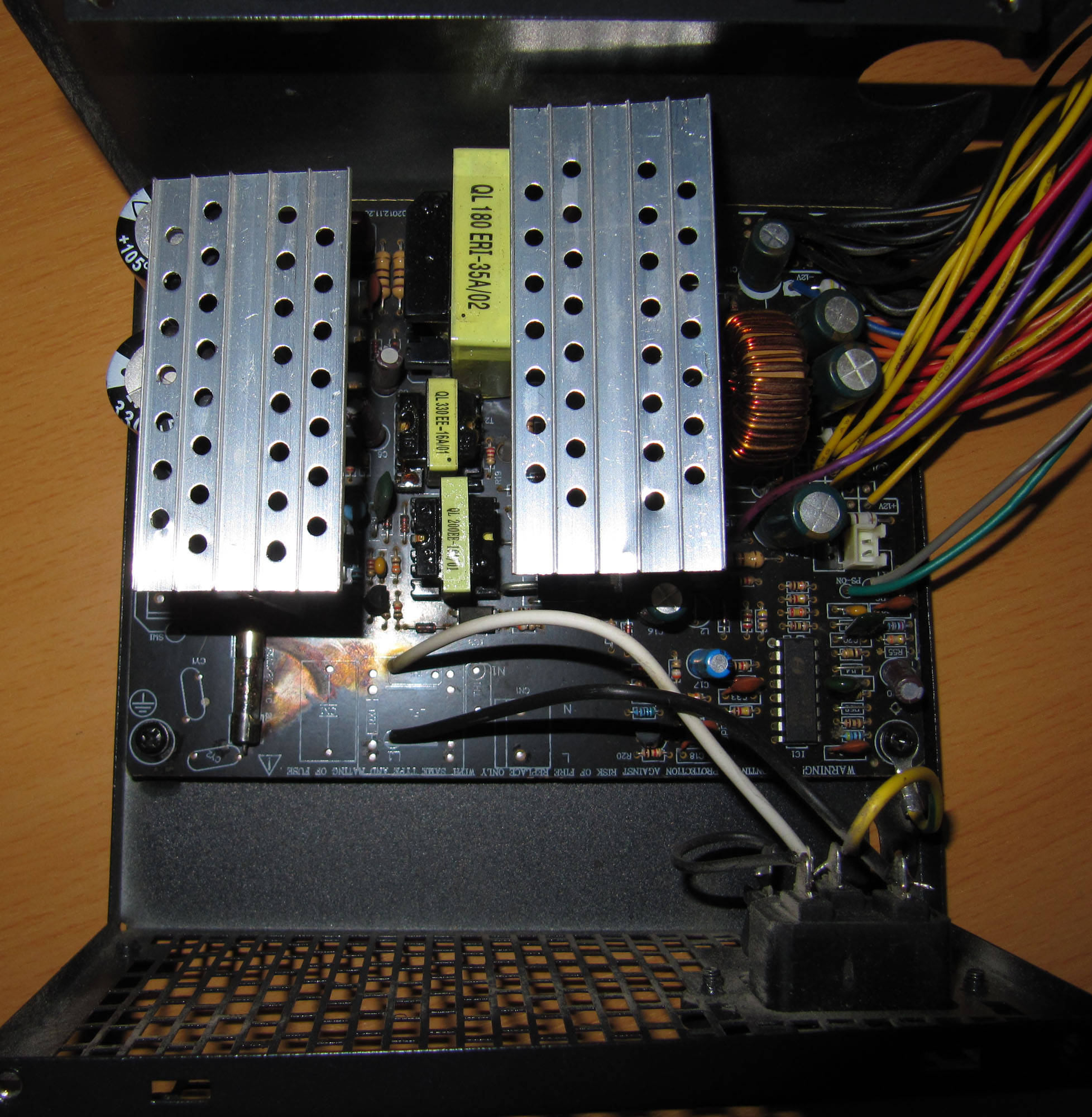

                          A dead Athena Power "Hercules" Model: AP-MPS3ATX35
                          This power supply came out of a PC i'm fixing up.
                          From what i've been told this PSU was purchased from Fry's Electronics less than 10 years ago.
                          So this is going to be the first PC power supply i'm putting here so apologies if i make any mistakes.
                          Anyways, on to the power supply.
                          Label...
                          Does not look bad but it will be in a moment.
                          Top Side....
                          Heatsinks don't look too bad but you may notice some stuff off about this supply.
                          Bottom side.....
                          Soldering does not look very good.
                          Primary.........
                          This does not look very good.
                          The switching transistors are 2 13007's (how suprising) while the one for 5VSB is a BU3150.
                          The wires on the common mode choke look a bit thin.
                          There's no varistor and the glue appears to be hot glue.
                          The capacitors are Cheng LS 470uf 200v
                          Time for the best (or worst) part, the secondary....................
                          The s20c45c diodes are for the 3.3v and 5v rails.
                          The f16c20ct diodes are for the 12v rail.
                          All of the capacitors are EJICON KF.
                          The 12v rail has one (badly soldered) 1000uf 16v capacitor with no PI coil.
                          The 5V rail has one 1000uf 10v capacitor with no PI coil.
                          The 3.3V rail has one 1000uf 10v and one 220uf 16v capacitors with no PI coil.
                          Both the -12v and -5v rails have one 220uf 16v after a small coil.
                          The 5VSB rail has one 470uf 16v cap before a coil and a 1000uf 16v capacitor after a small coil.
                          This does have a fan speed controller but the temperature probe had a 1cm gap between it and the heatsink.
                          Speaking of the fan, here is the fan.......................................................
                          Just your typical cheap fan.
                          Not much else i can say about this unit other then it's trash.

                          • goodpsusearch
                            • Oct 2009
                            • 2848
                            • Greece
                            #1453
                            Excellent pictures! Nice quality and focus.
                            Looks like the engineer that designed this thing was high! I really hate the way parts are placed on PCB.
                            • PeteS in CA
                              • Aug 2005
                              • 3578
                              • USA, Unsure of Planet
                              #1454
                              Well, if you put real agency approved Y-caps in place of those GP parts (and replace the fan if it's non-op) it could be a noisy but otherwise decent 225W-250W PSU. The output caps look like some less than excellent brand, though they haven't launched. Replacing them with something along the lines of PW or LXZ might be good, just because they're 10 years old. Giving the 5VSB circuit a look-over would be good, replace any small lytics. If there's room you might even consider kludging an OVP crowbar into the 5VSB output circuit.
                              PeteS in CA

                                #1455
                                The fan still works but the bearing might be getting a bit dry.
                                The "Y Caps" definitely need to be replaced.
                                And if i do try to fix this power supply i most likely will use parts i have on hand.

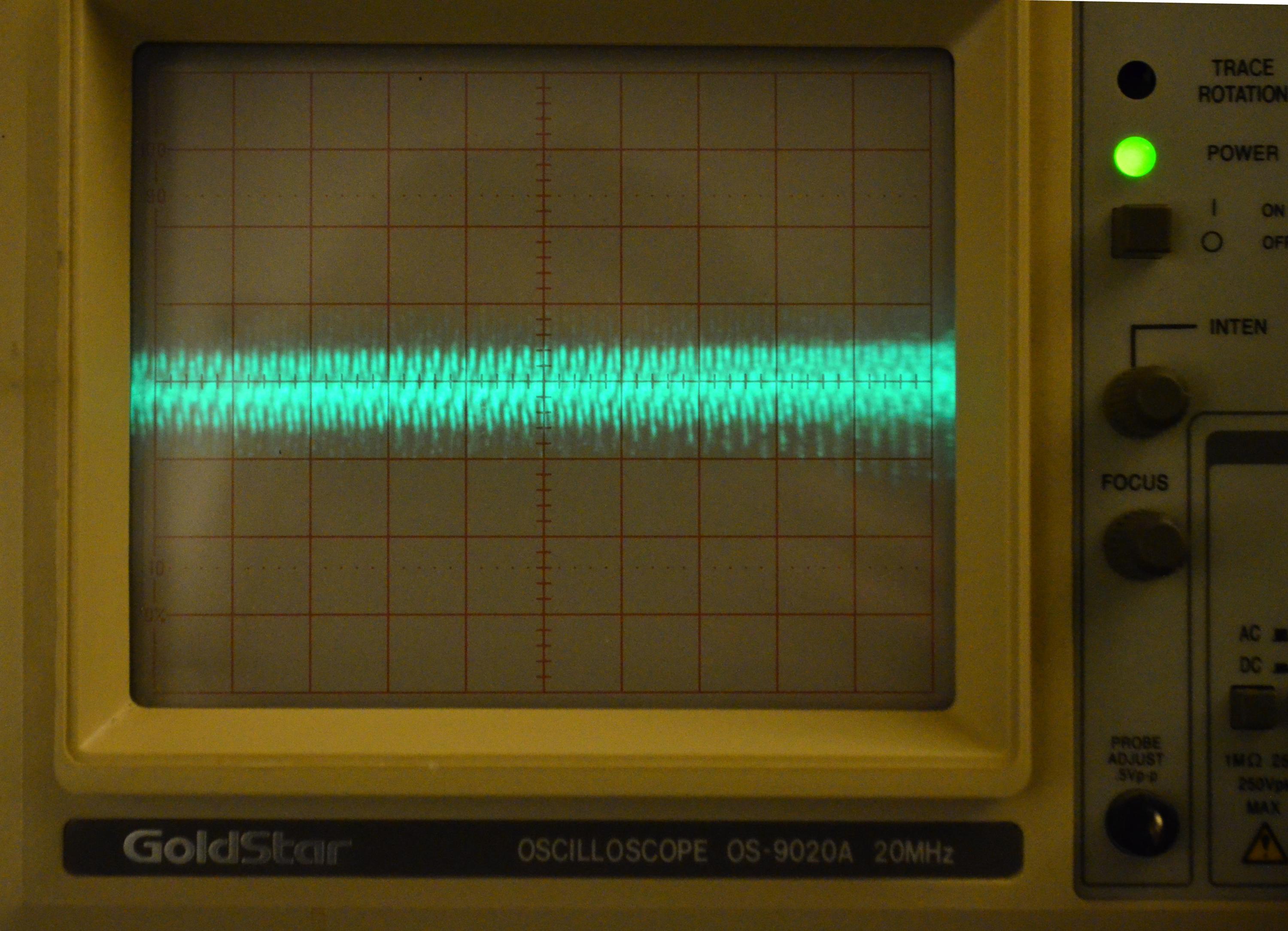

                                  dmill89: Just a tip, if your meter can handle somewhat high AC frequencies you can try putting it in AC mode and see what it shows on the 12v rail. (Cheap mans scope )

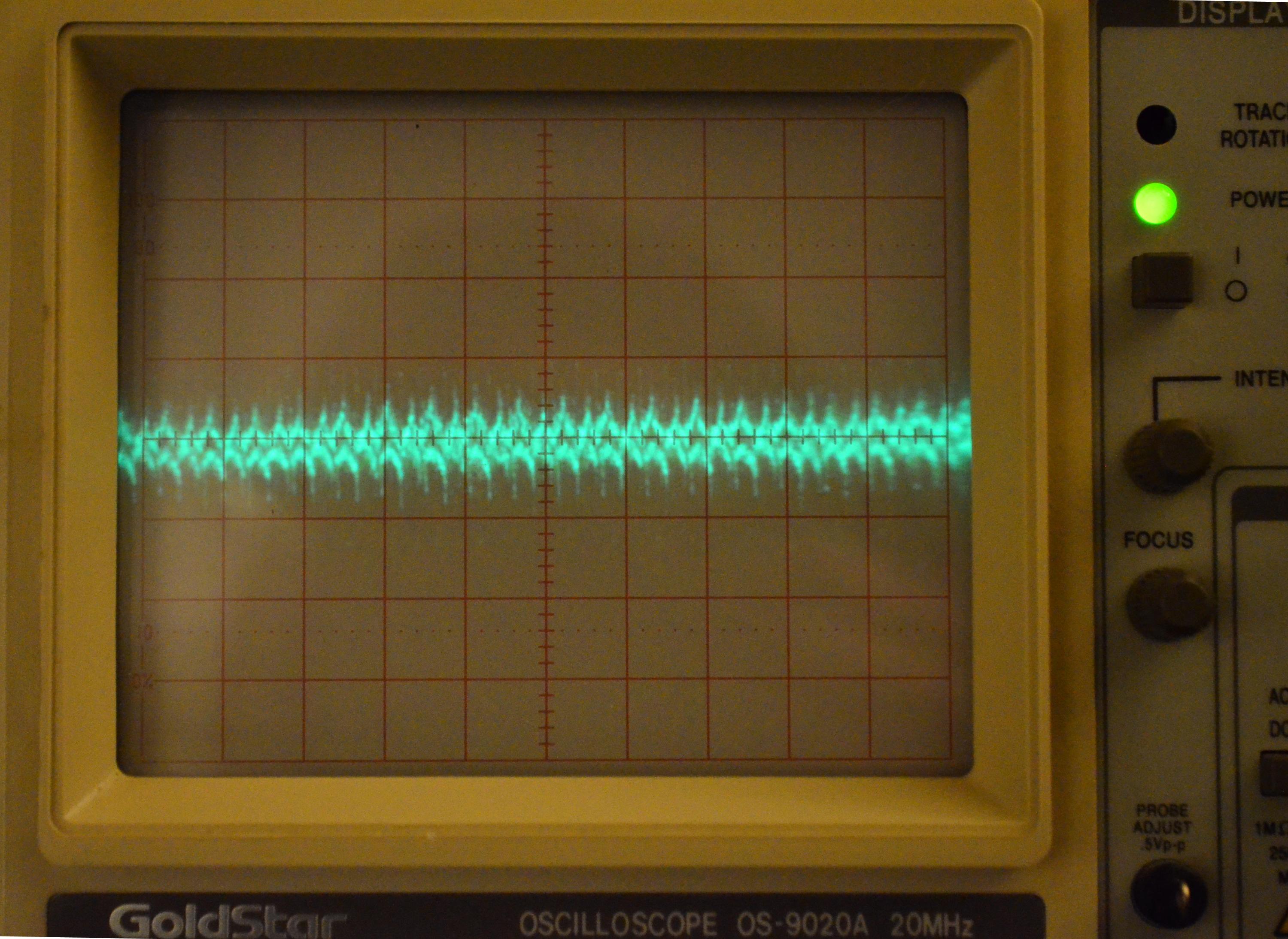

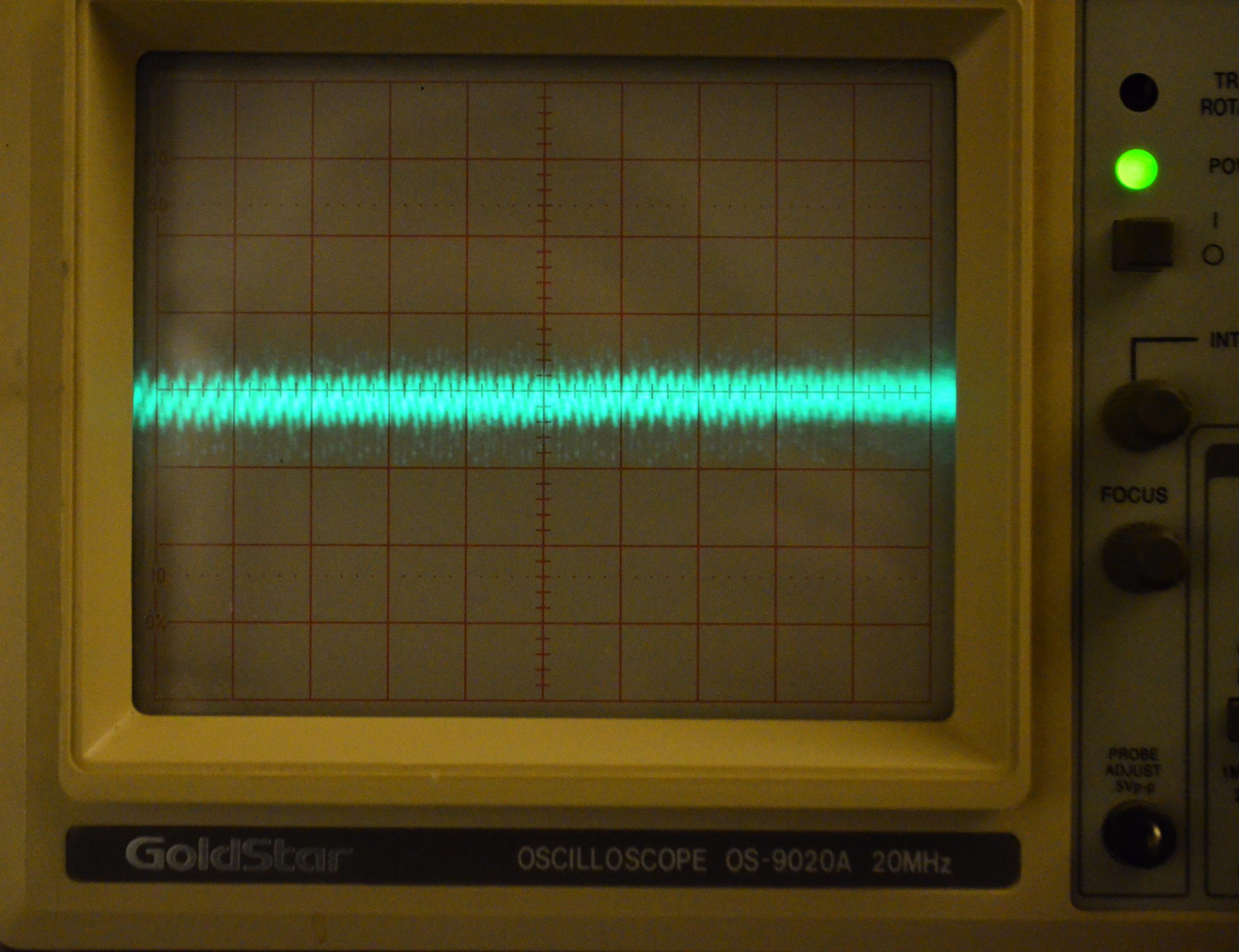

                                  I was able to get an oscilloscope (hurray for < $30 analogue scopes on e-bay) on this thing with the same load and the results are pretty bad. The scale is set to 50mv per division, looks like we're looking at 200mv+ (ATX spec is 120mv on the 12v rail and even that is pretty bad) spikes and a very solid 100mv+ ripple with a 110-120w 12V heavy load:
                                  And here's the 5V rail on the Seasonic tester with the 137W 5V heavy load, scale set to 20mv per division so we're looking at around 40mv ripple (50mv is the ATX spec on this rail):
                                  and about 50-60mv on the 12v (same 20mv per division setting):
                                  The 3.3V rail is surprisingly stable though, scale set to 10mv per division so right at 10mv ripple on this rail:
                                  While bad in general it does look like this PSU does handle a 5V/3.3V heavy load better than a 12V heavy one.

                                    #1457
                                    Nice score, $30 well spent!
                                    Yea the 3.3v on these supplies are usually really silent because they are usually derived by linear regulators from 5v.
                                    So in effect they get filtered twice...
                                    This was the PSU you recapped partially with used caps right?
                                    Still looks decent for what it is, I would not expect any miracles to happen even if you recapped it fully
