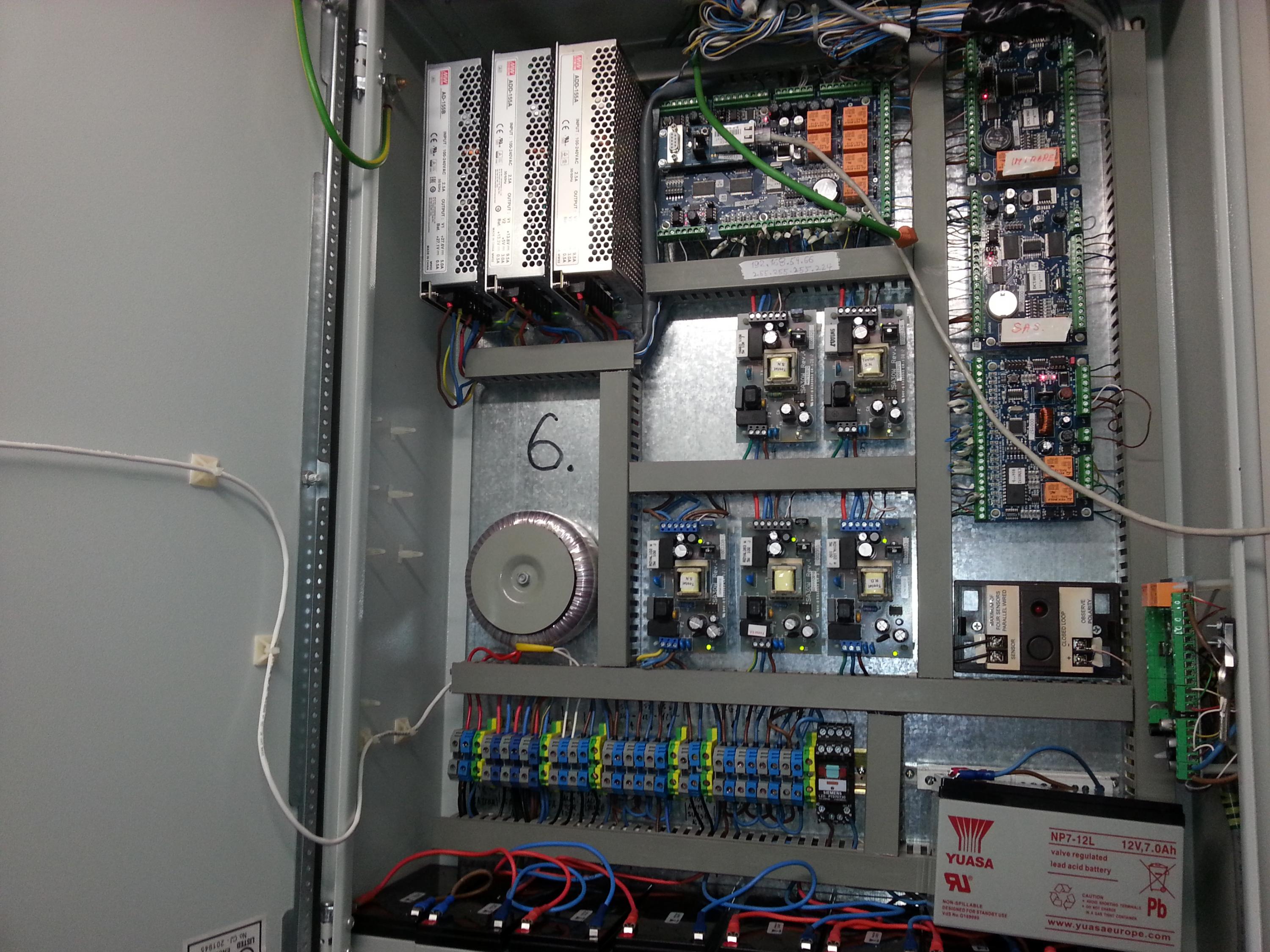

                      This is what it looks like when they're in service inside the panel (top-left) - don't think you can place your coffee mug in that orientation A fan would definitely be a good idea, but we're not really allowed to modify things too much in there, since I suggested that myself when taking up this project for the first time, but I was told it's best not to do it...besides, it keeps things running smoothly if you catch my drift
                      Not all of these panels are this packed: depending on where the container is located, the security systems may be more or less complex, hence more or less stuff inside the panel. This particular one is located in a "high risk" area, out in the middle of nowhere, with nobody around for miles to guard it, so it's got the most cameras, locks and sensors on it, hence the 3 supplies (+ the smaller "naked" ones in the middle of the panel). Others may have 2 or even 1 supply if it's placed in a more populated area or is guarded.

                          You'd be slightly disappointed to find out there's really not much, if anything, your run of the mill thief could value from these containers - just random measuring equipment and some plumbing. I can't imagine there's too many of those on Ebay, which would instantly track you down if you posted an add for one....whatever it is, since you wouldn't even know what it does (even WE don't, since those are not covered by this maintenance contract - just the security systems)
                          Getting INTO the container, even with no security at all, would take a bit of time, since it's surrounded by a fairly tall fence with barbed wire at the top, so you'd have to carry ladders, wire cutters and other heavy equipment
                          Each container also has a backup diesel generator, a large UPS after that AND individual batteries for those supplies (along the bottom of that closet in the picture), so power cuts were also thought of when designing these....pretty bulletproof in that respect.
