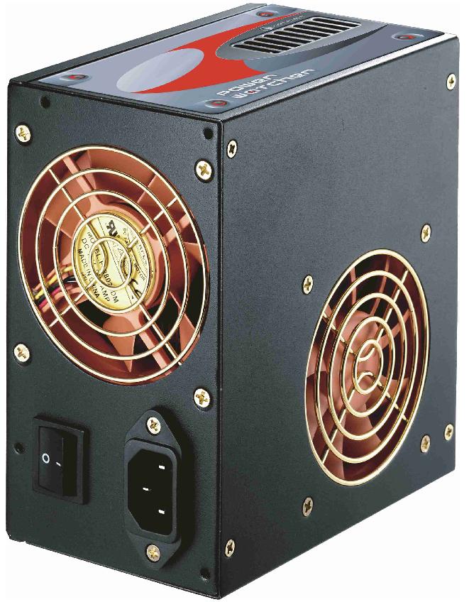

                      Thermaltake PUREPOWER-480AD ATX12V PSU
                      Fancy brushed aluminum plate... functionality? Guess again...
                      Teapo main caps...
                      And teapos on the other side too...
                      This PSU has not been used yet, so unsure of its reliability. I'd guess it's not too bad. Comes with a PCI plate or 5 1/4" drive bay filler for a fan speed knob, i think.
                      I think that was made by High Power, their HPC-480-102DF power supply has the same dual orange 80MM fans, black casing, and even the same amp ratings.
                      http://www.highpowersupply.com/produ...c480102df.html
                      High Power HPC-480-102DF
                      Dood's ThermalTake
