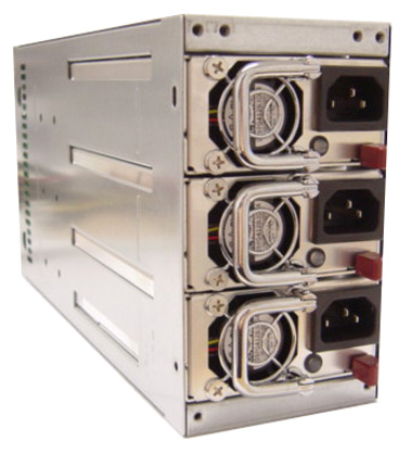

                              • tiresias
                                • Feb 2006
                                • 489
                                #115
                                Re: Power supply build quality pictorial DISCUSSION
                                Originally posted by Super Nade
                                O.K, I bought the Supermicro PWS-056 for $136 shipped from wiredzone.com (an authorized reseller). It should be in by this week. Then I'm gonna send it off to JonnyGURU, who's going to do a bit of toasting. Hopefully, I'll learn a lot of new thing from this.
                                Many thanks to Galvanized for pointing me to this unit.
                                Great idea, Super Nade... Jonny's testing will be sure to give us a reliable indication of the true quality and potential of this unit. (and the 0060 too, which is essentially the same PSU with a single fan).
                                All this talk of these great Supermicro PSUs isn't good for me... I'm starting to set my sights even higher now. And the next step up from the 0056 is, of course, this 500W, $350 masterpiece. It even fits perfectly in my case... help, the credit card is attacking me!
                                (PWS-0035), attached.
