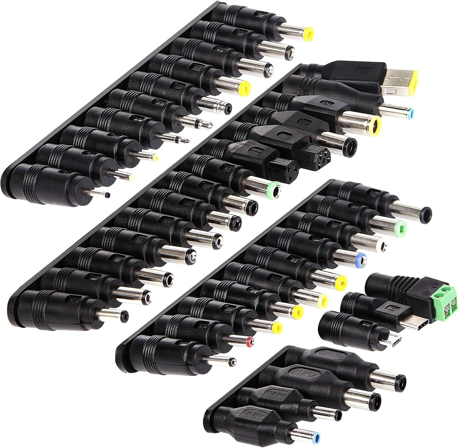

        Search for "universal laptop charger tips", you'll find a set for several brands, they accept a standard 5.5x2.1mm barrel plug at the input
        Those work for the "regular" laptops as the ID pin is set for 65W or 90W, at least on the ones I got for HP, Dell, Lenovo square plug
        For gaming laptops that's another story, you can probably take the cable from a dead charger and mimic the resistor inside the charger for HP/Lenovo, or program an 1-wire EEPROM for Dell with the correct ID for a 230W charger or something like that
        EDIT: Found a project on github for the Dell charger emulator with an ATTINY85
        https://github.com/KivApple/dell-charger-emulator
        EDIT2: I use a linear 30V 5A PSU, for injecting voltage into a shorted rail
        Haven't tested how a bench SMPS reacts to that, if it has short circuit protection it won't work for that purpose, unless the SCP can disabled by a switch (the PSU works in constant current mode, as set by the current limit, dropping the voltage while pushing current through the short circuit)
