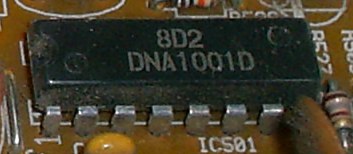

    About those Delta PSu we have, anyone have the datasheets for DNA1002 and DNA1001?
    days are so short when you actually do something..
    • starfury1
      • May 2006
      • 1256
      #162
      Re: Power supply build quality pictorial DISCUSSION
      Hi Yanz
      Not that I know of here but PeteS has post a bit of info in these forums
      Link here stating that they are custom made ASIC...(I think it was)
      The DNA1001D being "functionally similar to the UC3854 and UC3842
      combines a PFC controller and a PWM"
      The DNA1002D will most likely contain "error amplifier, opto driver and a bunch of comparators with a reference for fault detection."
      This from my query to him (Thanks Pete)
      He does "NOT" have block or pin out diagram for these chips
      (so please all spare him his pm box )
      His best advice was to contact Delta Electronics and ask support
      (I haven't as yet..yeah I know slacker )
      My searches on the net have proved fruitless Yantz
      (not to say info isn't out there I just haven't found it)

        Here was my PM on this topic to Starfury:
        These two ICs are Delta proprietary parts. Unfortunately, I don't have specs or pin-outs. The one on the primary side (1001?) combines a PFC controller and a PWM (functionally similar to the UC3854 and UC3842). If the controller bd. is only half populated, the PFC section is not used. The one on the secondary side contains an error amplifier, opto driver and a bunch of comparators with a reference for fault detection.
        My suggestion would be to send an e-mail to Delta's Sales and Support office, either in the UK or the US which can be found on this webpage. Ask them to e-mail you a pin-out diagram and a block diagram of the two ICs ...
        The specific suggestion of the US or UK offices has to do with Starfury being from the Land of OZ.

                          hitachi made that dna chip.
                          case style and lettering give it away.
                          look in old hitachi books for a possible match.

                            Found info via google which lead me back here to PeteS reply posted awhile back
                            kc8adu mentioned hitachi (thanks) and that was the only other thing that kept falling out but no pdf's or docs could I find
                            Japlytic has posted some info on pinout (part schematic) of the other chip DNA1002
                            in the orginal post from "larrymoencurly"
                            Delta proprietary chips? What are they?
                            I would like to say a BIG THANK YOU too, to all who help shed a bit more light on these chips
