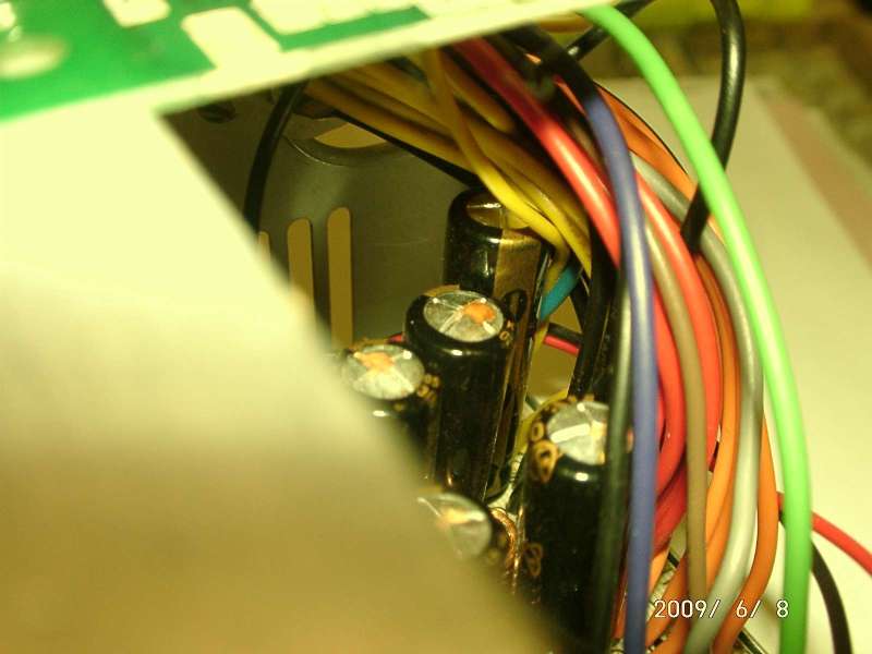

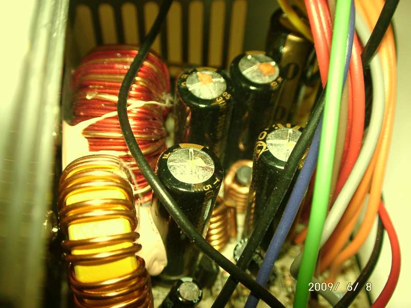

    So. here is the whole thing:
    current: ----------------------------replacement cap
    2x 2200uf 10v we 06201 ------------2x2200uf 10V nichicon VZ(m) H9427
    3x 1000uf 10v we 6301 --------------3x 1000uf 16v Rubycon ZL T0645 PET
    (these r the best i can get 4m my location. )
    if im better of with my stock caps please suggest me so. thnx
      Well, the Rubycon ZL caps should be appropriate, as they are a Low ESR / High Ripple Current cap.
      The Nichicon VZ is only a high temperature General Purpose cap. The 2200/10 only shows 920ma ripple and no ESR rating at all. A suitable PW 2200/10 is rated at 1815ma Ripple and .035Ω ESR
      So those VZ caps can handle maybe 1/2 the ripple that a more suitable cap would.
      That might actually be better than your old ones depending on how well those "CS" or "SC" caps have aged ... and if they were any good in the first place!
      I would try to get some reasonably close Rubycon ZL in maybe 1800/10 or even 1500/10.
      If you can't get any Low ESR caps, the high quality Nichicon VZ are a better bet than re-using the old crapacitors, which according to "CS"'s own website are only good for 633ma ripple! When they were new!

        Those VZ also have date code for 27th week of 1994.
        -> H9427
        15 years is pretty old.
        Between that and what Keri said I suggest getting better caps.

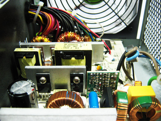

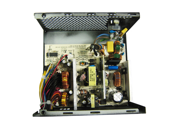

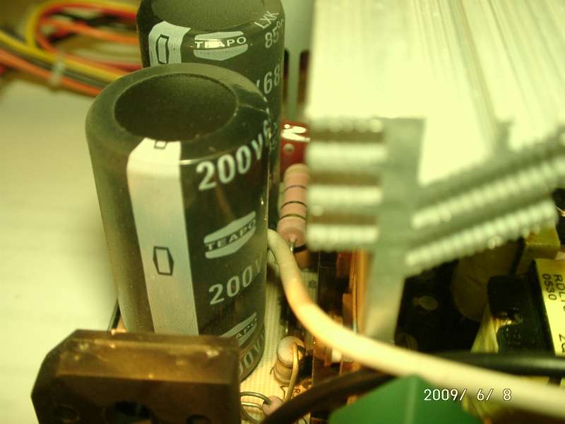

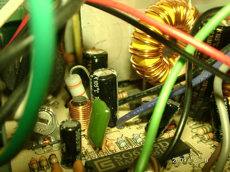

                      Delux 500 watt PSU
                      actual watt 300 ... written on the PCB and checked marked by a pen.
                      Model: DLP-50A
                      12V1 20A (12v1 and 12v2 are physically seperate)
                      12V2 22a
                      5V 18A
                      3.3 28A
                      5 vsb 2.5A
                      -12V 0.5A
                      230V at 50hz 4A
                      ACtive PFC circuit visible ( so i know its there)
                      please comment on the biuld quality.

                        #231
                        Re: Power supply build quality pictorial DISCUSSION
                        Overrated at least: poor assembly; thin cables; small heatsinks; small transformers; one small, OST brand primary capacitor (1st pic, low right corner and 2nd pic on the left), I suppose an OST RLG 180uF 400 V which is adequate for a 200-250 W psu and anemic for anything bigger. On the good side it does have a complete input filter and boast active PFC so the manifacturer didn't spare on everything: detailed photos can help in identifying other capacitors and such.
                        Zandrax
                        Have an happy life.
                        • yanz
                          • Nov 2004
                          • 910
                          #232
                          looks like built by FSP/Sparkle. the view of secondary side isn't too clear, u could try posting bigger images.. yes the transformer looks small, but i'm not sure if it's because of the angel/camera..
                          maybe the psu has high efficiency, but those small heatsinks are really giving impression of cheap cost cutting PSU. really a bad look, but i dont know bout the functionality..
                            I think yanz is right, it looks like an fsp.
                            They are notorious for those small heatsinks on their cheaper units (see:antec basiq)
                            The thing that makes it look really like a fsp is the fact that it is complete, and is actually neatly laid out, and uses a rectifier instead of 4 diodes. Just has those tiny heatsinks and the fact that its way overrated.
                              Damn that power supply has tiny heat sinks.
                              My current power supply has active power factor correction and its absolutely packed with components. It may even be a bit too dense. Too bad it has crappy caps.

                                #235
                                In the seconds pic, you can see the letters "SPI" on the main traffo, so it must be a Sparke/FSP unit. It does look a bit dissapointing (for 500 watts anyways). I'm not sure if it will stand behind those ratings, especially with those primary switchers. The heatsinks have good thickness but no fins, so their heat dissipating capability could be limited. Size of main traffo looks small too, but it could be just the angle like yanz mentioned. My guess would go with the 250 watt rating as well (maybe 300W on a good day).

                                  #236
                                  Model: DLP-50A <<- Not a Sparke/FSP number.
                                  Delux <<- Is an actual Brand name.
                                  Who says Sparke/FSP doesn't sell just transformers?

                                      #238
                                      That's a 300W lower end FSP being marketed as a 500W. Even the housing styles on the Delux site scream FSP. It's probably fairly efficient being built on the general Epsilon platform, but not 500 watts efficient.

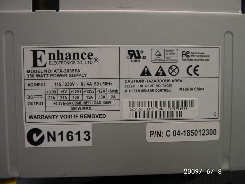

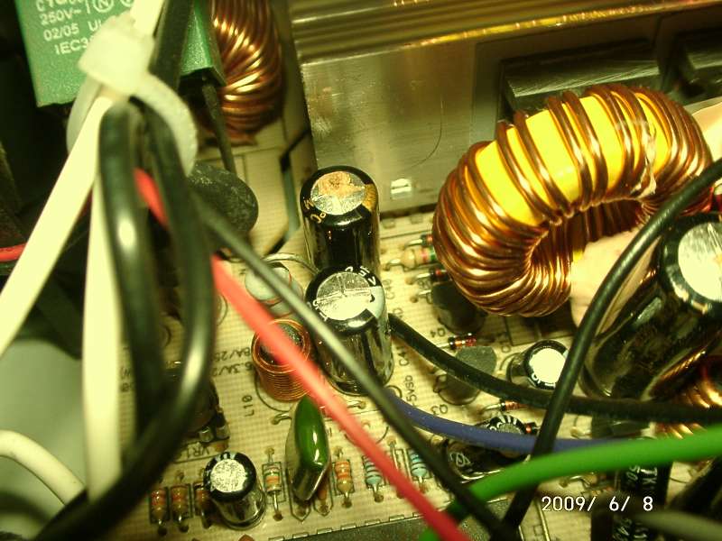

                                        Enhance ATX-2035FA
                                        Pull this out of an Asus case. Looks like came with the case and had been in use for close to 3 years.
                                        Won't power on and looks like bunch of bad caps:
                                        The heat sinks are not too thin so I guess I will recap this for testing...

                                          hmm, that UL leads no-where.
                                          Actually looks decently made.
                                          Those caps are YC brand, definitely get rid of all of them.
