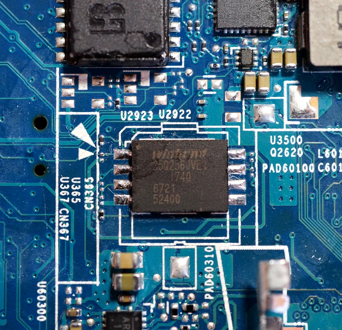

    I soldered back the 32MB chip but maybe I killed it as now I get flashing power light. Will have to try a new chip before I flash the other 16MB I think.

        Thanks, I tried this- now the keyboard/powerlights come on, then the power light flashes orange 30 times, then 7 times & it powers off.
        I haven't flashed the 16MB chip yet as I wanted to make sure I fixed this problem first, but should I flash it to work with your file?

          Hello, you must first solve the 32mb chip, it must turn on again, locked, leaving your original copy, if you still have no image, you must check the soldering of your chip on the board, you must also check the components that are around your chip, maybe some microcomponent came out. Upload an image of that sector to verify...

            Thank you everyone for your help, I tried reflashing my backup & resoldering but the same problem.

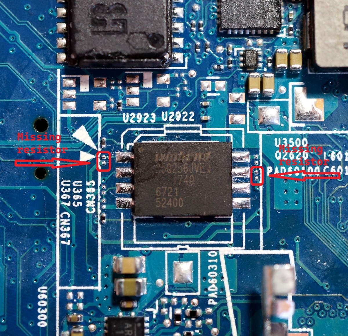

              • aldopc
                • Jul 2017
                • 484
                • Chilito
                #227
                Re: Hp ellİtebook 840 g5 bios password
                Originally posted by Vesko356
                Correct, you lost 2 resistors, the one on the left is 468 kΩ and the one on the right is 0.02 kΩ

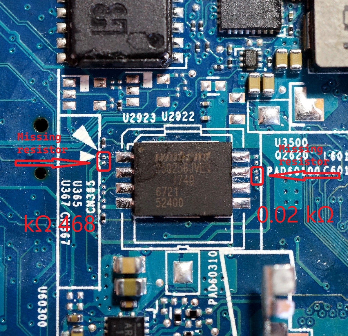

                • q2v5
                  • Sep 2023
                  • 7
                  #228
                  @Vesko356 Thanks, guess it's time to buy a microscope..
                  Thanks also, will order those values & be more careful.
                  • klasg
                    • Aug 2023
                    • Sverige
                    #229
                    Do you know the values on the other 2 resistors around the chip?

                          Thank you for that. I flashed them both but the laptop is still a no boot. Fan up full, power consumption stuck at .256a. CPU is freezing. Any ideas? It was booting now I seem to have murdered it!

                            Replace a blank chip and flash again

                              Do you mean blank the chip or replace the chip with a new one? Do you mean replace all chips?

                                Yes ! Have you read article 226 yet?

                                  Thank you, I accidentally knocked this off. I've replaced it and now it's booted! Thank you.
