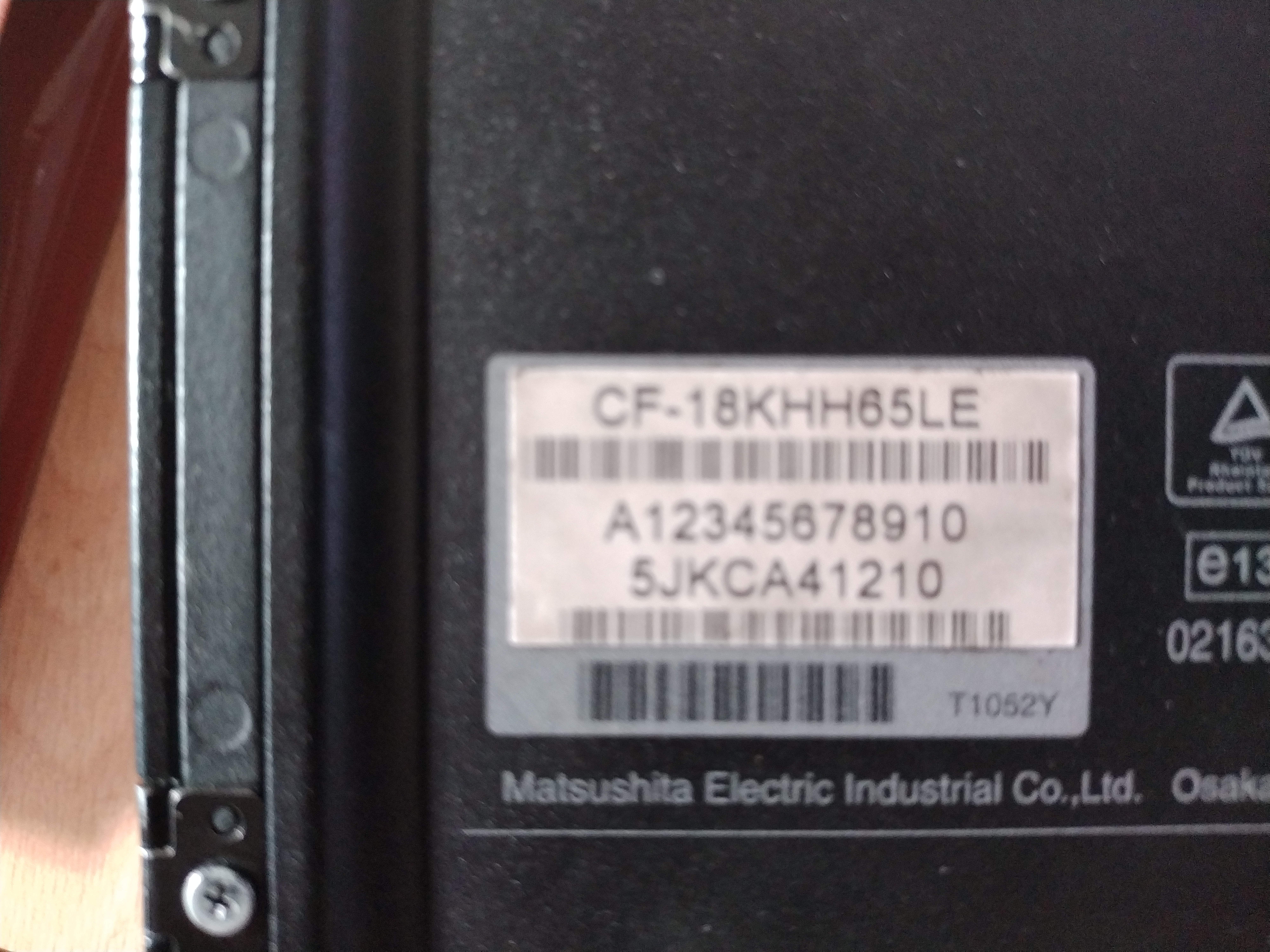

    >Provide the full machine model number, serial number (or Service tag, SNID) and the board model number (see https://www.badcaps.net/forum/showthread.php?t=88758 ) ,
    > The serial number, make, full model number, motherboard model and revision (except QR codes) must be written/typed at your request as per the rules. Not as a picture, part of the file name and so on.
    Jaguar IDS Diagnostics Laptop aka Panasonic Toughbook CF-18
    Model: CF-18KHH65LE
    Serial(?): sticker has two strings: A12345678910 and 5JKCA41210
    see attached picture
    Laptop has some 3-4 separate boards in it. And they are not here with me now. So I cant give board model. Panasonic model string should tell which machine is in case.

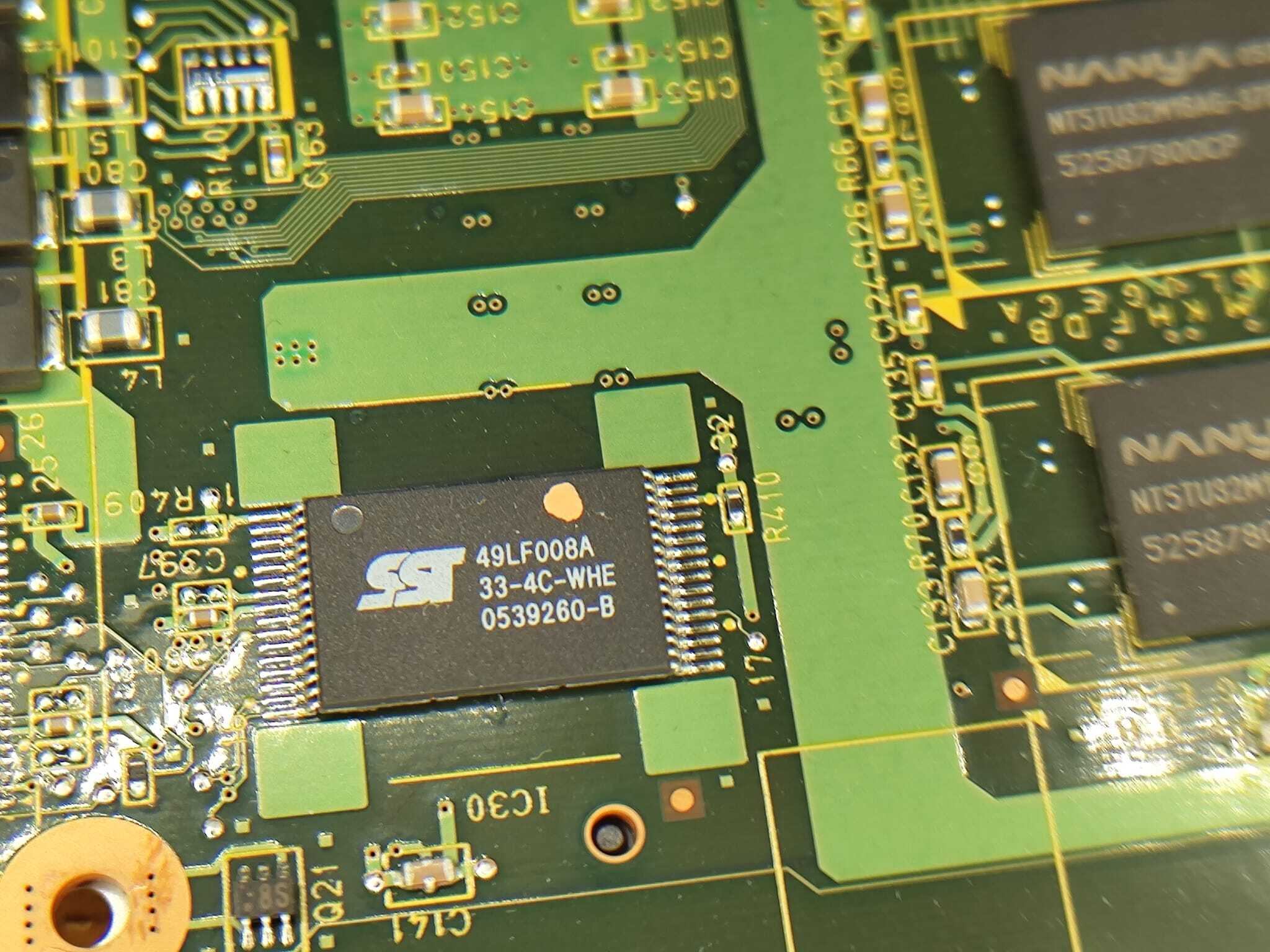

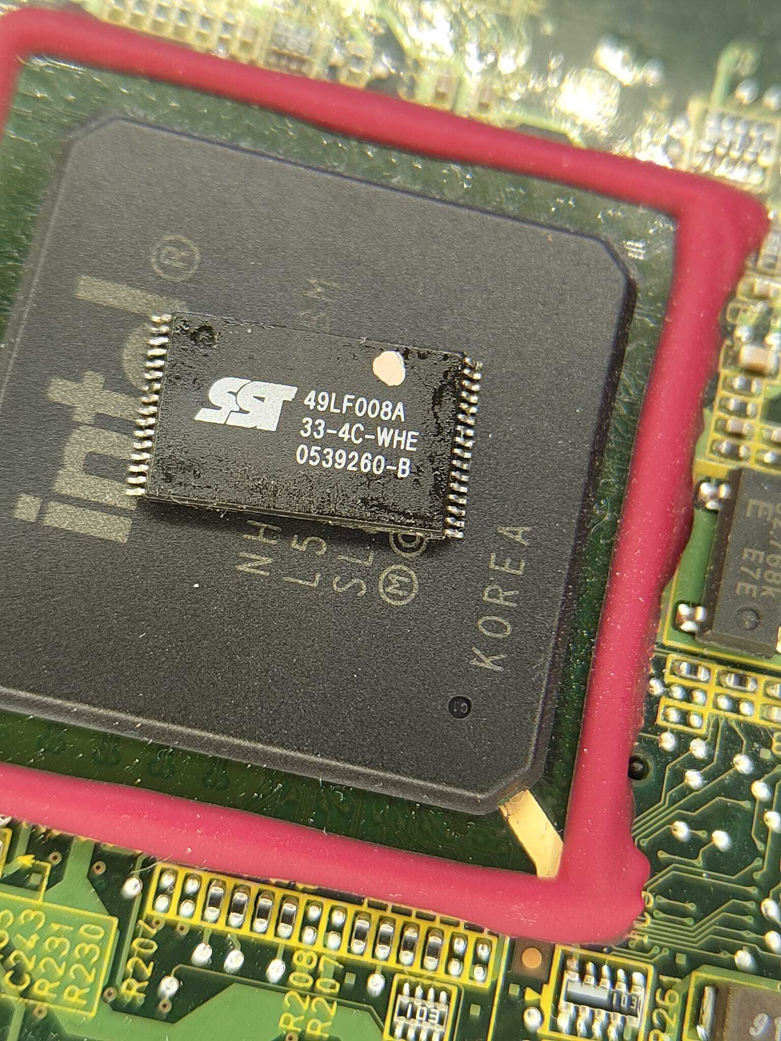

    Here's chip where the dump is from. And also model sticker.
    • tlindi
      • Jan 2025
      • 6
      • Finland
      Model: CF-18KHH65LE
      Decodes as following:
      ---->K CPU K - Pentium M 753 - 1.2GHz (Centrino) 802.11a/b/g
      ----->H LCD-Keyboard H - 10.4 XGA High Bright Touchscreen
      ------>H HDD-RAM H - 60GB HDD - 512MB RAM - dual ant. connectors
      ------->6 Wireless ?!? -> See Customer Special Configuration
      -------->5 Integrated Options ?!? -> See Customer Special Configuration
      ------->65 Special Config Jaguar (UK)
      --------->L OS L - Microsoft® Windows® XP Professional MUI
      ---------->E Destination E - non North America (U.K.)​
