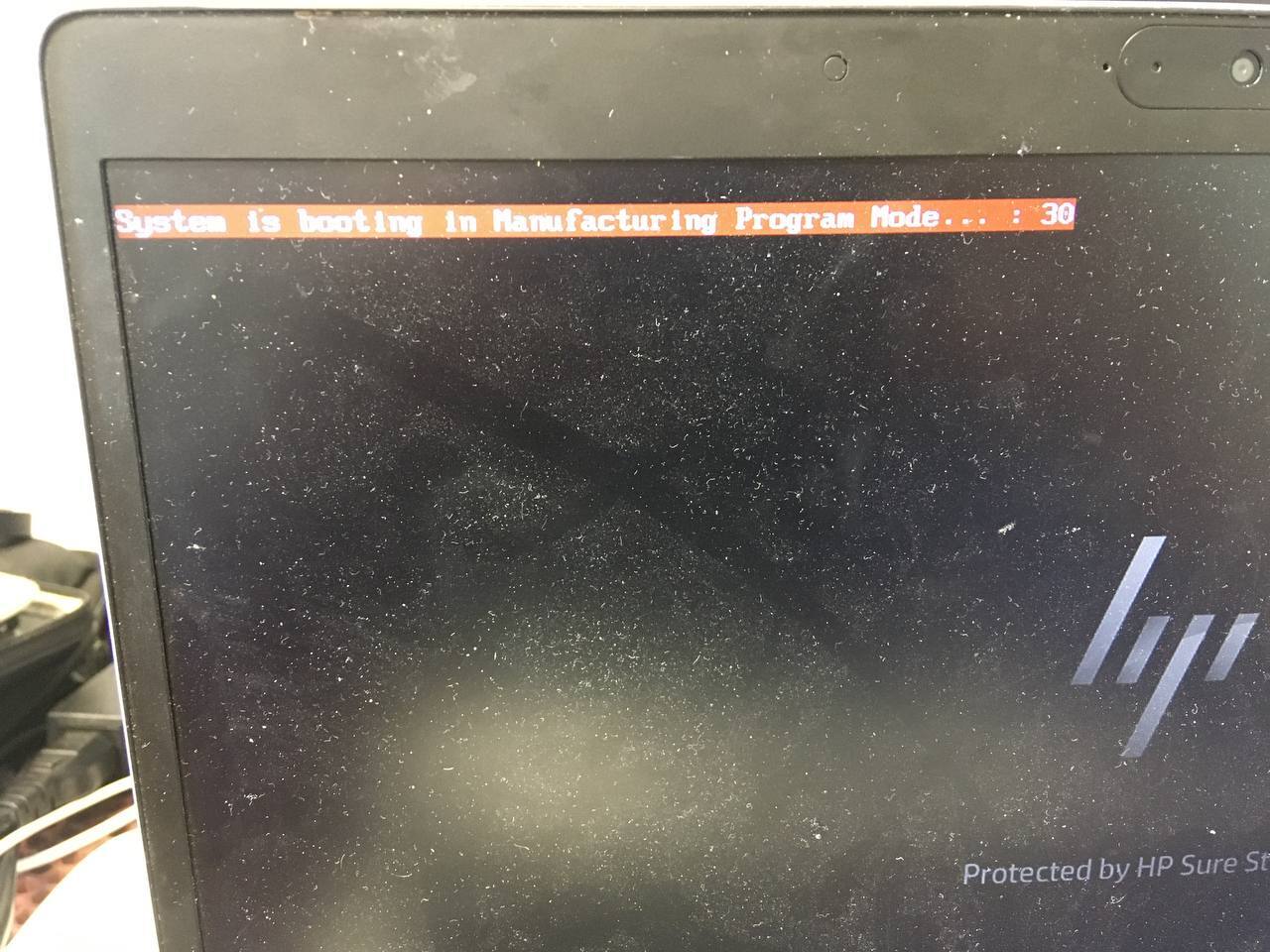

                  • habmuku
                    • 5
                    • Italy
                    #269
                    Request for unlocking my bios:
                    HP EliteBook 840 G5
                    ProdID 2FA64AV
                    SN# 5CG9245ZLH
                    I tried HPUnlocker withous success (password is still there).
                    • rex98
                      • Feb 2023
                      • 1263
                      • Mandaue CEBU, Philippines
                      #270
                      HP EliteBook 840 G5
                      ProdID 2FA64AV
                      SN# 5CG9245ZLH
                      First boot press F10 reset bios to factory defaults, 2nd boot reset security settings to defaults.
                      search here bios config utility in forum in case you don' know.
                      Use BCU to fill these DMI INFO
                      Serial Number: 5CG84925QJ
                      Product Number: 2FA62AV
                      CT Number: PGWHN00WBBL7HY
                      Description: HP EliteBook 840 G5
                      build_id: 17WWCSBT602#SABU#DABU
                      Feature Byte: 3X476J6S6b7B7H7M7Q7W7m7saBaEapaqauawbUbhcAdUdpdqgdhKhkjh.gD
                      MAC Address: E4-E7-49-20-66-B0​
                      • habmuku
                        • 5
                        • Italy
                        #271

                        Does not work (black screen). Just noted your product number differs from mine (don't know if this matters).

                          #272
                          the product number is extracted from your bin. upload the EC 16mb or use RC unlocker D.I.Y .
                          did you verify this main bios bin after reading?
                          ec is found at the back of the board you need to disassemble.
                          • habmuku
                            • 5
                            • Italy
                            #273
                            Sorry, I did something wrong, I attached the correct file now. Thanks for patience.

                              #274
                              Serial Number: 5CG9245ZLH
                              Product Number: 2FA64AV
                              CT Number: PGWHQ00WBCE59A
                              build_id: 17WWCSCT601#SUUZ#DUUZ
                              Feature Byte: 3X476J6S6b7B7H7M7Q7W7m7saBaEapaqauawbUbhcAdUdpdqfAfXhKhkj4jh.fR
                              MAC Address: 80-E8-2C-A1-5E-C5​0
                              in case your wondering about this DMI info its from your dump.

                                #275
                                This worked! Thank you so much.
