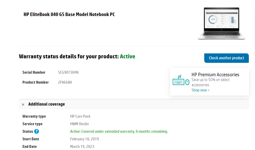

      Serial Number : 5CG907304N
      Product Number : 2FA66AV
      Description : HP EliteBook 840 G5
      Build Id : 17WWCSBT602#SABF#DABF
      FEATUREBYTE : 3X476J6S6b7B7H7M7Q7W7m7saBaEapaqauawbUbhcAdUdpdqfA hKhkjh.GF
      my CT number is : PGWHT00WBBW7RW
      help me please

        This is still under warranty.
        I don't provide help for people using CH341A and a clip.
        • mahdi19
          • Aug 2015
          • 42
          • algeria
          #124
          Re: Hp ellİtebook 840 g5 bios password
          i live far from where i by this pc... how can i contact them !
