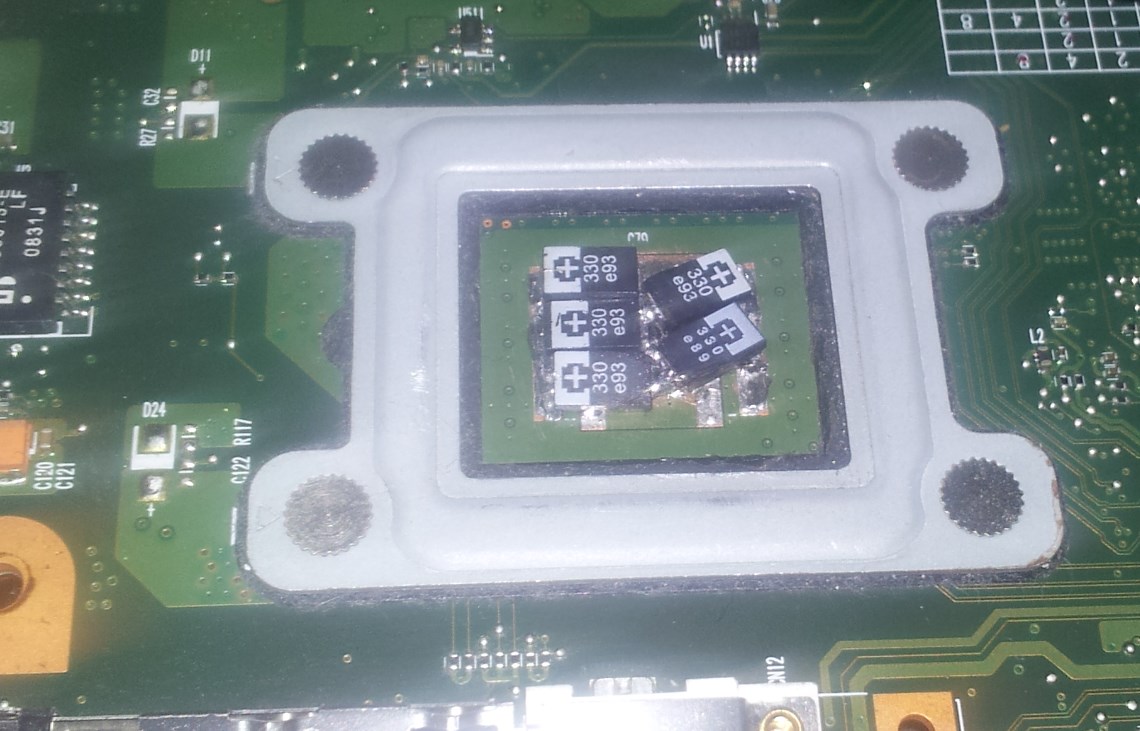

                  Re: Toshiba Satellite - Locks up when plugged in
                  Hello.
                  For the 3rd time I have a toshiba laptop with the symptoms required for a capacitor OE128 replace.
                  So that's what I did, I replaced it with 4x Tantalum Capacitor 330uf 2.5v SMD LOW ESR .
                  Previous times I had success.
                  This time It did not correct the problem... If I boot with only the battery and then I plug the power, after 2 seconds the laptop shuts down and reboots.
                  If I boot with the power connected sometimes I get into desktop and then it freezes or reboots.
                  Some times when it freezes some screen corruption or artifacts appear on screen, which made me wondering if there is some problem with the graphics card...
                  what should I do next?
                  thanks.
                  • Th3_uN1Qu3
                    Believe in
                    • Jul 2010
                    • 6031
                    • Romania
                    #629
                    Try other caps, or try 6x 330uF instead of 4x330uF.
                    A working TV? How boring!
                    • Napalm
                      • Mar 2013
                      • 20
                      • Portugal
                      #630
                      It worked with just an aditional cap from an broken board.
                      I've scraped the pcb so all could fit, here it is the ugly soldering i did, but it's working fine.
                      thanks all.
