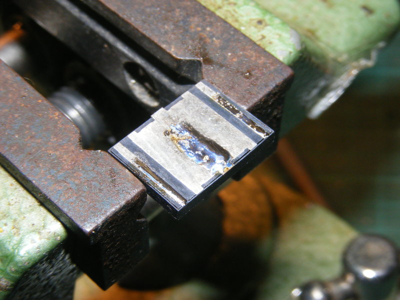

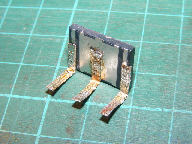

                  Okay - I've got a completely different way of doing things now, this just 'came' to me during the night, not sure how well it'll work for everyone though.
                  Basically afaik the problem with the NEC/TOKIN replacements is that we invariably cook them shortening their lives, so I went with this method to avoid that, not to mention it's easier to install.
                  1 - Take your NEC/TOKIN cap and 3 x ~2cm lengths of braid,
                  2 - Tin the pads slightly
                  3 - Attach the braid to the pads **( Yes, I know I've done mine in the middle, because I had already scratched away the solder resist, for non-resistremoval jobs just split the braid down the middle )
                  4 - Trim them up
                  5 - Fold back
                  6 - Solder to main board.
                  Helps a lot too if you can preheat the mainboard a bit. I'm using a 100W station to really get the heat down quick, but the board was preheated to about 150'C to help it all along.

                      Just a checking question (tried to find an answer on this thread but couldn't see a clear one), if I use a 1200uF in place of the 900uF, can that stop it from working as well? It's fine on battery, but won't boot and won't stay on for more than a few seconds with power in. I have a few of the 900's coming in via post, but thought i'd try a 1200uF in this case until they did arrive.
                      The larger sized capacitor shouldn't be a problem. Im guessing there is too much connection inductance.
                      The + strips need to be connected to the PCB at both of their ends. The - plate needs to be connected at all of its corners.
                      It could be done with component lead off-cuts rather than braid.
