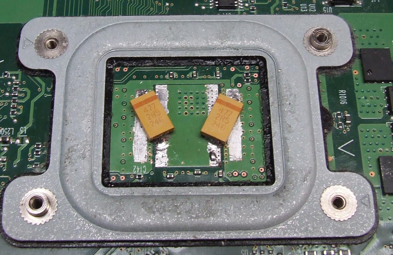

      It's ALIVE!!!! bwaa haahaa
      The fix was a 100% success!
      I can't believe such a major TOSHIBA problem was fixed by such a cheap fix. (approx $13 NZ not including labor).
      TOSHIBA should recall all laptops fitted with these NEC Tokin chips and fix this issue once and for all!
      SO here is photo of the finished product as promised.
      I can't claim the soldering work as my own I have a guy who does this sort of thing for me.

        Re: Toshiba Satellite - Locks up when plugged in
        Brilliant work matey, well done!
        True they should, but it makes for some cheap buy-fix-resell work for us to do

                  I've found the cheapest replacements for the bad NEC/Tokin caps are the Kemet T520V337M2R5ATE009 --

                      Another success here. Used 4x 330uF tantalums. On this particular model there was also a lonely 220uF tantalum in the middle of the CPU socket, along the usual NEC/TOKIN 0E907 on the bottom. Now the 220uF tantalum cap has 4 new buddies.

                              acer aspire 6920g - replaced oe907 with 4 smd 470uf 2.5v capacitors but no luck
                              Hi guys,
                              I've been following this thread for a while.
                              My acer aspire 6920g kept restarting and i researched and found this forum by pure chance.
                              most people thought it was the second processor.
                              anyway, i ordered 4 tantalum smd 470uf 2.5v capacitors as a replacement for the oe907 chip.
                              I used a soldering gun to remove the oe907 chip eventually after 3 hours.aluminium plate down below it was the hardest to remove.
                              I replaced it with the 4 chips.
                              put the laptop back together(which was also tricky with the wiring) and put the power adapter back into it to test.
                              Power comes on and when i hit the power switch the fan starts but that is it.
                              no bios screen on the monitor and keyboard is not functioning now.
                              i assume it's the chips.
                              am i correct in thinking that 4 x 470uf is too much as a replacement for a oe907 as it is 900uf and 4 chips is 1880????

                                In some applications, the NEC/TOKIN capacitor is used as a feed through capacitor.
                                Current from the Vcore regulator flows into one of the outer + strips and out the other end to the CPU.
                                Check for continuity between where the two outer + strips were soldered to the PCB.
                                Or maybe other damage was caused by too much heating. Its best to rip the capacitor off the PCB as is described earlier in this thread.

                                  Re: acer aspire 6920g - replaced oe907 with 4 smd 470uf 2.5v capacitors but no luck
                                  Originally posted by murphyai
                                  Hi guys,
                                  [B]
                                  help???????
                                  hot air near cpu socket =
                                  you rip of the tokin capacitor with a blade .. uff
                                  try to consider on reballing the cpu socket
                                        it wasn't possible to rip the capacitor off the board and to be honest you will damage a board in most cases doing that.
                                        so i melted it off the board with a soldering gun and then the aluminium plate underneath as well.
                                        i think i haven't soldered the capacitors on correctly.
                                        i will desolder them later and only add 2 x 470uf 2.5 to the board as that is 940
                                        i also received a how to guide from the people who supplied me with the capacitors which i will post now for other users here.
                                        i will let you know later on how the soldering went.
