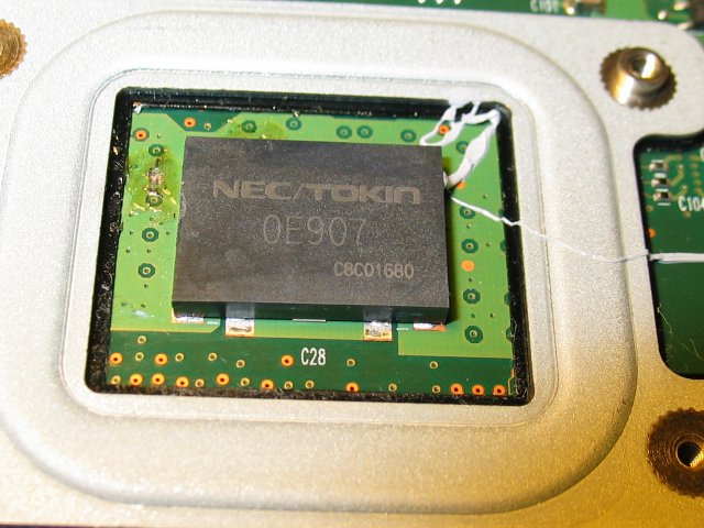

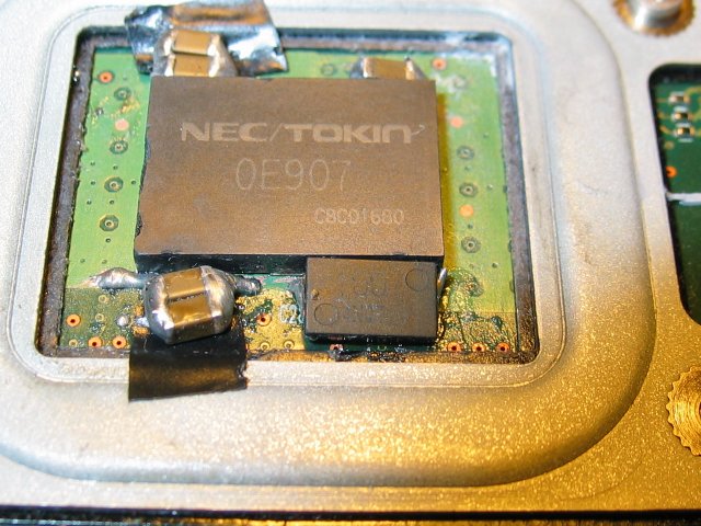

                Re: Toshiba Satellite - Locks up when plugged in
                Just fixed one Satellite A300. This is caused by a bad cap. A big one - NEC/TOKIN 0E907 (900uF/2.5V) under the CPU. Mine had 900uF but probably lost some of its magic, resulting in >100mV ripple on CPU power. Adding 1x 100uF and 5x 10uF ceramic caps fixed the problem.
                            Wooooww!! it work's !!! i change a little bit the prescription but it's perfect!!
                            i put 10 ceramic caps on right side and 4 470u tantalum on left side and now it's like a new one , thankyou everybody , now i want to post a pic of the job to help others , can someone help me to post a pic ? what max specs of the pic please...

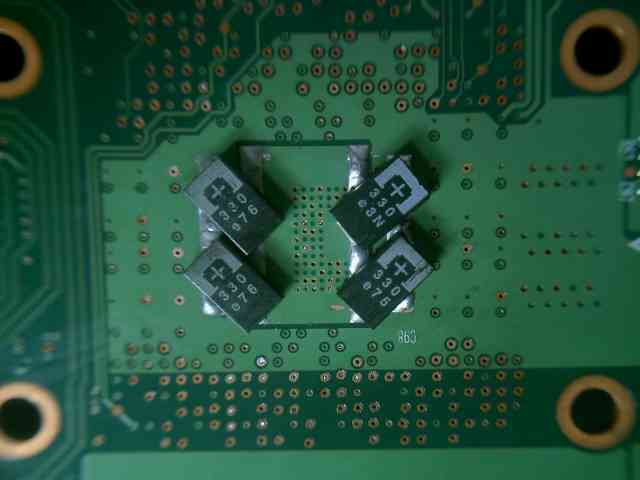

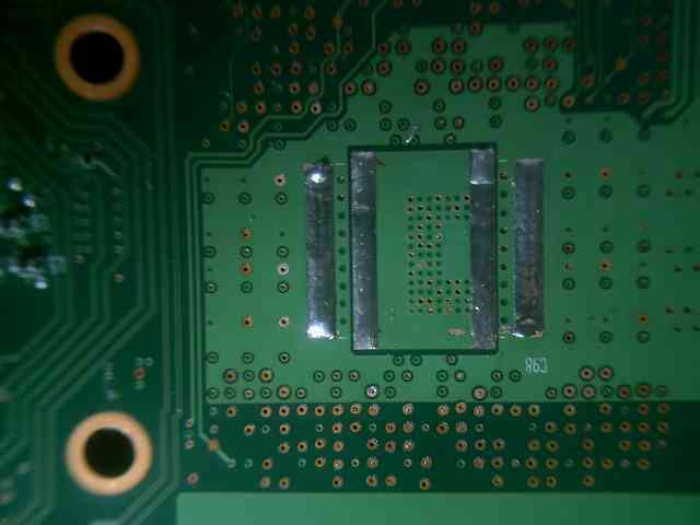

                                    Originally posted by Biancocf
                                    can you post a picture ? i want to see the finish job , the space is too short to 4 caps here , if possible of course...
                                    I had the opportunity to solve another one with that same problem, this time I took some pictures. Hope it helps.
                                    The notebook is a Toshiba Satellite A305-S6872.
                                    The first image shows the capacitor removed, board cleaned.
                                    The second, new solder added to the pads.
                                    And finally, the finished job.
