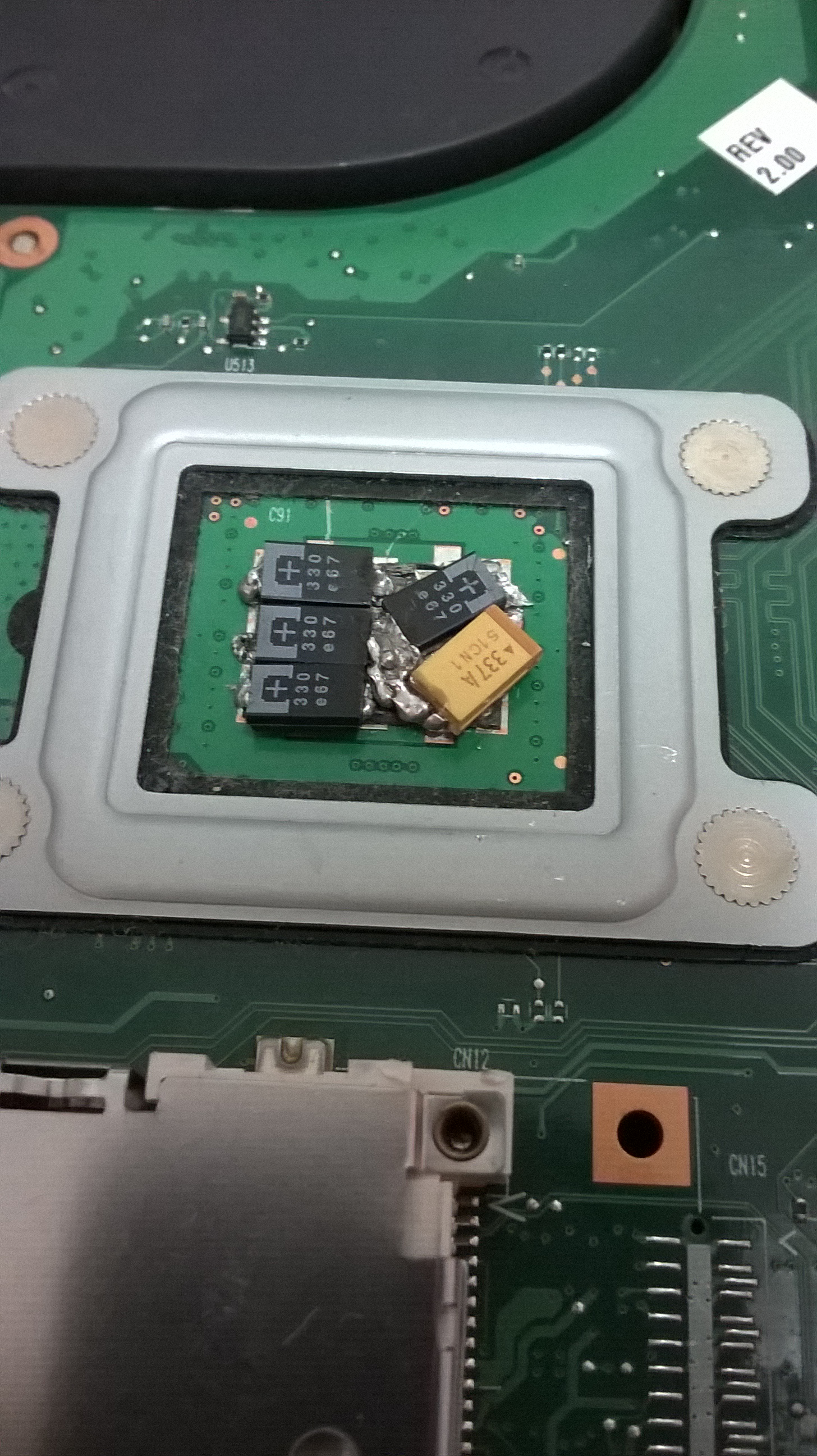

                    Have done another one yesterday. No pics this time, didn't have my camera with me. I used 4x 330uF scavenged from other boards as always. Runs great.

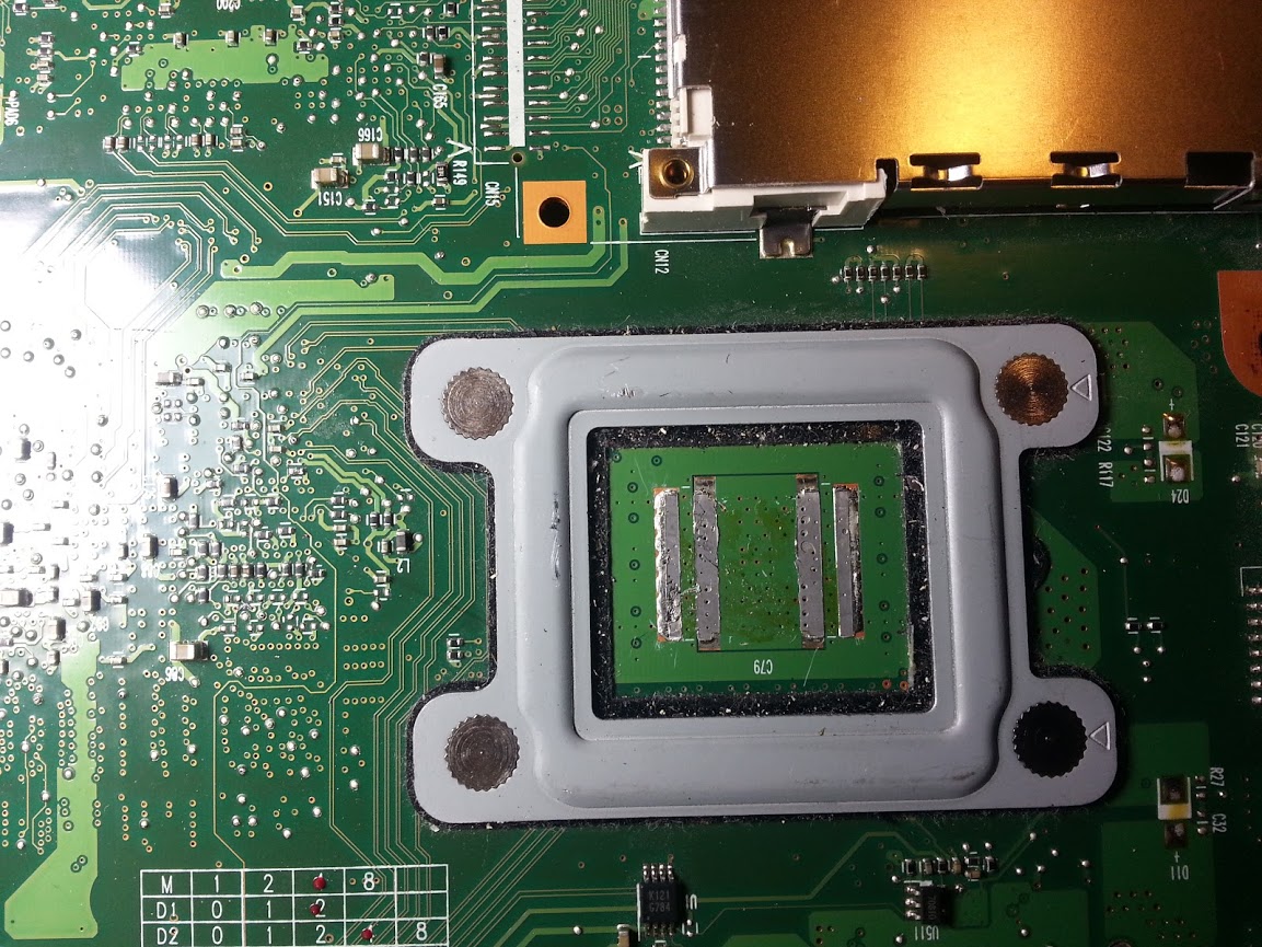

                      Hello, and great work guys. I plan on replacing my caps, and I've noticed a few folks have posted saying their display is not working. I have read to page 27 so far and no one has mentioned the display trick.
                      Simply remove your battery and A/C, re-install the battery and hold SHIFT and F5 while pressing the power button. Hope this helps.

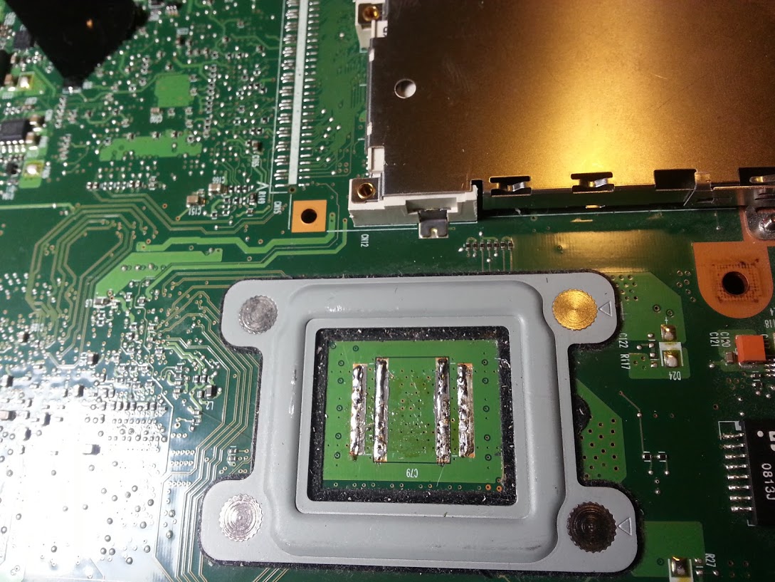

                        Hi, I was able to solder four Kemet 330uF capacitors (T520V337M2R5ATE009) to a Toshiba A205.
                        The laptop no longer freezes and is working fine. However, when I "Restart" the laptop, it gets stuck. It seems that it does not power off the system (or probably the CPU) completely within the regular short power-off and -on cycle. I suspect that the new capacitors do not discharge the power quickly enough. When I "Shut down", it turns off fine.
                        Is everyone experiencing the same problem? If other capacitors are working fine without this symptom, I would like to know which ones. Thank you in advance for your help.

                                    First things first, try soldering an extra cap on there. There is another board with a Tokin like that, it's the one in the Acer 6920G, and when the Tokin fails on that one it needs 6 capacitors to work stable.
                                    I had one in last week where someone else had soldered in 4 330uF caps and it still didn't work right. I added 2 more et voila... magic.

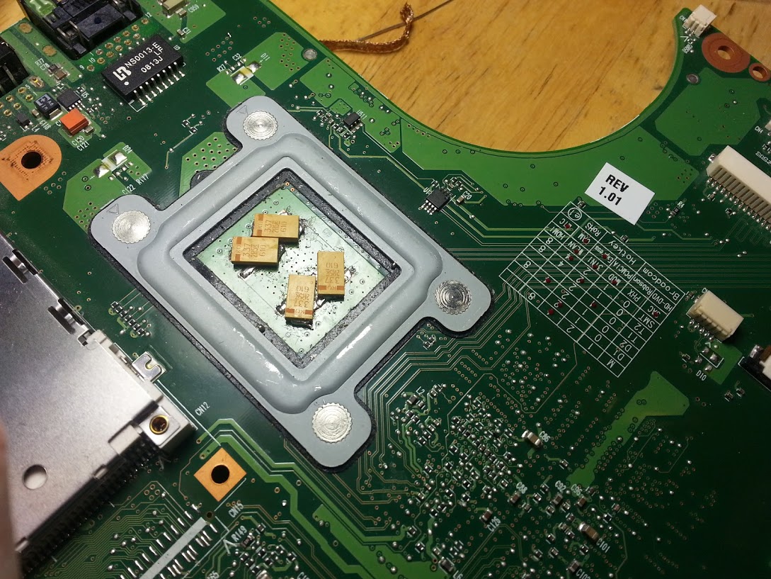

                                      I tried 5 caps and then 6 caps but still hanged in windows at a random interval and sometimes when full reboot I get a thin blue horizontal line just before a black screen before the cursor appears.I found it weird why for 3 years 4 caps would work and now I needed 6 caps so I tried and no result, in meantime I changed HDD 500GB to an older one of 200GB and so far its working for a day or so , so maybe it's the drive or a windows problem but the freeze seemed like a hard-ware issue , I will report what I find.

                                        Today I've received an A300 with ATI HD onboard with the synthomes you're talking about.
                                        I would like to try to fix it installing caps before change the Tokin.
                                        WHat and how many caps should I solder near the Tokin? Is it possible to find those caps on another laptop motherboard?

                                          To continue, the problem is software related the latest antivirus program update was causing the freezing, I feel so silly now lol.
                                          I didn't have to open the laptop and resolder new caps but since the symptom made me think it was related to the caps I only reinstalled the VGA driver and then went straight for the board ,the key thing to remember with this motherboard and NEC problem is that it hangs + shutsdown.
                                          I'm glad it's working now and I wont be replacing the new caps I added it will have to stay like this .
