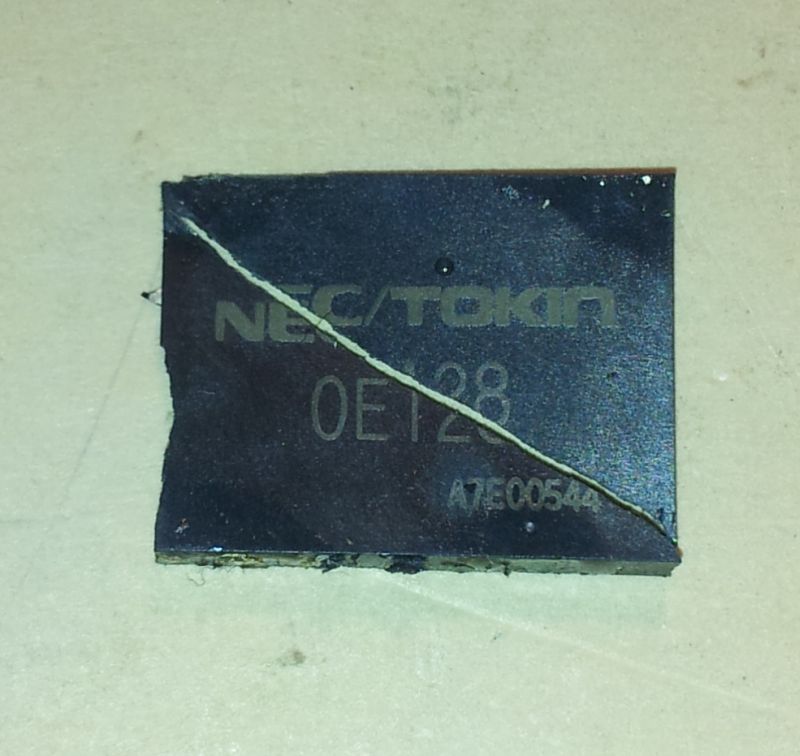

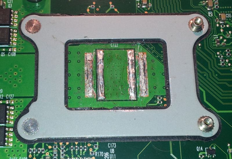

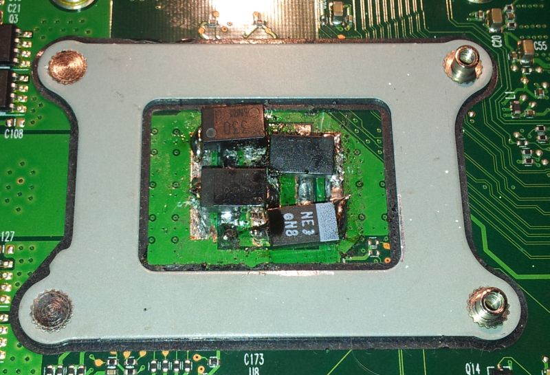

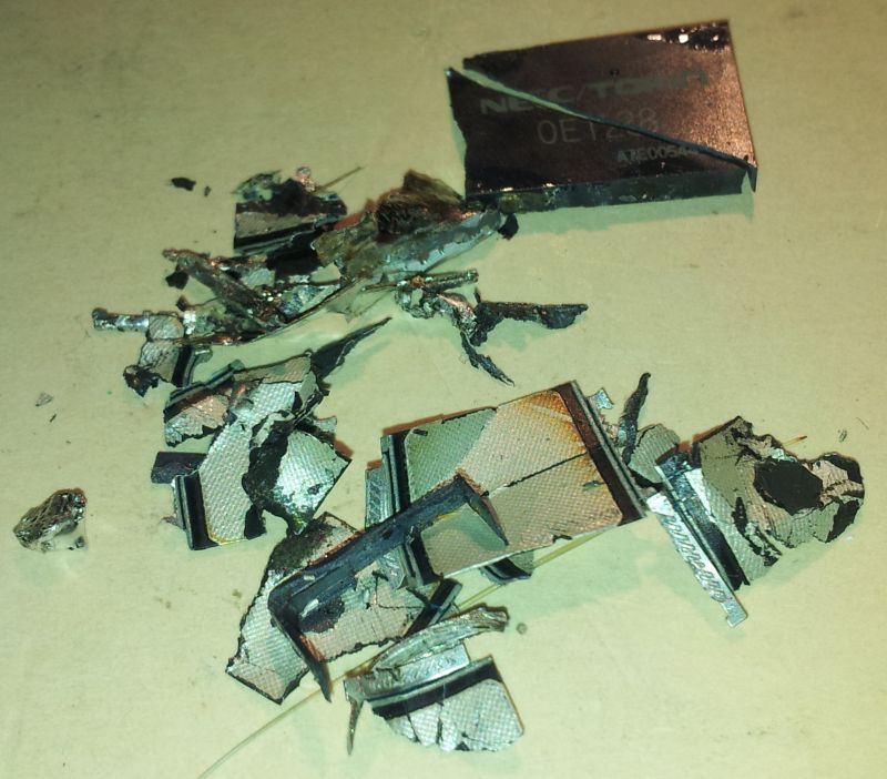

                                        I found this site and decided to fix my Toshiba Satellite L300. It was rebooting every 10 minutes non-stop, with the AC plugged in. With the battery it was good, but with the AC plugged in, it would always reboot.
                                        Not a heat problem.
                                        I found the OE128 capacitor inside. Broke it with small pliers, and removed piece by piece. Found four 330uF capacitors in another laptop motherboard. Not sure about ESR values, but they should be low because they were near the CPU. I used these and soldered in place like in the photos at the beginning of this thread. I used a 30w soldering iron. There is only a hairline gap seperating the + and - on the motherboard, so I had to be really careful. Very easy to stuff it up.
                                        Reassembled the Toshiba and it works great. Does not randomly reboot. I can keep it running all day and it won't reboot, where as before it would reboot for no reason 3-4 times per hour.

                                          Nice! Can you post some pictures of the job you made I'd like to see the outcome. Thank you!
