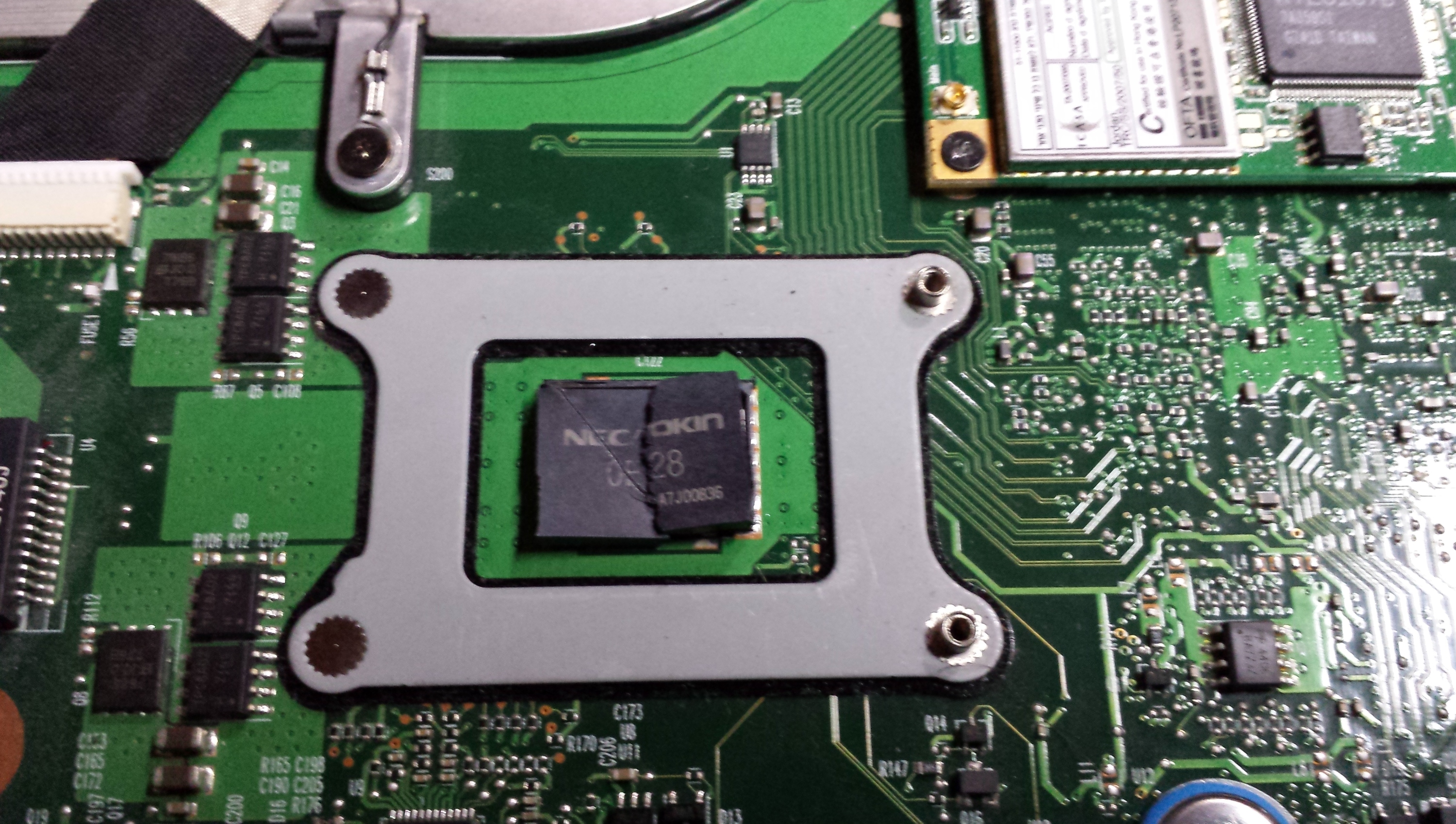

          Already fix laptop toshiba a300-20t with tokin replacement. Installed windows 7 with no problems. Thanks unique

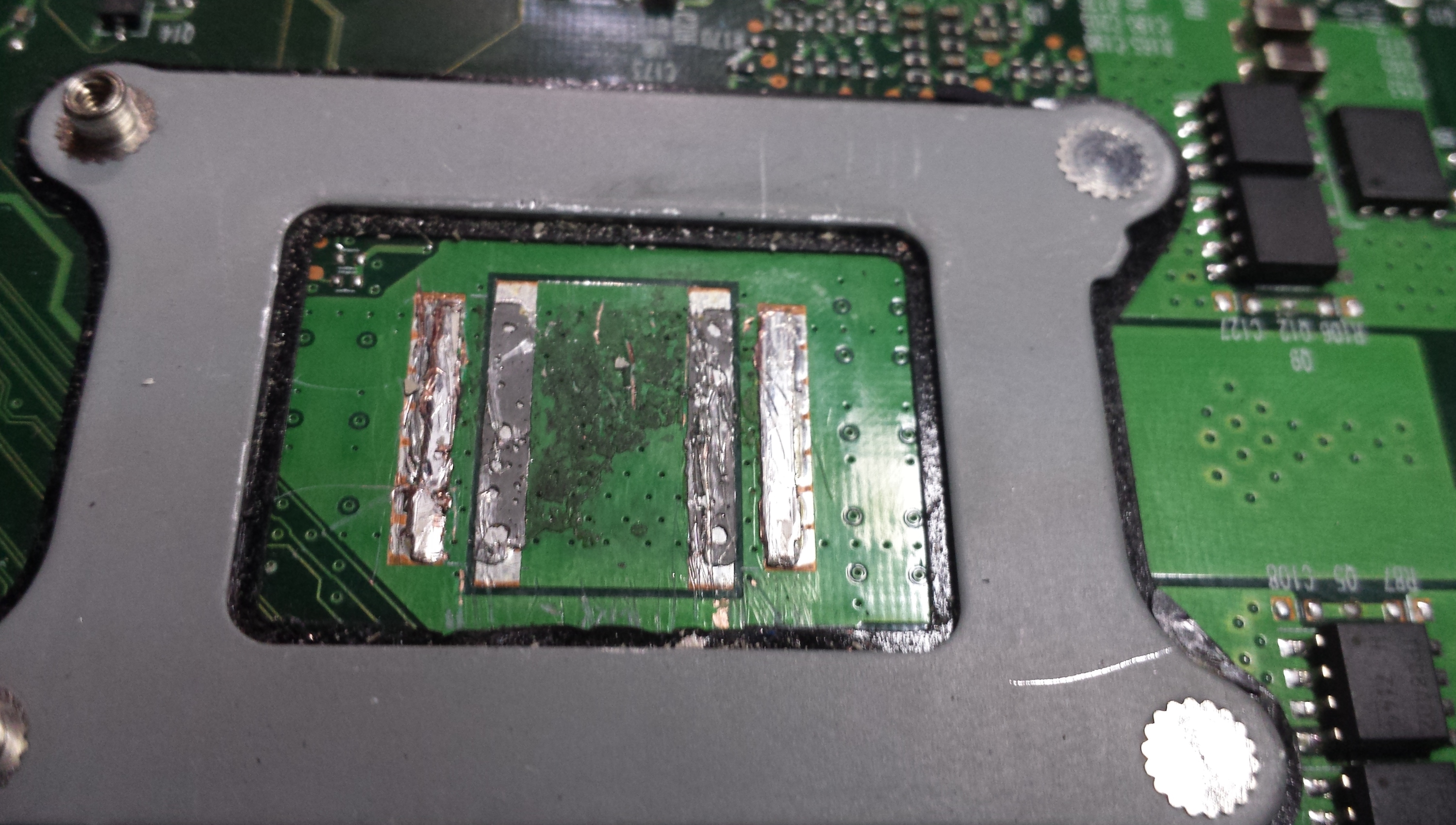

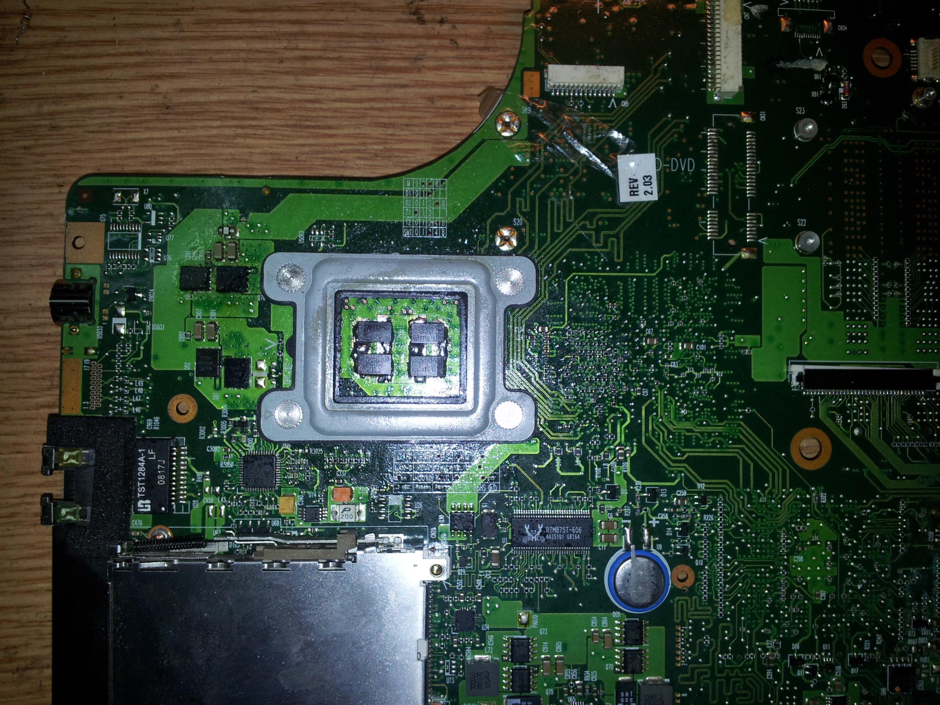

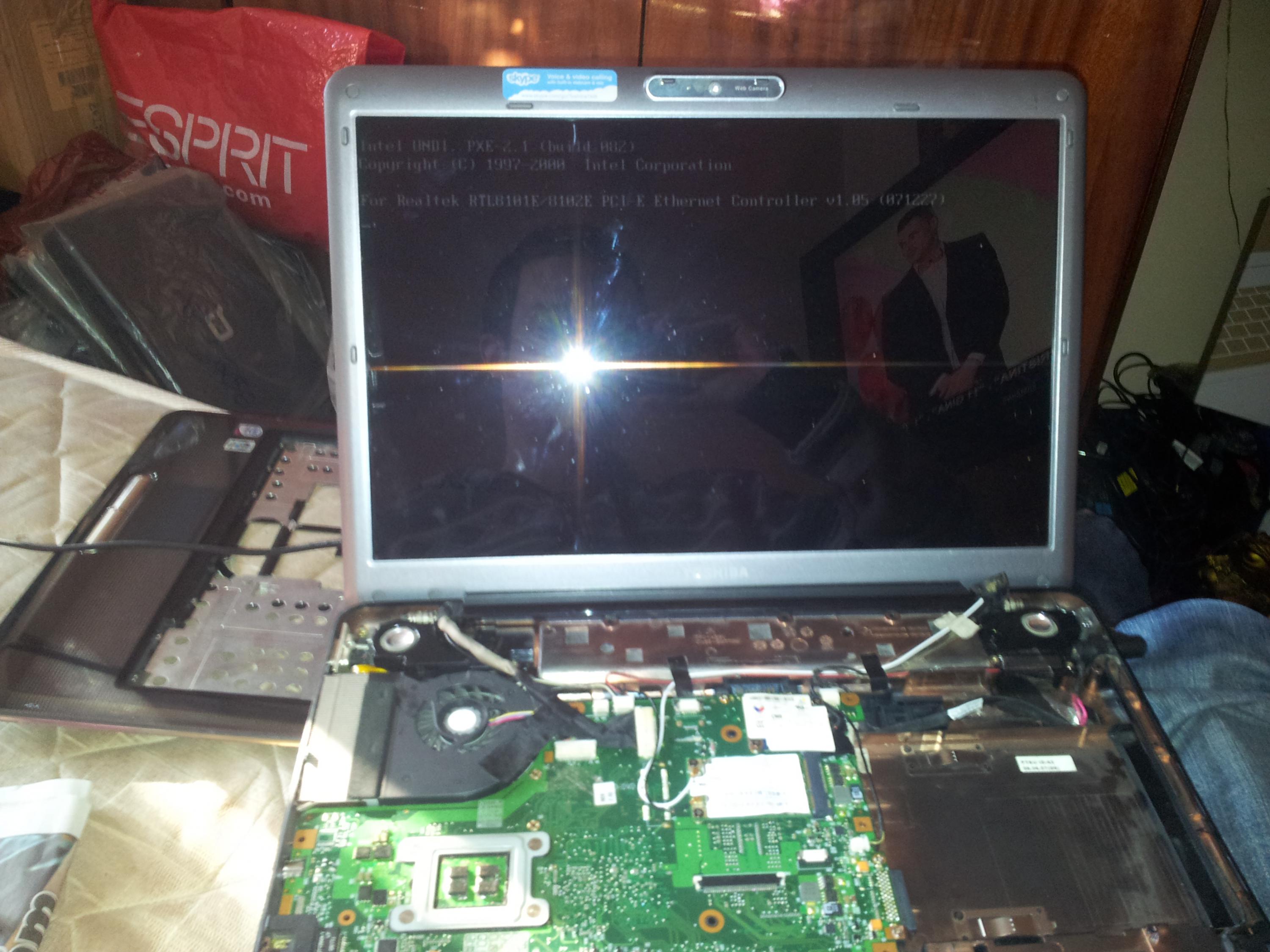

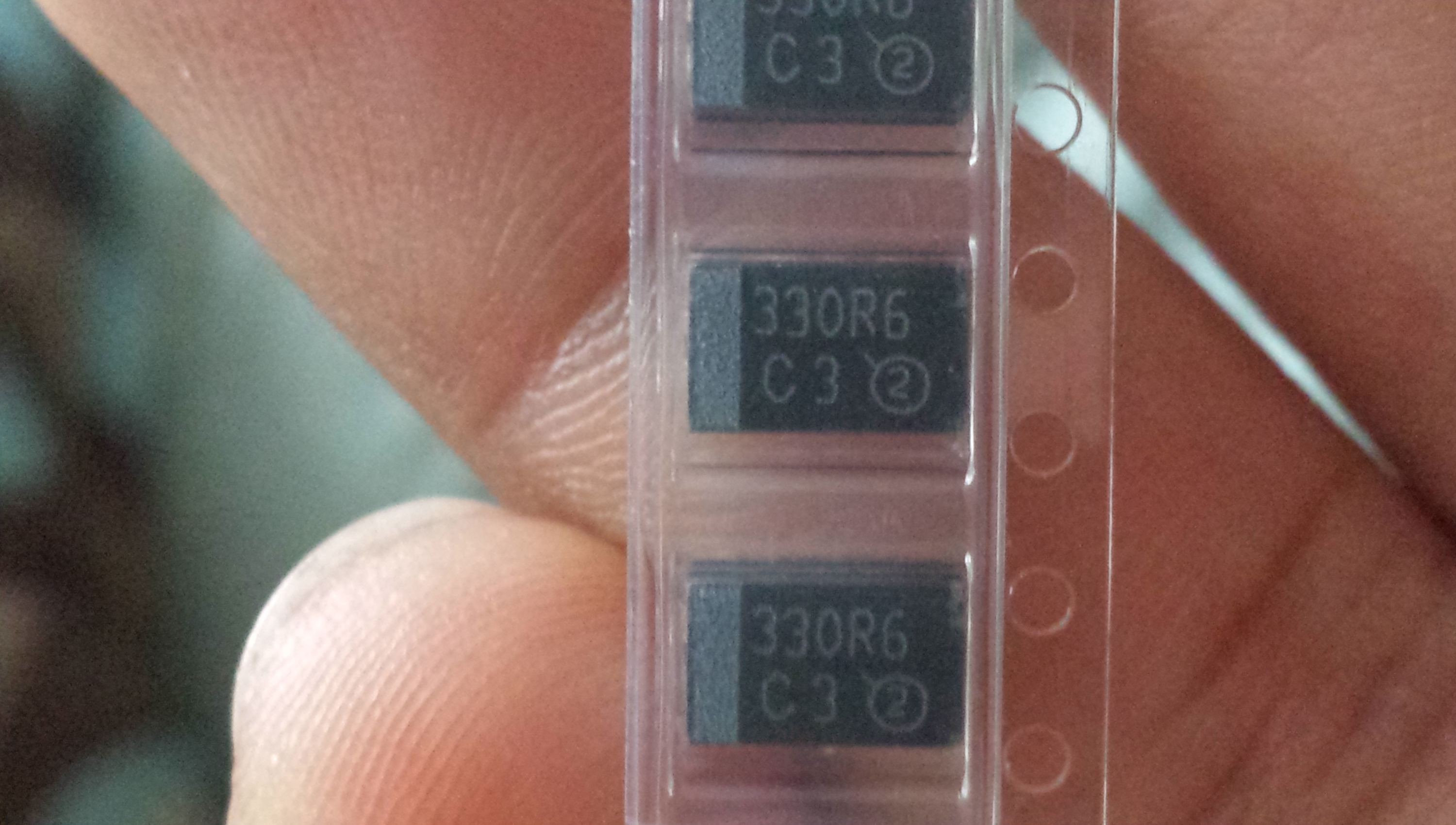

                    Another two done here... Same 4x330uF, salvaged from DV6000 boards which were beyond repair.
                    Only had time to take pics of one of them.

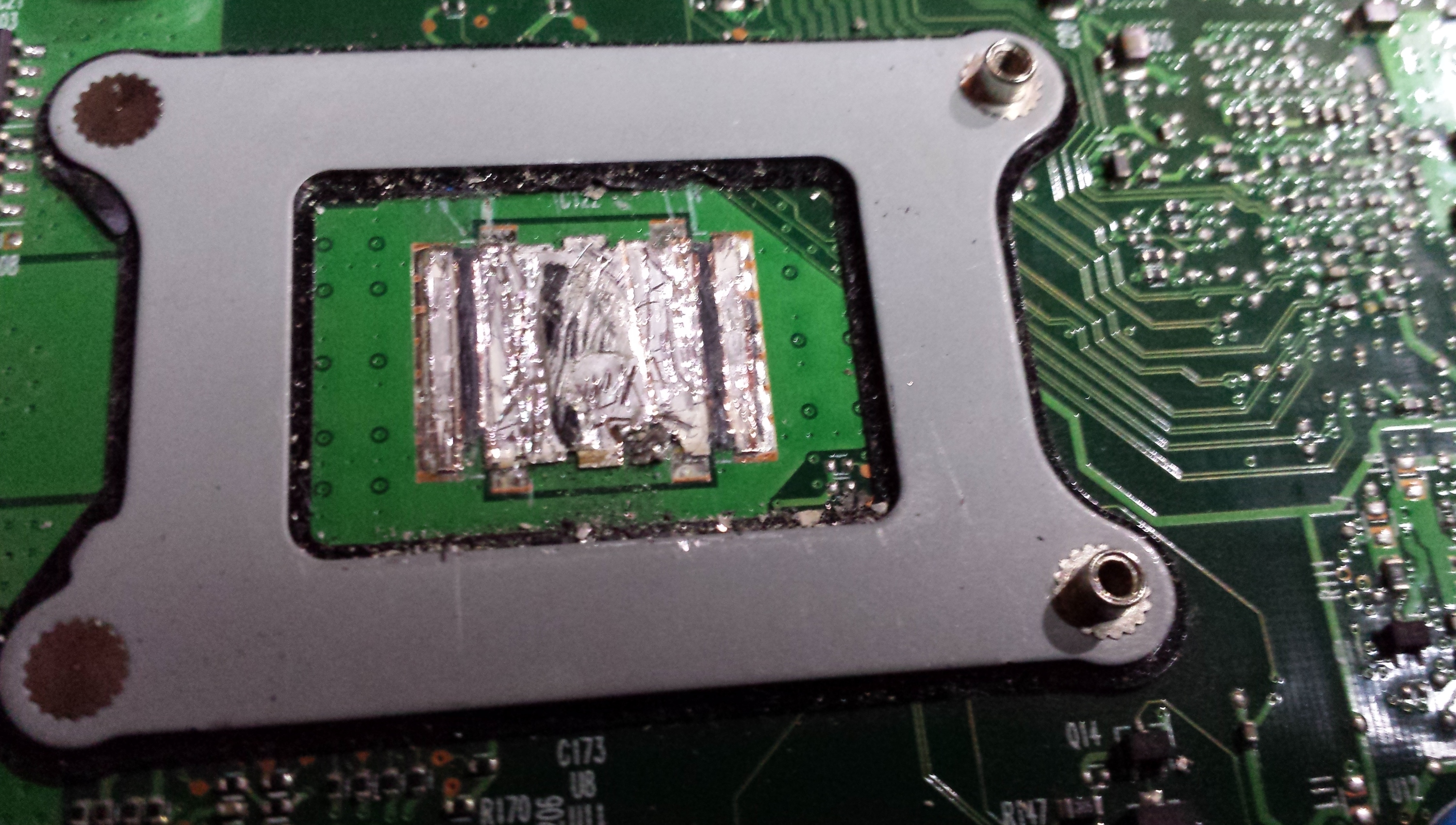

                      Re: Toshiba Satellite - Locks up when plugged in

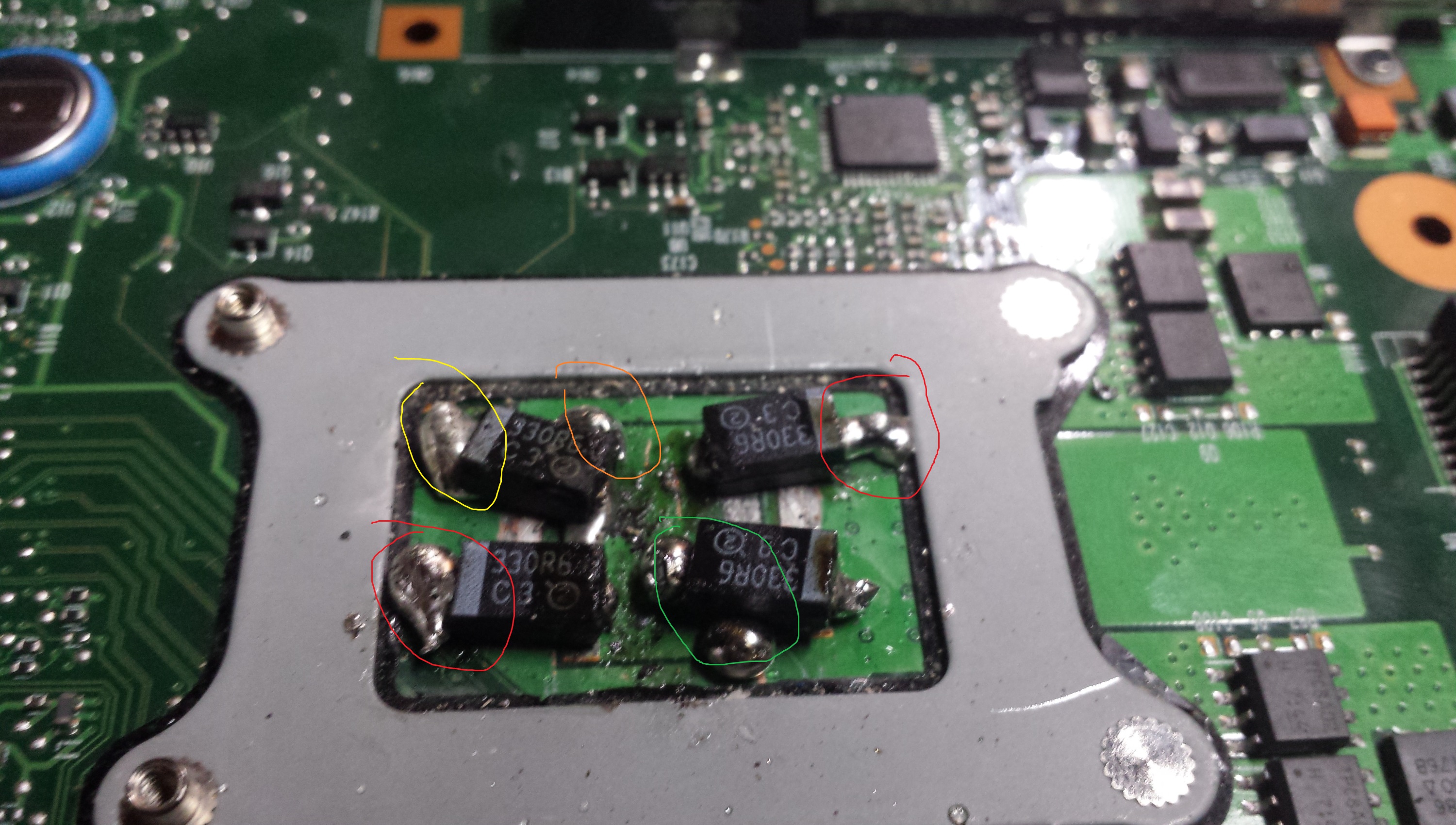

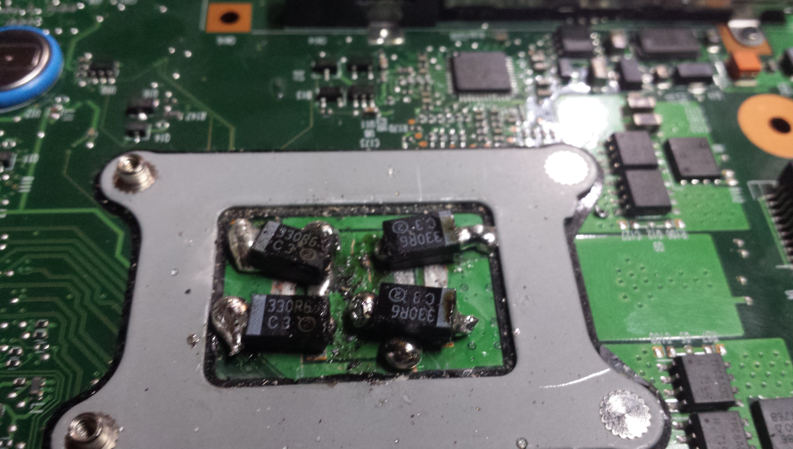

                      Hi guys,
                      I've been reading this thread since the first post, and after much debate(with myself). I decided to replace the nec/tokin OE128 with 4 smd caps. Here is the link to them.
                      http://www.alliedelec.com/search/pro...x?SKU=R1085263
                      The laptop I'm fixing is the Toshiba satellite A205. A friend of mine was having problems with it. Here is what he told me. That the laptop would freeze whenever the AC adapter is plugged in and that it wont boot when the adapter is plugged in. After much thought i decided to follow the procedure that i saw so many people had success with. So I ordered the 5 330uf caps and waited a month and a half for it to get here. When it finally arrived yesterday, i got to work. I broke the OE128 with a screwdriver and scraped it off. Then I did a horrible job with the soldering and somehow managed to get 4 caps soldered. Now when I press the power button, the laptop does not boot, whether it is plugged in or not. What should I do? Did I do something wrong? If so, what? My only tools are a soldering iron and a screwdriver.
                      • dupetank

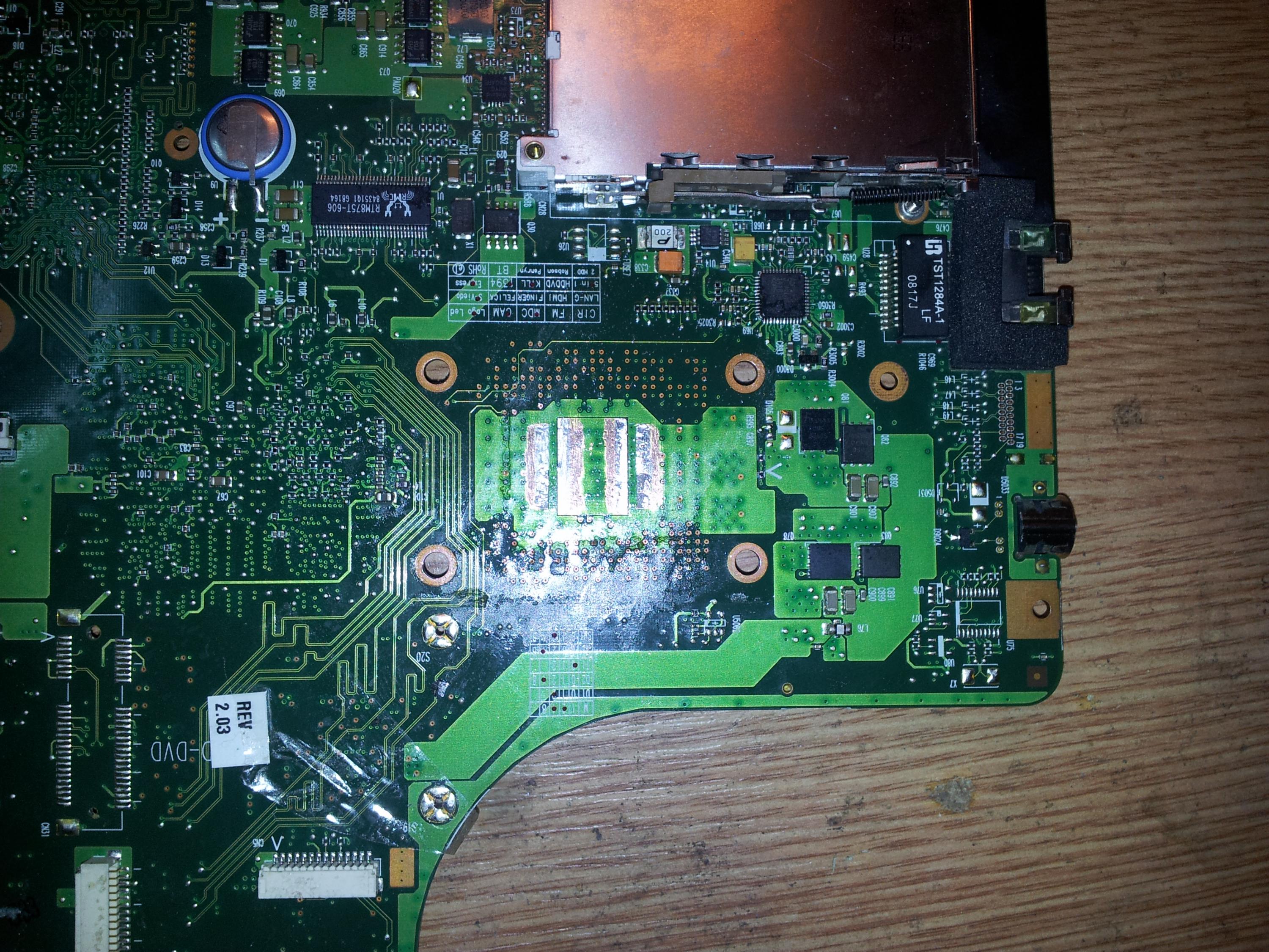

                        Sorry about the pictures. Better resized pictures.

                          #652
                          Is that clean enough in picture 7?
                            That is too messy and I can see what look like multiple short circuits. Do you know what "short circuit" means?
                            All this can be fixed but I hope you have been careful to not disturb any small surface mount components that are sometimes nearby.

                              #654
                              Originally posted by dupetank
                              Hi guys,
                              Sadly those do not look like they are connected, you see those four silver tracks in the center that's where they are suppose to be connected.
                              Inner two are ground and the outer two are where voltage is supplied.
                              Remove, clean and try again, it's too messy, use less solder, if you have a big iron, purchase a smaller iron, should be the size of sharpie pen with a chisel tip, 25-40w is enough to get the job done, just do 2-5 second contact time then let the component and board cool for a moment and repeat.
                              Try and clean the tracks of solder using a desoldering braid really good so it's a flat surface then position the components and add a bit of solder to the tip of the iron and apply to the component and track, just enough to hold it in place and allow you to work on the opposite side. Now on the opposite side, you can add enough solder, *NO QUARTER INCH BLOBS!* just a little bit from contact on component to track, basically you want it to look like something from the movie terminator with the liquid metal terminator was just a pool on the ground and it came up like pointed, well just make it look like that from track to component, once you get that side done go back to the other side and add a little bit more and do the same thing as before.
                              Just be forewarn, it will be difficult
                              When I did the laptop for my client, it was pain too, I think part of the problem was the oversize components I got and not cleaning the track very well, it was a bit bumpy, so the components didn't sit flat.
                              Mine is not pretty but it works.

                                #655
                                The "50" at the end of the part number, "TR3D337K6R3C0050", indicates 50 milliohms of ESR.
                                The ESR needs to be fairly low for success. I dont think anyone really knows what the maximum is allowed to be. A figure of about 10 is generally recommended but a recent poster claimed success with 24 milliohm parts.
                                This topic is mentioned a number of times in this tread.
                                Also, do not solder over any isolated vias. They look like a small drill hole surrounded by light green or orange(copper), surrounded by dark green(no copper)

                                  #656
                                  Hi guys,
                                  It looks like you did a sloppy soldering job
                                  To me, the capacitors, except for the bottom right one, look to have their solder shorting to the CPU heatsink bracket.
                                  The one on the bottom right, it seems to have solder bridging the positive and negative of the capacitor (that blob right below it, it looks like it could be soldered on both PCB traces)
                                  Try getting a meter and measuring the resistance across the capacitors. A reading of 0 ohms means there is a short (again, probably in the soldering), and a reading of a few ohms (say, 3-10) is normal, I've measured that across plenty of different CPU's before. Unless it is broken, the CPU DC-DC converter's output, when not connected to anything, should be almost open circuit, (maybe a few K ohms of resistance, but no less) so that shouldn't cause an issue here.

                                    #657

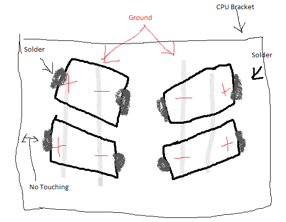

                                    Mad Professor,
                                    What do you mean they are not connected? The solder?
                                    The biggest frustration I had while doing this is getting the cap to stay in one place while I applied solder, it kept moving when I touched it. Which is why it looks so messy.
                                    So the solder is not supposed to touch the brackets!! I'm pretty sure that solder is not touching pos and neg on the bottom right cap, I made sure of at least that.
                                    I'm sure you guys have probably already guessed that this is my first soldering job that I've ever done. The fact that its fixable brings a huge sigh of relief from me. I may not be familiar with some of your jargon terms so please make it simple and easy to understand.
                                    I was also hoping that someone could understand the data sheet that comes with the caps, and figure out the ESR of this cap.
                                    I really appreciate the help guys. I attached my understanding of the layout. Also one more question, should I let the iron touch the PCB?
                                      That attachment is correct bud. Good luck

                                        #659
                                        hmm... outside is positive, solder from positive side touching cpu bracket. those kind of brackets are usually ground which are part of the screw points, or I maybe wrong... use flux, tweezers and 40-60 watts of soldering iron and then your done

                                          #660
                                          Mad Professor,
                                          RED = obvious short to cpu bracket
                                          YELLOW = Potential short, does not look connected to positive plane/track.
                                          Green = Does not look as if connected to ground, potential short at cpu bracket
                                          Orange = looks poorly connected at ground *negative*
                                          To make it easier, you can remove the green lacquer in the red box to expose the ground plane. Simple scraping and 30 minutes of your time will be enough. Just don't go deep you are just removing the green and Don't go outside of the red box.
                                          Then line up your chips and hold them down, solder the positive side first to make sure its line up then ground.
                                          Here's an example
