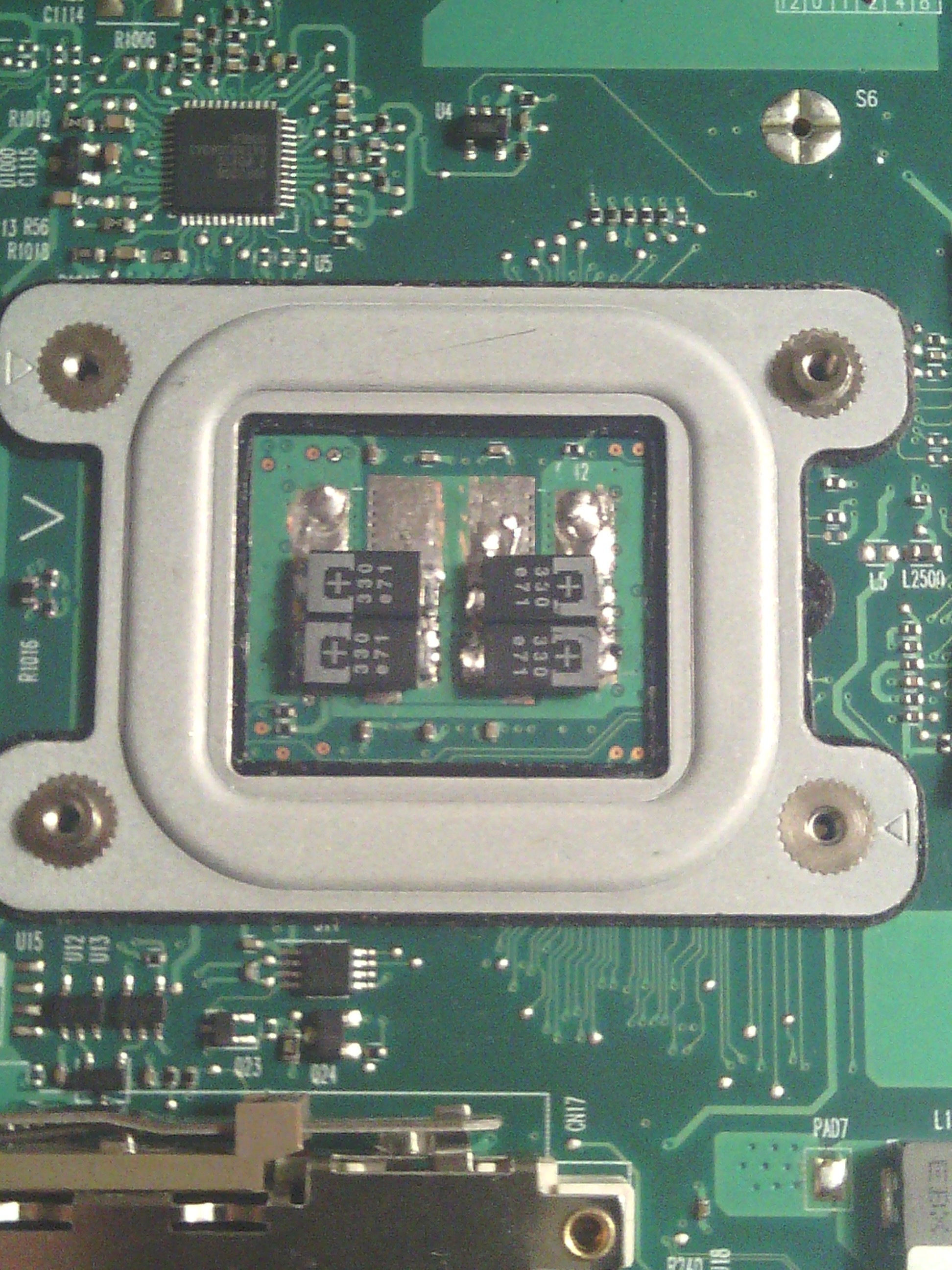

    Quick Q, What should I do if in the removal process of the TOKIN, I have exposed copper in the centre? Is it possible to still earth to the - pads? General advice etc would be good. Thank you muchly.
    • tw2005
      • Oct 2011
      • 6458
      #742
      Re: Toshiba Satellite - Locks up when plugged in
      Check out post#732
      that's genius, you won't have to fiddle trying to squeeze them in on an angle to solder to the original tracks.
      Bad picture though, so you have 3 tracks, thin sections at either end and a large common track in the middle. So long the tracks are not shorted to one another, looks messy in the photo.
      I'd just clean and tin those up and put the caps in

          just separate side rails to be not shorted with middle rail and u r good to solder 4x 330d capacitors

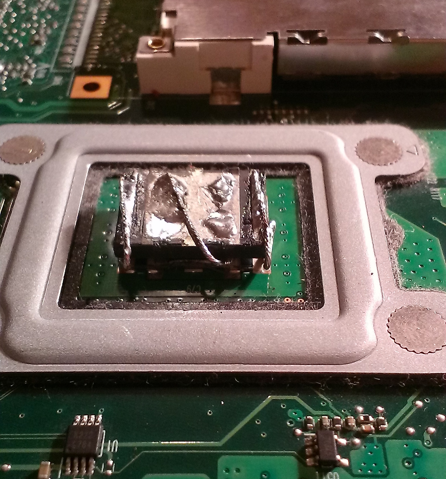

                        Hi there,
                        I have repleace nec tokin oe128 with new one orderd from ebay, with old one, laptop (satellite l350) was reebooting while trying to load windows on charger, working fine only on battery. But, with new tokin capacitor it is not booting at all, fan just spinning, no beeps, no nothing else. Before touching old tokin, I have remove CPU, RAM, HDD, disconnect all connectors, scrach down old tokin with very sharp iron solder end, didnt damage MBO, and connect new tokin with wires to MBO (wire length each cca 2cm). If I turn on laptop without CPU, fan spins for 30 sec, then laptop shuts down, with mounted CPU fan just spins, no shutdown, no bios, no nothing...
                        What is dead, CPU or motherboard? Is it posible that new tokin is faulty? How to check it?
                        How should laptop work (for testing only) if I try to start it without tokin capacitor?
                        I was very carefull with taking old tokin out, and with soldering new one in, thats why I dont understand why and what is wrong, or what am I missing???
                        Big thanks for replay, help me figure this out, cose I have no more idea what to do...
                        • rievax_60
                          • May 2012
                          • 897
                          • australia
                          #752
                          It wont work when it's connected with wires. It is very difficult to properly solder the nec/tokin capacitor. Use tantalum capacitors like everyone else.

                            #753
                            OK, I will find some (as described in previous posts) and give it a try... Thx for advice!

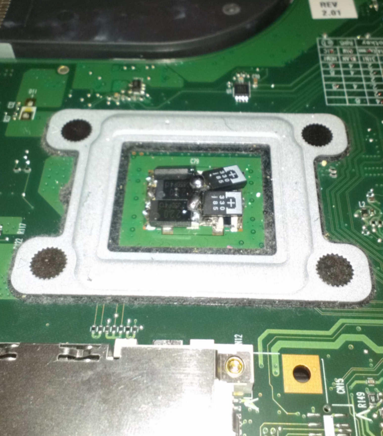

                                  Thank you guys so much!!!
                                  Instead of connecting tokin with wires, I throw away tokin oe128 bought on ebay for 0,99$, and take few capacitors form old (definitely dead MBO), and I soldered them straigth on MBO (like rievax_60 advised me).
                                  3x220 on one side and 2x330 on other side, put it back together, and.....
                                  IT IS WORKING!!! THANK YOU!
                                  On pictures you can see how I soldered oe128 (still do`nt understand why it did`nt work, and how those less then 1" wires mess it up...), and on other picture is shown how I solderd capacitors, the working solution (this is the worse looking solder joint I ever did, but it is working...)!
                                  Once again, thank for advice!
                                    The Vcore supply to the CPU is low voltage high current. Very roughly ~1V and upto ~20. The CPU can go from drawing low current to high current in a very short time, less than 1 microsecond. The long wires add too much series inductance to the capacitor which allows the voltage to dip when the current suddenly increases. The CPU then crashes.
                                    For the same reasons, any replacement capacitors need to have a low ESR rating. No one knows how low, the lower the better. I use 2R5TPE330M9, which are 9 milliohms.
