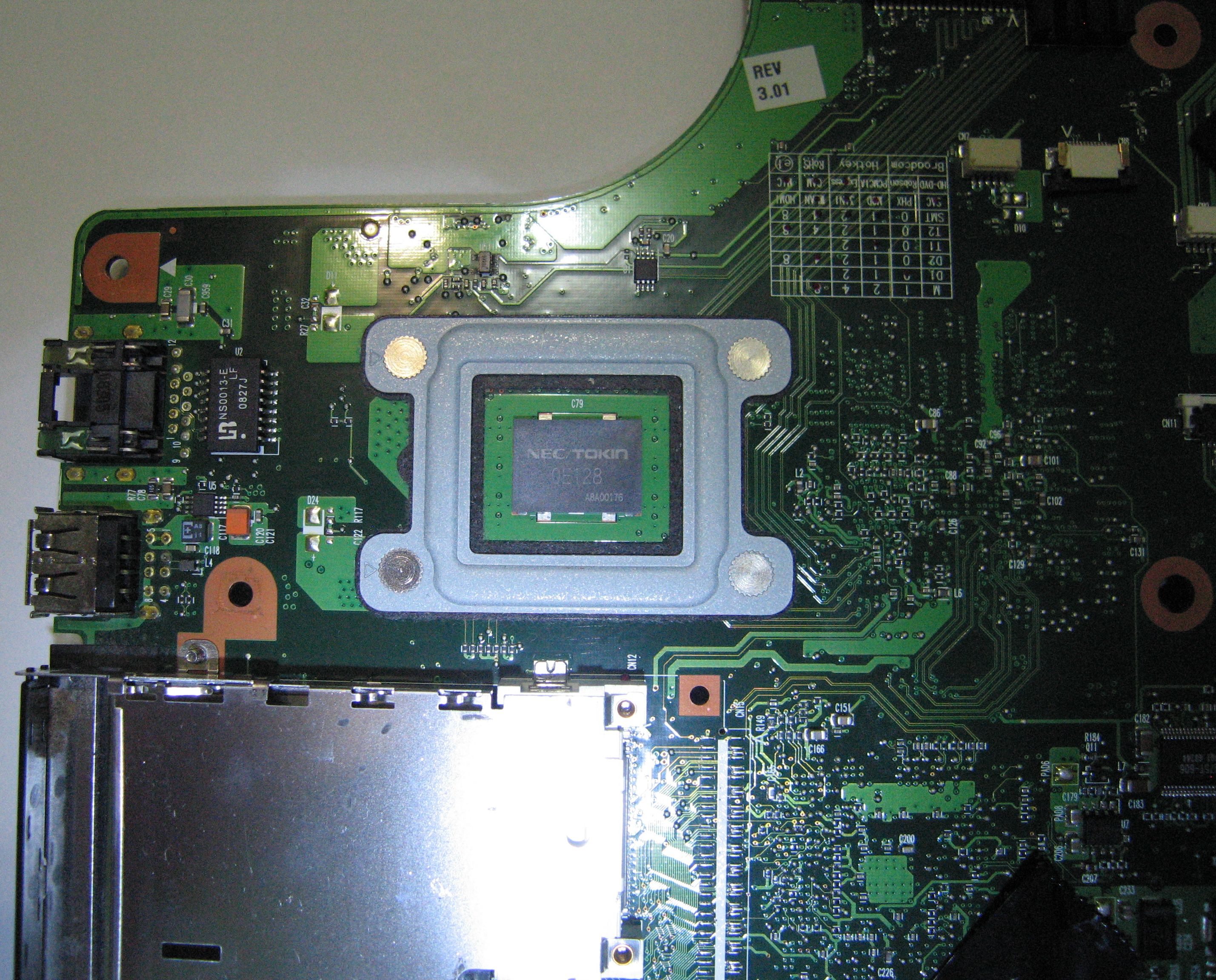

        Hello
        I have accidently removed a litle capacitor numbered C142 when removing a bad nec tokin. (see image)
        i tried to resolder it but its very difficult.
        With 4 tantalum caps it did not boot, with 6 it boots fine but powers down loading windows.
        any way to fix it?
        the problem now is that it disappeared and I dont know where it is. I have scrap boards the problem is know the specs of the tiny smd...

            Any similar sized SMD ceramic will do in place of the one you lost.

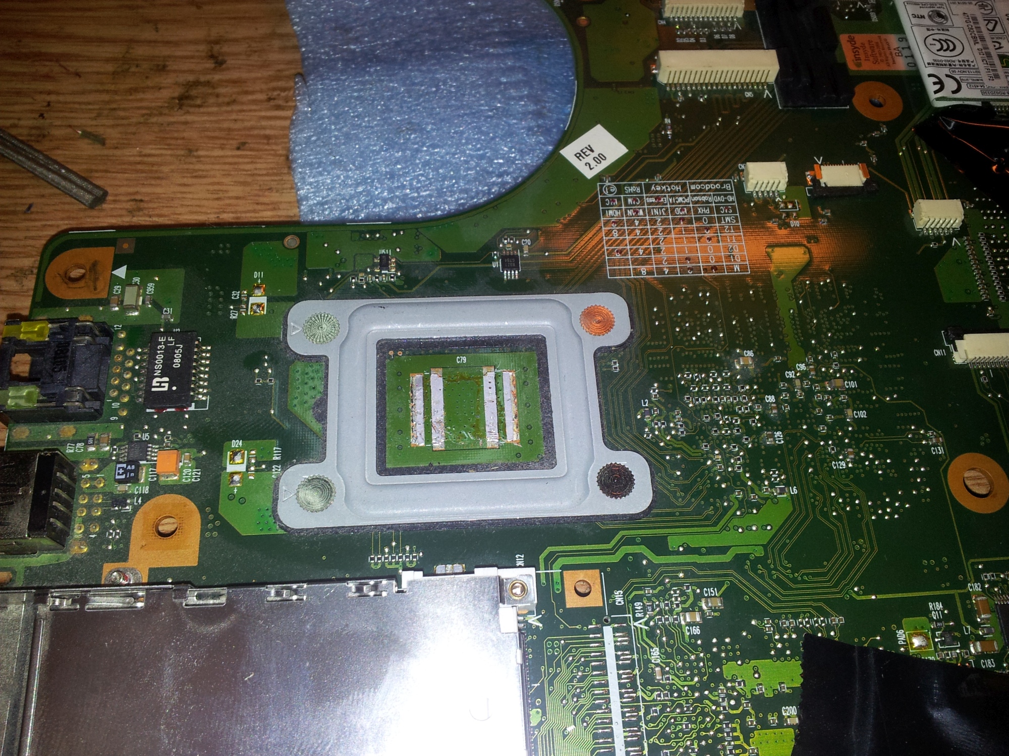

                Here's my go at this (Toshiba L300-0HH PSLB8C) :
                Caps used were Kemet T520 Series, part# T520V337M004A(1)E009. Cap is 4V 330uF, ESR is 0.009 and Ripple rating is 4600. Picked up aruond 60 of these a while back at a bargain (Make sure you use "V" size case which is low height).
                0E907 is 1.5mOhm or 0.0015 Ohms. The 4 replacement caps give 2.25 mOhms or 0.00225 Ohms. Not as low as Proadlizer, but still very low. There's also a 0.006 Ohm, 2.5V 330uF version of this cap, and the resultant ESR of using them in parallel would be 1.5 mOhm, but they're probably as rare as hens teeth.
                Toughest part was getting the 0E907 off. I used the method I remembered reading about in this thread of peeling away the layers (At this point I wished I had a reflow setup like you Th3_uN1Qu3). This was necessary after the Proadlizer cap came off when I trued to remove it with a hot air gun like a tooth cap. Took flux and wick to clean the area well afterwards, as well as nailpolish remover-grade acetone to remove the residue.

                  Job well done.
                  I have always used mechanical means to remove these caps. Thin-nosed pliers and surgical blade. Heat runs the risk of damaging the solder balls underneath the socket.

                          Here's another L300:
                          (See attachments for higher res versions).
                          This time I thought I'd opt for the scratching off the silkscreen in the middle method to make it easier to solder them on.
                          Computer works, but the LCD is wonky so I think it needs a new flex cable (because it displays fine when I move the screen).
                          Needs a charger and a new battery and it's as good as new.
