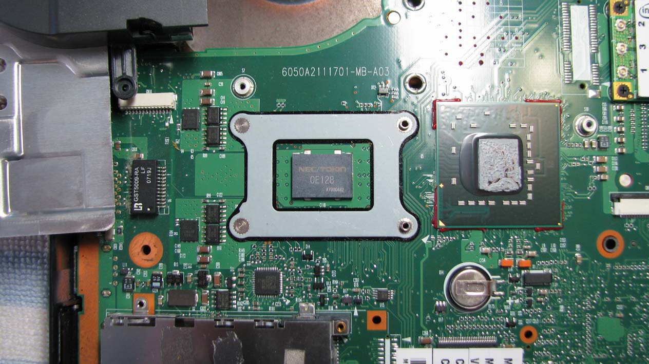

        Many thanks to everyone who contributed to this topic - the information was invaluable for repairing our Toshiba Satellite A200 PSAF6A-02H01N Notebook purchased Aug-2007.

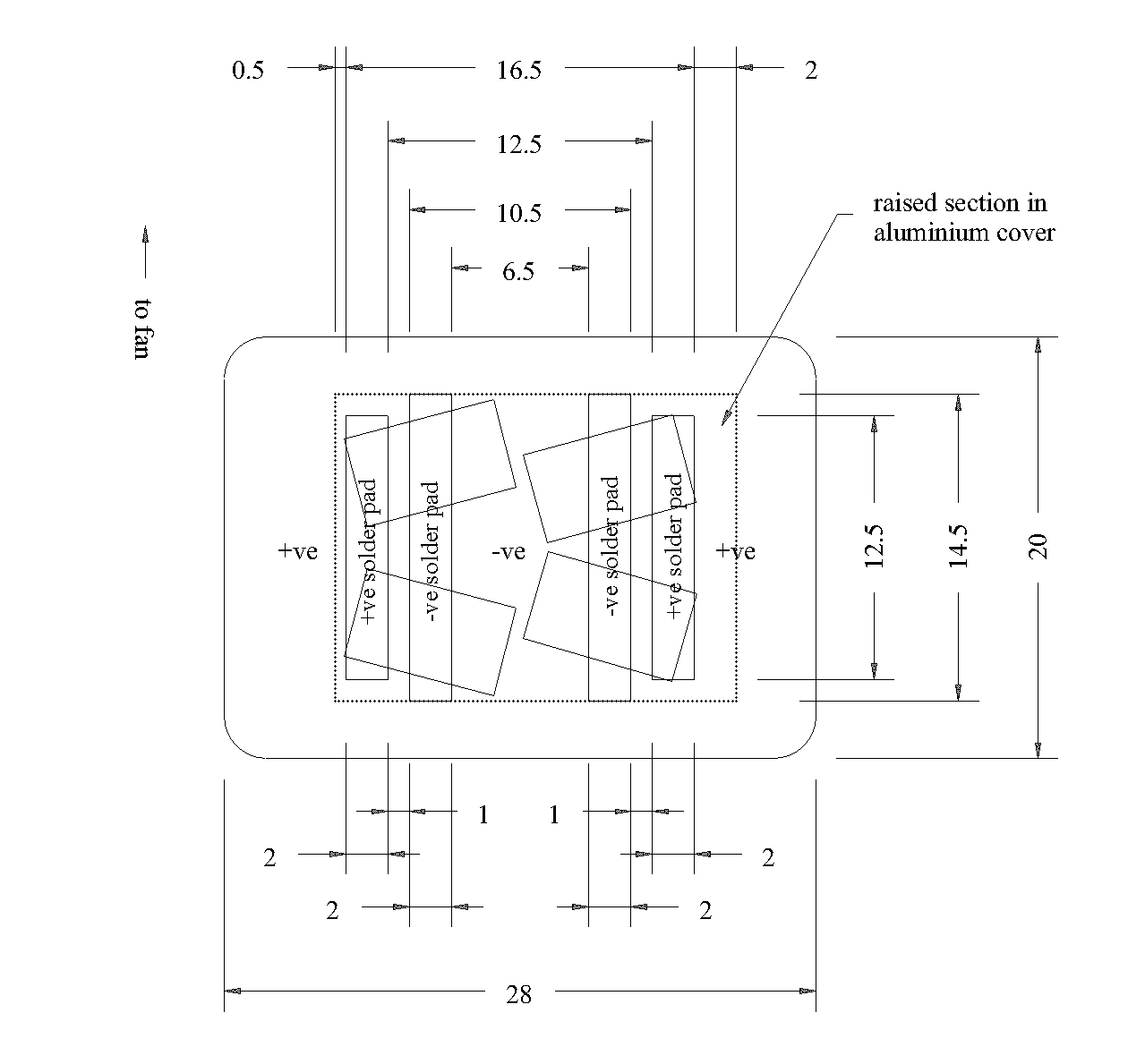

        For ease of soldering with the 3.2mm wide tip I was using in the soldering station, I decided to mount these 4 capacitors in a different layout to what is shown in this topic (see attached images).
        For anyone interested in using this layout, & so that I could contribute something to this topic, I have included some information below (apologies to all the experienced PCB repairers for all the obvious procedure comments):

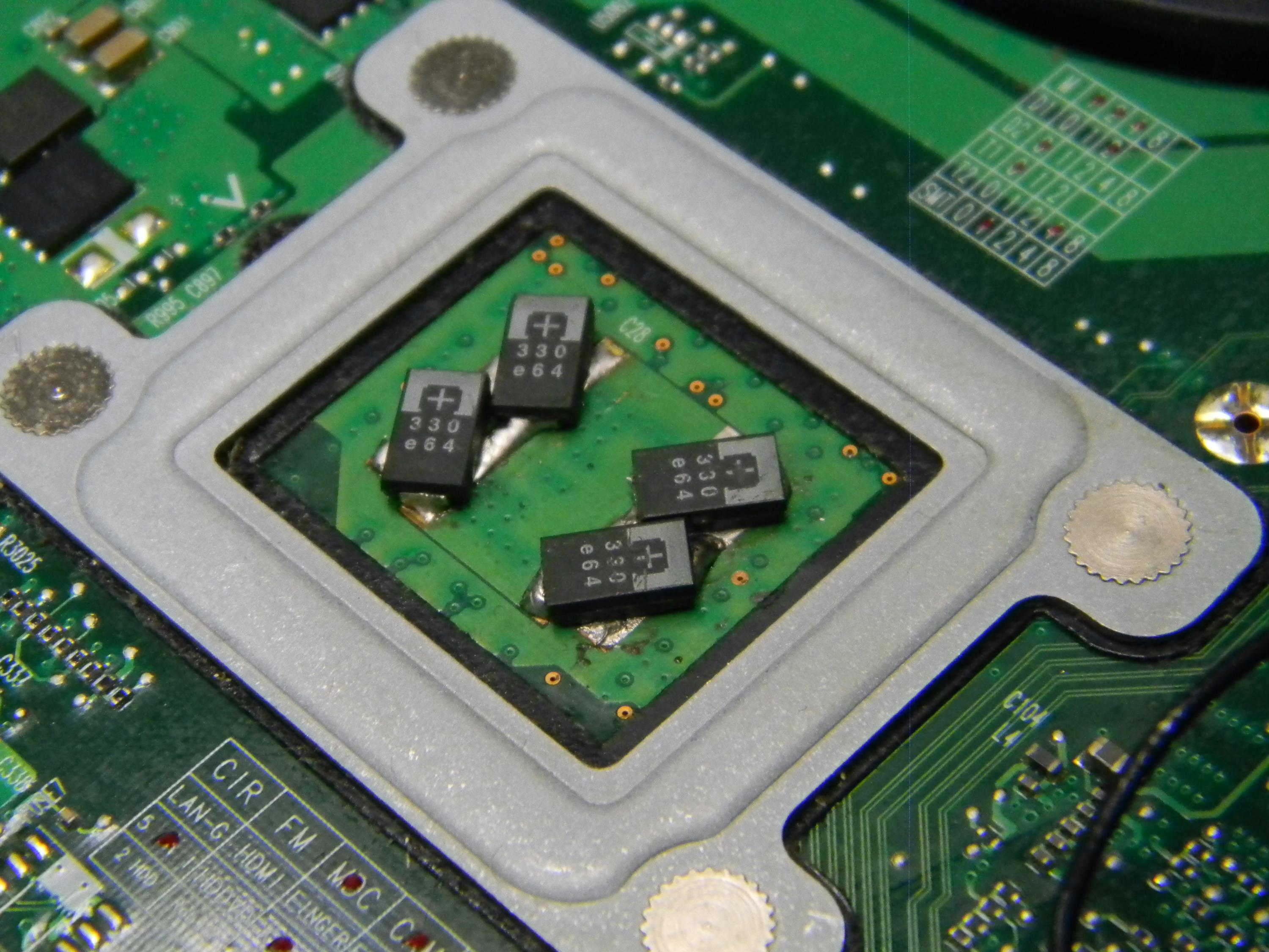

        I replaced the NEC/TOKIN 0E128 capacitor with four 330uF 2.5V Panasonic SX series EEFSX0E331XE capacitors purchased from Element14 (formally Farnell) in Australia (Element14 is pretty much world wide).
        http://au.element14.com/panasonic/ee...t=EEFSX0E331XE
        NEC/TOKIN 0E128 details: 1200uF +/-20%, 2.5V, 105ºC, 1000hrs, 0.0015 or 0.002 ohms ESR depending if the part number ends in ‘MNSTE' or ‘MTE', dimensions in mm 16.7 x 12.1 x 2.5.
        Panasonic EEFSX0E331XE details: SMD polymer aluminium electrolytic, 330uF +/-20%, 2.5V, 105ºC, 1000hrs, 3500mA ripple, 0.009 ohms ESR, dimensions in mm 7.3 x 4.3 x 2.1 (max).

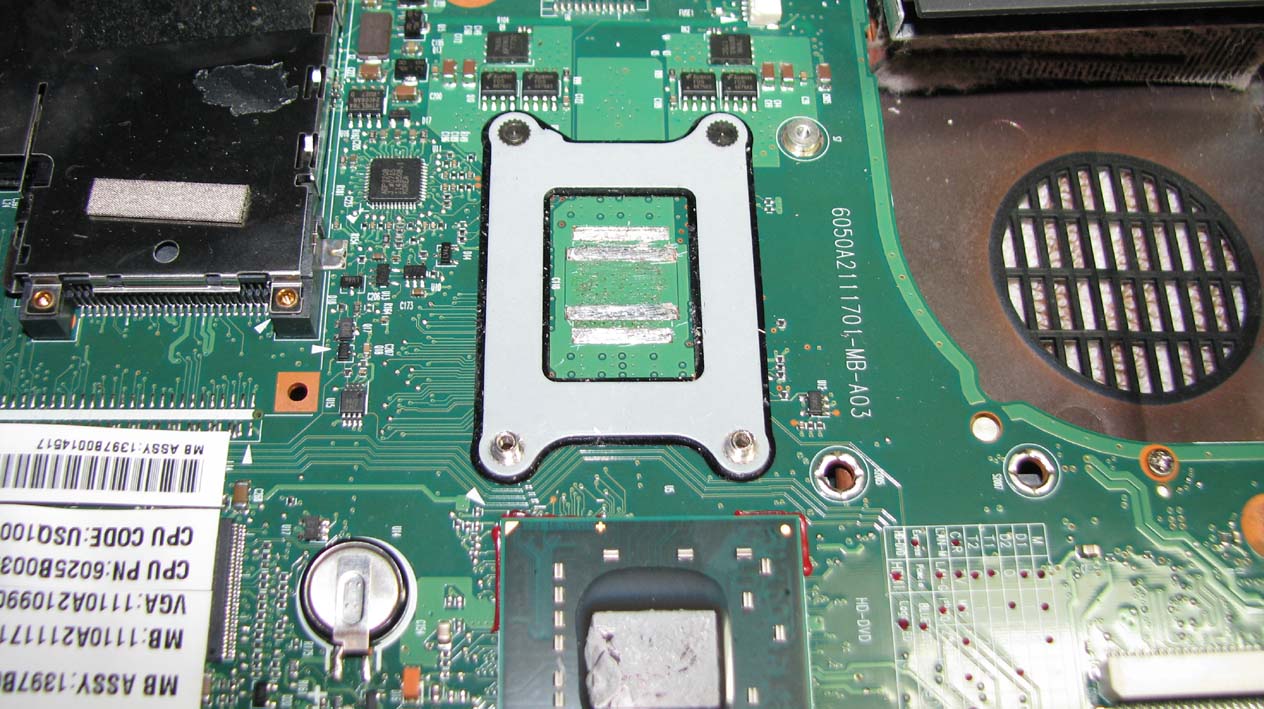

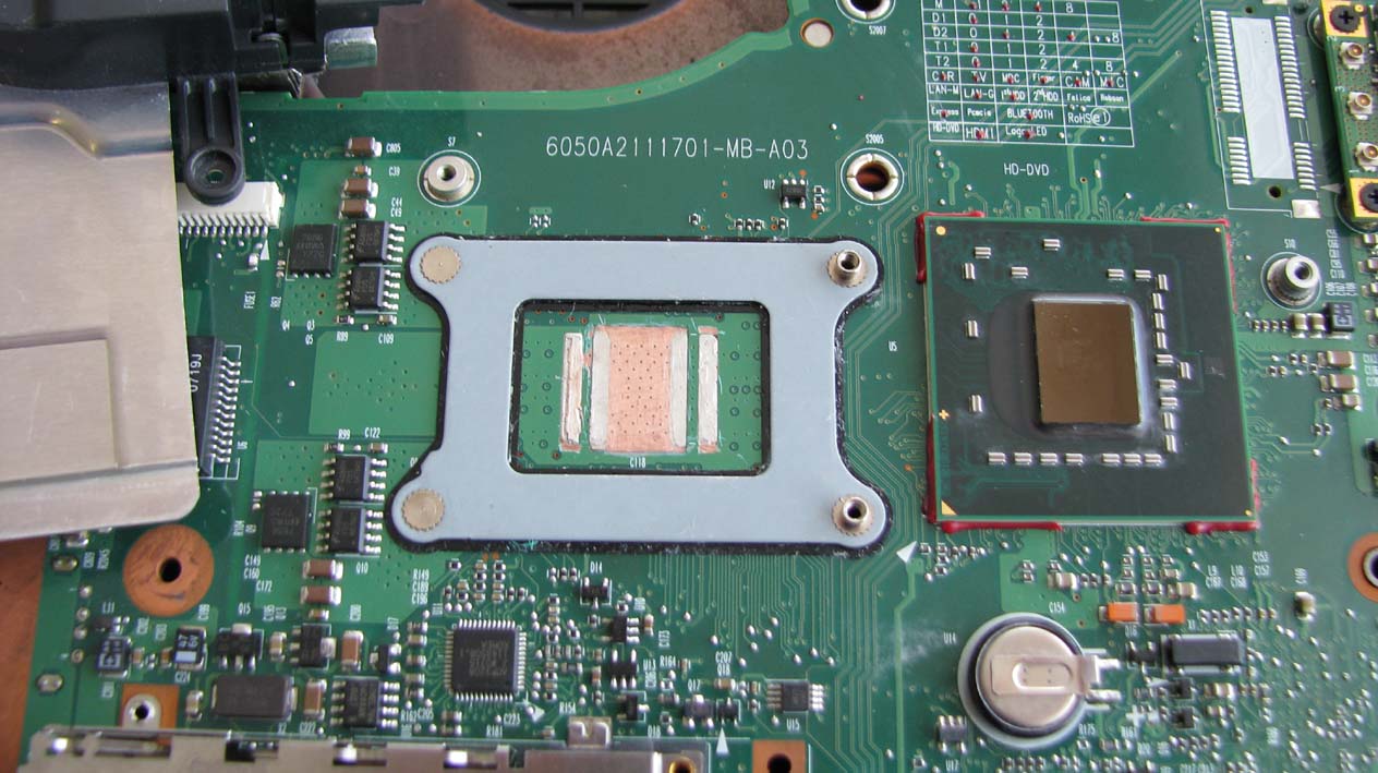

        Using this layout, the only extra effort required was the removal of most of the green finish on the PCB from between the two -ve solder pads to allow soldering of the capacitor's -ve ends to the PCB. This was achieved with a curved cutting edge blade hobby knife & a sharp flat blade jeweller's screwdriver.
        Once completed, this area was tinned & any excess solder removed with a solder wick (with only 3mm between the PCB copper & the raised section of the aluminium cover/heatsink I wanted to give as much clearance to the aluminium as possible).
        The two right hand pair of capacitors (closest together) were soldered in place first.
        My finished solder connections aren't very neat but I was more interested in getting the capacitors soldered in place as quickly as possible to prevent any damage to the capacitors (the soldering station temperature was pre-adjusted by soldering onto the –ve copper pad).
        Using a digital multimeter, ~5.5 ohms was measured between the +ve & -ve solder pads with the NEC/TOKIN 0E128 capacitor removed & prior to fitting the replacement caps (CPU still fitted).
        4.0 ohms was measured between the +ve & -ve solder pads with the new caps fitted (CPU still fitted). In both instances it took a few seconds to reach the above figures.
