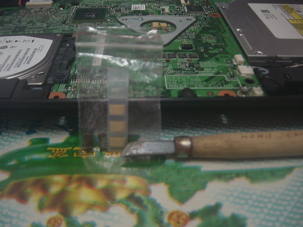

    Originally posted by oxlahun
    This step must be done very carefully, I drew a line with the tip of the screwdriver to weaken the metal foil and then I could break and lift. I used a common 30W soldering iron.
    Those metal pieces peel easily from the PCB when an edge is lifted with a sharp tool. There is no need to use an iron at this stage.

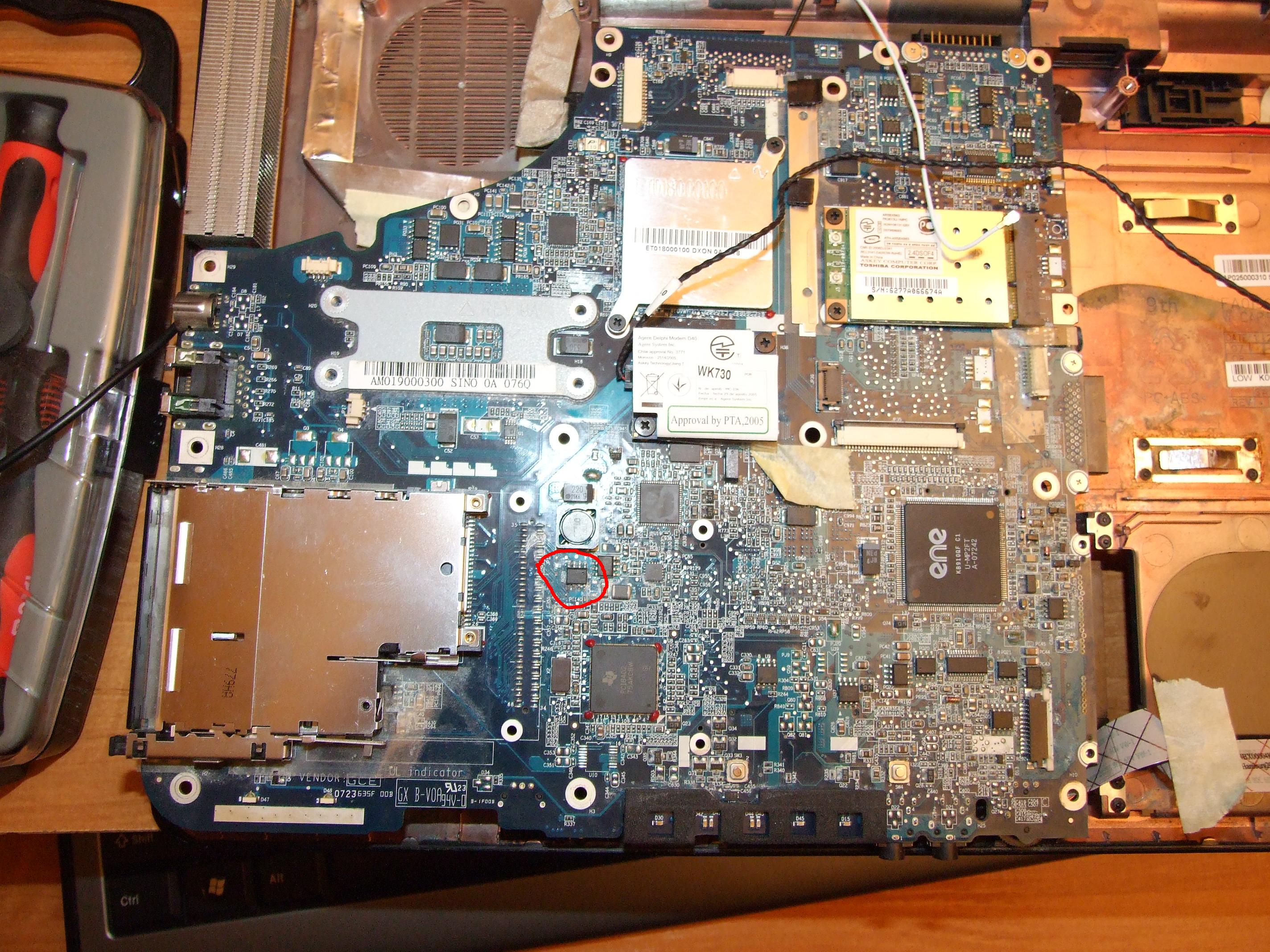

              Hello, I hope someone can help me. I have a Toshiba A200 that shows the same symptoms, works on battery (all 3 minutes of it) and freezes randomly when on AC during BIOS post, BIOS setup, Windows boot, etc.
              The problem is: I can't find any Tokin OE128 or OE907 anywhere...
              Model: Toshiba Satellite A200-1AO PSAE0E-02101UPT
              Board: ISKAE LA-3661P rev2.0
              I've attached a photo I found on Google, as my camera doesn't even come close to this resolution or quality. Just ignore the red marking.
              I removed everything and replaced cpu/ram but the problem persists. If I somehow manage to fix this board, I can finally retire my faithful 8 year old Acer Aspire 1680. Any suggestions as to what component might be causing the symptoms?

                It seems I can't edit my previous post, anyway here's an update: yesterday I ran on battery until the board powered off, then I plugged the AC, went to dinner and when I came back, turned it on and it worked until morning O_O
                Tonight I repeated the process: let the battery run out, plug AC, leave it alone for around 30min, powered it on, and just finished installing Windows 7 without a single freeze!
                OK, the problem is not solved, but at least it's usable until I find a more permanent solution. I'll take the opportunity to update the BIOS and try a few combinations of memory sticks, for some reason BIOS post (not Windows) doesn't recognize more than 3063MB, even with 2x2GB inserted. Must be some kind of incompatibility because chipset supports up to 4GB. Now where did I put those other 2GB sticks?

                  What do you get for an output on the screen when it freezes? and when the unit freeze does it restart after or what? you have to explain further.
                  but one customer came to me 2 years ago with this symptoms and I tried everything I had on mind (without having the knowledge about this fix procedure here) and somehow I did install WinXP successfully, and did some trick like start antivirus, or a game or something to make the CPU busy like that and it stays for a couple of hours but thats not a solution.

                      Exactly that, a frozen image, it simply stops in time. Sometimes it even freezes during the memory test in the BIOS post, or inside the BIOS setup. It simply freezes, and I have to hold the power button for a few seconds for it to shutdown. I don't believe it has ever restarted. Sometimes it doesn't even get to the BIOS post screen, but holding the power button always shuts it down. It doesn't freeze when in battery, at least the 3 minutes it can hold...
