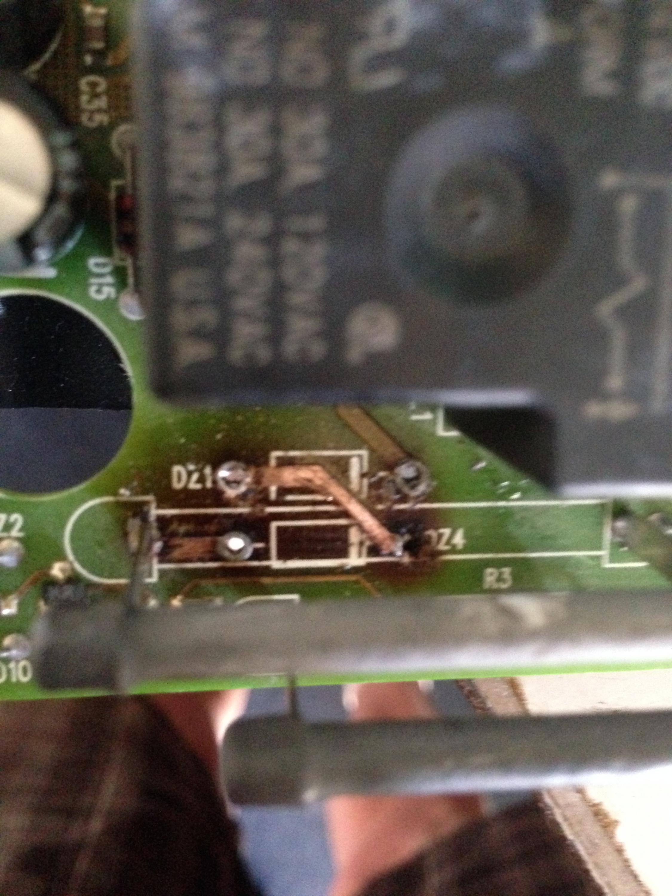

    Just closing down for tonight and the picture for budm of the top of the board flashed up
    and whilst i had not noticed before is there a hole in the top of one of the BIG caps?
    May be just dust showing up odd in the picture or the hole may only be in the plastic top
    but maybe have a close look?

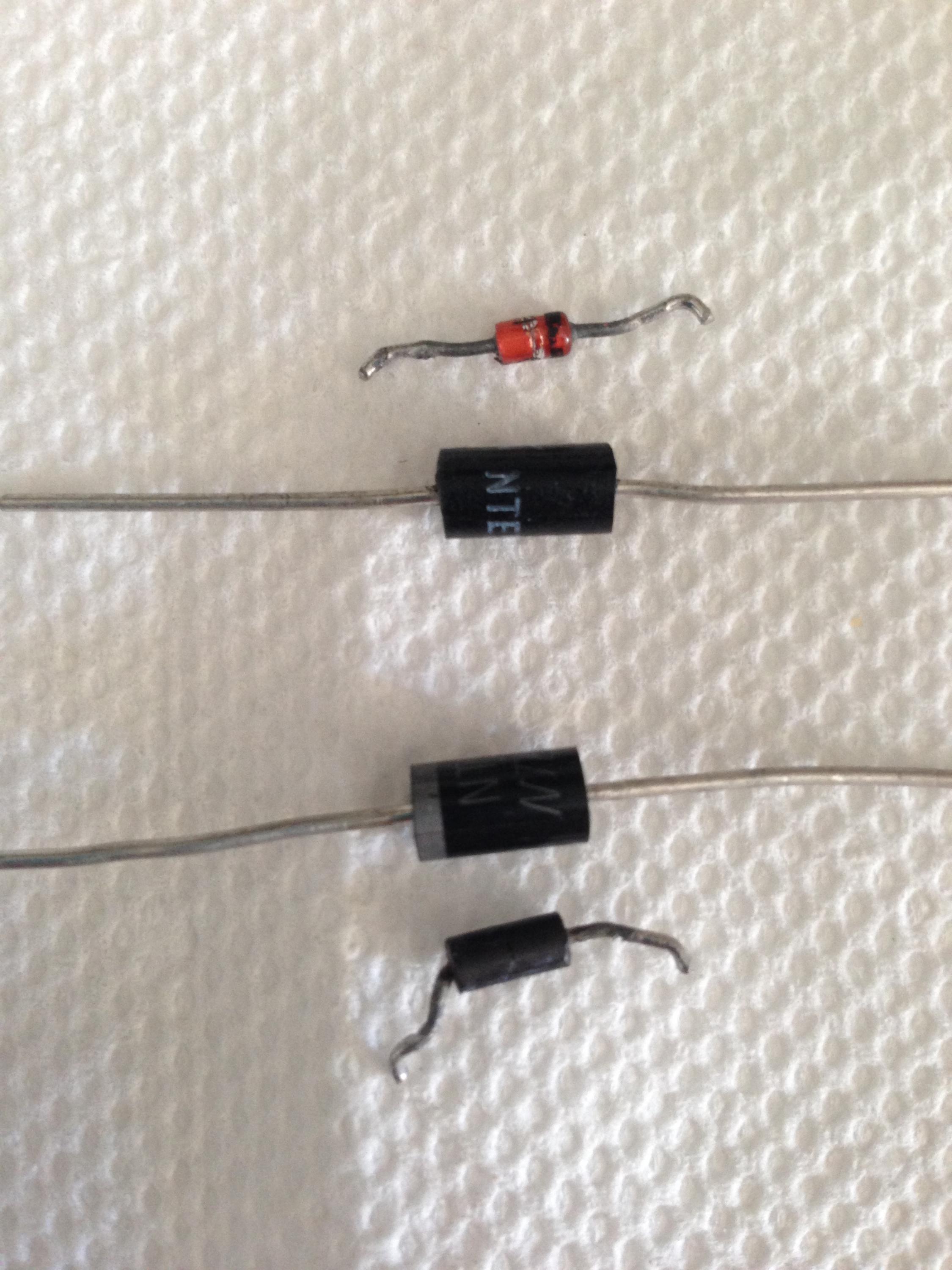

      #42
      Re: Help with Motor Control Board
      No that hole is the screw hole into the mounting board. I could only find the one 24v 5w diode. Everywhere I went they were out of the smaller 5v 1w diode. I even asked if they had a 2 or 5 watt but no luck so I have to either order one or drive 25 miles to another store.
      I picked up the NTE5137A but couldn't find the NTE5116A.

        #43
        Originally posted by budm
        That will be 15V Zener, if the legs will fit the holes then I would go with higher Wattage.
        I would also mount them with body above the board like 0.100"~0.250" to allow better air flow.
        So the C15PH is a 15v not a 5. Maybe I'll be in luck and they will have that one.
          • 31196
          #44
          c15 = 15v usually.

                  #48
                  Ok I was able to find the smaller 15v zener. These are both larger in size then the ones I removed, would that matter other then the fact it would be a tighter fit in the board? If not I'll get to soldering.

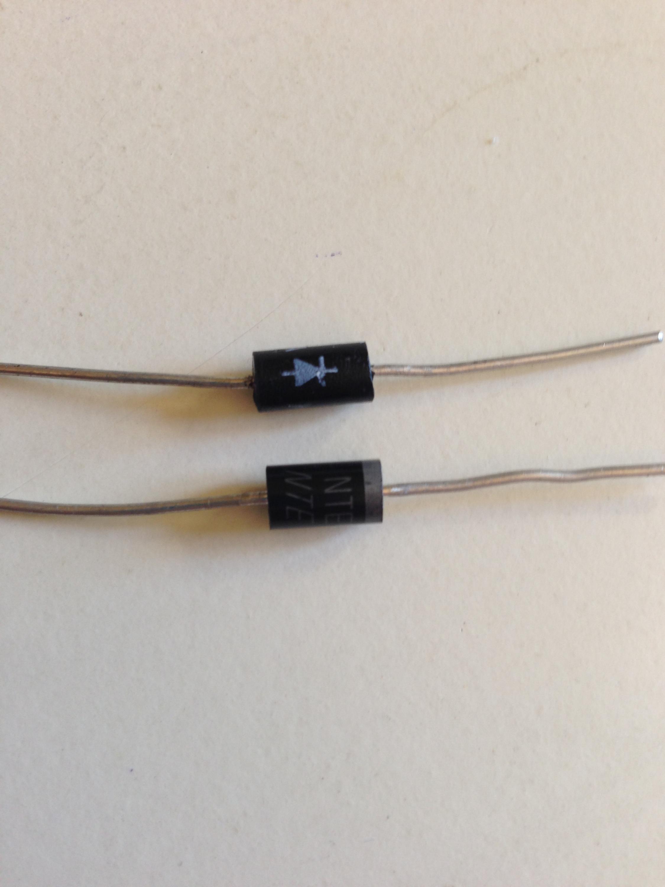

                      #50
                      Getting excited hoping this works. One more question, as you can see in the photo one of the diodes does not have a stripe so the arrow with the line represents negative side correct? Also if I put them both on with the negative on the same side then you can see in the one picture that the DZ4 negative connects up to DZ1 positive correct?
                        #51
                        "one of the diodes does not have a stripe so the arrow with the line represents negative side correct?" Correct.
                        " you can see in the one picture that the DZ4 negative connects up to DZ1 positive correct?" Cathode of DZ4 is connected to the Anode of DZ1.
                        The BAR on the pointing end of the Triangle is the Cathode.

                          #52
                          yes that is correct solder them in the same way you have them lined up in pic 1 onto the board the same way

                              #54
                              yes that is the way they are connected.

                                #55
                                BTW, the pads on the board for DZ1 and DZ4 Cathode look damaged, make sure you do have good connection since they run hot.

                                  #56
                                  I checked the pads and they were ok at least by a continuity check. I installed the diodes but unfortunately it still doesn't work. Removed the board and the diodes still read 530 and 632 so at least I didn't blow them I don't think.
