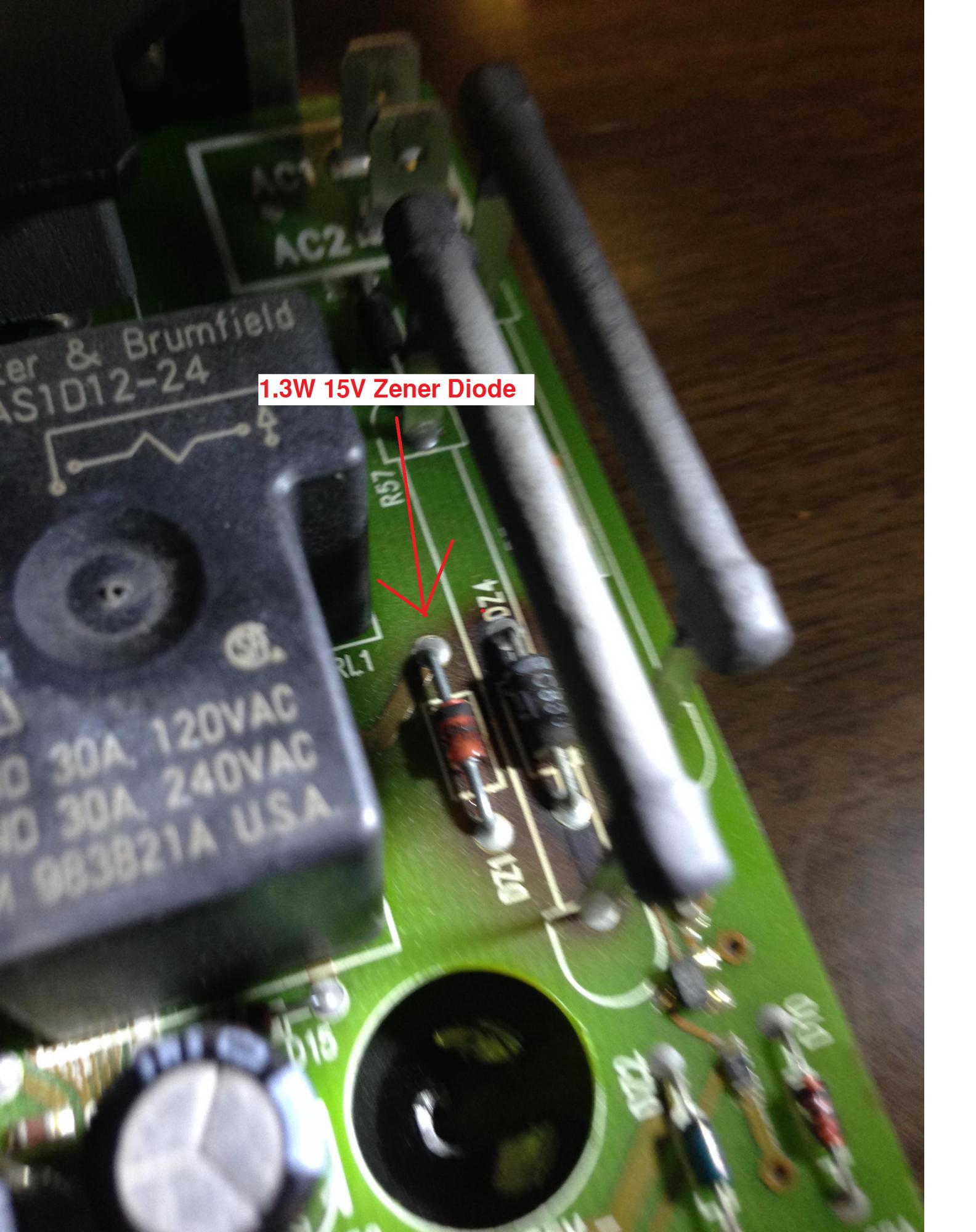

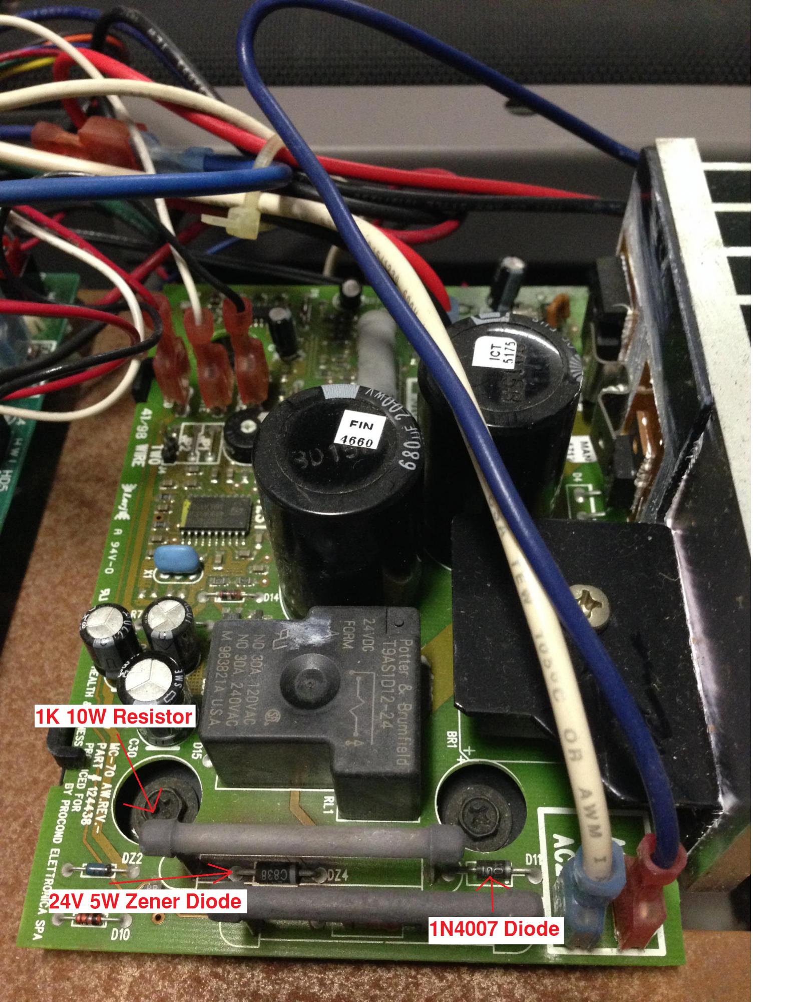

                                  Hey all, Again this old thread was helpful for me getting my MC70 treadmill motor control board running.
                                  For future individuals looking to repair their boards, here's what I replaced:
                                  1x 24v 5W zener diode
                                  1x 15v 1.3W zener diode
                                  1x 1N4007 rectifier diode (general purpose)
                                  1x 1K 10W ceramic resistor
                                  I had to bridge / repair the fried traces on *both* sides of the 24v zener diode. I simply used leads from a spare 1N4007 that was handy.
                                  The zener diodes were easy to spot & the resistor was replaced as a preventative measure. Mine was showing evidence of overheating with a white-ish color.
                                  The 1N4007 is the one at the end of the 1K resistor, where the AC connection is made. In my case, it looked ok but tested bad and was something I had on hand, so replacing it was an easy choice. Without replacing this diode - the board appeared to be completely dead.
                                  After replacing the above components, I cleaned off the old thermal paste and installed a thin coating of new paste.
                                  I hope someone finds this information helpful. My repair cost less than $20 CAD, plus shipping.
                                  Cheers,
                                  -Mark

                                    Mark - can you give the locations of the components you replaced?

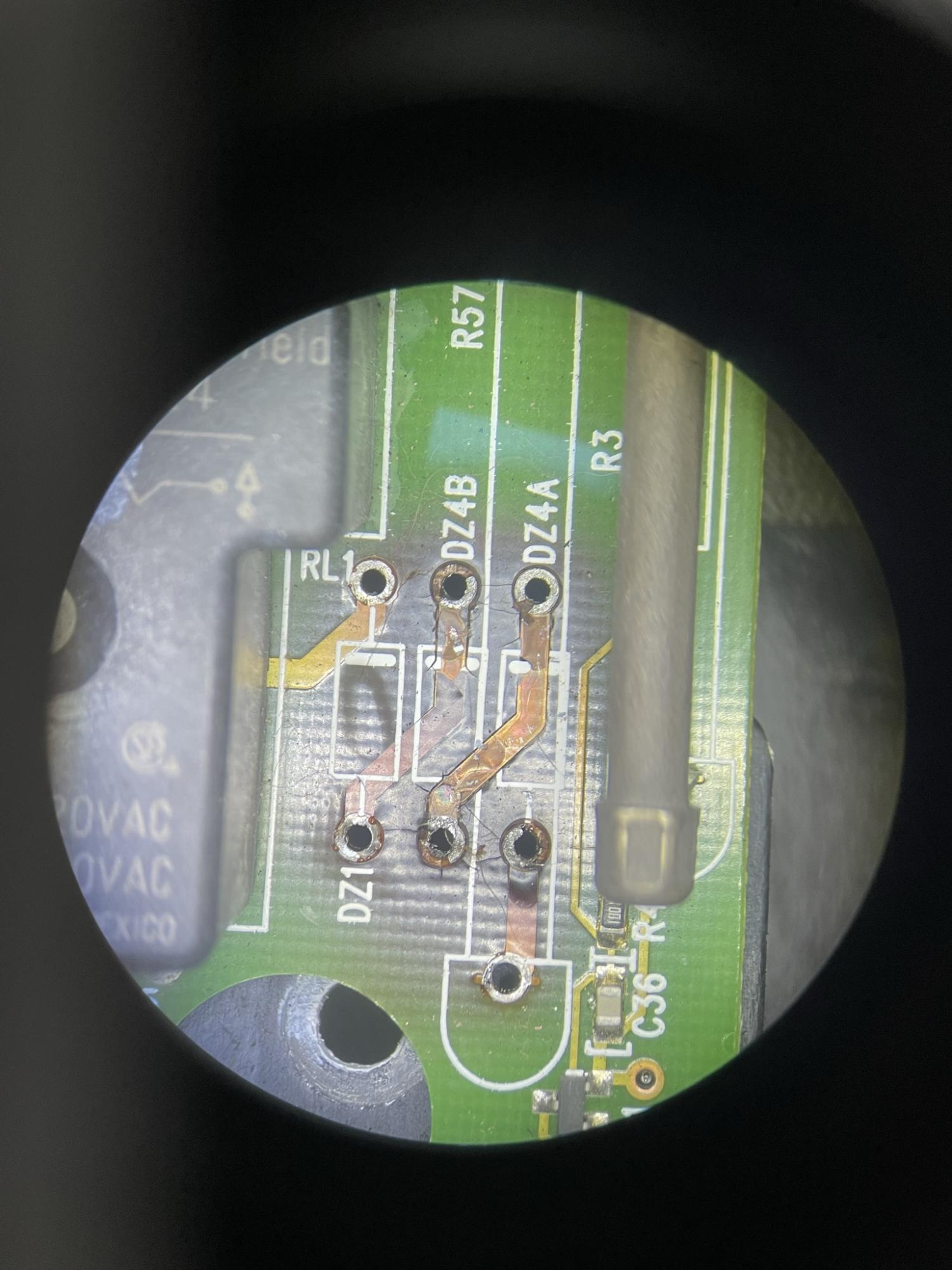

                                      I am fixing this board for my sister's treadmill at the moment. The same issue -- the motor controller board got a bit toasty in this area.
                                      My board revision is a bit different -- instead of one 24V zener there are two 12V zeners in series with the reference designators DZ4A and DZ4B. They must have gotten a good deal on 12V zeners...
                                      Anyways, based on my teardown and repair, the components above map to:
                                      • DZ4 = 1x 24v 5W zener diode
                                      • DZ1 = 1x 15v 1.3W zener diode
                                      • D11 = 1x 1N4007 rectifier diode (general purpose)
                                      • R57 = 1x 1K 10W ceramic resistor
                                      The reference designators may be different on your board, but probably not. Mine were the same as the OP based on their pictures, aside from having two 12V zeners (DZ4A and DZ4B) making the 24V zener (DZ4)
                                      I've attached some pictures for reference in case the designators are different for whomever reads this next.
                                      I plan to fix the traces with some wire or copper tape I have lying around. I will then cover the repaired traces with a green overcoat pen.

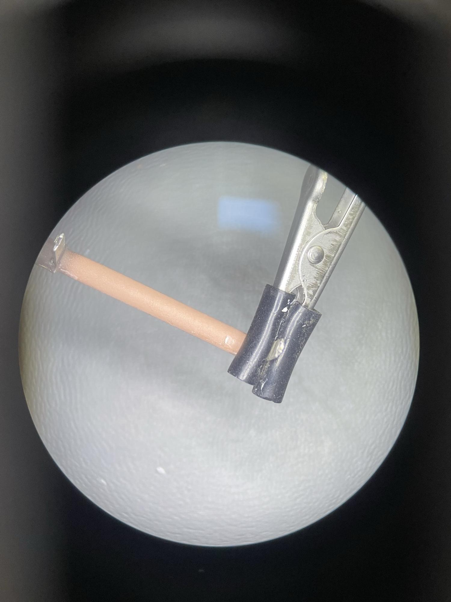

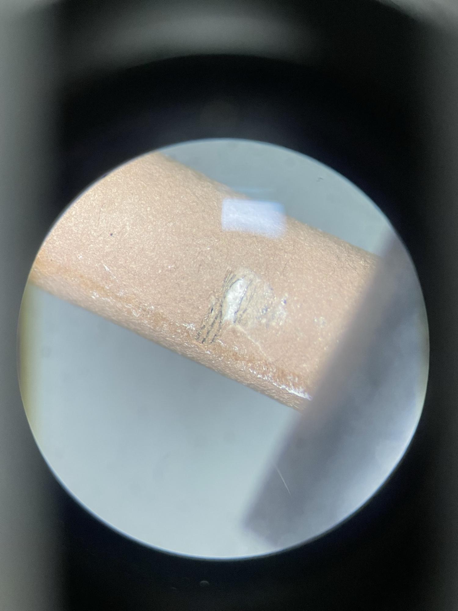

                                        Sorry for the double post. Here are some pictures from my repair so far.
                                        I used a Hakko FX-888D soldering station set to 360C with a sizeable tip. Pick up some desoldering braid/wick, I used 2.5mm wide solder wick. You should also get some flux to help the solder flow into the wick and generally make things easier, I recommend Chipquik SMD291.
                                        The traces are pretty fried, desolder the components carefully because you can easily rip the overheated traces off the board or damage the through holes.
                                        The 1K resistor exploded a bit and was open circuit when I did a continuity test on it. You can see some of the exposed windings under the microscope!
                                        I hope this info helps people repair their old treadmills!
