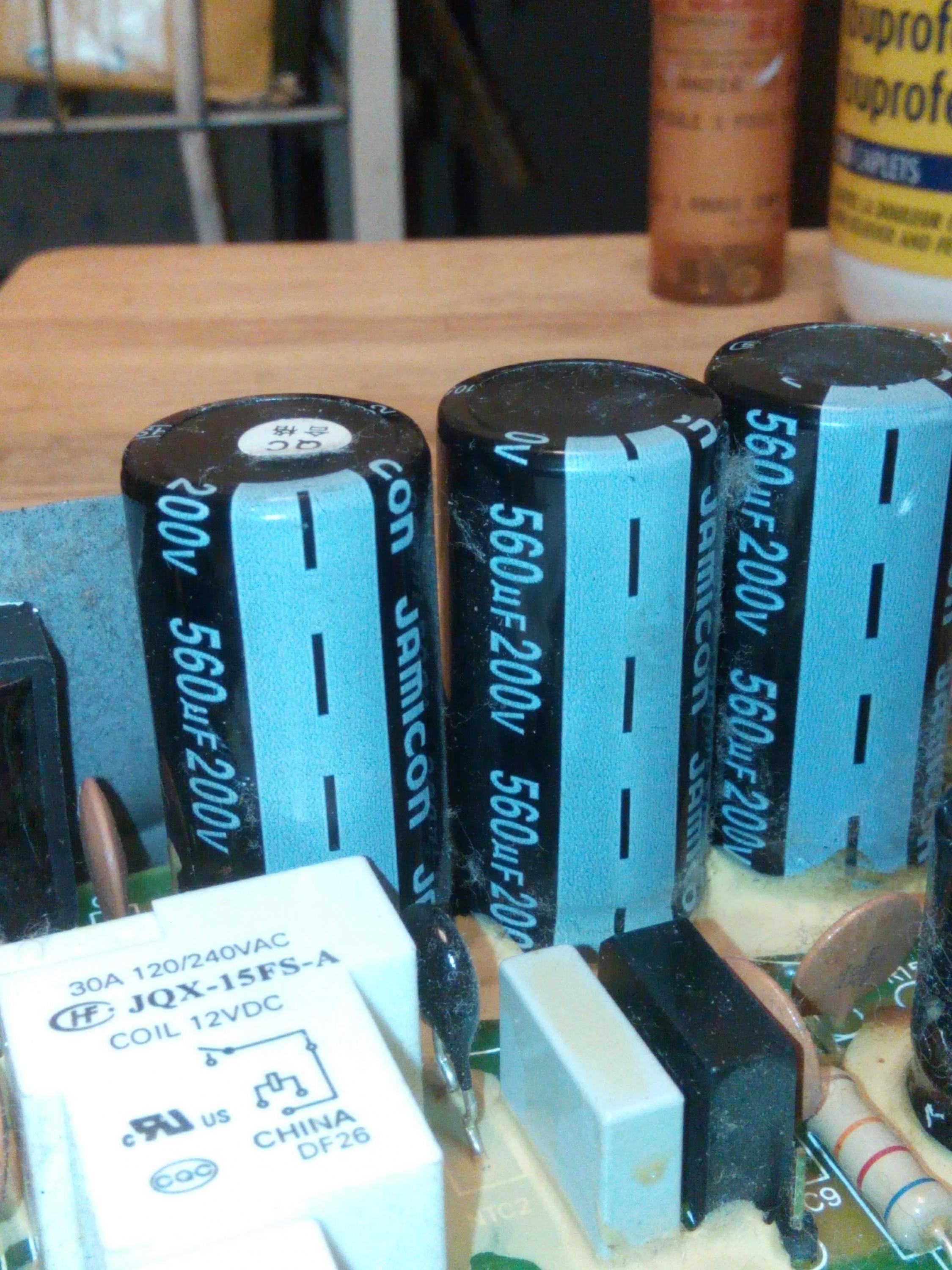

    I am looking for this Treadmill Motor Control Board 032669-IF schematic or how to fix it myself if someone can guide me and let me know what parts to change...
    I hope someone can help!
    Thanks.
    Re: Treadmill Motor Control Board 032669-IF
    Show us good clear straight shots of the top and bottom side of the boards.
    What is the unit not doing?
    What visual inspection and Voltage testing have you done so far?

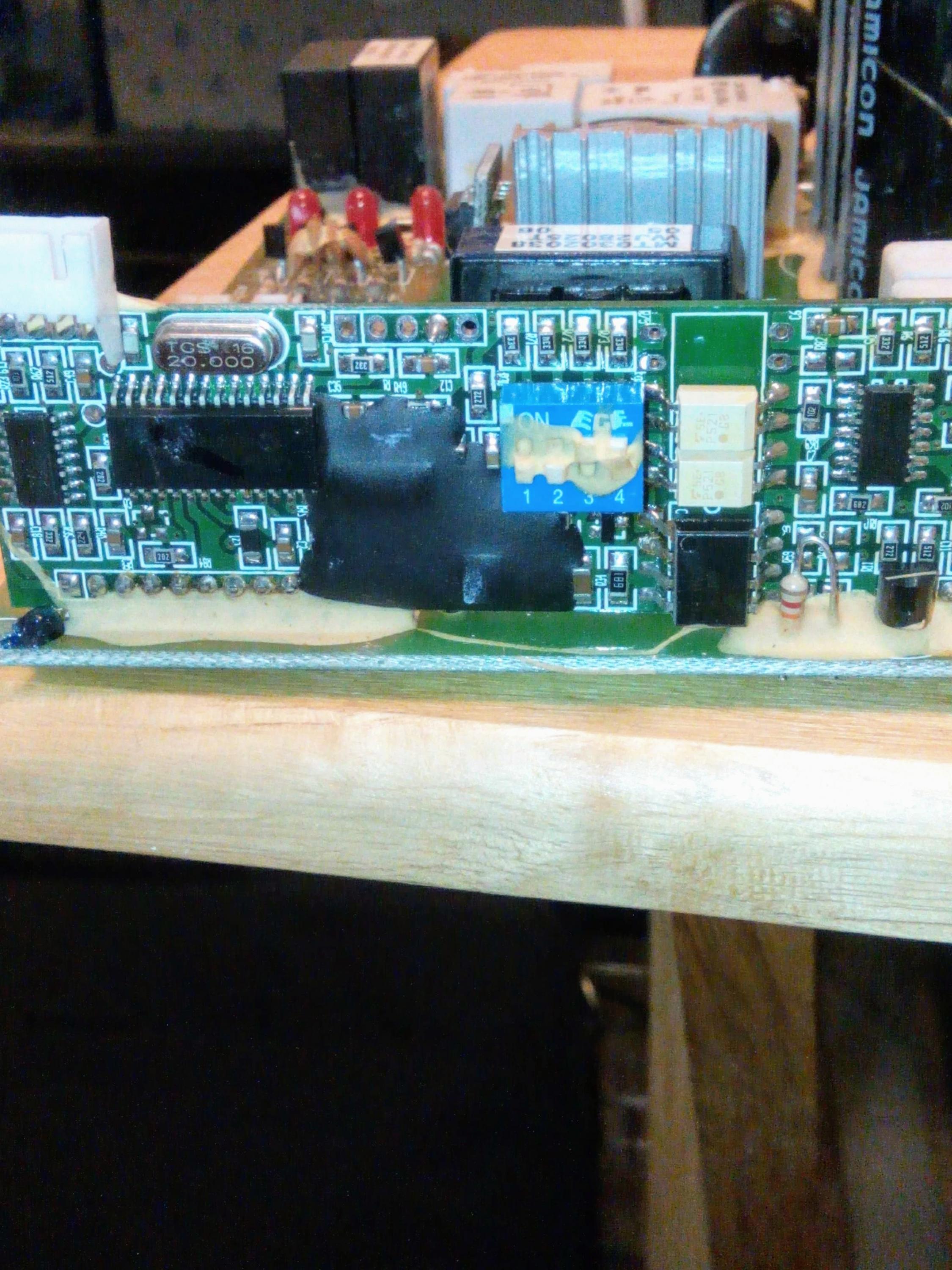

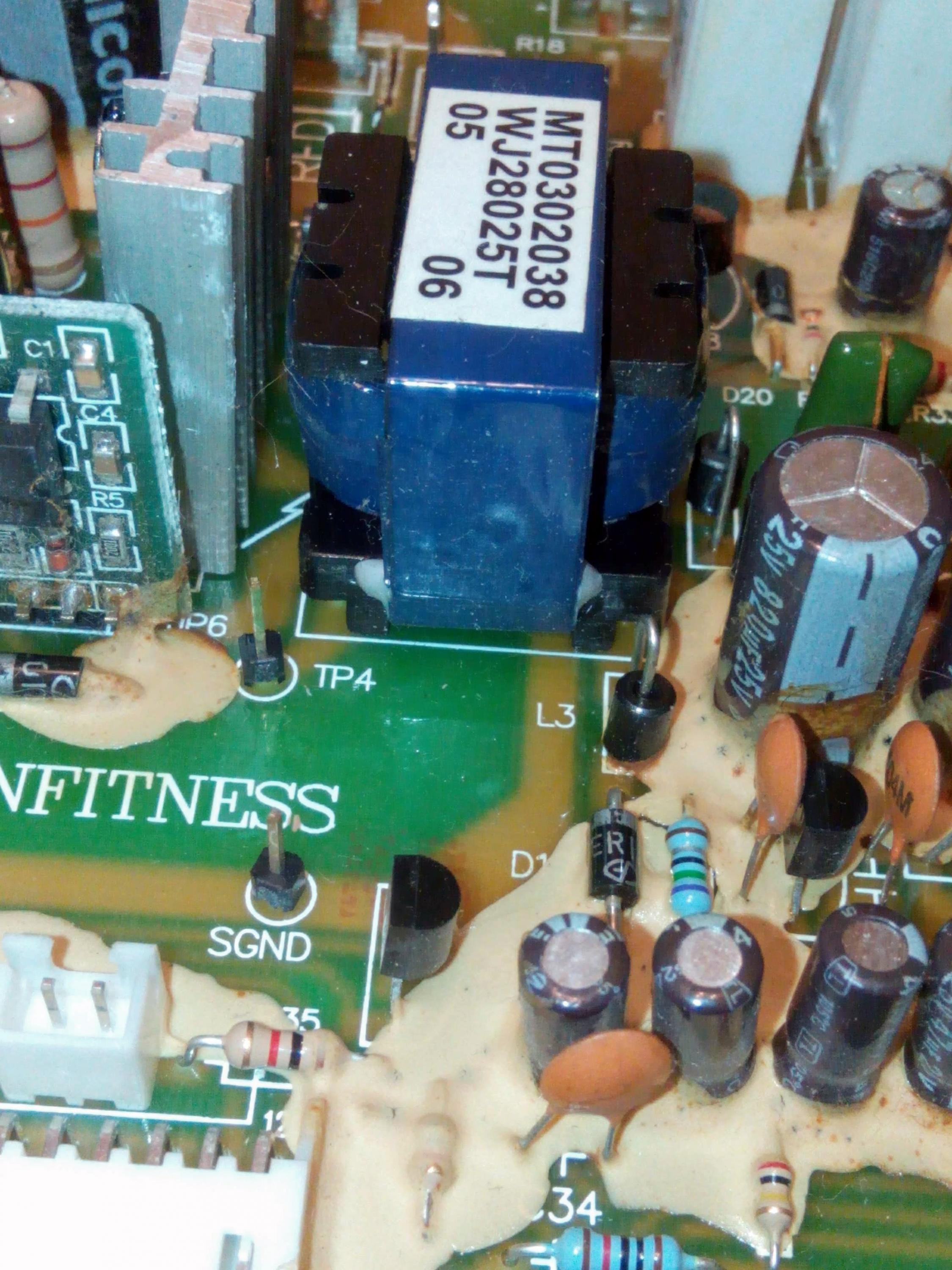

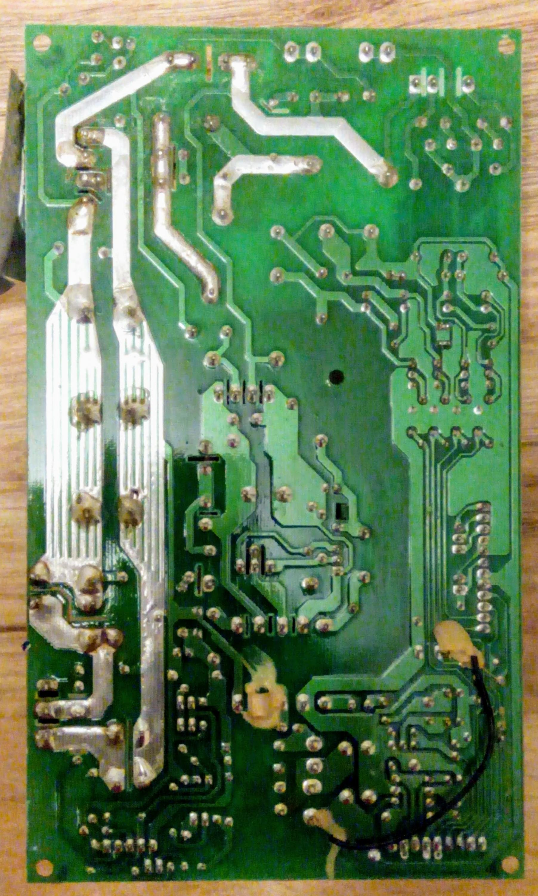

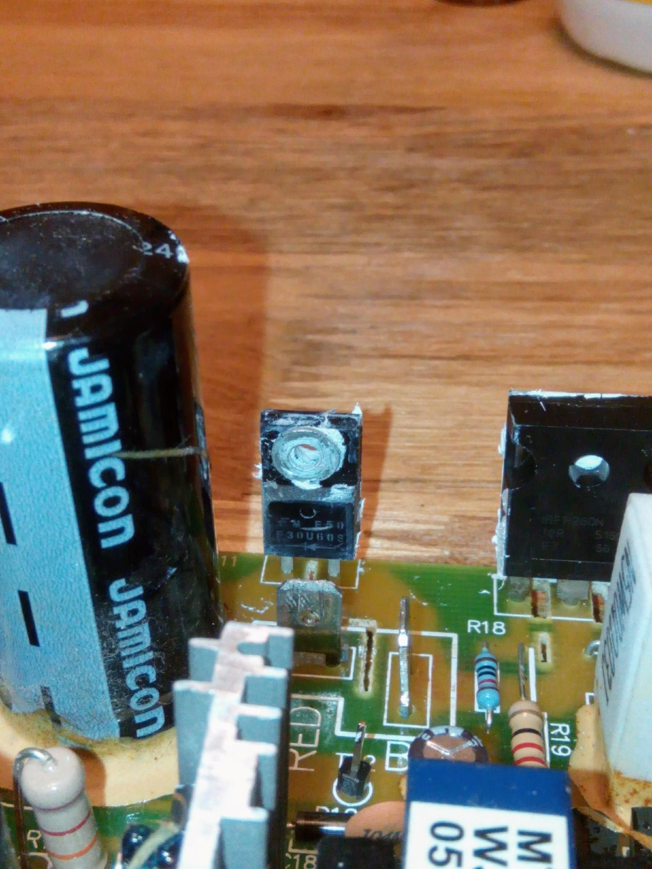

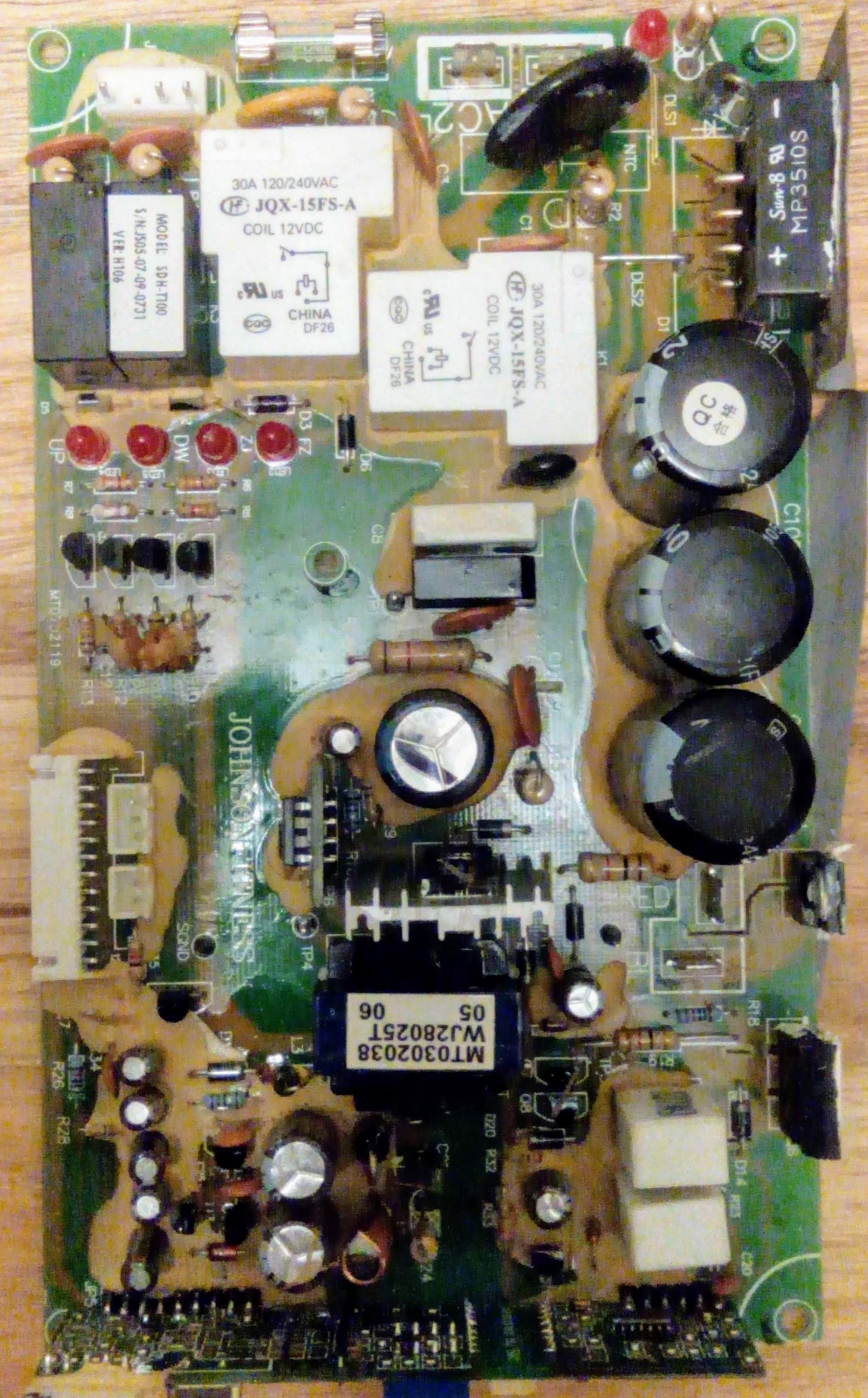

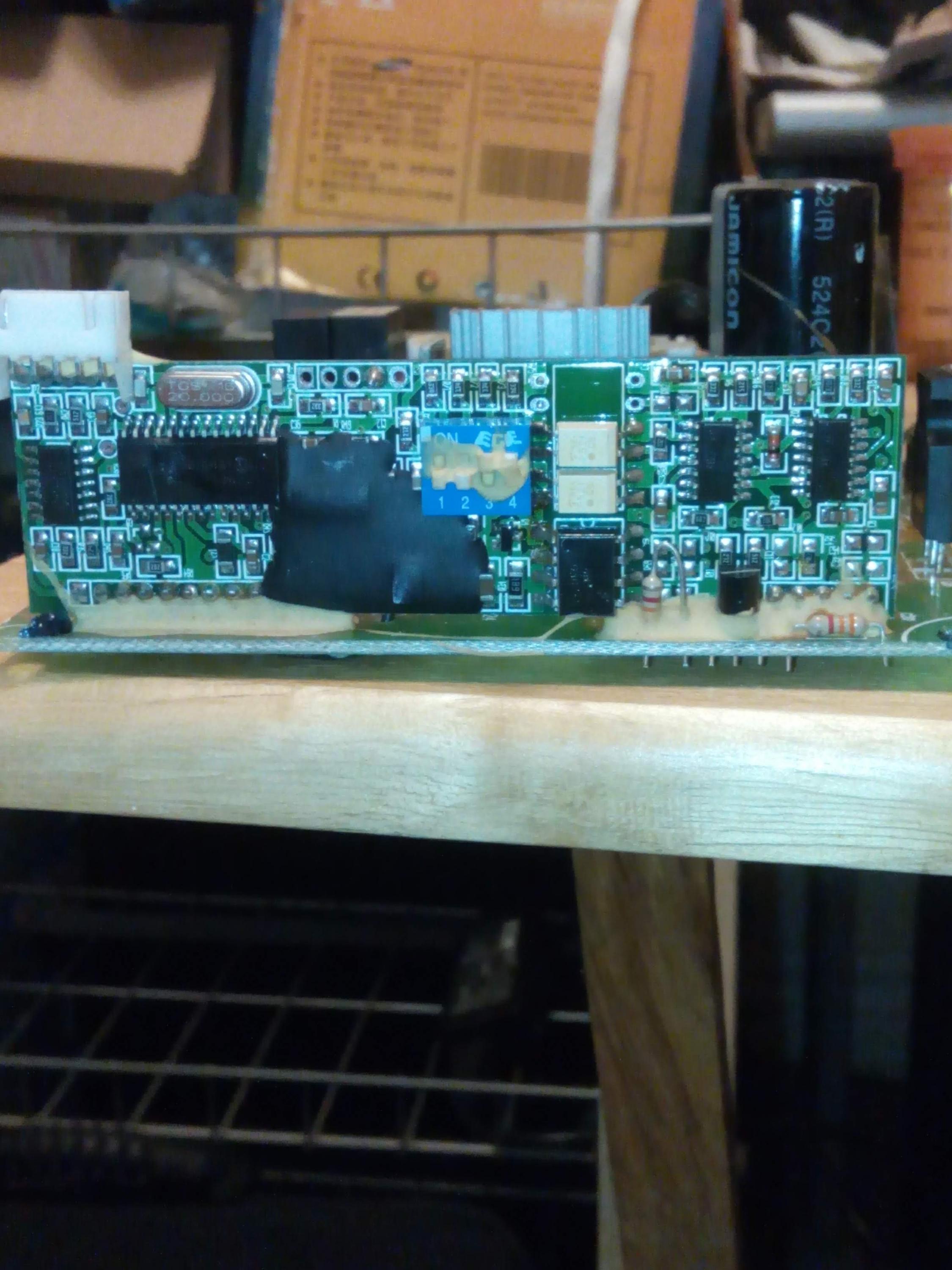

          Thank you everyone for replies, I will make sure to upload close photos of both side of the card asap tomorrow... I did the visual inspections and nothing seems faulty visually but I didn't do the tests with a multimeter yet, I've been reading on some other websites and forums about similar issue and it seems quite commons that these controller boards fail and some figured out what is the issue, but they are just selling repair service a refurbished card at high price point... this controller board is used in several Treadmills (made by Johnson) and I am trying to find a service manual of anyone of them or the schematics to be able to figure out the issue, there is 5 Led on the board and 4 test points but right now I don't have set up a test bench to be able to know what is going on with the card, the original owner of the treadmill told me that it is making sparks (but I think he was describing the sound of clicking relay) myself I extracted the card now but I didn't test it on the machine... I was hoping to find some documentation or someone who know more about can point me to the right direction.
          • eagleeyez
            • Sep 2011
            • 29

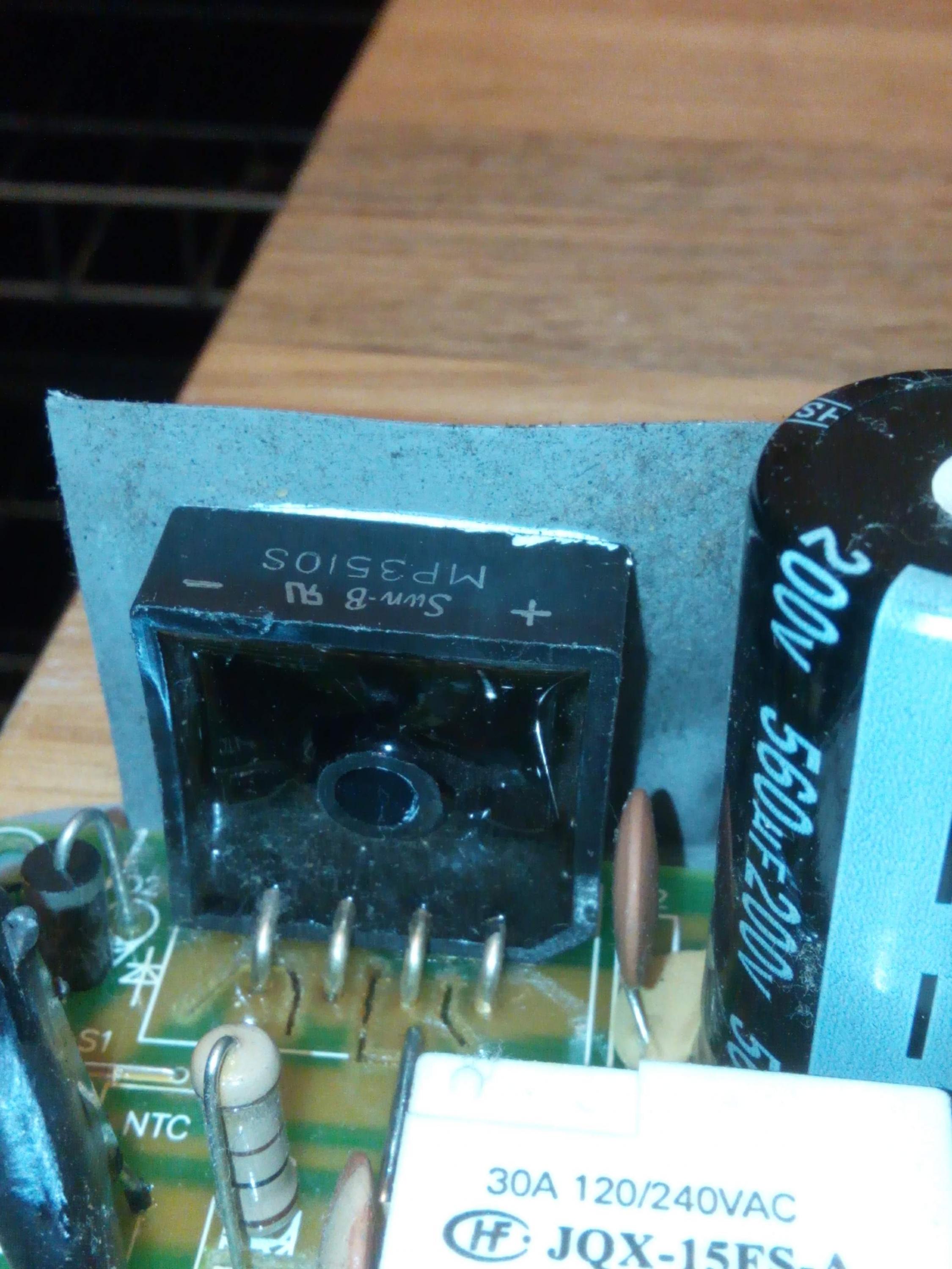

            Here is attached the images, I can host them on imagur as well if needed
            Thank you.
              I have repaired quite a lot of these over the years for customers and while I have had little success in tracking down service manuals they are generally straightforward enough to repair so long as you think of them as a smps which is essentially what they are with some logic. So in no particular order Bad solder joints, NTC, rectifier pack (usually caused by something else) electrolytic caps (the smaller ones), switching transistors, snubber caps, various relays are a weak spot and that goupy crap plastered around could do with going.
              You really need to test this partly installed, hope some of this is useful and good luck with your board.
              Hope this helps,
                    Well it is almost never the motors, but check those anyway before partial reassembly, this can most easily be accomplished by measuring the dc voltage the motor generates when rotated by hand since they are almost certainly permanent magnet dc motors.
                    An oscilloscope and function generator will be useful for testing relays once removed from the board, the LED's are mostly status lamps that indicate which motors are active, I believe there is a voltage status led there as well. I would stay away from the logic for now as this is rarely an issue, from a brief examination of your board I see no obvious defective capacitors this generally does not mean much as they don't always fail in a visually obvious way.
                        Well I would say send it to me for investigation but I see your in Canada, so that's not an option, if you not able to put the board back for basic testing other than removal, testing and replacement of suspect components your not going to get very far. If your not able to do this then the only other option is to examine possible components. From extensive experience as I suggested earlier remove yellow goupy stuff, then go through the large semi conductors and switching transistors, capacitors. Relays are a particular weak spot, don't forget to check the inrush protection (NTC) and rectifier pack. Even if you do this it will not guaranty finding the problem.
                        Kind regards Mark
