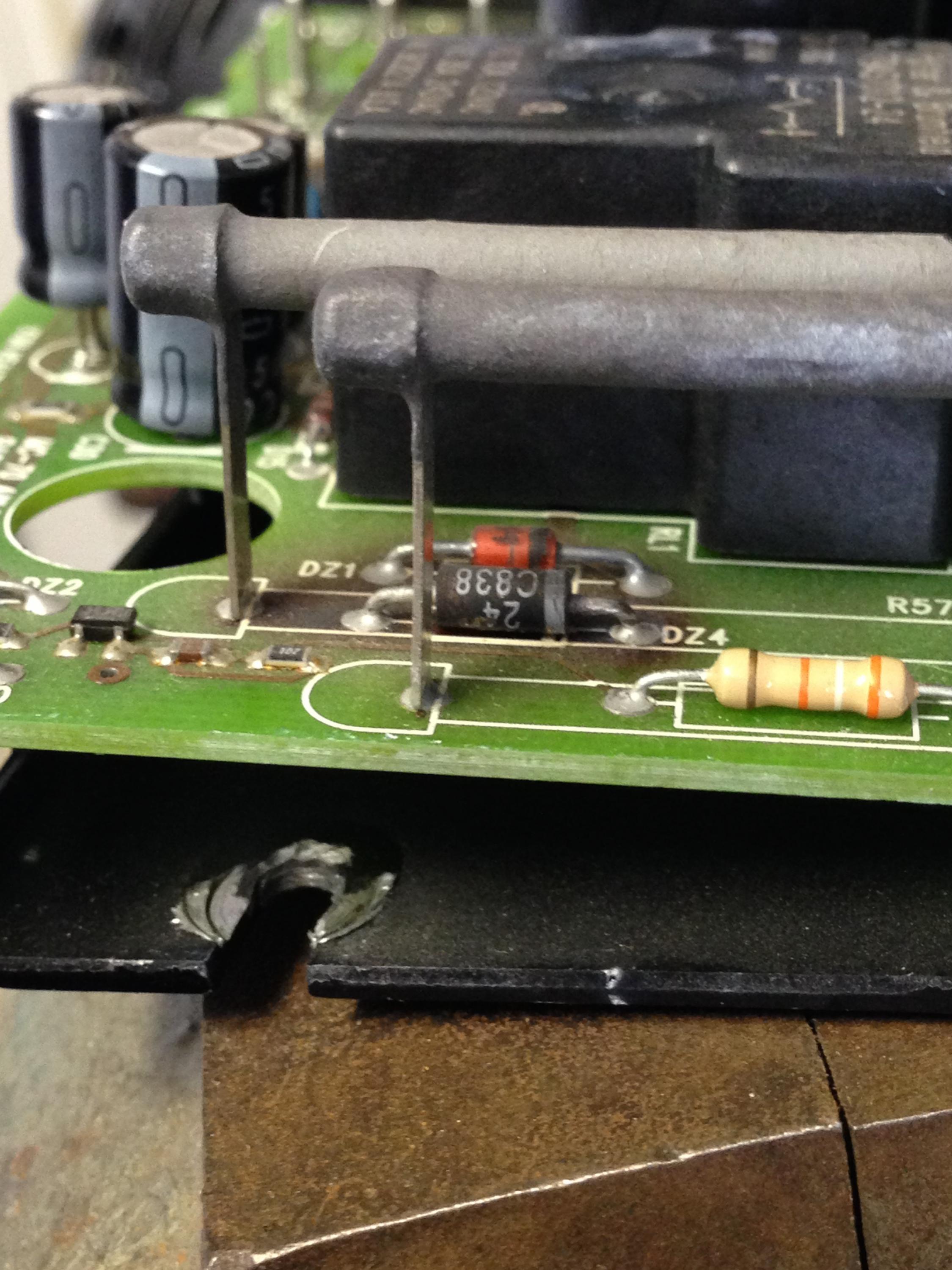

    if both of those diodes read 0 both ways then they are both shorted. as toasty stated in post 13 you should check those 2 diodes dz1 and dz4 and budm stated in post 7. i'm not the best troubleshooter but i would bet those 2 diodes are part of the problem if not the complete problem just from looking at the burn marks on the board. you said they read 0. is that with the leads of the dmm reversed also? if so you would have to desolder a leg and retest to make sure. if they do read 0 both ways they are both shorted.

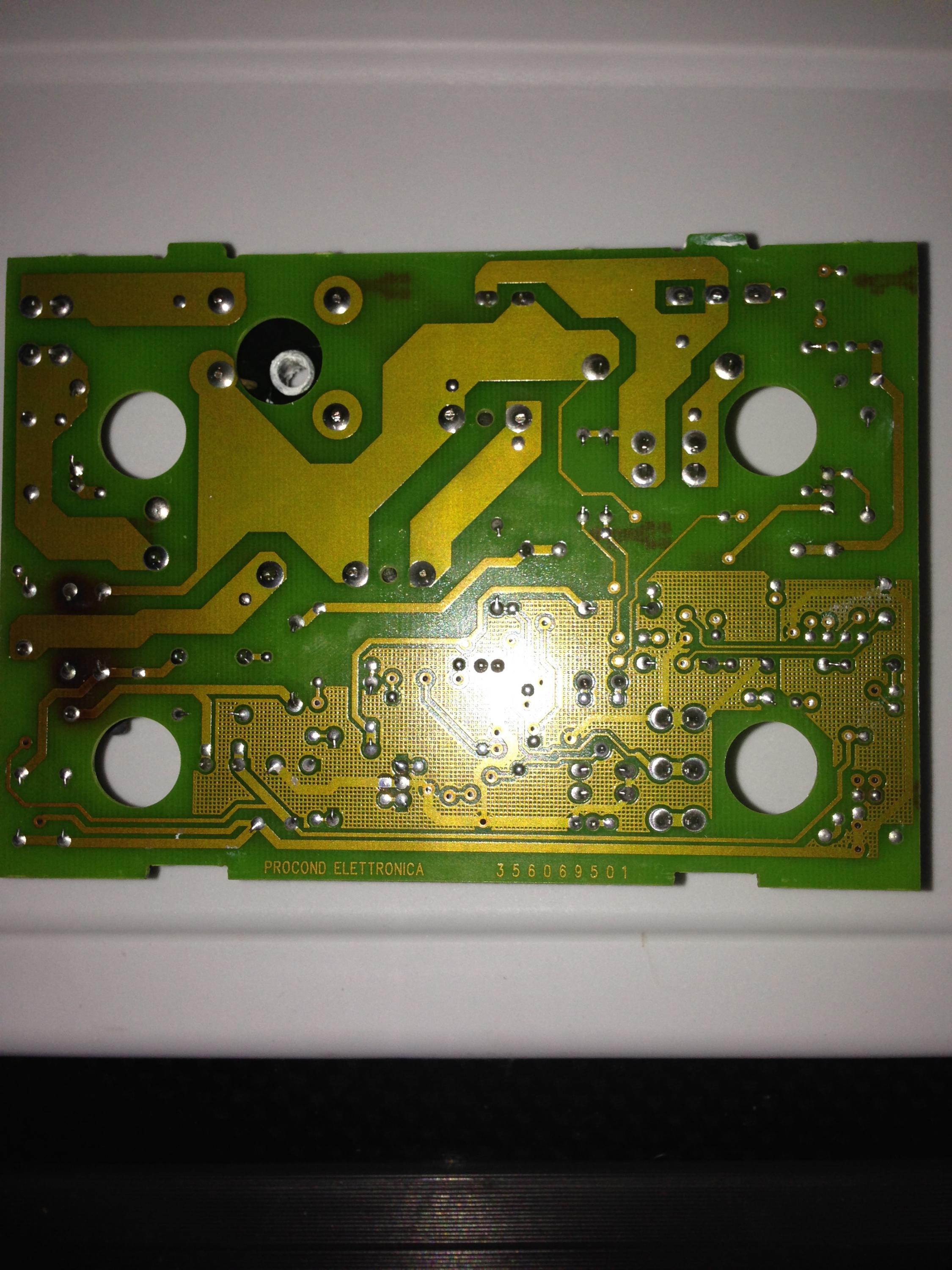

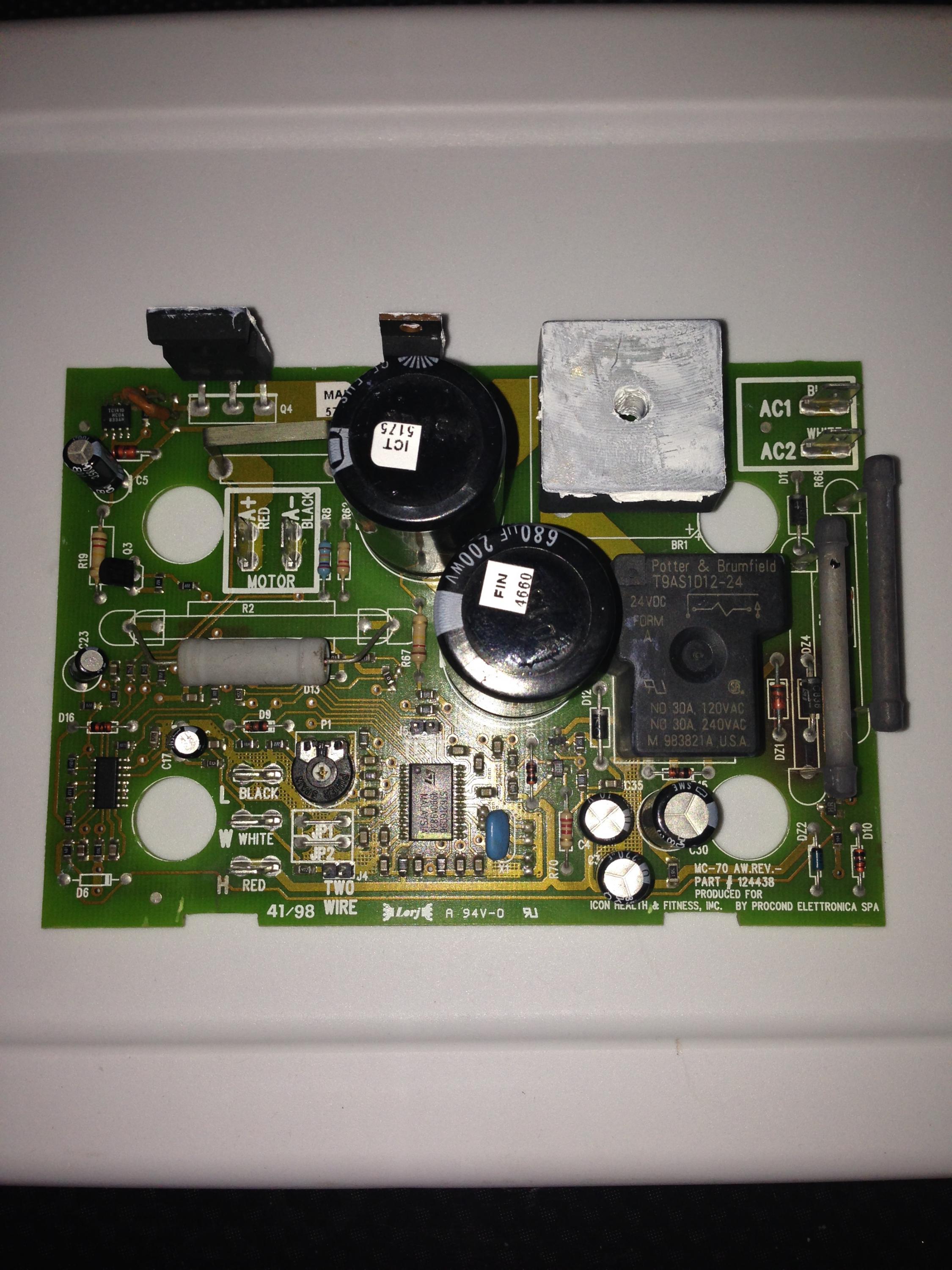

      Re: Help with Motor Control Board
      If we can get good clear pictures of the top and bottom side of the board, that will help troubleshooting a lot.
        The 2 diodes start with a reading but immediately go down to zero on. That is with the leads reversed also. Here is a top and bottom view of the board. The mounting plate and heat sink had to be removed for the photos. I also checked the black/white/red wires that are supposed to read 5v but they fall well below that at around 3v.
          Any idea what size these to diodes are? All I can see on DZ1 is 5Ph and on DZ4 24-C838.
            They may be 5V and 24V, but best way to test is to lift one leg off the board to get better reading.
            Can you the numbers on Q4 and the one next to it?
            I will look at the board layout using your pictures, I may ask for more close up pictures later on.
                  Ok I changed DMM's because the other was acting to erratic. When I test the 2 zenner diodes now DZ1 reads 005 and DZ4 reads 007. The registers the same with the leads reversed also.

                      #30
                      Did you lift one leg off the board?
                      Also check them using Ohm mode.

                        #31
                        That was with them still attached to board. I'll try my hand at desoldering.

                          #32
                          Removed one leg of diodes from board and when set at 200ohm I get .6 on DZ1 and 1.4 on DZ4. If it is set to diode mode I get .001 and .002 with continuity.
                            #33
                            "I get .6 on DZ1 and 1.4 on DZ4"
                            They are bad.

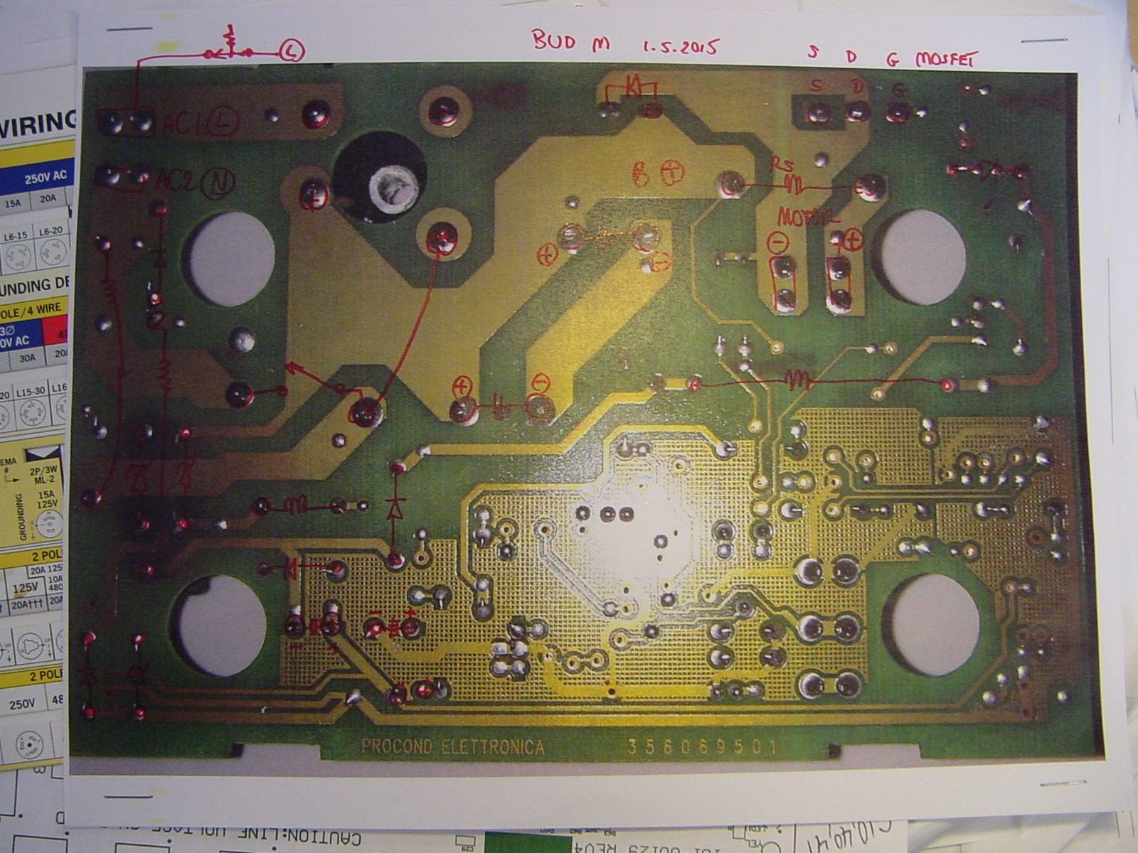

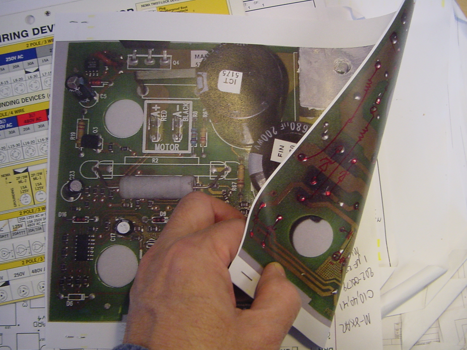

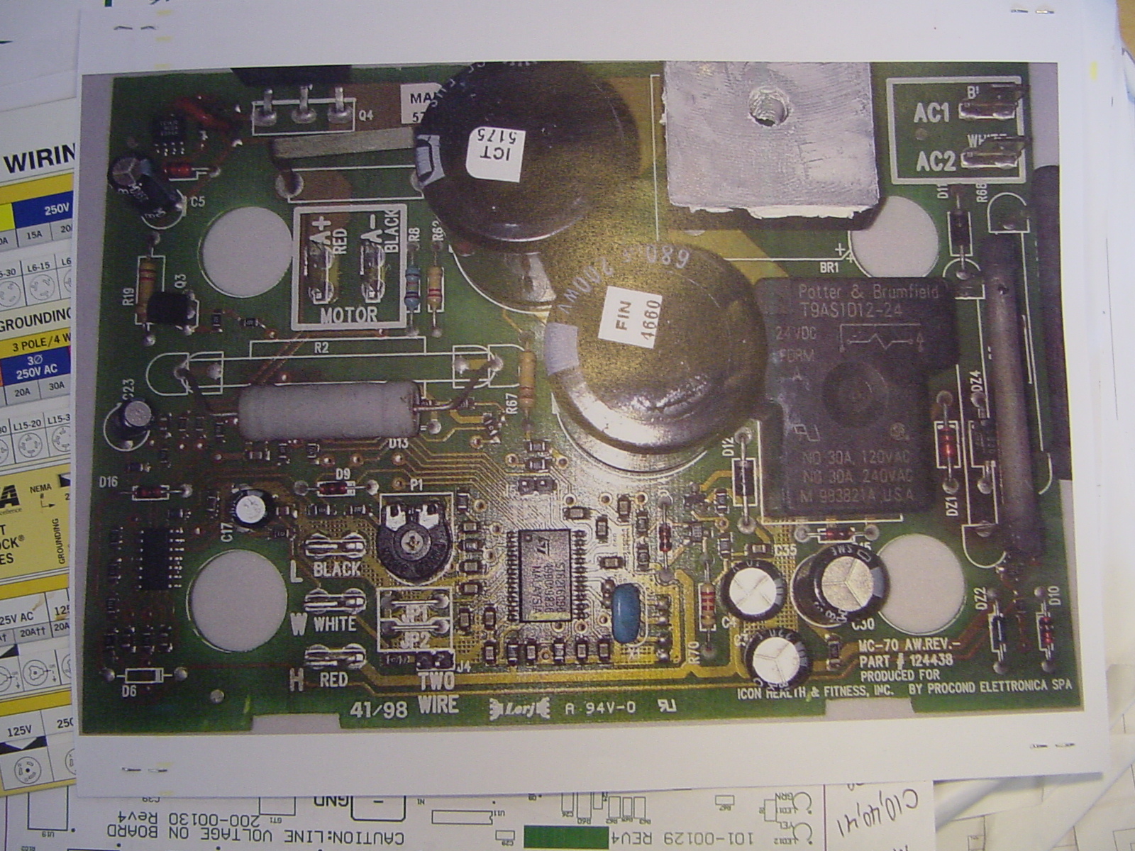

                                #35
                                So this the virtual PCBA I come up with, hard to trace out double-sided PCB.
                                The motor is driven by the power MOSFET.
                                One of the black power resistor is for soft-start, another one is for Voltage drop for the Zener diode.
                                  #36
                                  With the diodes removed, you can see the whole numbers as printed to verify the Voltages. They look like 1W ZENER.

                                    #37
                                    The black one broke in half when I tried to remove it from the board (after I got the reading) that was the 24v one. Can I go up in wattage if I can't find a 24v 1w?

                                      #38
                                      DZ1 says C15PH
                                        #39
                                        That will be 15V Zener, if the legs will fit the holes then I would go with higher Wattage.

                                          #40
                                          5w is good, next one down is 1.3w
