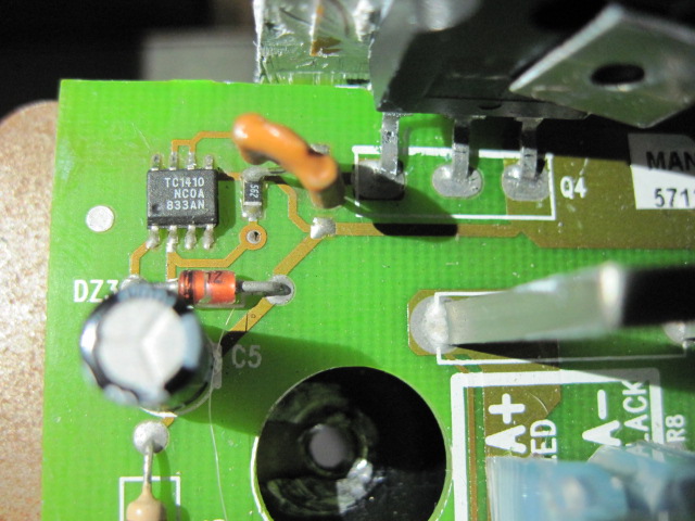

                        Here is a close up of where the gate leg goes to. It looks like it is connected to the different chips and diodes in the corner then back around to the source leg.
                          Re: Help with Motor Control Board
                          TC1410: http://www.microchip.com/wwwproducts...product=TC1410
                          Check the Voltage between VDD pin and GND, be real careful, you are working in the primary deadly side, do not let the probe slip on you.

                            OK I traced the gate leg. It goes to a 3 legged 100v capacitor. Then from one leg of the capacitor to the small 562 chip and the other leg to the 2 middle legs of the 8 legged chip (TC1410 NCOA 833AN). From the small 562 chip it goes to the 3rd bottom leg of the 8 leg chip, leg then to R19 Resistor. The left bottom leg of the 8 leg chip then goes to DZ3 which then goes back and connect to the source of the mossfet.
                              Ok you said to check VDD and GND, on the link you provided is shows pins 1 and 8 both VDD and 4 and 5 GND. Do I check red to pin 1 and black to pin 4 or pin 1 and pin 8? And I assume check with with meter on AC not DC?

                                The VDD pins are tied together internally, same for the GND pins. Meter set to DC.
                                          Is that your board in the picture? -if yes does the 3 leg capacitor have a brown
                                          mark (burn) or is it just shadow?
