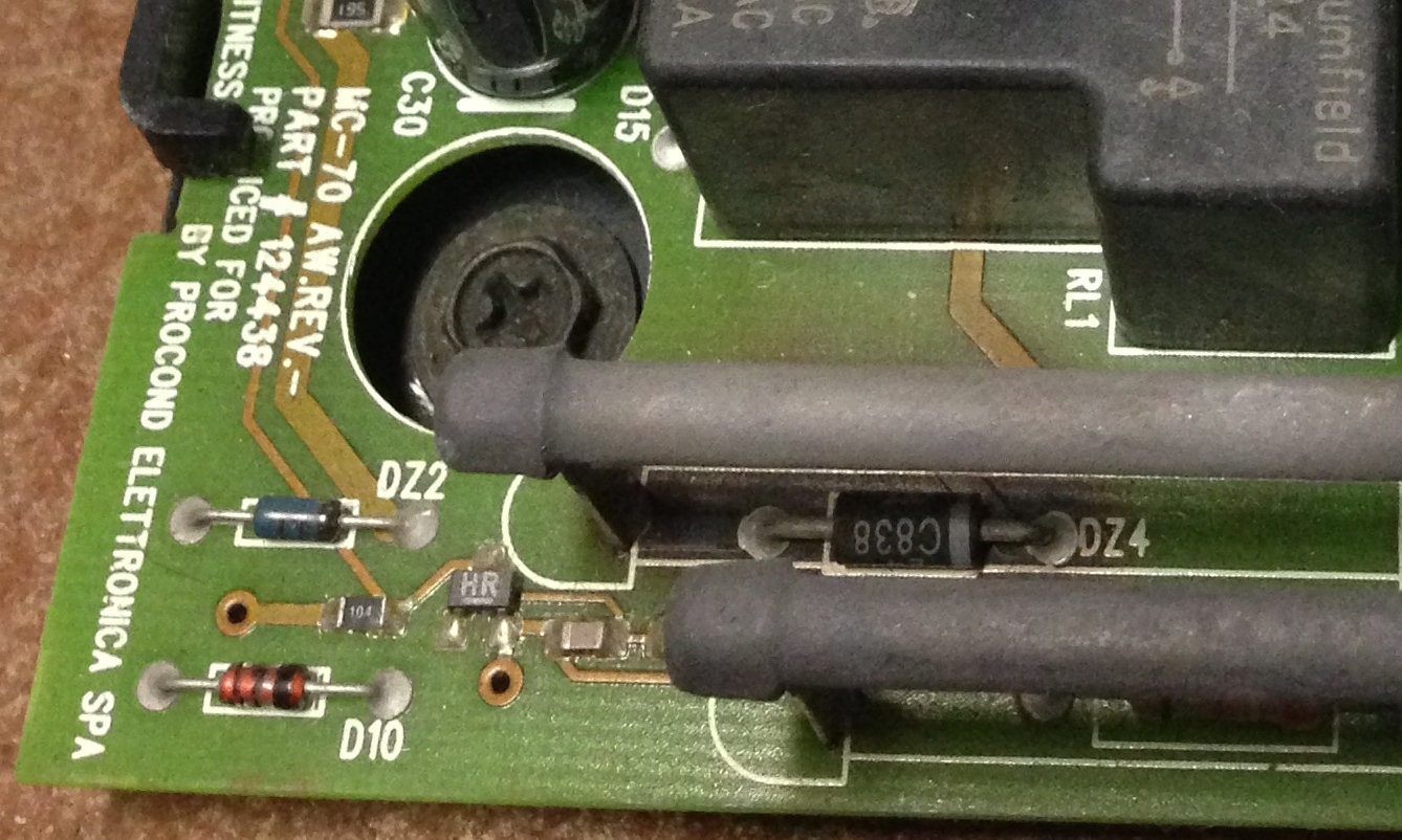

          I also just tested the diodes D9 D10 D14 D15 D16 which all look like they are identical. I get 0 reading in all but D10 which gives me an .5 ohm reading and it has continuity where the others don't. Does that sound right?
          It looks like D10 connect to DZ1 and then to the relay.

            D10: There may be another component connected in parallel with D10, you need to lift one leg or remove it off the board for proper test. Pictures and location on the board?

              Here is the picture, located on the bottom corner near where I had the bad zeners.
              This is the bottom of the board.

                  By looking at the board the only thing it is connected to is the zener in DZ1 and the one leg of the relay switch.

                      Here is another picture of where D10 goes. Not that great but I don't have color printer.
                        #191
                        Re: Help with Motor Control Board
                        It looks like generic diode 1N4XXX series, remove and test it off the board.

                          I removed D10 and it still shows continuity and reads .5 ohms.

                            Looks like it's 1n4148 diode. I hooked it up to a 9v battery and got nothing so I guess it's shorted.

                                Ok I just got the 2 large resistors, got 10w 1000ohm ceramic. Maybe not large enough cause they measure .831 and the original measure 1.442 in diode mode. I also replaced D10 and now it measures .609 but if I reverse the leads it measures 1.031. Motor still won't turn on.
