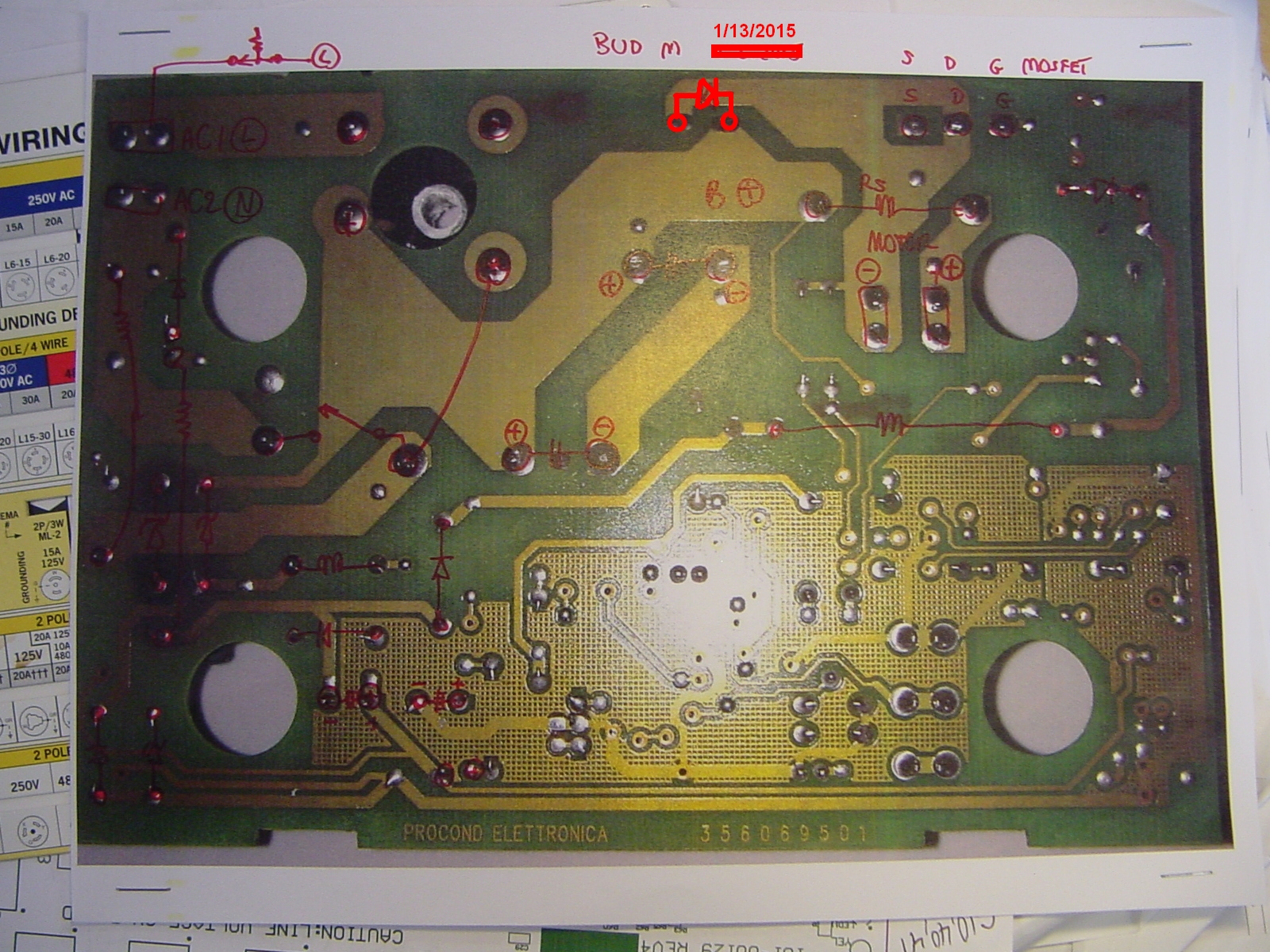

            BudM you said the diode went across Source to drain because the diode in the chip was not big enough. In your picture on post 128 the diode is going from the B+ to the Drain not the source to drain.
              #206
              Re: Help with Motor Control Board
              Ah, you are correct, I look at the trace layout and see how it is connected, it is basically across the motor for the motor back E.M.F.
                I am kind of sure that the way the diode is drawn the positive is on the positive side of the cap and the negative is on the drain which when the source connects to the drain that connects it to the negative side of the cap so that that would short out the capacitor. Maybe the diode's positive side need to connect to the negative drain and the negative of the diode to the positive cap voltage so it will not short out the cap but when the motor EMF collapses it will forward bias shorting out the motor.
                  #208
                  The Cathode has to be connected to the B+, the Anode is connected to Drain (basically across the motor, there is current sensing resistor in series with the motor) so when back EMF will be diverted to the Diode. The MOSFET is connected as sinking for the motor.
                  This is how it is connected, the MOSFET sinks the motor:
                  http://www.spaennare.se/pwmdig.html

                            The MOSFET is already shorted out when you were probing the driver IC, you also verified that it has low resistance reading on the MOSFET.
                            If you replace just the MOSEFT without repalcing the driver IC then you are taking a chance of damaging the new MOSFET if the driver IC is damaged.
                            We need to get the unit back to the same condition as before you were probing the IC and damage the MOSFET.
                            ""What I think should be done is to solder a shorting wire across the motor control FET & see if the motor runs when power is applied." It is already running at full speed due to the shorted out MOSFET.
                                    Just wanted to let you know that in you post 128 the Anode is connected to the B+ not the Cathode.
                                          Thanks for catching that. I made an correction, hard to make 100% correct when I do not have the board in front of me.
