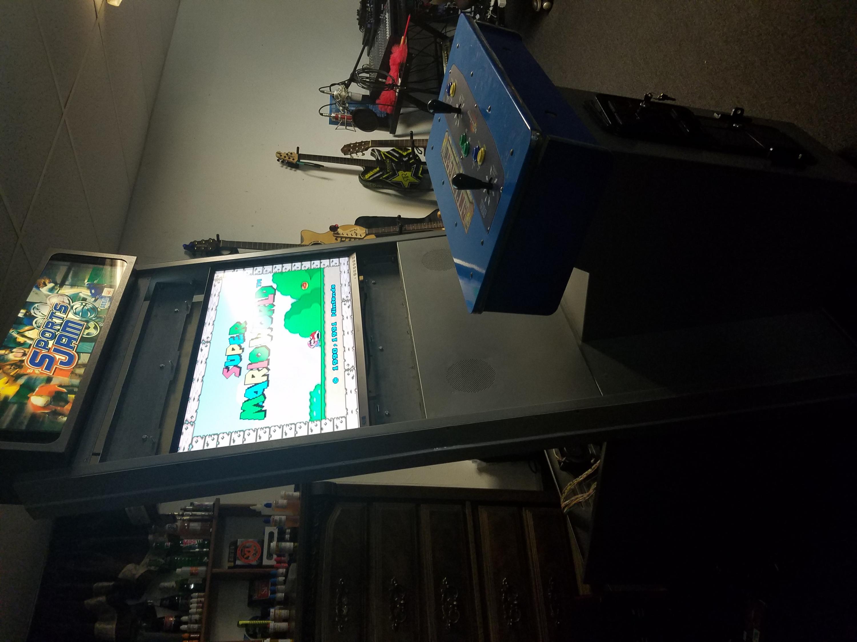

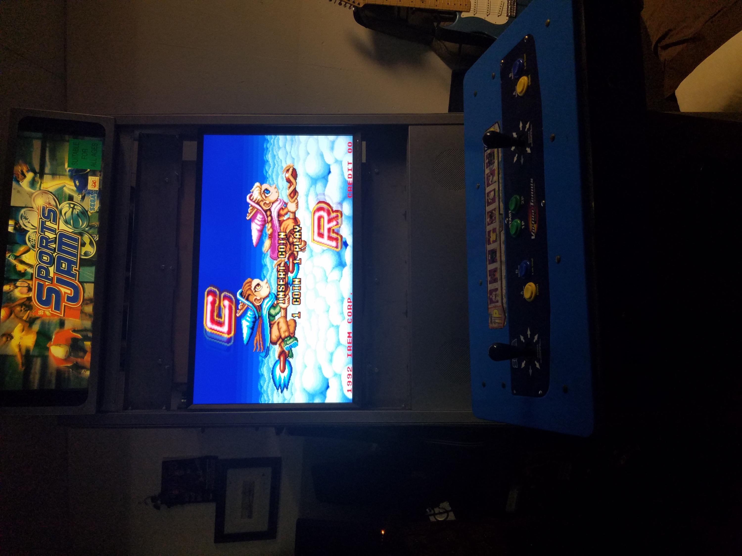

                      I did, its a bad tube. I threw that sucker in the can. I am glad I trashed that piece of junk. On a good note, I fitted a 32inch Samsung Led monitor in its place. I got a great deal on it, $180. Check out Pics! It will be a great machine when I am done with it. I took all the Naomi stuff out of it. This machine will be ready to sell in a couple days
                                Nice, just make sure to turn down the backlights level to as low as possible to extend the life of the LED backlights.
