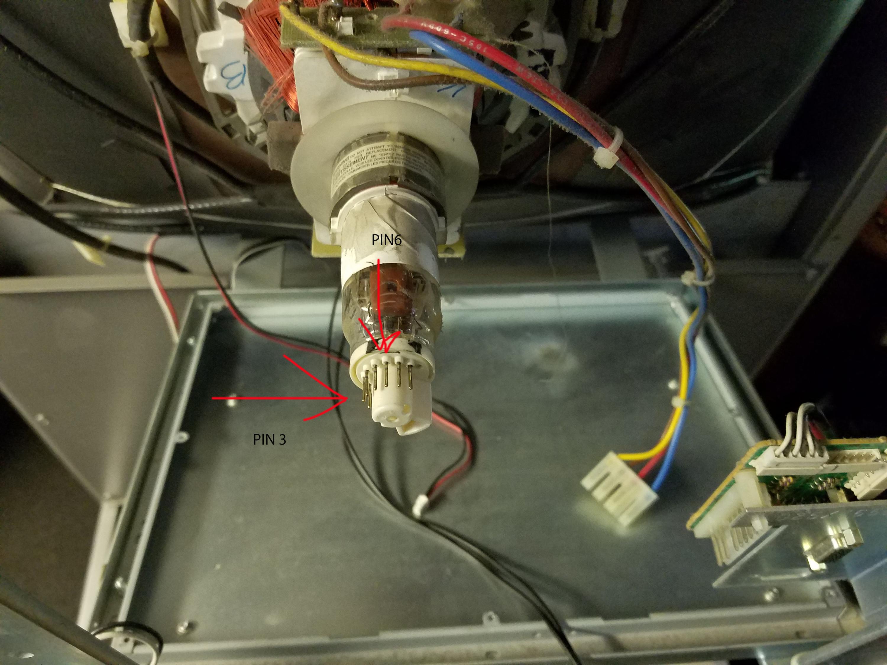

    can you show those pins on the neckboard foto?
    i dont know how your numbering them.

      Re: WGM2792 Arcade Monitor Resistor Burn Off On Neck Board *Need Help*
      Yes, i am sorry. I should have been more specific. I was numbering them facing the tube from left to right. I am attaching a picture of the neck with the numbering, as well as the board.
            you should see a low resistance between 6 & 7 - that's the heater element!
            and check the resistance between ground and pins 21, 24, & 26 on the 28pin chip
            ground is on pins 11 & 22
              Checked, All are about 390Ω.... Pins 6&7 on the tube is about 9.63MΩ. What about 3 and 6 @ 1.1 ohm, is that ok?
                    lets ignore the heating resistor for a while and try to get the neck heater working.
                    leave the resistor off he board,
                    re-assemble the thing and see if your getting heater voltage on the neck-socket pins when it's on.

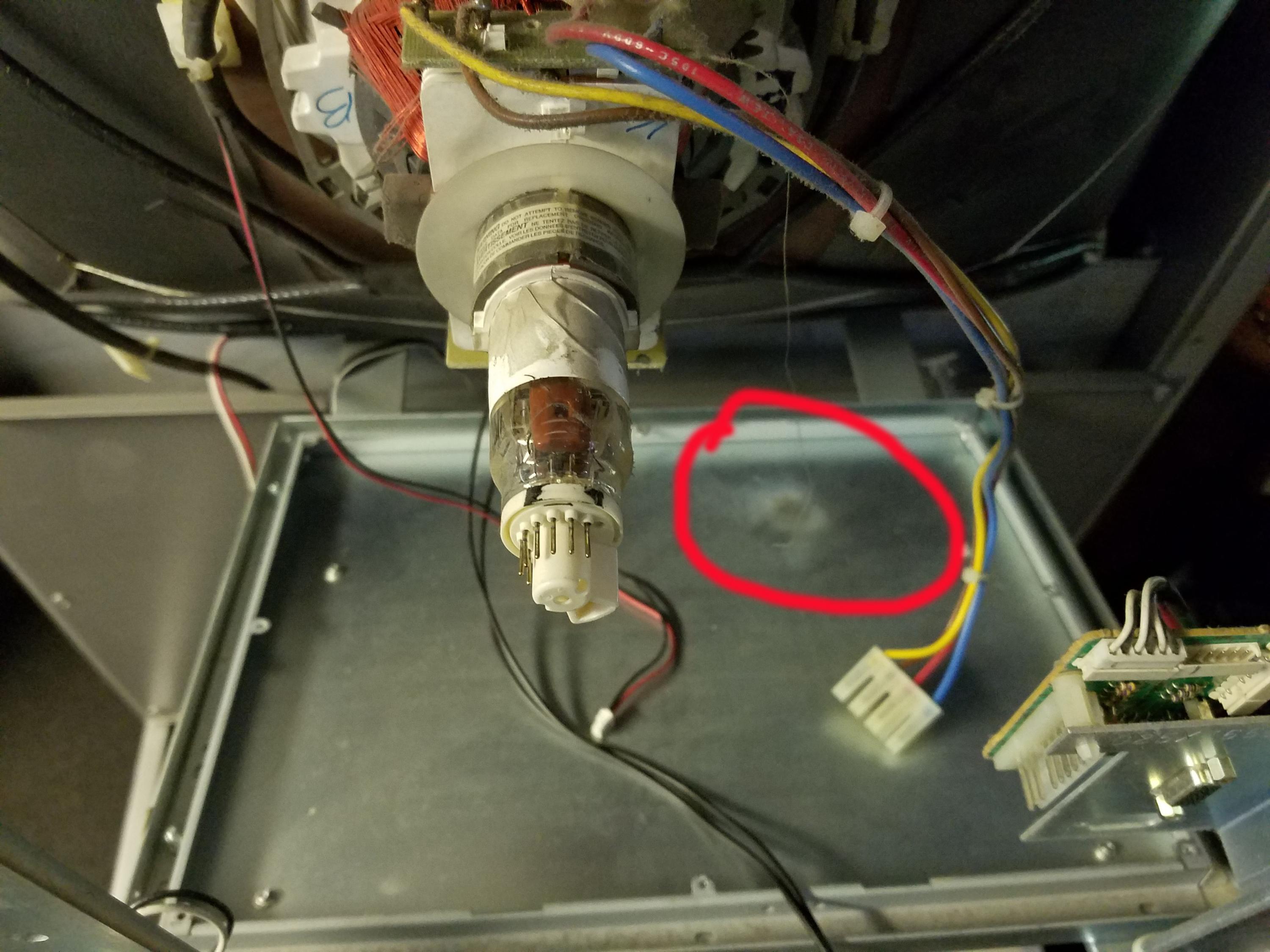

                            i just noticed something in your tube foto - where the hell is the convergence ring assembly?
                            did you strip it off or was it missing to begin with?

                                    #57
                                    strange.
