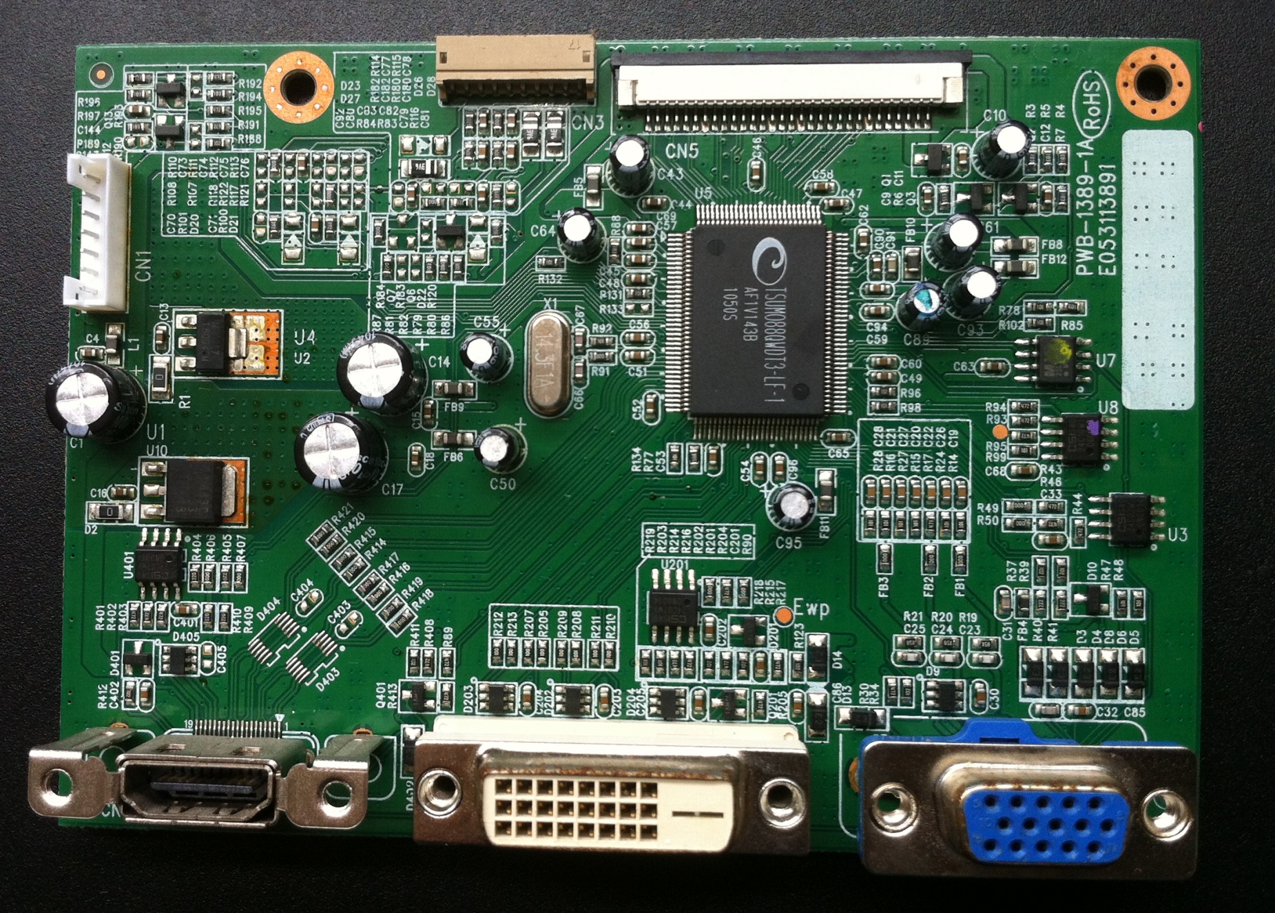

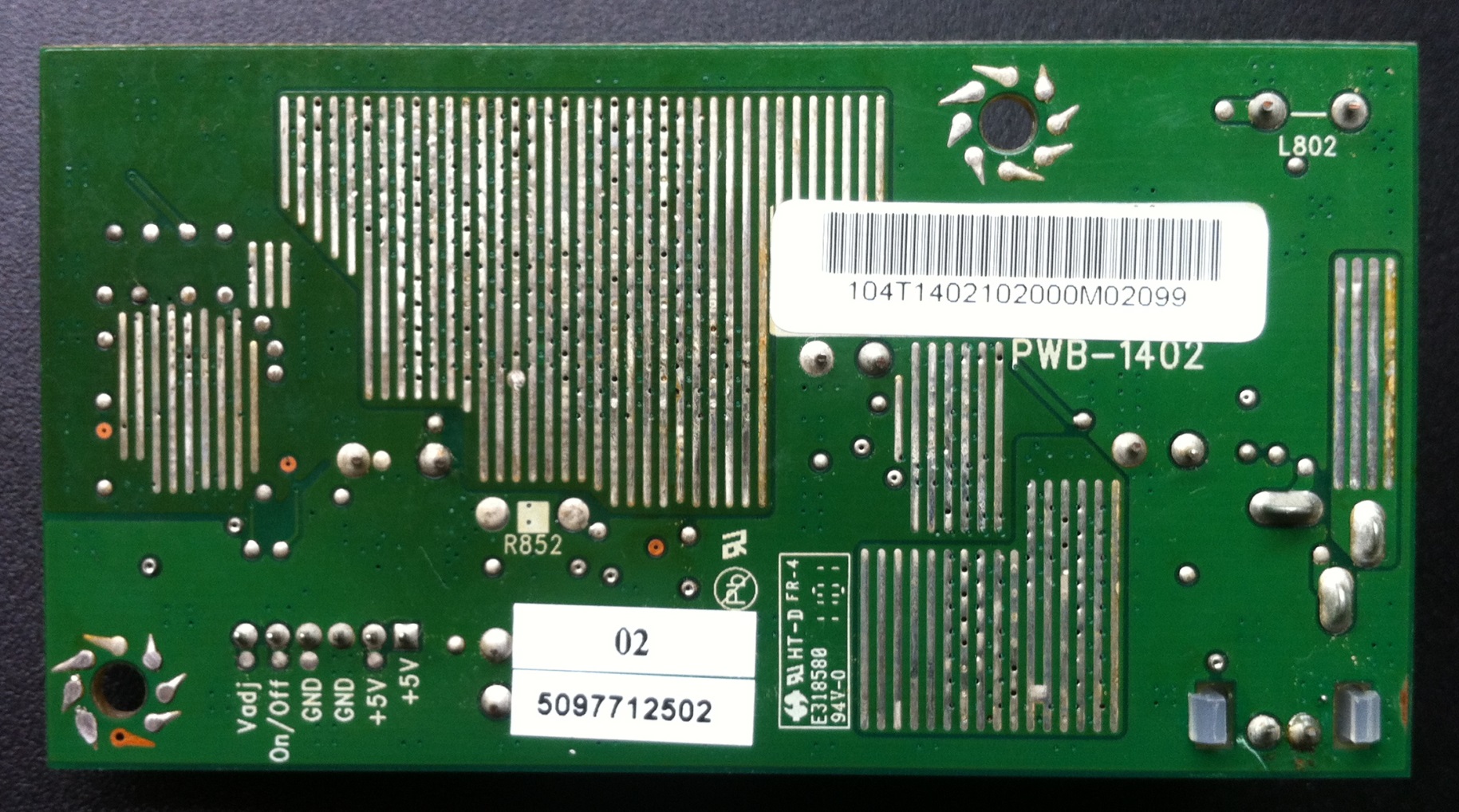

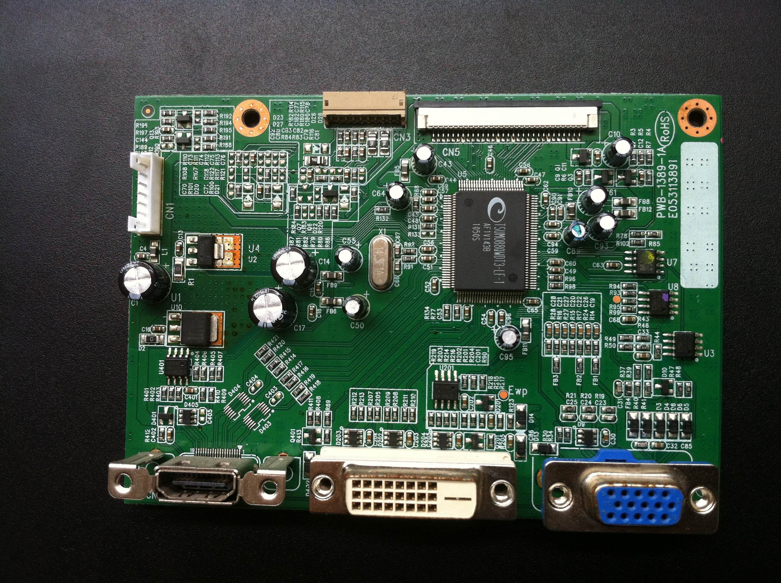

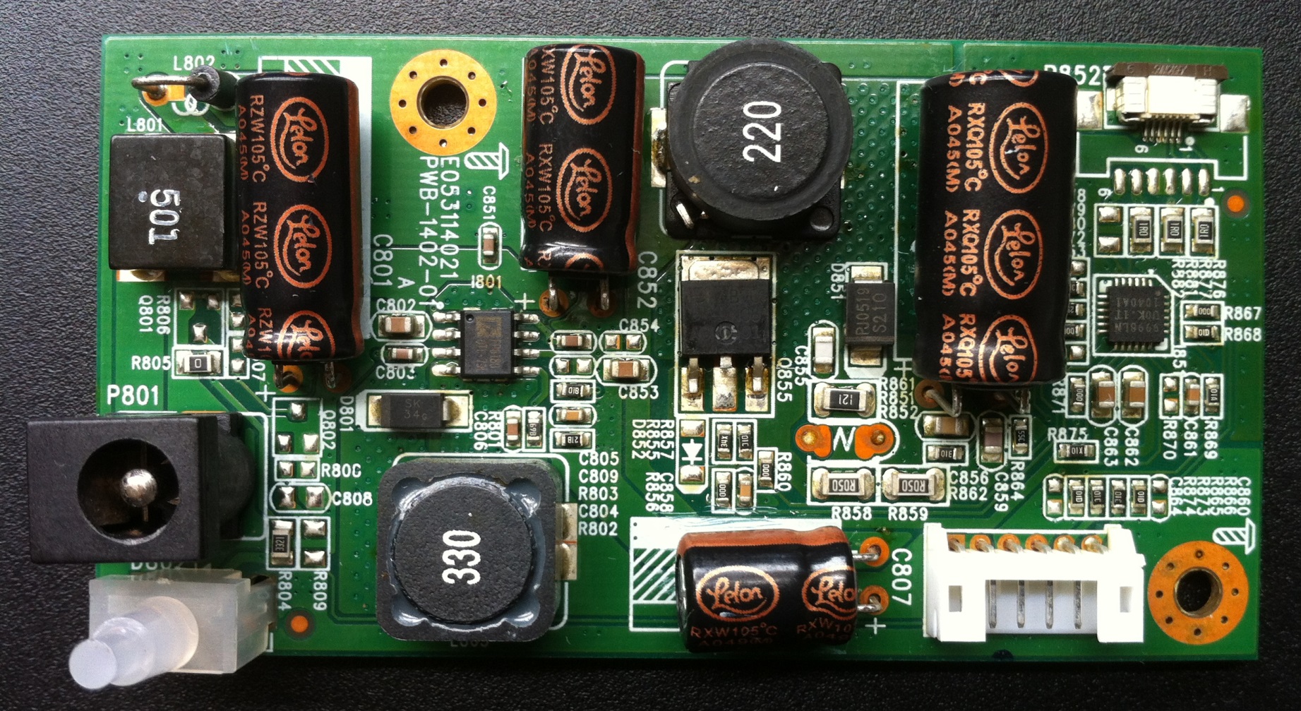

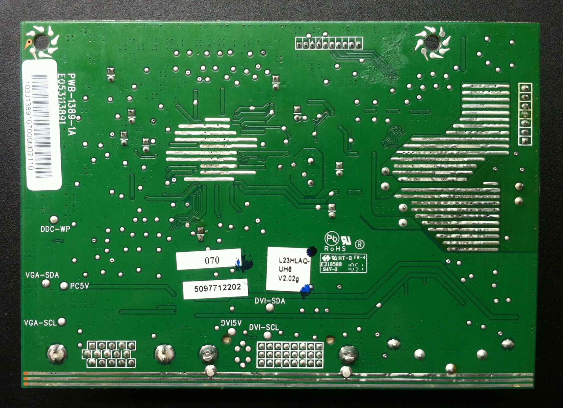

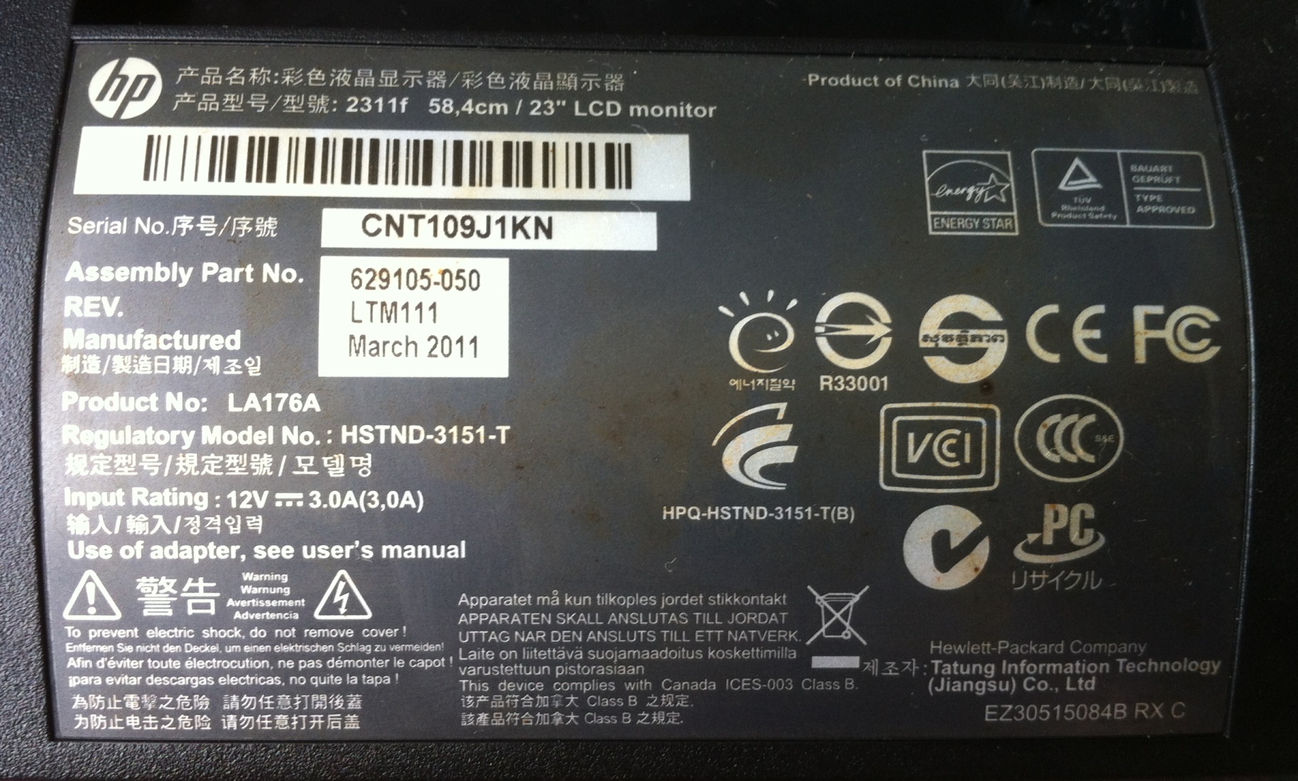

    My HP 2311F monitor is having an issue, turning on and off, after a while. After searching through this forum, I found similar thread (#56) posted by "matt230" on May 2nd 2013. It was suspected bad caps.
    Referring to "Bud Martin's guide", I was unable to figure out which caps are not working. The caps look fine by visual (neither bulging nor leaking) but I do not own the capacitance or ESR meter. It would be grateful to have some suggestions which caps might fail.
    Followings are the info that I'm able to dig from the monitor:
    PSU board: Lelon caps (www.lelon.com.tw)
    1) 470uF 25V
    2) 330uF 25V
    3) 33uF 160V
    4) 330uF 16V
    Logic board: Su'scon caps (www.su-scon.com)
    1) 3 x 100uF 16V
    2) 8x 10uF 16V
    3) 1 x 2.2uF 50V

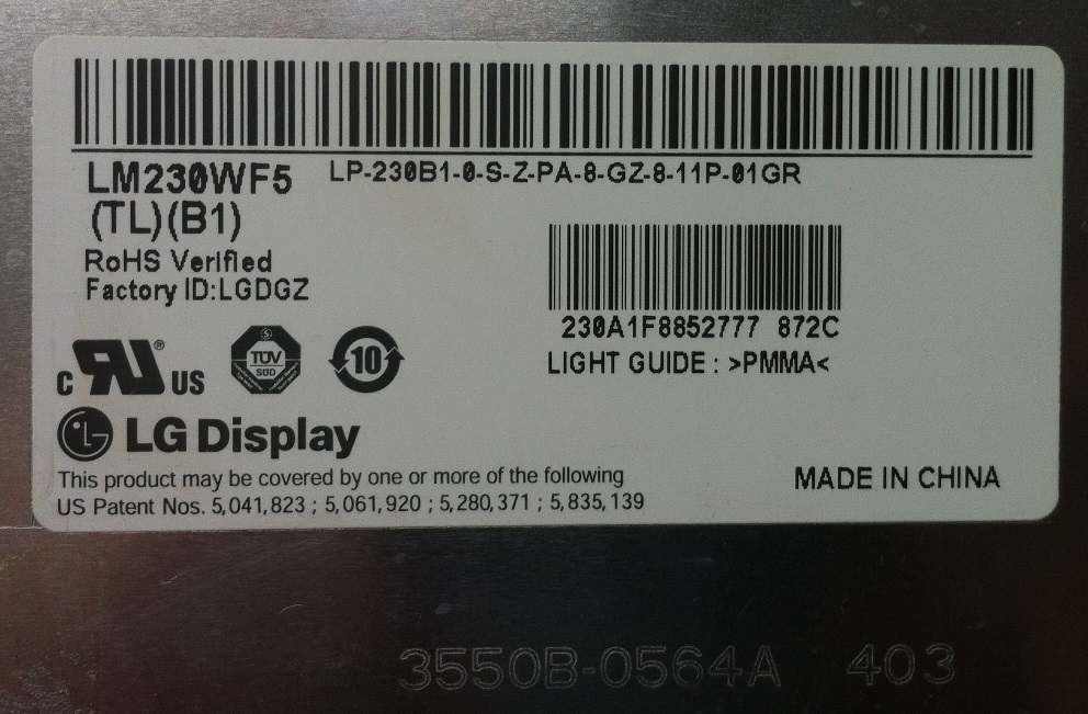

    Display by LG (LM230WF5)
    and the photos which might be useful
    Thanks, in advance, for your time.

                    It looks like this monitor uses an external power supply? Have you checked that for bad capacitors?

                        You did not show a photo of the inside of the external PSU so I thought perhaps you had not done even a visual inspection of the capacitors there.

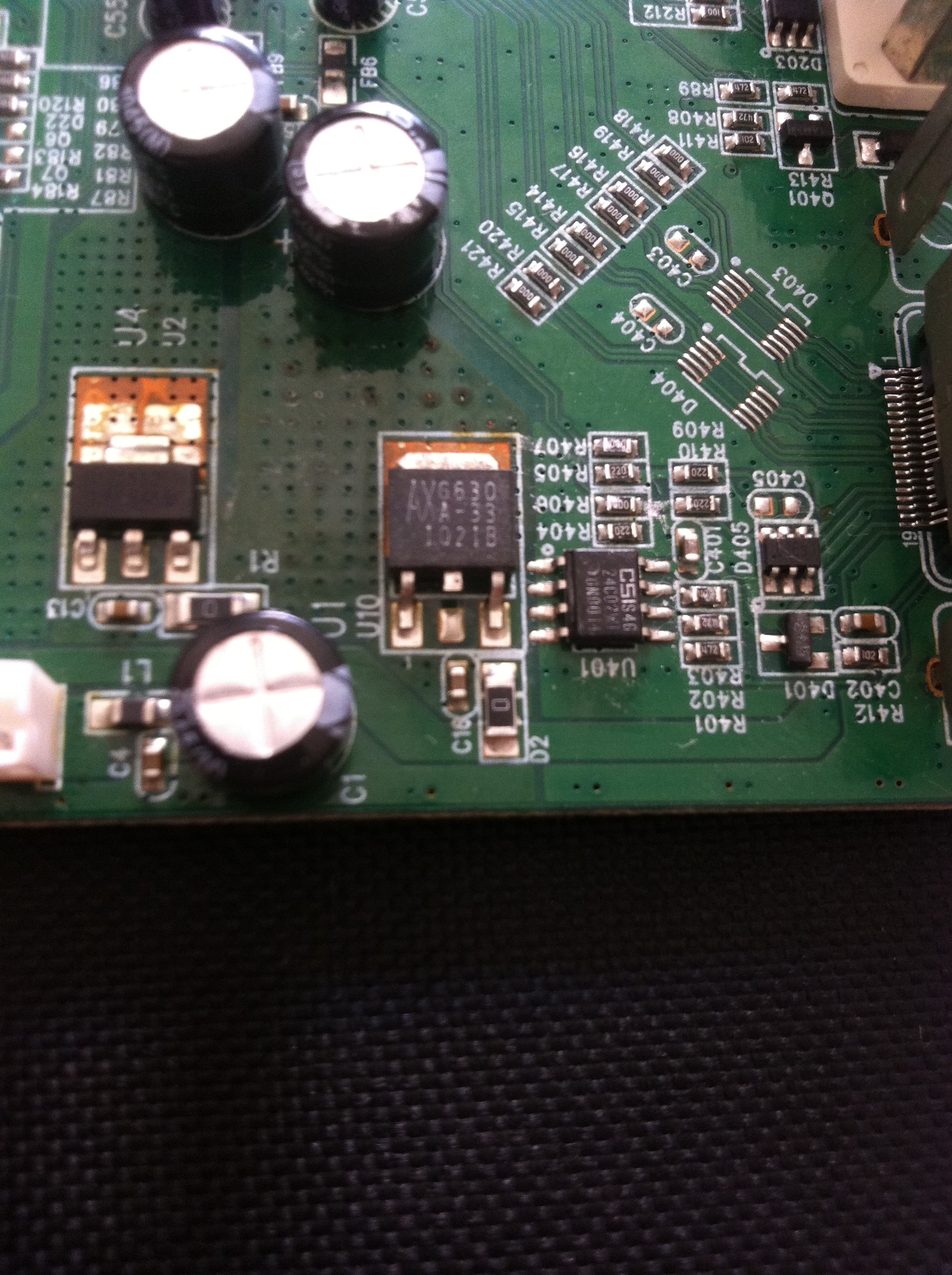

                                  • gagaguu
                                    • May 2015
                                    • 20
                                    • singapore
                                    Re: HP 2311F Monitor: Flashing on & off : Culprit found but need some advices
                                    I am trying to figure out what's causing my HP 2311F display flicker.
                                    I got really helpful suggestions and advices...
                                    i was following 'BudM's sticky' and it is really an eye opener...
                                    (thank you so much.)
                                    in a nutshell, my monitor was having a LDO regulator, U1 on Logic board, faulty.
                                    For those having same problem as me, you would have a rough idea...
                                    Please refer to the attached datasheet.
                                    (it was thermal shutdown function in action.)
                                    That being said,, what would be the compatible regulator?
                                    Pls help.
                                    regards,
                                    Win K. Soe
                                      There are probably several regulators which would do the job.
                                      Go to Digikey\Mouser\Farnell etc and search for one that meets the same specifications.
                                      You need same package type (well, you can get creative but it's easier if you have the same package)
                                      Same output voltage, same output current (1.2A) etc.
                                      Same or lower dropout voltage (NOTE: it's different for different output voltages)
                                      Also, are you sure the regulator is bad, and there's no short on the output?
                                      -David VanHorn
                                      • gagaguu
                                        • May 2015
                                        • 20
                                        • singapore
                                        I borrowed an IR thermometer and checked every converters, regulators, etc...
                                        it checked out this regulator. It's temp is higher than others.
                                        (but the temp is within it's op temp and i dont understand why)
                                        So i tried the dummy test. put a little thermal paste and Al heatsink.
                                        I tested it the day before yesterday for 4 hours plus. ok..
                                        In fact, i m testing it with that heatsink now..it's over 3 hrs and no flicker...
                                        (during this 3 hrs, i took out the heatsink and it flickers, putting it back, ok..)
                                        so I'm 85% sure that regulator is causing the flicker.
                                        From datasheet, it's AX6630A 3.3V.
                                        I will check with RS Singapore.
